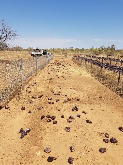

Sodium monofluoroacetate to be exact. Here is a picture of some I took 2 weeks ago.
Does anybody know how 1080 got its name (without Googling it)

Post by CT hillbilly » 21 Nov 2021, 5:48 am
so tomorrow is our last day for the 2021 baiting campaign with 78 property's getting on board and around 8.5 T of meat injected only around 2T of pig and the rest being dog lets hope we get good results from the land owners in April-may when we kick off again

Post by CT hillbilly » 22 Nov 2021, 4:50 pm
we prefer meat baits to be dried for a day or 2 to allow blood to drain so 1080 isn't diluted to much
CT hillbilly
Posts: 130
Re: 1080 time
Post by animalpest » 22 Nov 2021, 5:06 pm
You dont want the "blood to drain" after they are injected. The 1080 will be in the blood so you lose it from the bait.
Drying the meat for a day or two puts a skin on the meat, reducing loss of the 1080 and fluid and hopefully making the bait a little less effected by moisture, ground bacteria and insects. The biggest killers of 1080 meat baits are some types of bacteria, fungi and loss through water/rain.

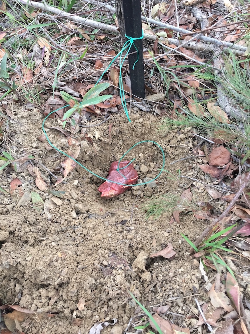

Post by Trapper22 » 22 Nov 2021, 10:30 pm
I do some contract baiting for some councils here in SE Qld, finished a job last month where baits got laid in peri urban areas. Baits are tethered so that non target species don't carry them away. Just order the amount of injected baits and pick them up from the DPI depot the day you start.
Depending on which council, baiting is done April/May and September/October which comprise of laying baits, picking up untaken baits 7 days later, then a follow up baiting 30 days later.
Photo of uncovered bait
tethered
Trapper22
Posts: 7
Re: 1080 time
Post by animalpest » 23 Nov 2021, 9:42 am
That's good. Tethered baits have a lower rate of bait caching by foxes as well.
