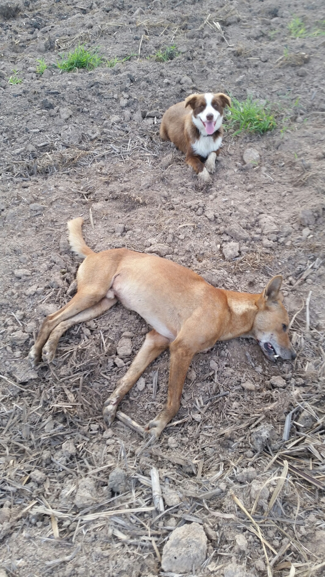

Got 2 dogs with the 223 last week actually. This one was the longest kill with my 223 that I've measured, 376metres
2018-01-31 07.24.15.jpg (1.87 MiB) Viewed 9251 times
Kelsey Cooter
Posts: 401
Re: Tips for hunting feral dogs.
Post by Daddybang » 31 Jan 2018, 7:31 am
That's nice work with a .223! :drinks:
Post by Oldbloke » 31 Jan 2018, 8:20 am
Wow, 376 mtrs is a long way. Where did you hit him and what was the load? Was it a bang flop?

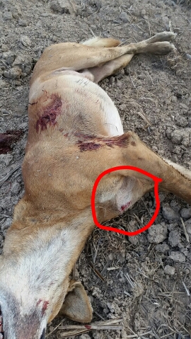

Oldbloke wrote:Wow, 376 mtrs is a long way. Where did you hit him and what was the load? Was it a bang flop?
It was actually with a OSA 55gr seirra blitzking. I was out shooting the small aninals that eat sugar cane, and well and truely didnt expect to have to take that kind of shot at a dog, but he saw me as i saw him so i had no choice.
Mmm wasnt exactly a bang flop. He hit the ground where i shot him, but bucked around on the ground a fair while. Where I've circled is where it hit, then the large patch of blood on his chest is where part of the bullet left, i never would of thought it would make it all the way through at that distance. Well and truely more ass then class.
2018-01-31 08.55.45.jpg (148.11 KiB) Viewed 9086 times

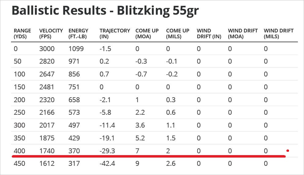

That's 411 yards. Here is the results of a quick calculation on the Hornady Ballistics calculator assuming 3000fps.

So when it hit, the projectile was about the same velocity of a 22win mag at the muzzle.

Oldbloke wrote:That's 411 yards. Here is the results of a quick calculation on the Hornady Ballistics calculator assuming 3000fps.
Thats a great graph thanks for that, i see on the osa website they say 3200fps, I'm not sure exactly what speed they do out of my 22" howa.
Would you of expected an exit hole? Must of just avoided every bone aye?

Post by Gamerancher » 31 Jan 2018, 12:28 pm
Yes, there is a big "hollow" cavity in there. :lol:

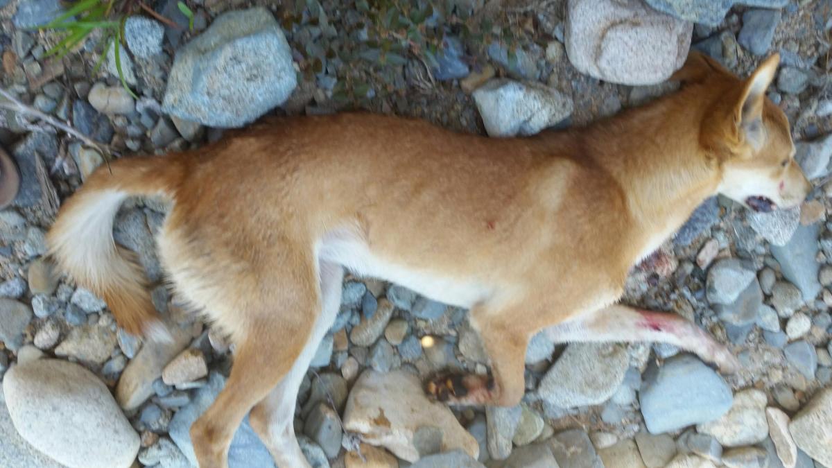

First time out for awhile and nailed this one , was a young bitch one of the mob I've been chasing for awhile :thumbsup:

Again she's healthy lookin granddad they must be getting a good feed down there! :thumbsup: :drinks:

grandadbushy wrote:First time out for awhile and nailed this one , was a young bitch one of the mob I've been chasing for awhile :thumbsup:
7mm or 22-250? And how are the knees coming along?

Grandadbushy, great to see the future breeders culled, looks healthy too.
Post by Member-Deleted » 01 Feb 2018, 2:13 pm
Yeah she was healthy and quiet , got to within 150 or so mtrs shot with 22-250 would have been nice to try the 7mm mag
out but was in a hurry to get down to it as the farmer was keeping a eye on her while she was keeping an eye on his chooks
Yeah Oldbloke mechanically both knees are ok but the 190mm clot behind the right knee is giving me some
grief pain, swelling and such but other than that alls good can't walk far so most of my shooting will be from the ute
for awhile to come but that's the way life is just keep throwing one leg in front of the other and carry on
cheers :thumbsup:
