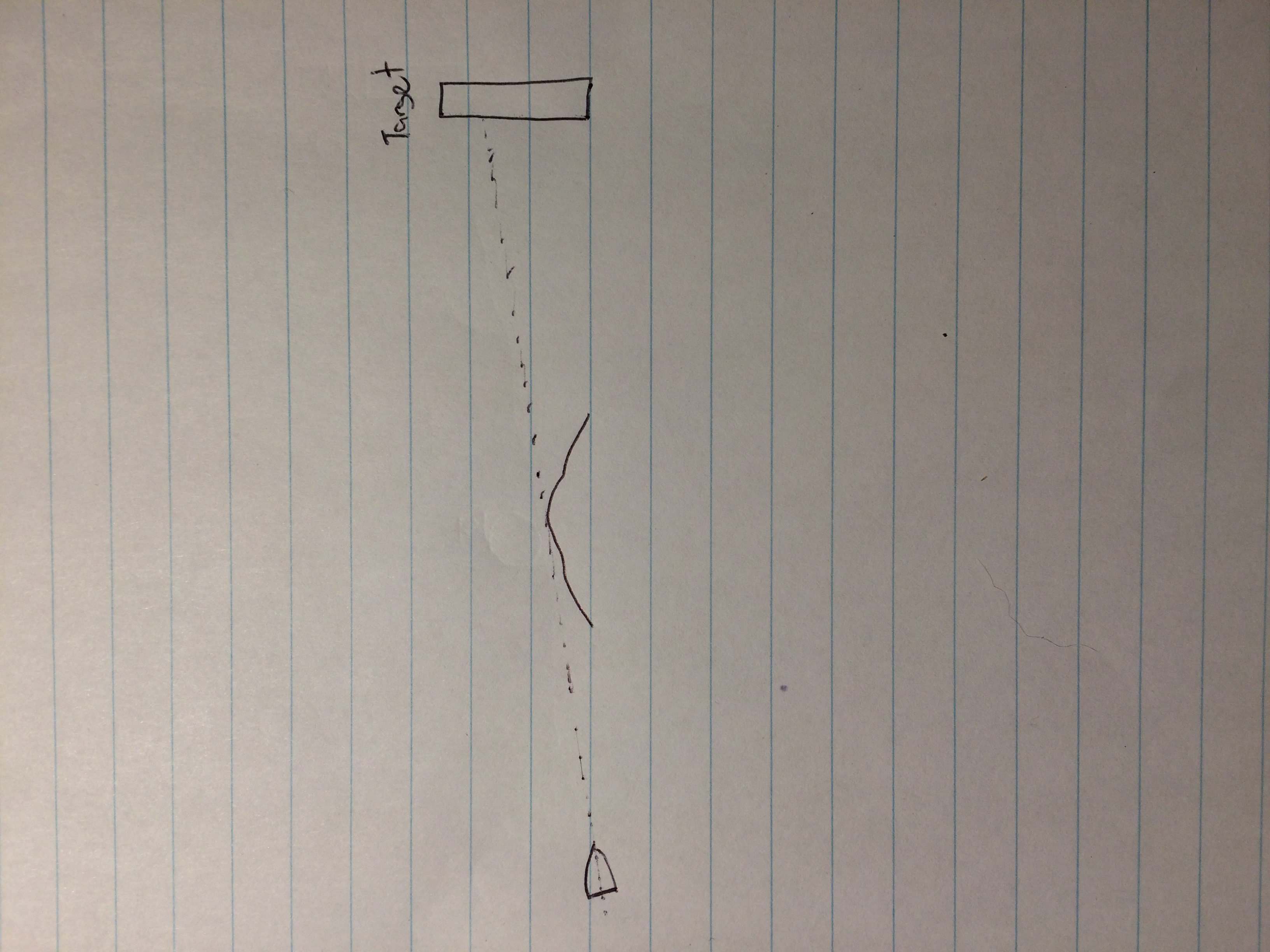

I’ve got another question unrelated to the previous ones. Hopefully it’s ok to keep it in this thread.
If a bullet passes extremely close to an object on the way to its target, could this interfere with the bullets path after said object?
I’ve got a rough drawing to show you what I mean.

Not in my experience, no. If I were shooting over 1000m I probably wouldn't want my bullets passing a few millimeters from an object en-route, but I haven't seen that it affects it in any meaningful way. One of my 240m gongs is set up on the other side of a dam. The trajectory of .22LR is such that I'm sighting through two fences en-route, but the bullets are passing over both of them, and the dam, before coming down into the target. On the closer fence, the bullets pass very closely over a horizontal log fence strainer, close enough that I get an occasional strike. I could probably set up some sort of barricade situation and see if very close supersonic bullets are pushed off course to any measurable degree, but I really don't think it's a problem. A heavy steel plate set up a few meters ahead of the muzzle, and so close as to be virtually touching the bullets, and see if the groups move across the target three or four hundred meters downrange. Damn, looks like another project to add to the list :-)
