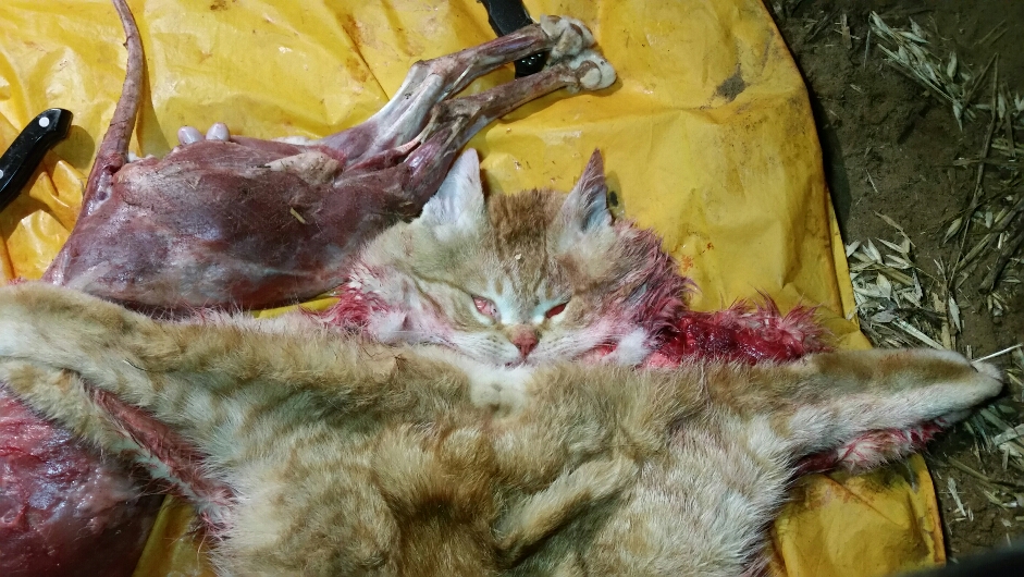

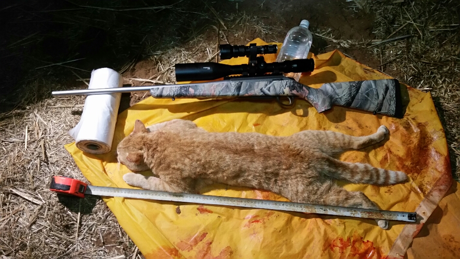

Some may remember this big fella i bowled over a couple of months back...
Pictured with 204 cartridge
2018-06-14 20.14.04.jpg (1.29 MiB) Viewed 12563 times
Next to Tikka T3
2018-06-14 20.13.04.jpg (477.55 KiB) Viewed 12563 times
Undressed
2018-06-14 20.14.35.jpg (463.29 KiB) Viewed 12563 times
Eeek...!
2018-06-14 20.15.56.jpg (476.41 KiB) Viewed 12563 times

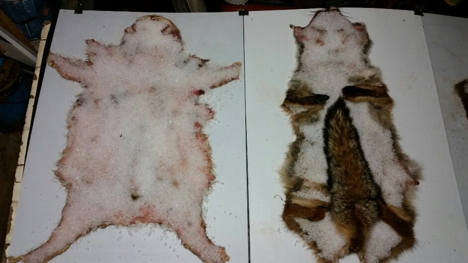

Salted
2018-06-14 20.34.25.jpg (362.79 KiB) Viewed 12563 times

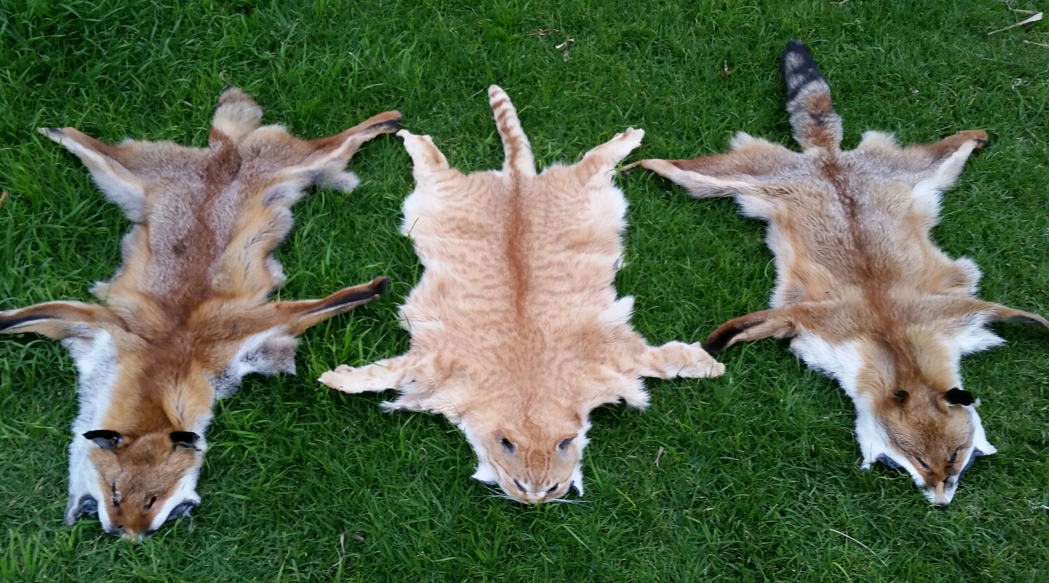

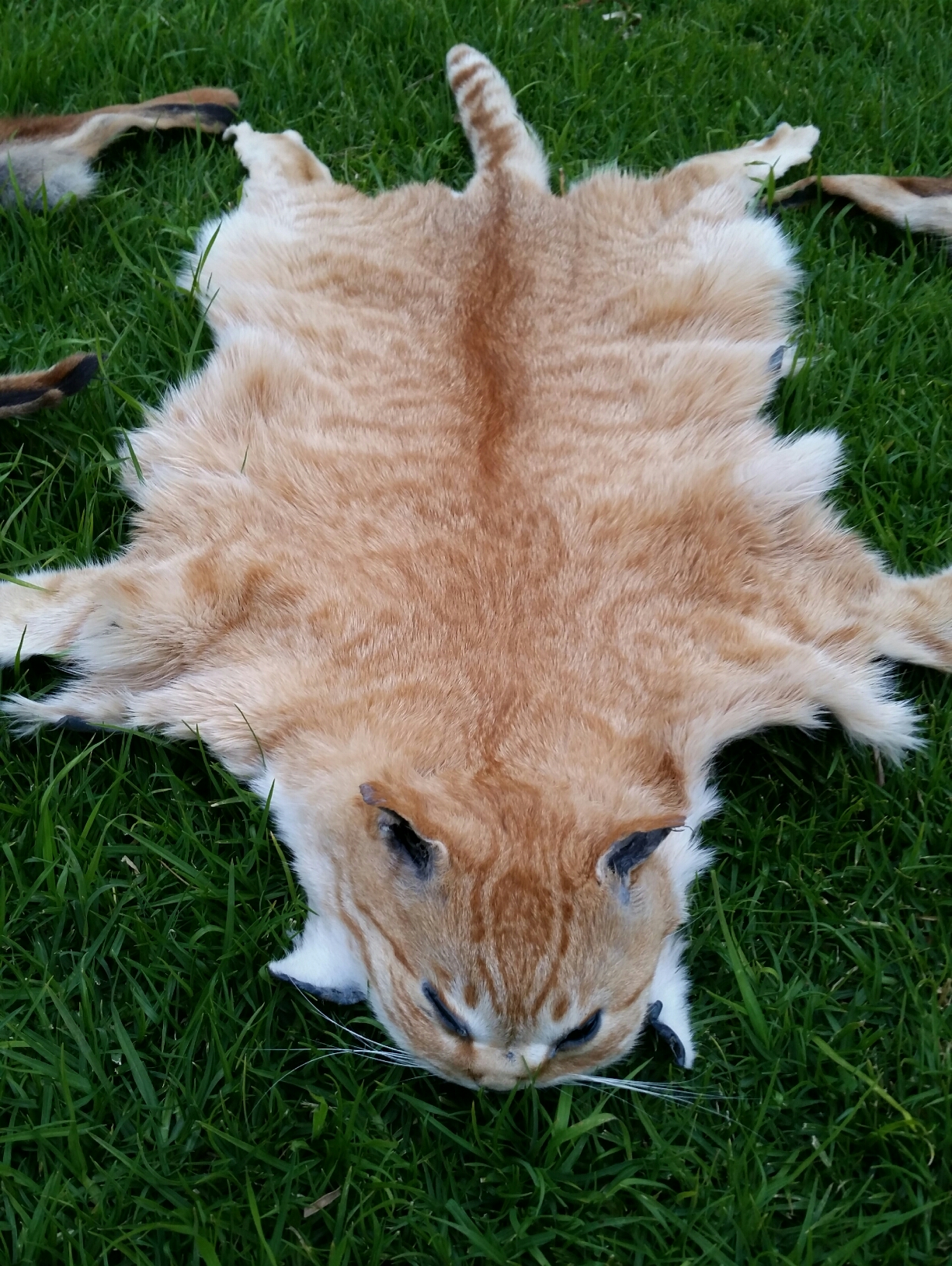

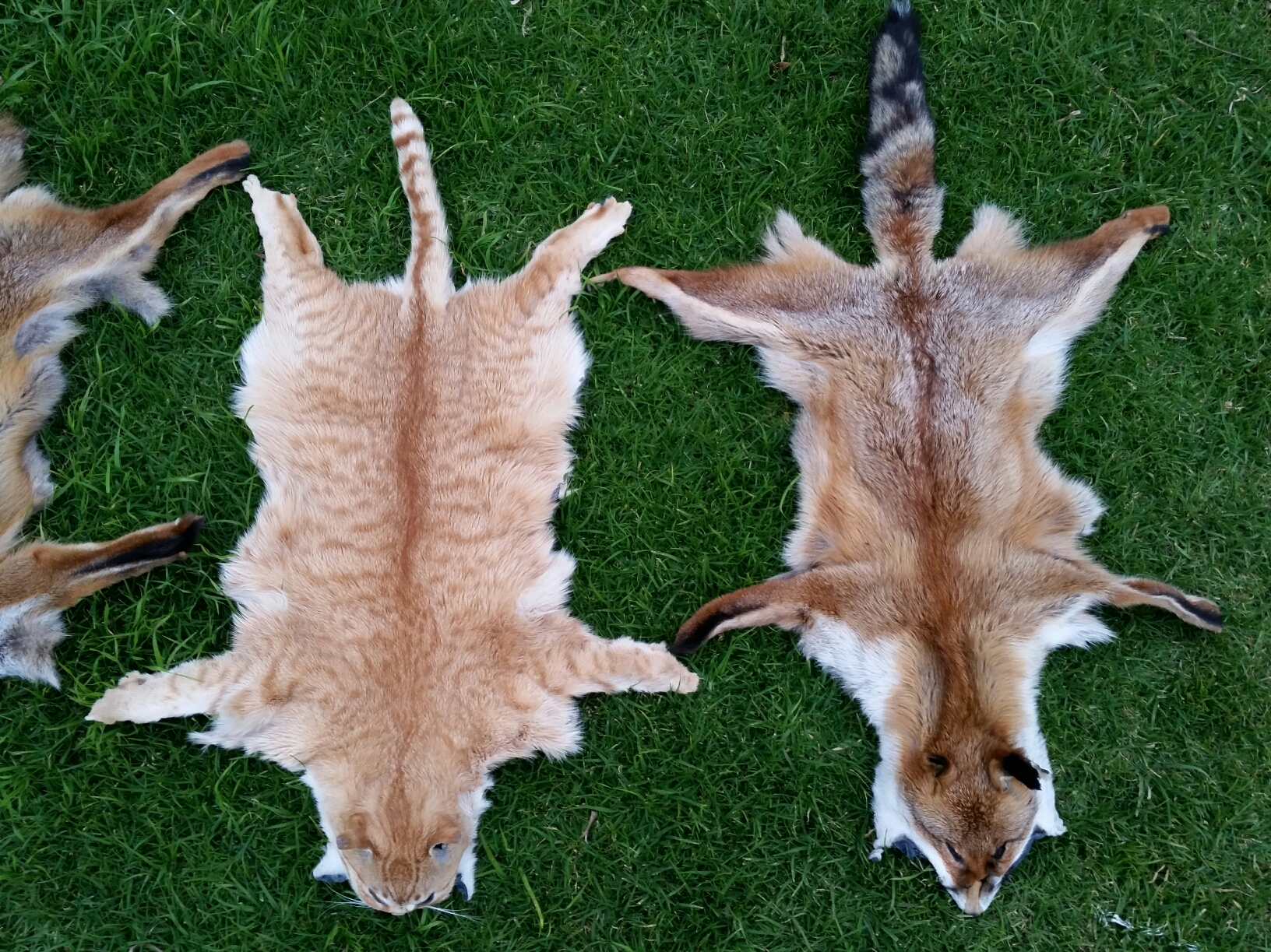

Well he is now done & here in my latest batch of skins...a hubby n wife pair of foxes, & my monster lion.
These worked a bit better than the last lot, with the exception of the knife nics & couple of tears.
Latest batch
2018-08-19 22.57.53.jpg (1.09 MiB) Viewed 12563 times
The cat skin was quite difficult & it has actually shrunk.
Problems arose from the varying thickness of the hide.
The hide is normal cat/fox thickness at the back legs, but it gets thicker the closer to the head...to the point where its very thick across the back of the shoulders, & even thicker head....so where its thicker its not as soft & pliable.
I kept feeding it the oil so as to avoid this but it didnt work.
With the exception of a very small amount of fur slip around the tip of the ears, the fur has set well & is beautifully soft & thick.

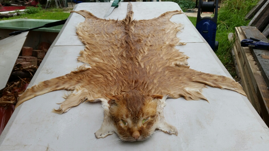

Big boy
2018-08-19 22.55.35.jpg (1.55 MiB) Viewed 12563 times
Unfortunately i put a 2" tear in it just behind a front leg while breaking & stretching it.
Just for a little perspective on size, the cat fur in this next pic is next to a mature bitch fox & is notably heavier (the earlier pic is dog fox on left).
Cat next to mature bitch fox
2018-08-19 22.58.10.jpg (1.85 MiB) Viewed 12563 times
Im not sure if i should wet the skin up again & try get more oil into it...?
I might give it more breaking over a bit of timber, but dont think ill get the thick areas any more pliable.
Happy to hear any tips to get thick skins softer if anyone has any. :)
Overall im pretty happy how its turned out, not perfect but it could have been a lot worse. :D

They look pretty good to me stix. What tanning recipe did you use?
Re: Tanning/Initial Tanning Prep...
Post by Stix » 20 Aug 2018, 8:42 pm
Oldbloke wrote:They look pretty good to me stix. What tanning recipe did you use?
I purchased a kit... DS Horne kit...it uses Alum & salt to set the fur, & chromium powder added for second stage for the hide, then fat/oil to skin.
http://www.dshorne.com.au/hornes-practical-tanning-kits
Works well enough, but ive used a good portion of the oil already, & it dies the skin blue/green from the chrome powder.
I need to find out if we (I) can buy the chrome powder seperately, as we know the alum & salt are easily come by...it would make for very cheap & effective tanning.

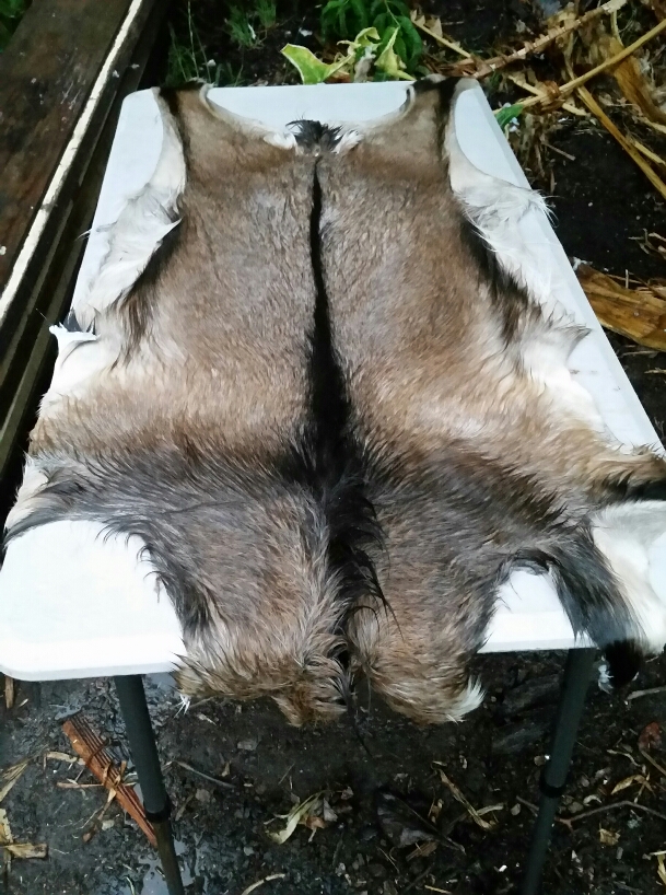

Fleshed out my first goat skin this evening.
For the most part it seemed to flesh out pretty easy & leave a nice smooth finish...much like a squid tube & very similar to the cats ive done so far.
There were a few difficult areas, but thats all down to the wuality of my skinning job--im not too good at it... :oops: ah well.
2018-11-19 22.57.31.jpg (439.19 KiB) Viewed 11864 times
Rekon it might turn out ok... but time will tell..fingers crossed...

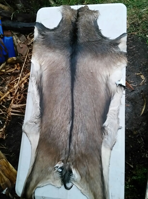

Post by Stix » 13 Jan 2019, 10:06 pm
Well that goat skin above turned out a cracker so im stoked. :clap: i want more goat skins now...!!!

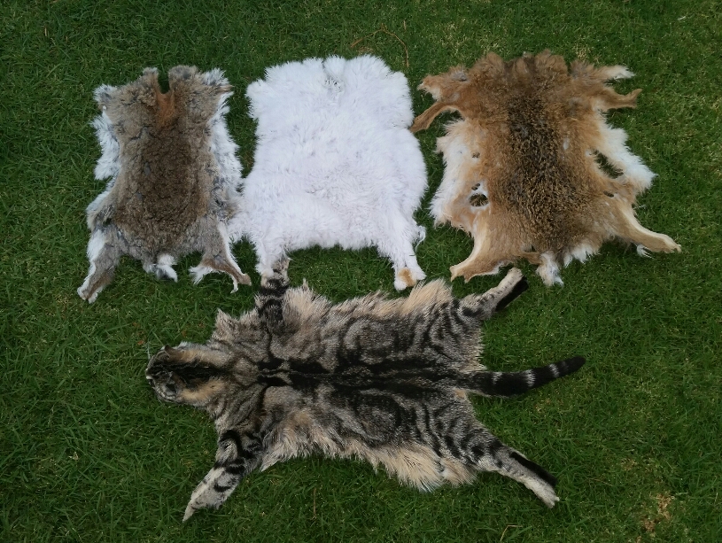

Here is a few of the latest ive been trying to turn out over the last few days...
Some of my latest furs
2019-01-13 22.14.39.jpg (516.79 KiB) Viewed 11802 times
Although the cat looks small in this pic, its your average size moggie & infact the rabbits are quite sizable...!
The top 3 are furry hoppy critters...left is the fur of a milky doe, a bit on the thin side & a bit skanky aa they use all their energy into producing milk...but all in all pretty reasonable result considering.
On the right is a Port Adelaide Hare--a mate ran iver it at 1am one morning & rang me--it squeezed ok & appeared in tact so he bought it over & i dressed it out.
Its the first hare ive done & its pretty thin...you can see the holes ive put in it while fleshing.
Given how thin it is, its turned out pretty soft & supple.
The cat is a really great fur...!! Although ive put too much oil on it so i need to rectify that somehow.
The white one is a domestic bunny... :lol:
A mate helps out an old Italian couple that breed their own rabbits for food.
When he told me they asked him to slaughter them i kicked up a fuss about getting there to skin them out...
My fuss worked...!!
The fur is amazing & the leather is so supple its unbelievable... :thumbsup:

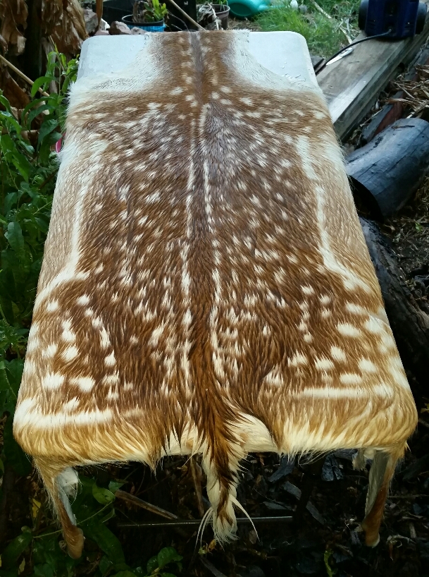

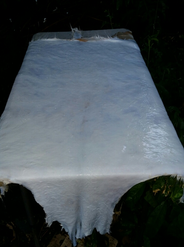

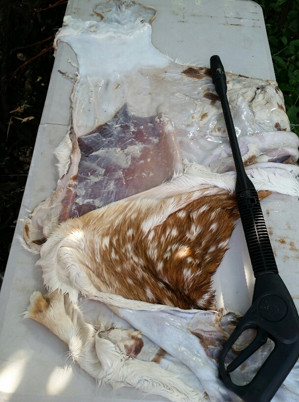

Anyone tanned fallow hide before...?
Im having trouble getting them to sit in the pickle...
They want to float up & on the surface despite squeezing them out in the pickle.
Do these hairs all have little air pockets in them or something...??
Anyone experienced this...,?
What to do..?...just sit a couple bricks on them...?

Post by Oldbloke » 28 Jul 2019, 1:20 pm
Lol. Most deer hair is hollow, like a fibreglass rishing rod. Put a brick on it.

Post by Stix » 28 Jul 2019, 6:01 pm
Yep cheers...
Already put a bucket lid on them (slightly smaller than the bucket theyre in) & a big rock on that...
So if the hair is hollow & floaty...they would make good hairs for trout fishing flies wouldnt they...?...

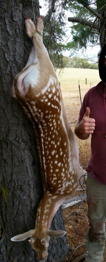

Post by Stix » 09 Dec 2019, 6:32 pm

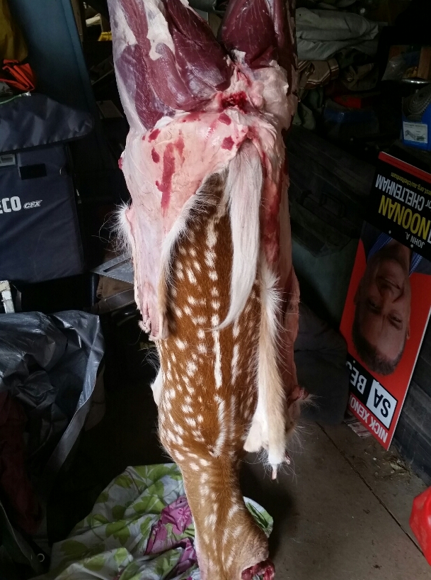

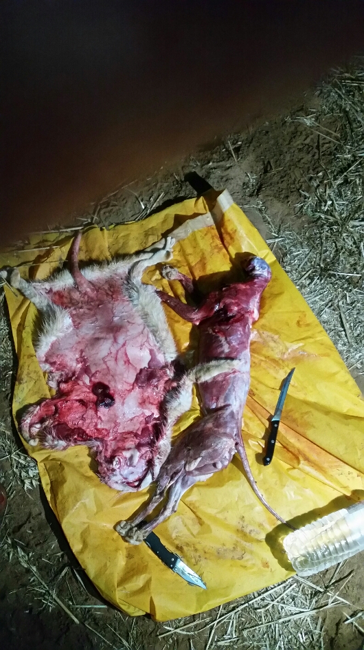

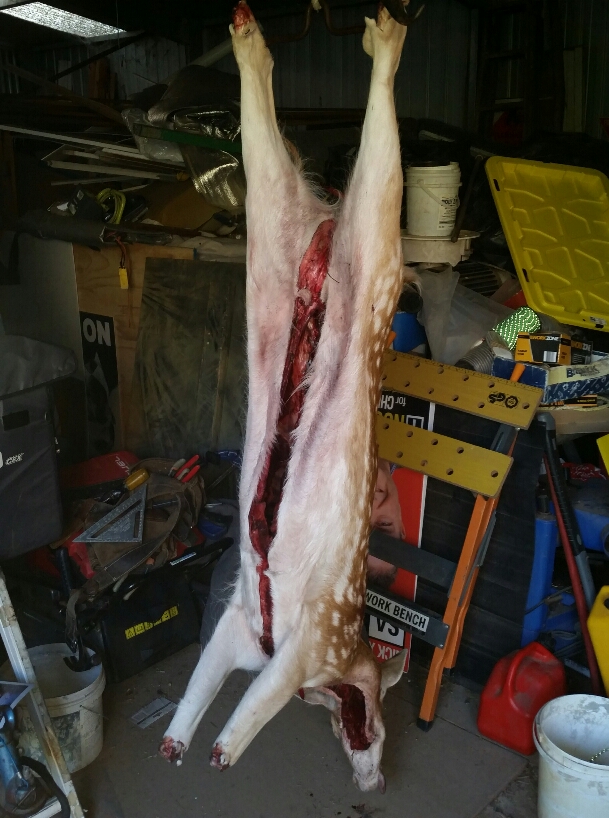

So...i found this handsome young fella...he was laying on the ground inly about 80 odd yds in front of my rifle...YAY...!!! :clap:
2019-12-09 18.35.44.jpg (296.46 KiB) Viewed 11417 times
He was heavy enough to make it challenging to get him up on the gambrel by myself without a hoist... :evil: ...iso much so i cracked a beer once he was up... :clap:
2019-12-09 18.42.10.jpg (375.93 KiB) Viewed 11417 times

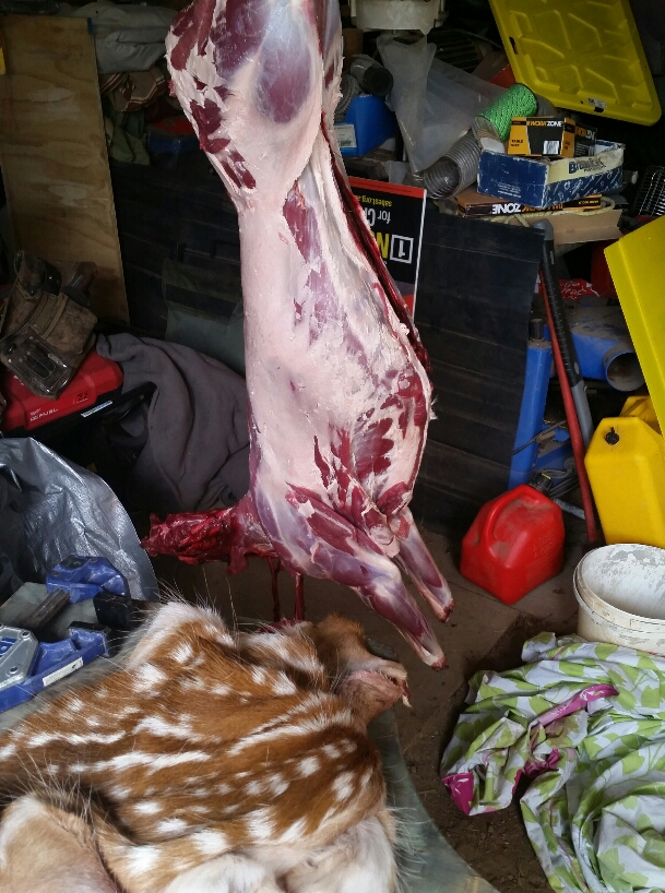

Skun him out...
2019-12-09 18.42.39.jpg (389.04 KiB) Viewed 11417 times

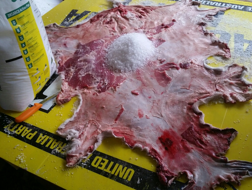

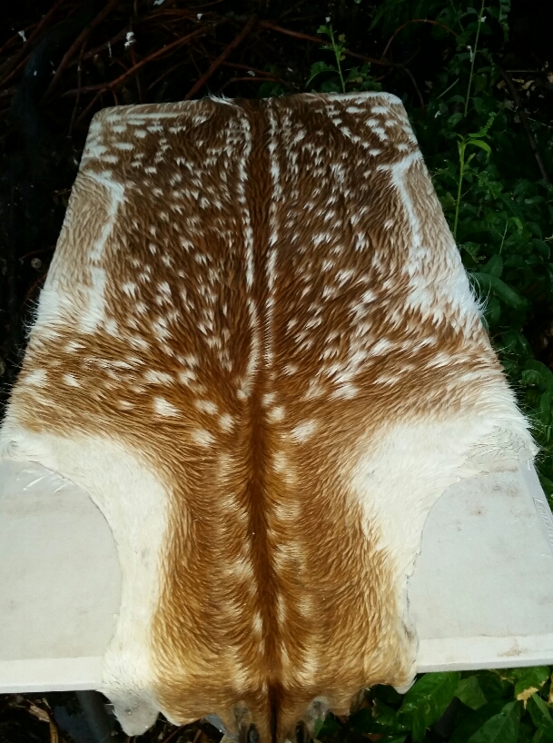

All done...needed another beer to salt the skin...
2019-12-09 18.42.50.jpg (442.26 KiB) Viewed 11417 times
Cut off as much fat & muscle as i could be bothered doing...then salt...
2019-12-09 18.43.06.jpg (486.09 KiB) Viewed 11417 times
After a good week on the salt, last night i fleshed him out...
Ive started on the back leg with the pressure cleaner...
2019-12-09 18.36.31.jpg (419.69 KiB) Viewed 11417 times
All done...!!
Not perfect...& not as good as id have liked...but still, im happy--or more to the point, my shoulder was happy to call it after 1.5 hours... :|
2019-12-09 18.37.40.jpg (283.06 KiB) Viewed 11417 times
Looks fantasic...!!!
2019-12-09 18.37.54.jpg (433.68 KiB) Viewed 11417 times
Im not looking forward to breaking it, but i cant wait till its finished...!!
Its in the pickle now, i just hope the bacteria dont get a hold as its really a great hide..!!!
