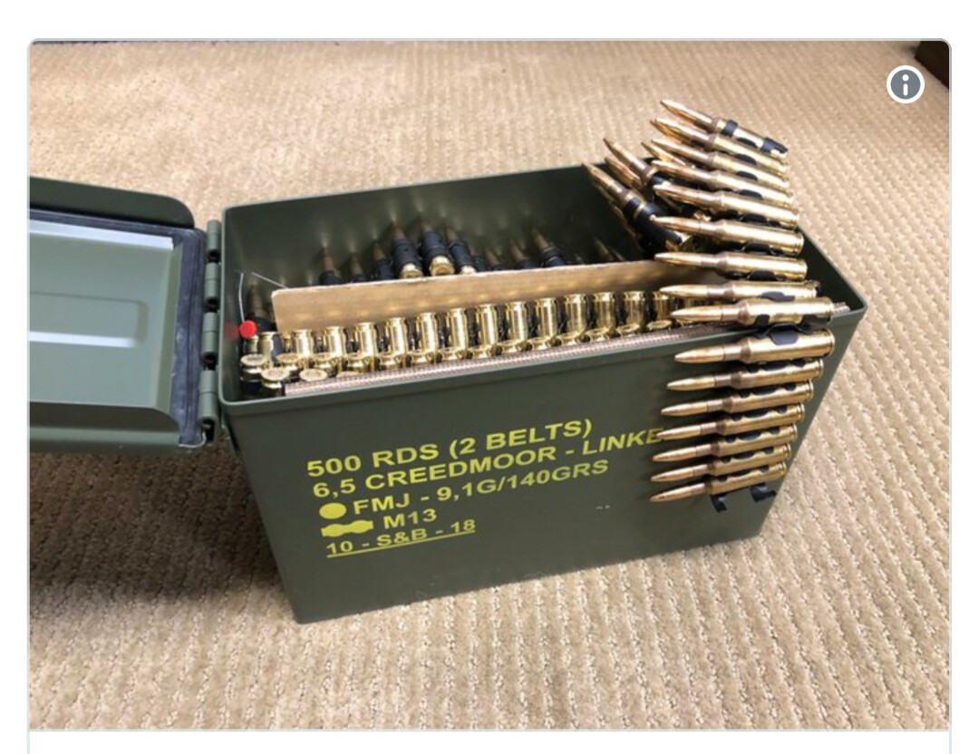

Post by Bent Arrow » 24 May 2019, 8:55 pm
I'll just leave this here then shall I..........
