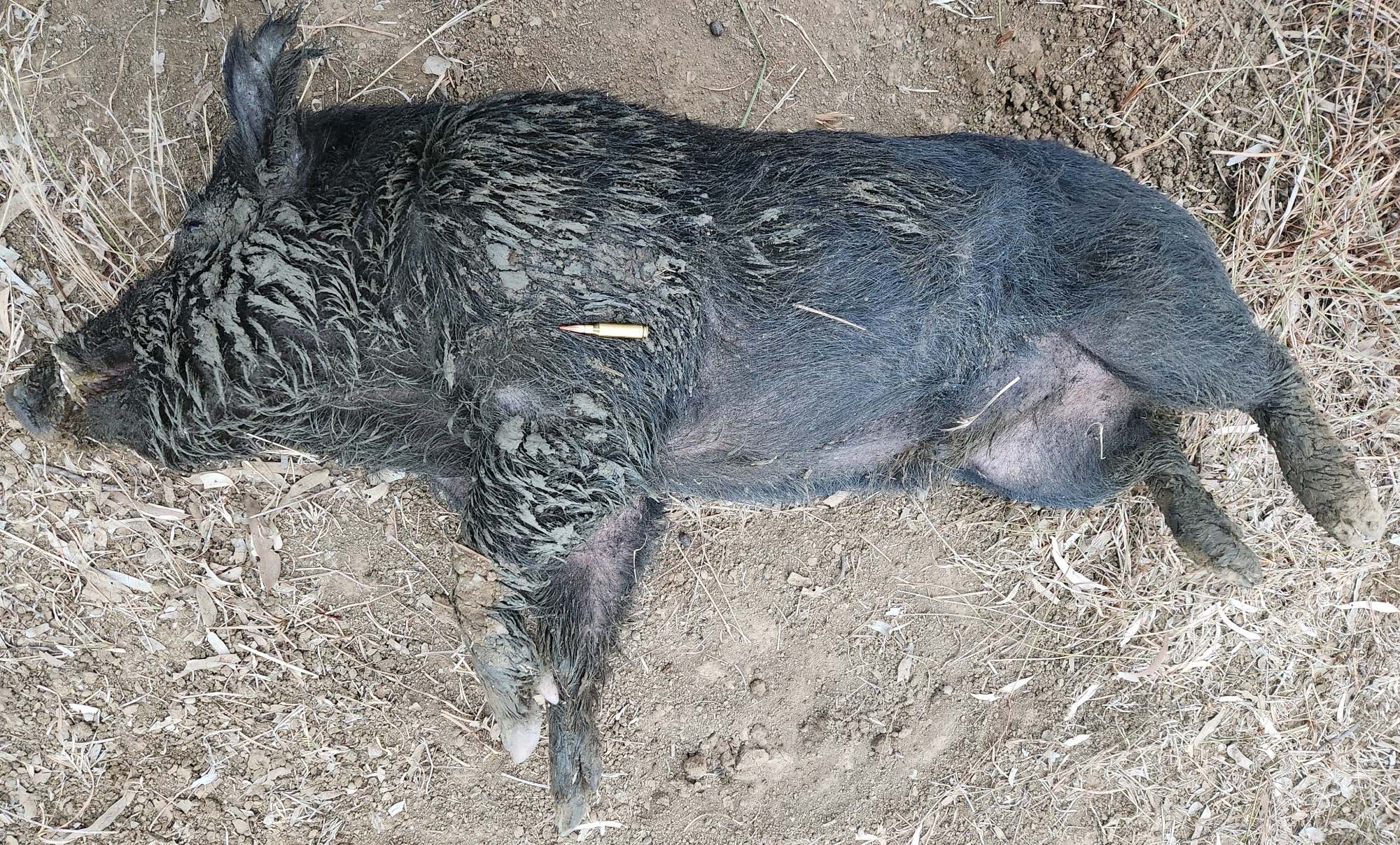

Nailed a large Boar just after sunset yesterday.
~100 metres with the 7mm-08 (120gn Vmax).
~45-50kgs of hot pork; waddling across to a waterhole..
Not a bad set of choppers on him as well.
The 7mm dropped him like a schoolcase...
Amazed to see that the round didnt exit the body.
Hit him in the shoulder(no mud), and it did the job perfectly.
But surprised to see it had stopped before reaching the other side of the pig.
Once I've used up my remaining hundred 120gn pills, I have about 150 of the 139 SST's to trial, which I expect might be a bit more hefty.
Of all my centrefires, the 7mm is the one easiest to tell if I've landed the shot; the loudest 'POKK!!' of any of my rifles.

Any pics?
Any idea of tge velocity of the 120gr pill?

Oldbloke wrote:Any pics?
Yep; Here you go.
Hit him on his other side; about right where the tip of that bullet is.
Last time I chrono'd my 120gn reloads, they were clocking 3087fps at the muzzle, so would've been just over 2800fps on impact.
