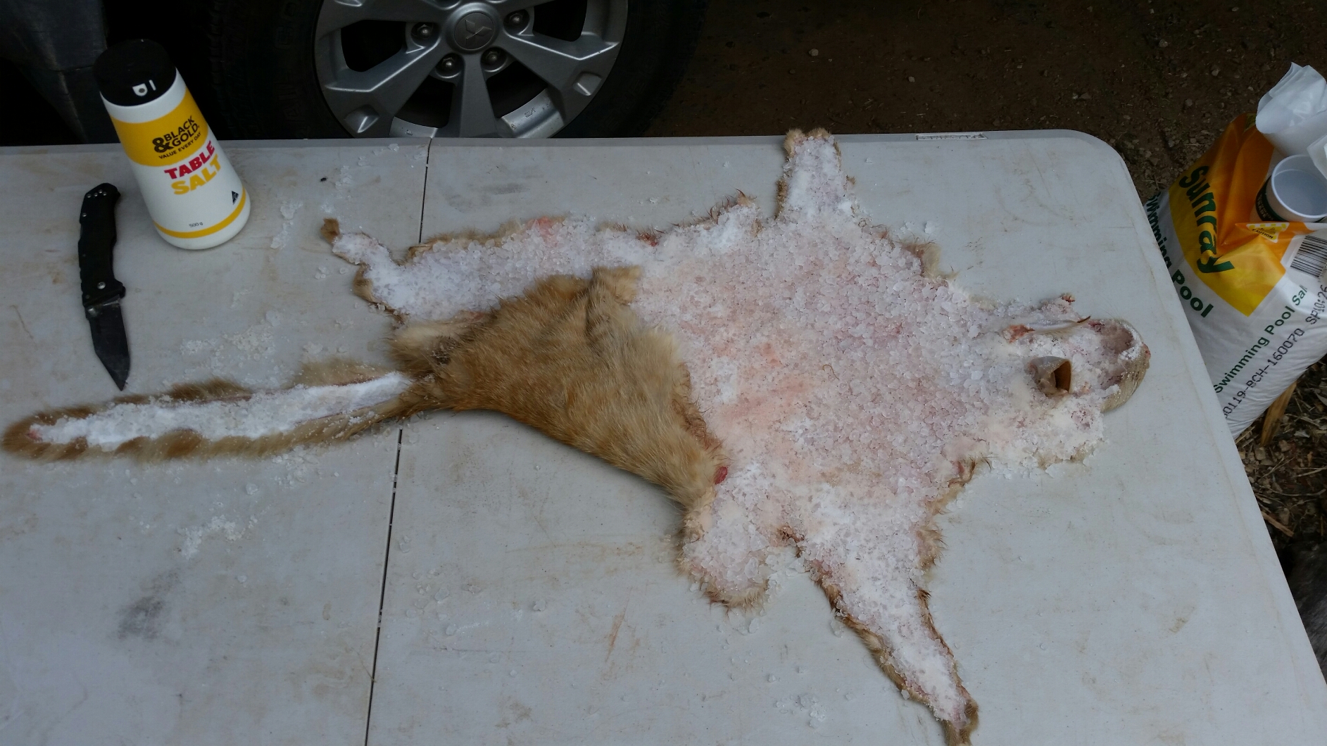

Got myself a nice cat skin on the weekend...apart from not being the nicest skinning job ive ever performed, it looks & feels a nice fur...
Ive never kept a skin/fur before, so what do i do to initially preserve it...?
Its been shot 36 hrs ago & has been in the fridge...
Do i cake it in salt & freeze it for now...?
I know someone recently di d a kid goat skin, & some others listed their tips too, but i cant find the thread...
Any tips to initially preserve it would be great...Cheers

Put salt on the skin and I mean a lot and fold it in half put it on a board on a slant to drain. The next day clean off the previous salt and then put more salt on. You may be able to freeze without the salting have to get info off someone else for that. I try and get them in the tanning solution asap so I dont have to salt.

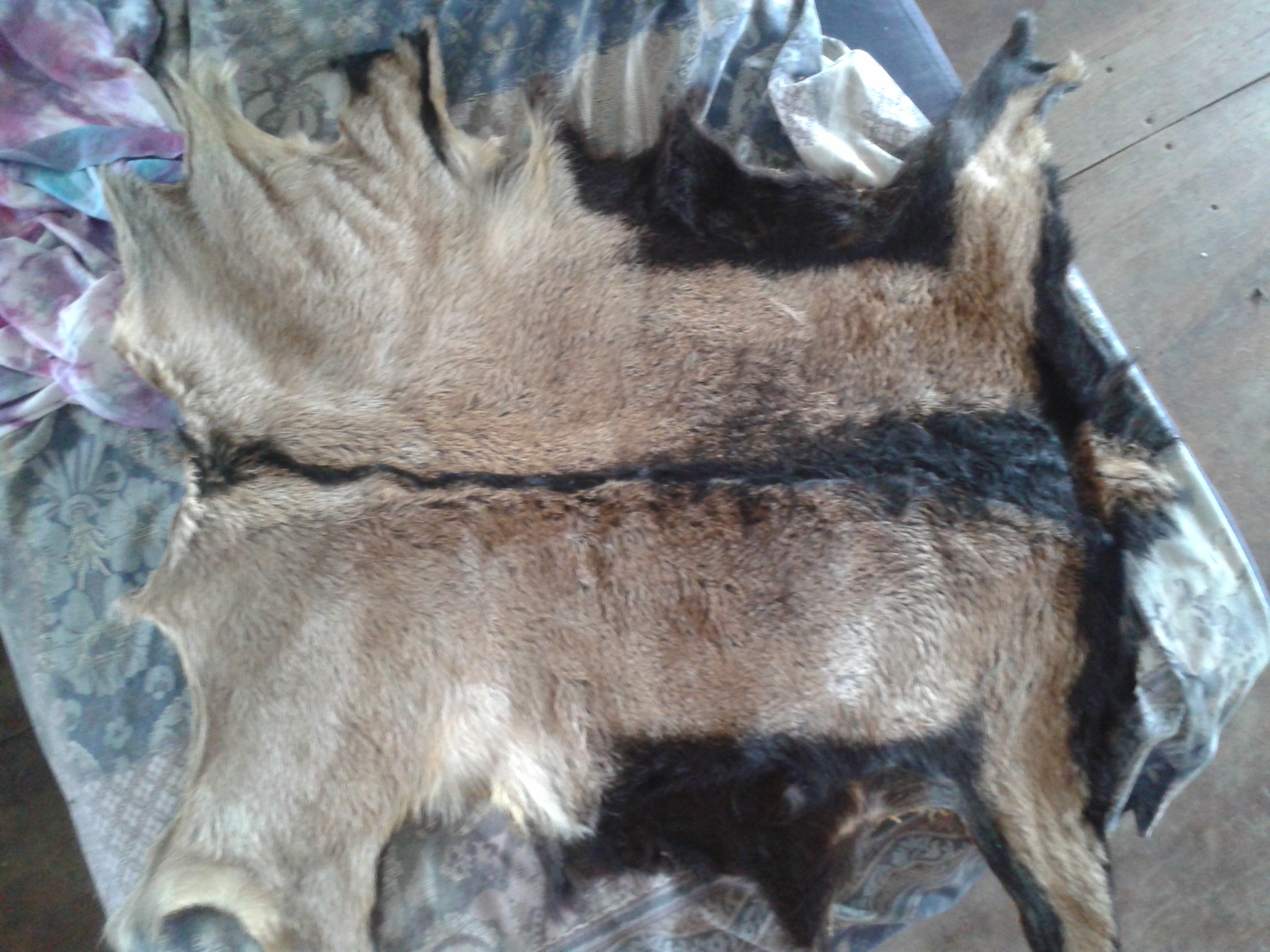

We did that kid by scraping when it was fresh.
Pinned it out flesh side up.
Scraped as much flesh off as we could(paint scraper worked)
Then applied a thick layer of salt (as sungazer said)
Left it pinned out in a shady spot for a week reapply salt everyday (just over the old)
Then scraped most of the salt off before dropping in the tanning solution.
Hope this helps ya stix. :drinks:

Post by Daddybang » 20 Feb 2018, 1:36 pm
Flesh side
Furside
We didn't rehydrate it at all before putting into the tanning solution. Goes to show there really is more than one way to skin a cat!!!(or goat) :lol: :drinks:
Should add we still need to trim the edges. :drinks:

Post by Stix » 20 Feb 2018, 3:39 pm
Thanks guys...
I also rang a bloke who said its too late & the skin will be f#@ked...
But it wasnt very slimy...so he said it might be worth a crack.
This guy is a local tanner, & he suggested to salt AND freeze it...saying the salt kills one kind of bacteria & freezing kills another.
So i shot up to Bunnings n grabbed a bag of pool salt & covered it...
Also grabbed the good ol' Saxa to make sure all the nooks n crannies were covered.
Anyone know what to freeze it in...?
Cotton bag/cloth, pkastic bag, newspaper...???

Post by Stix » 20 Feb 2018, 3:42 pm
Moggie May so far... (she was a pretty young lass).
Salted Moggie
2018-02-20 16.01.39.jpg (1.26 MiB) Viewed 13323 times

Post by Stix » 20 Feb 2018, 3:59 pm
Now ive done that...
Im thinking of just tanning it now...
I know this is lazy in terms of doing my own research, but can any of you folk tell me what i need to get this thing cracking immediately...? (if i get it straight into the tanning solution)
