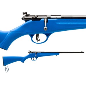

Hi, just wondering why these single shot rifles are banned in The Democratic Peoples Republic of New South Wales?. According to the website they are "PROHIBITED FOR SALE IN NSW"

Too short overall.

Barrel Length: 16.125"
Savage rascal is only 77 cm overall with a 16.125 barrel. not sure may be the reason ?

Ahh found it...
152 Shortened firearms
(1) For the purposes of section 62 (2) of the Act, a firearm is to be considered as having been shortened only if:
(a) in the case of a firearm that is a smooth bore shotgun or a combination smooth bore shotgun and rifle:
(i) the length of the barrel, or, if it has more than one barrel, of the longer or longest barrel is less than 45 cm, or
(ii) the length of the stock is less than 30 cm or it has no stock, and
(b) in the case of a firearm that is a rifle, not being a combination smooth bore shotgun and rifle or an air gun:
(i) the length of the barrel or, if it has more than one barrel, of the longer or longest barrel is less than 40 cm, or
(ii) the length of the stock is less than 30 cm or it has no stock, or
(iii) the overall length is less than 80 cm, and
(c) in the case of a firearm that is an air gun:
(i) the length of the barrel is less than 30 cm, or
(iii) the overall length is less than 70 cm.
So in NSW, a firearm rifle must be at least 80cm long.

From the Act 62(2)
(2) The regulations may provide that certain kinds of firearms are to be considered as having been shortened for the purposes of this section only if they (or specified parts of them) have prescribed characteristics.
Important part here is "considered", ie it doesn't matter if it came OEM or not that way, if it is shorter than the regulation allows for then legally it is shortened.
As for the table, the important thing is
    Not shorter than 80cm overall
    Barrel not shorter than 40cm
    Stock not shorter than 30cm
(As you know, 30cm + 40cm = 70cm so if you had a 30cm stock, you must have at least 50cm forward of the trigger to be legal)
