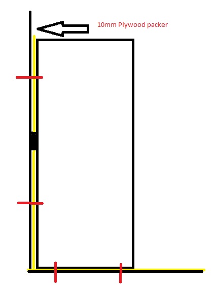

Post by Gamerancher » 06 Mar 2019, 7:25 am
Bolting to both the wall and the floor makes jemmying the safe damn near impossible. It 'aint that hard. I'd put it where you said you have masonry wall/concrete floor.
Put a 1cm plywood packer above and below the "decorative line", ( which I assume is brick ), and put 2 dyna-bolts into the wall.
Then put 2 or preferably 4 bolts through the base into the concrete floor. Job done.
Safe installation.jpg (21.02 KiB) Viewed 9820 times
