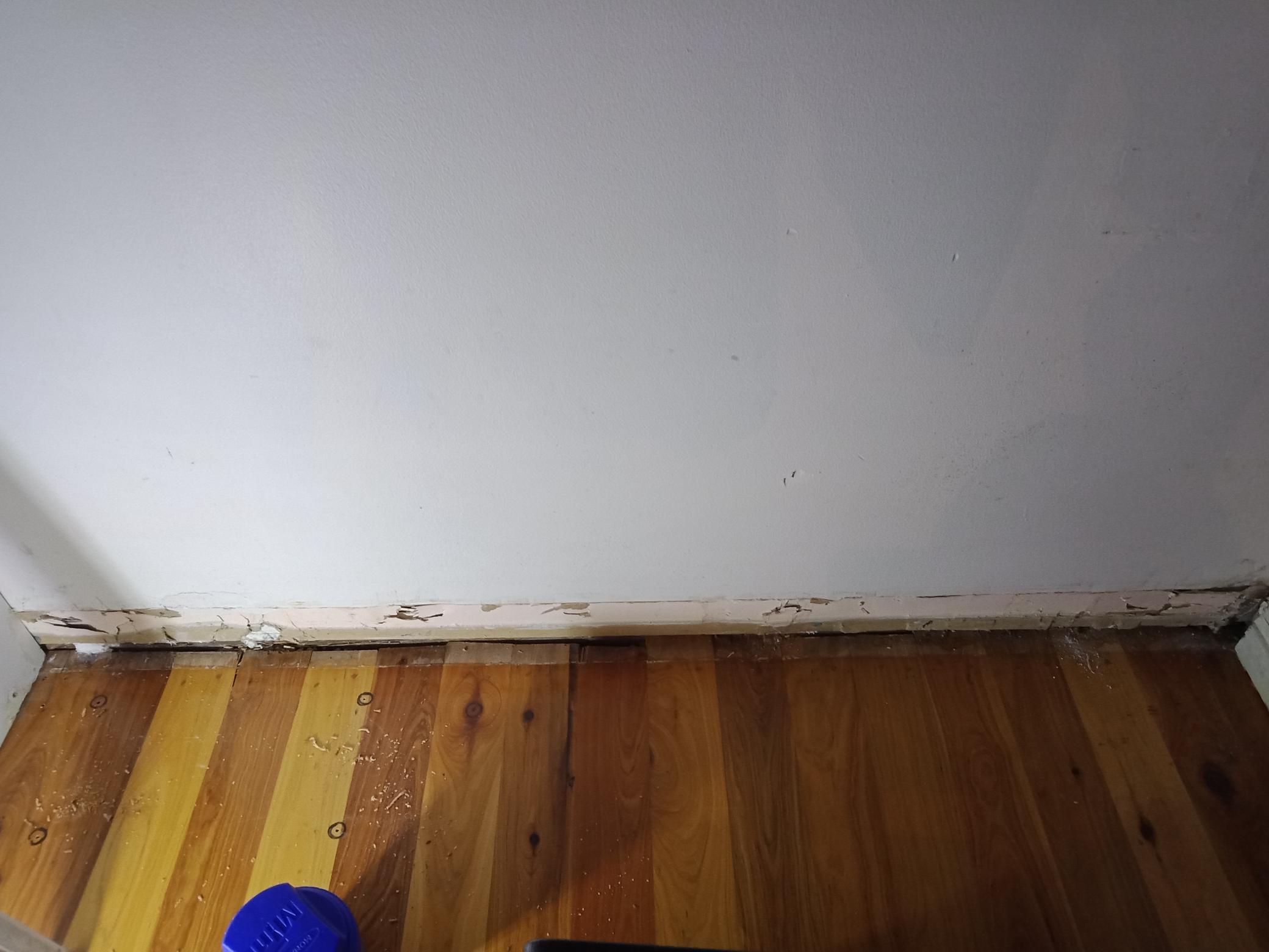

1) If your wall has skirting of any kind remove it along the wall of which you are going to place your safe. A chisel & hammer, and crow bar will do the trick. If the safe is going in a corner, measure the length of the safe and then cut the skirting to that length so you can fit the left over piece back against the wall later.

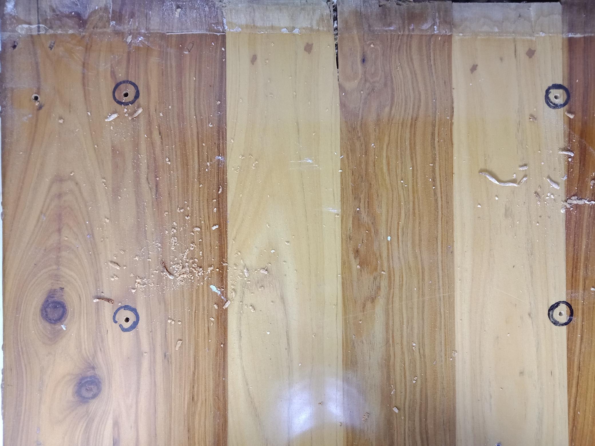

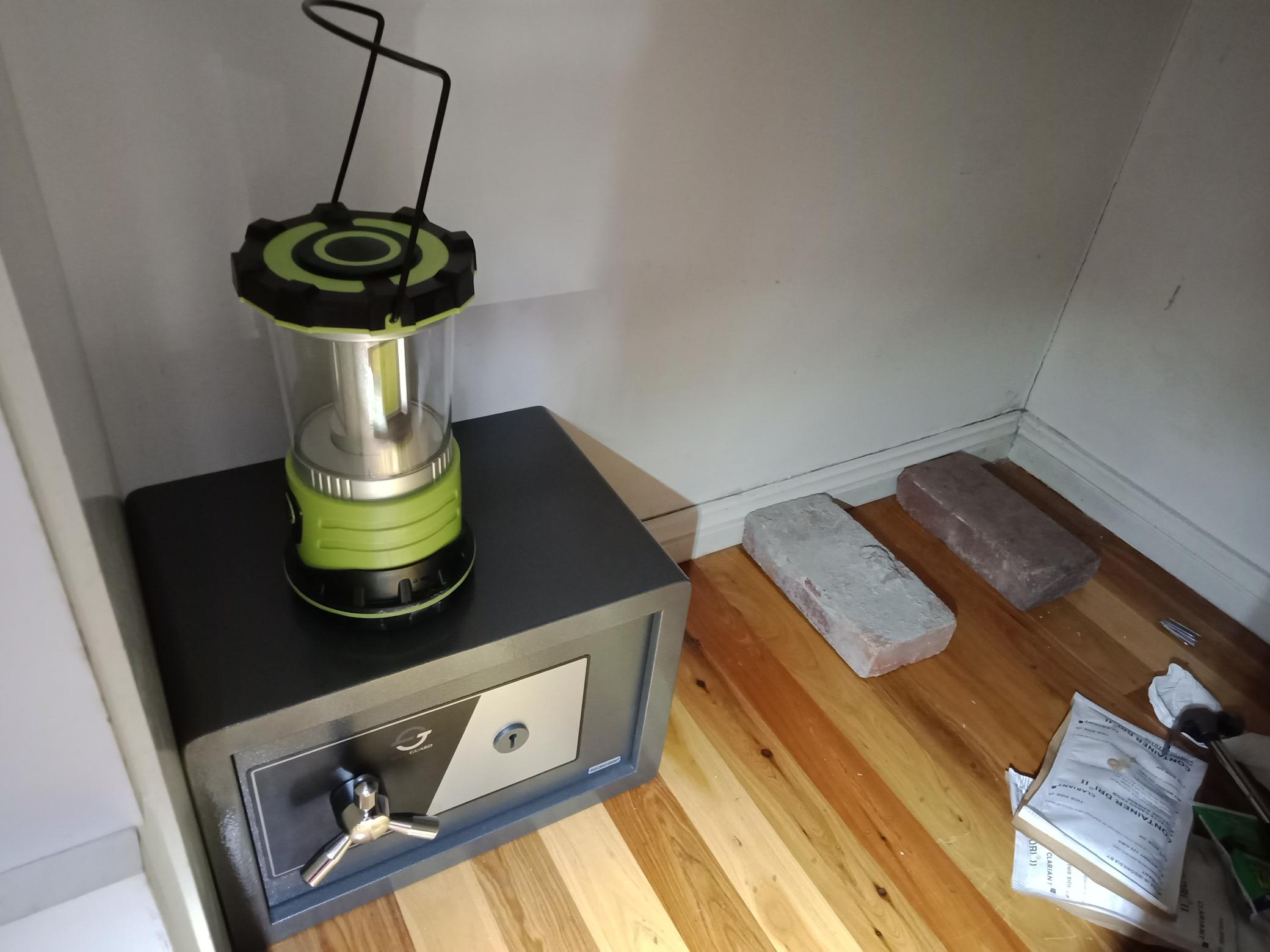

2) Now that the skirting has been removed, you can position your safe flush against the wall and mark out the 4 bottom holes.
3) Move the safe away and use a 3 or 4mm drill bit to make your holes.

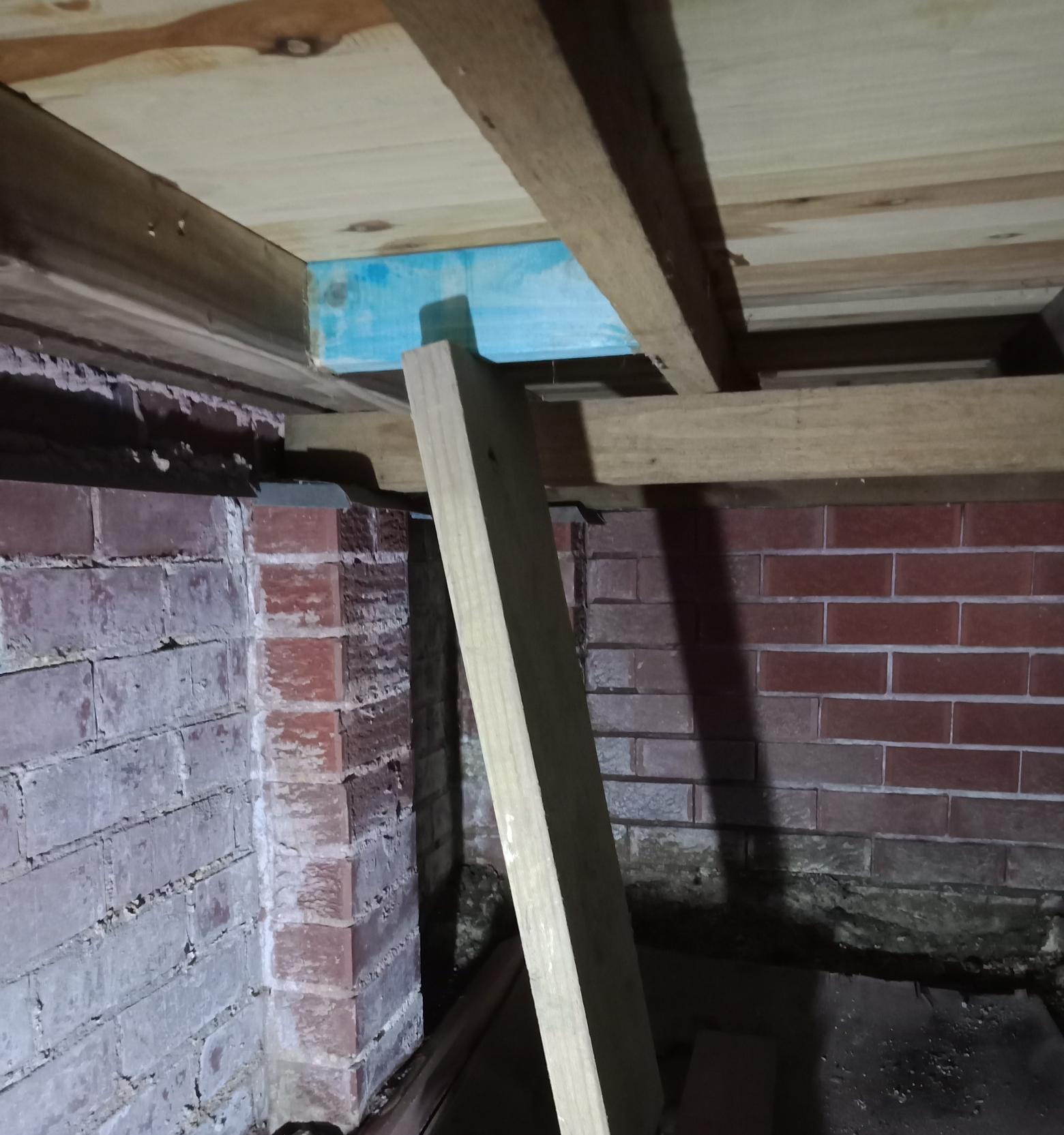

4) Go under the house to locate your floorboard drill holes. Measure the distance between the floor joists, and cut 2 structural timber pieces to that length.
5) Since my safe is going against the wall, (with brick lining under the house) it was not possible to screw the rear end of the cross-bars to the floor joist, so I first applied some Liquid Nails (timber glue) or equivalent to the rear of the cross-bars.
6) Place your 1st timber piece under the first rear and front drill holes. Since the Liquid Nails needs time to set, wedge some timber underneath to stop it from falling out of place.
7) Pre-drill 2 holes in the joist. Keep in mind that this wood is extremely hard so pre-drill using a drill bit that is the same width as the screw and no less, to avoid getting your screw stuck! I used 75mm screws. Use a hand held screw driver because it’s going to be a tight fit!
8) Repeat steps 6 and 7 for your second cross bar. Wait a day or 2 for the timber glue to set.
9) Go over your 4 floorboard holes with a 6mm drill bit. A depth of 50mm should be enough to go through the floorboard, and slightly into the new cross-bars.

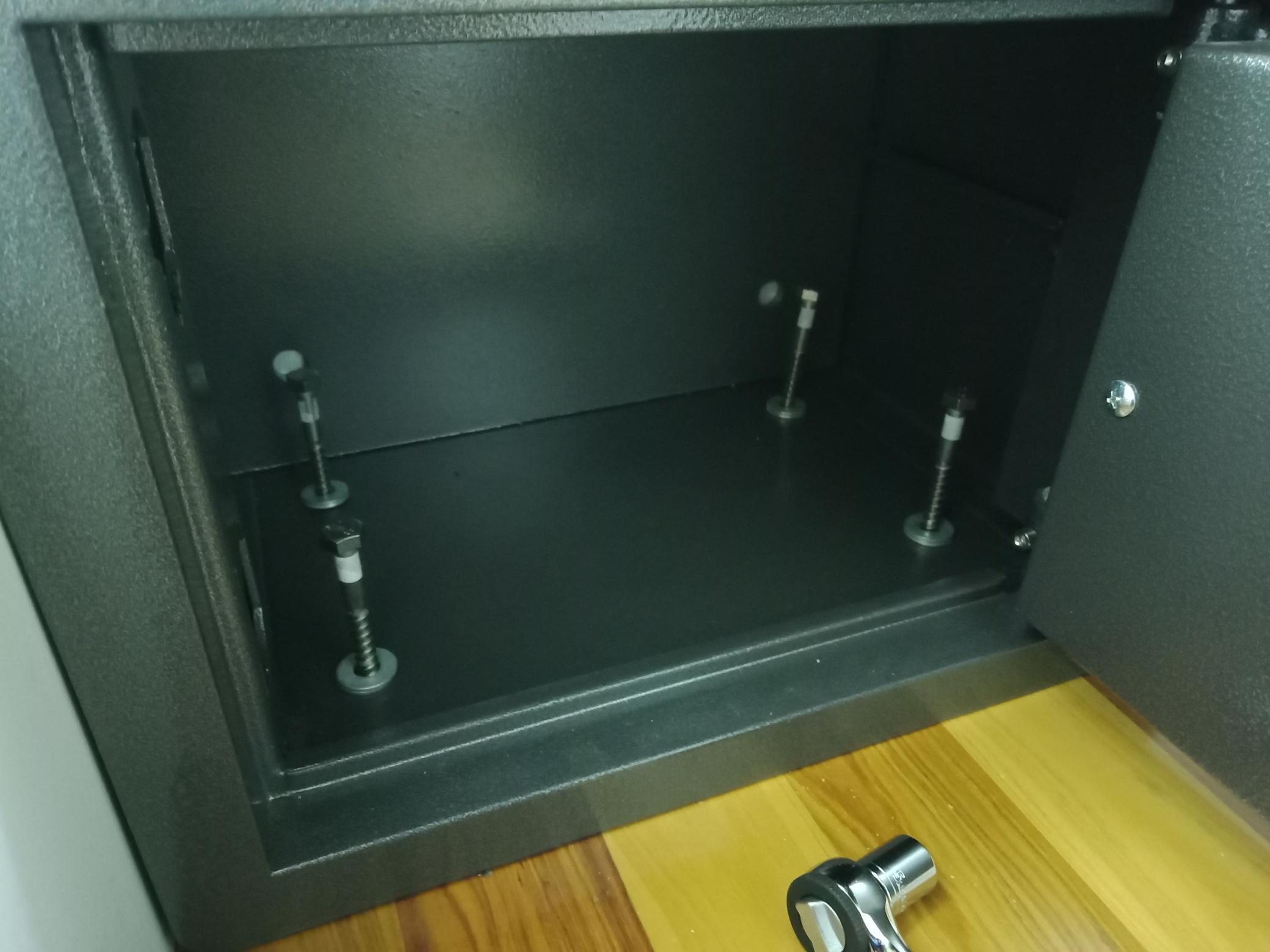

10) Put your safe back in place and use a compliant coach screw (I used M8X75mm) and washers to secure your safe using a spanner or ratchet. Again, this will be a super tight fit and won’t go in like butter so take your time. Your safe should now be rock solid.

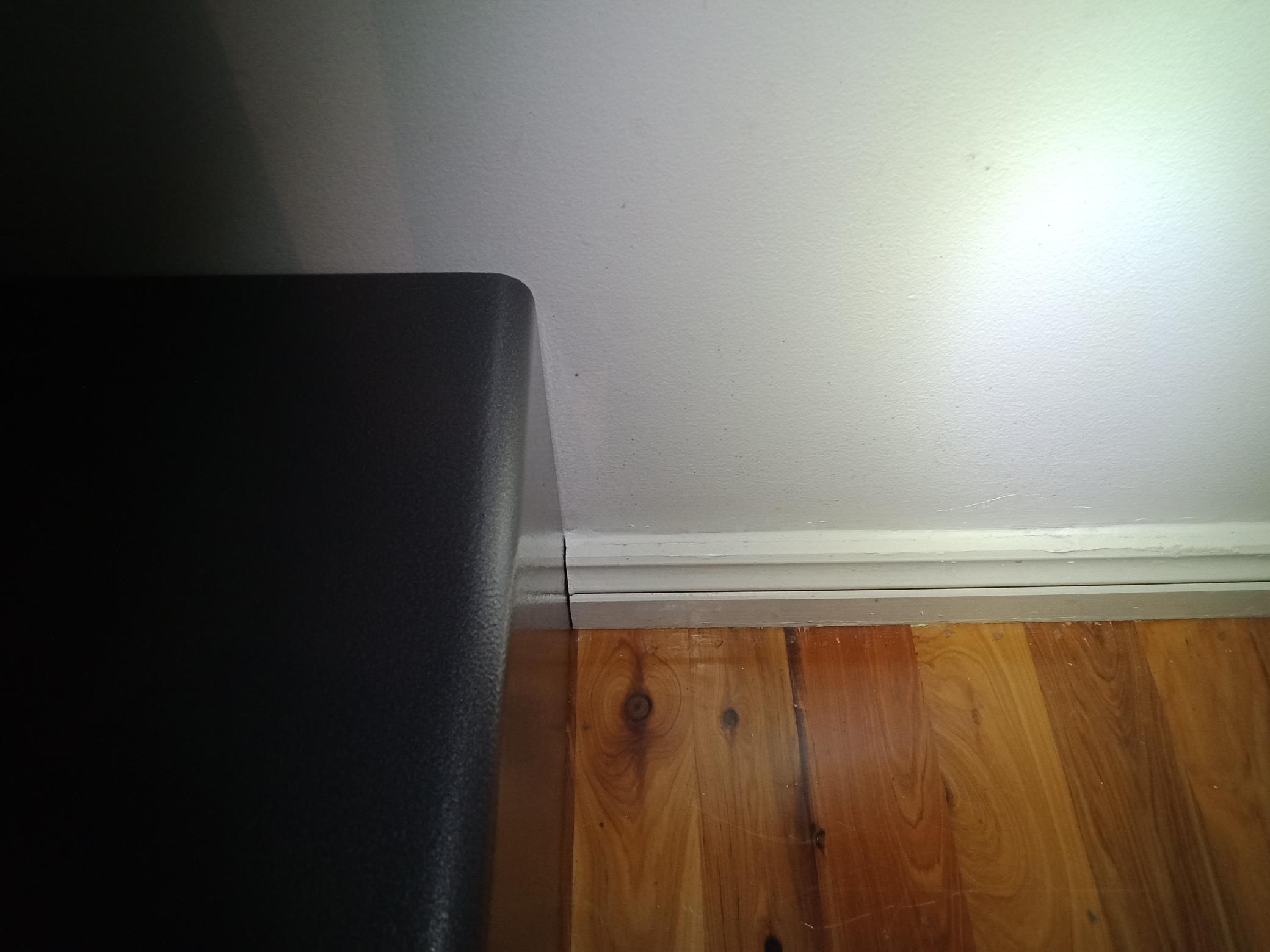

11) Take your left over piece of skirting and put back on the wall. If the skirting was originally attached using nails, remove or cut/file them down first. I used liquid nails to reattach to the wall, and used a white filler to bring to a clean finish.
