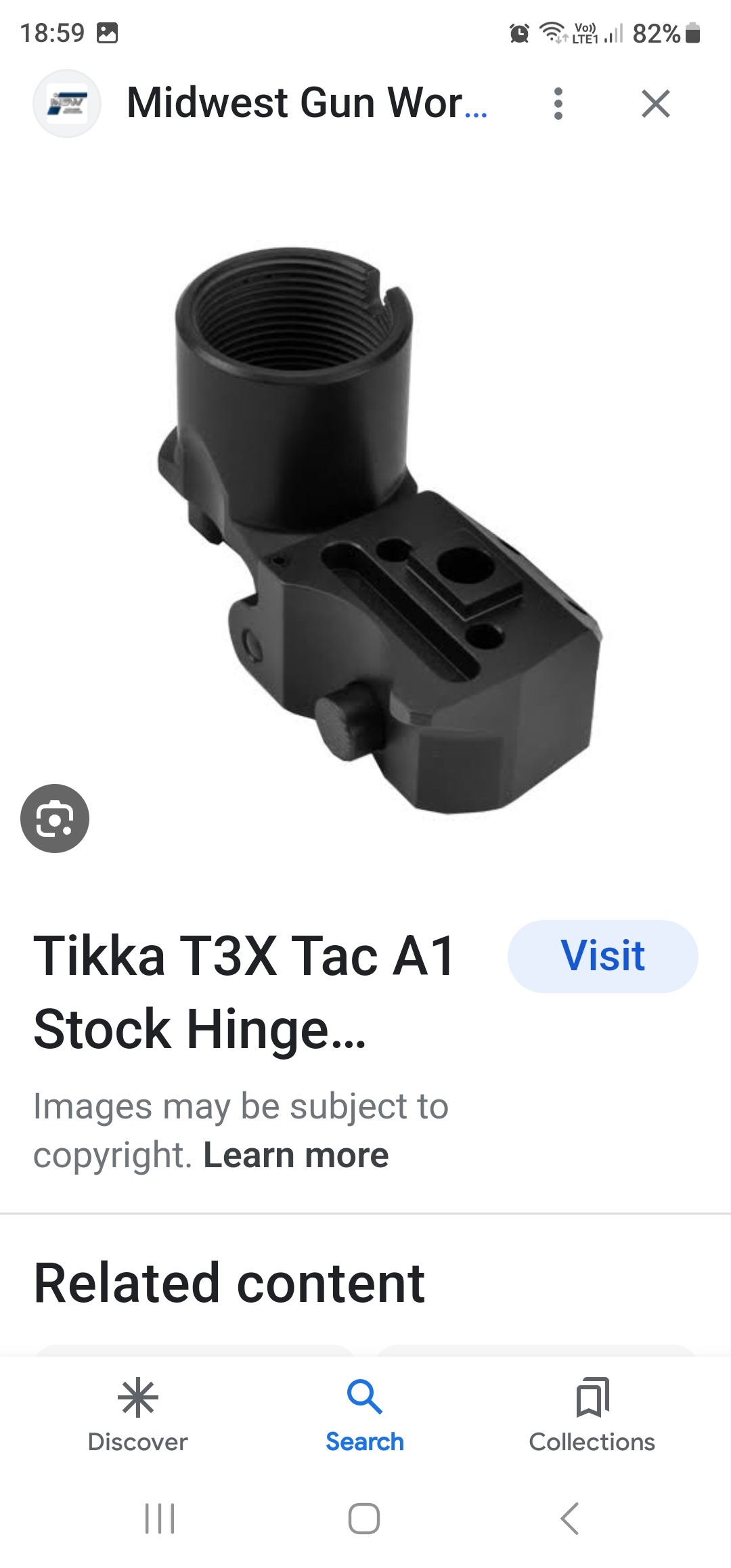

Post by deye243 » 17 Jun 2023, 7:17 pm
You have this
You need the ridged part I don't know what it's called my google fu is crap

Post by deye243 » 19 Jun 2023, 6:42 pm
After you remove the Cheek piece
