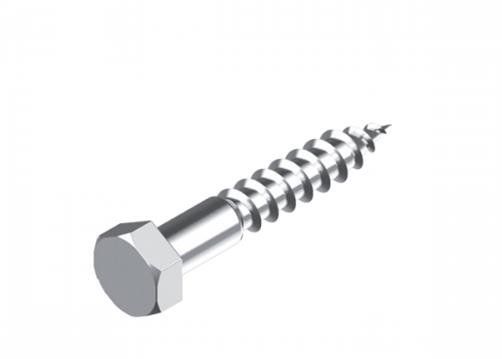

Post by yoshie » 10 Feb 2021, 5:52 am
Rider888 wrote:
Oldbloke wrote:Yes, I know. Is it a house, high rise unit double story etc?
I just dont get how 4 screws into timber upstairs is as secure but this is due to my inexperience
Coach bolts are quite secure, just make sure you get a stud or noggin
yoshie
Posts: 676
Re: Safe storage suggestions
Post by Oldbloke » 10 Feb 2021, 7:56 am
yoshie wrote:
Correct.
Where your drilling into slab there must be a rio overlap. Other wise would be no problem.
Cant do up stairs or another location on the slab?
