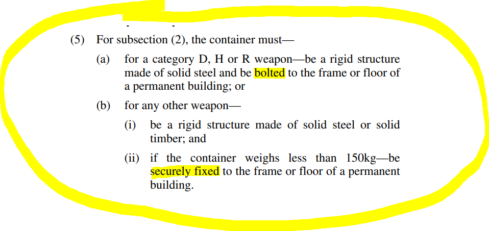

I suggest you learn the law. It does not say it must be "mounted" as you claim it says "securely fixed". Only category D,H or R firearms must be bolted(regardless of the container weight). Category A,B,C,E,M only have to be securely fixed to the frame or floor of a permeant building if under 150kg. You can see the difference in wording so securely fixed can be a simple as nailing into the wall just so long as it doesn't rock around.
Weapons regulation 2016 section 94(5).
Also a gun safe is referred to as a container.

WLB are not the law. They do not provide legal advise. There is also no case law on the matter.
The wording of "securely fixed to the frame or floor of a permeant building" is rather clear in my opinion. It just needs to be be secured to the structure by any means. Could be as simple as a nail through the container and into the gyprock. Or even a steal chain linking the container to a secure point of the structure. It does not need to be complicated. Just drill into the floor or wall with screws or bolts and be done with it. Or buy a container over 150kg.
