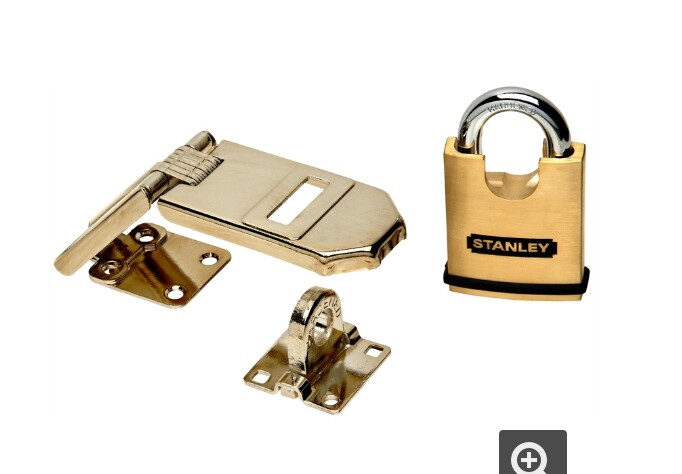

Workplace clothes locker with lock and hasp. Similar to this.
Harsp and lock.jpg (38.05 KiB) Viewed 9119 times
Re: Storage of firearms and ammunition in Victoria
Post by bladeracer » 27 Jul 2017, 10:57 pm
Oldbloke wrote:For firearms. A & B if I understand correctly.
I know for a fact it was passed as OK about 5 or 6 years ago.
Wow, I never would've thunk it.
