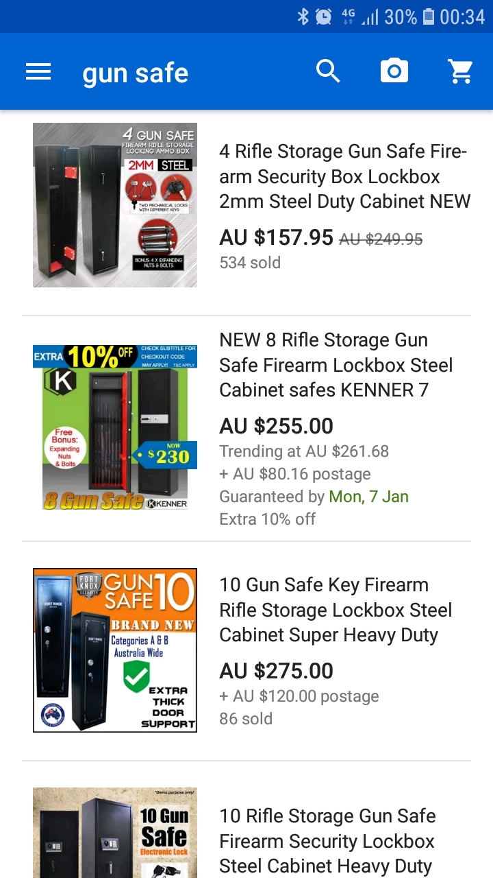

Post by Chappo » 31 Dec 2018, 10:42 am
https://www.ebay.com.au/itm/14-Rifle-St ... 0722458890
I bought this one as my first safe.
I am very happy with it. It’s probably not quite as sturdy as a spika or lokaway but it’s HEAPS stronger than a tool cabinet or school locker.
I like the keypad entry too as I feel it’s more secure than hiding the keys somewhere for someone to find.

Post by Blutius Maximus » 31 Dec 2018, 2:45 pm
I don' think it Vic that it needs to be a 3 point locking system (though my steel safe is).
Is that a requirement in NSW?

I’ve literally just been scanning eBay - pretty funny when your looking at the 20 gun safe they advertise on there - they show you a picture of the safe full of firearms - full to the max...but if u count up the firearms, they only managed to get 8 in there....misleading much?
Re: Beginner gun safe question
Post by Sergeant Hartman » 01 Jan 2019, 7:32 am
Ebsy safes. .... two words i won't mix together.
But currently if you buy anything over $120 you can get a 10% discount voucher from ebay.
