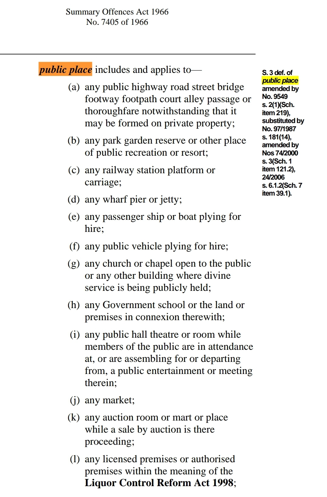

What's a public place.jpg (539.3 KiB) Viewed 13884 times

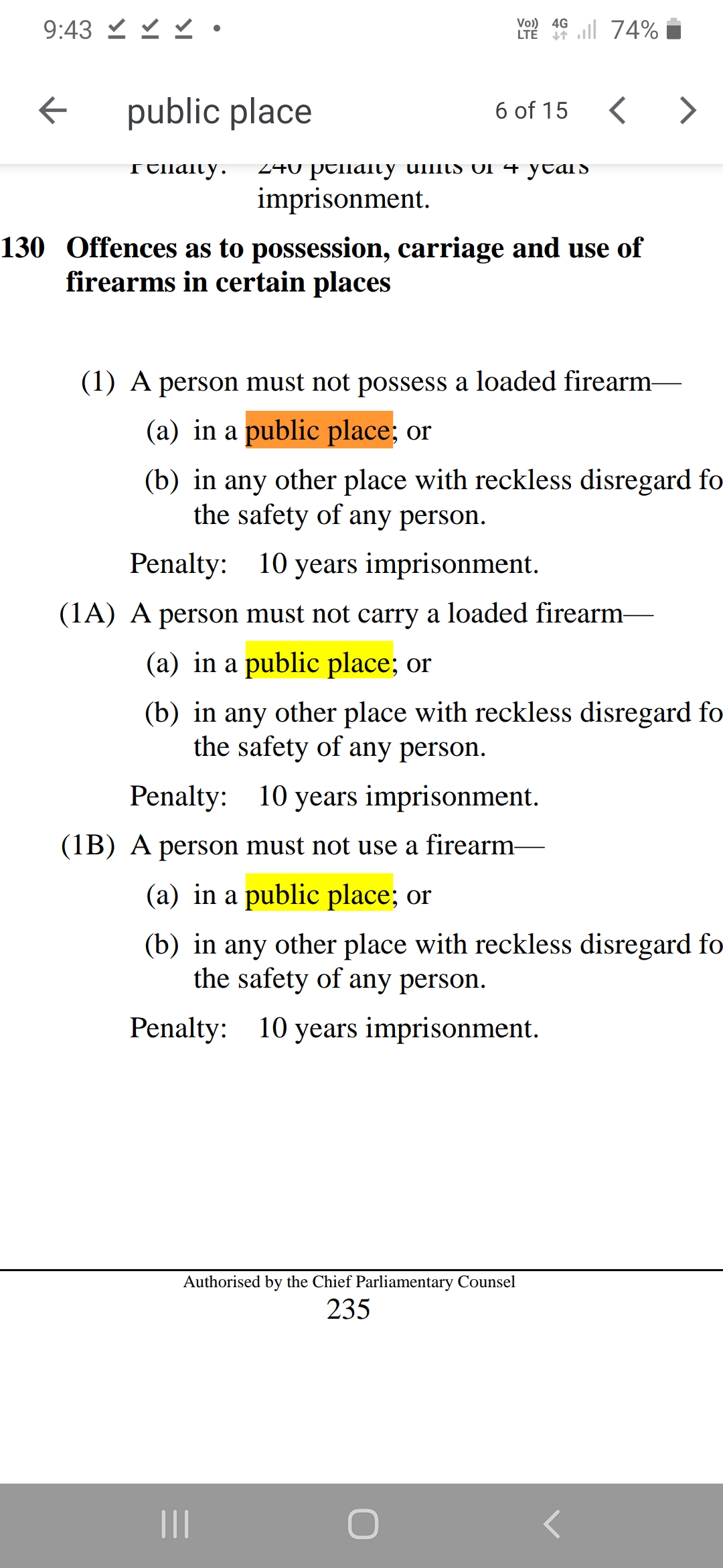

Publics place.jpg (587.02 KiB) Viewed 13883 times
Very, very restrictive.
And, yes. Get spotted and the boys in blue will arrive as quick as a flash. And watch out if he got a knock back that morning.

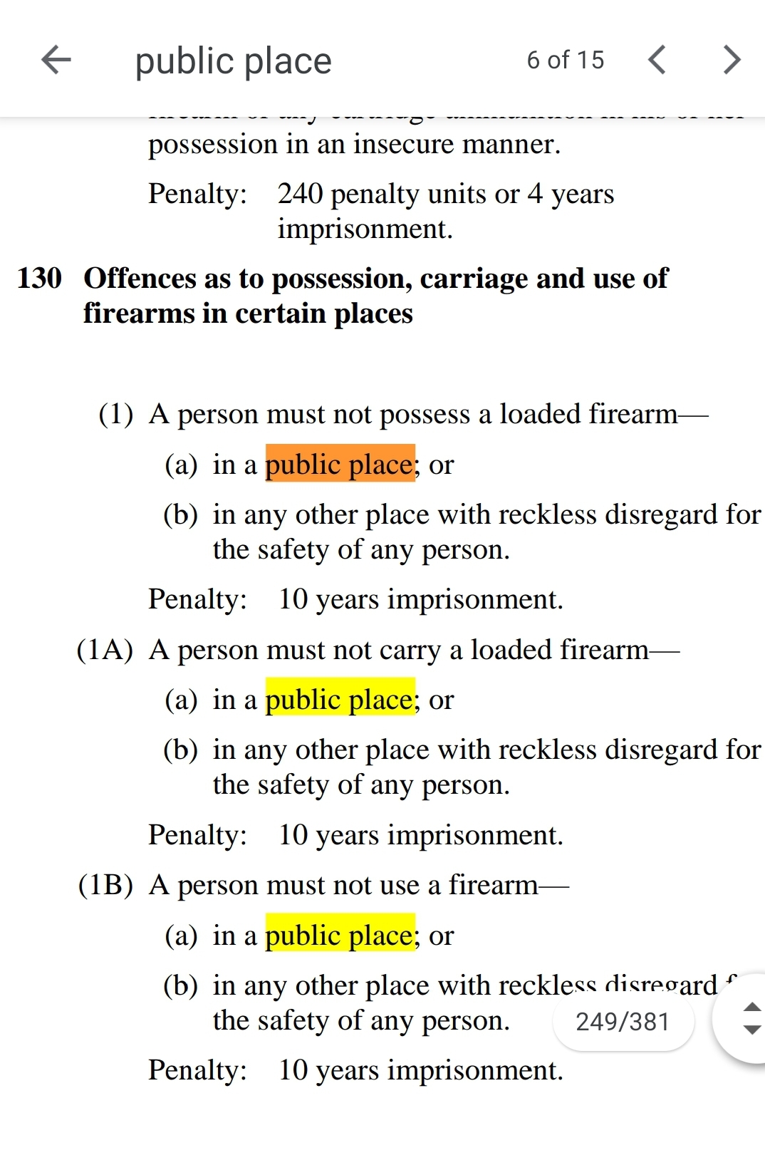

Cannot carry.jpg (500.33 KiB) Viewed 13884 times

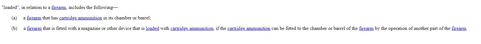

Post by bladeracer » 02 Oct 2020, 10:50 pm
Fionn wrote:
winton wrote:Can you supply any regs for VicPols interpretation that a loaded mag in you pocket counts as a loaded firearm? What about in your backpack? It just doesn't make sense to me. Where else are you going to put a mag if not in your pocket? Seems like a stretch.
Section 130(7) of the Firearms Act 1996.
I can't see anything there stating that a loaded magazine that is not inserted into the firearm is counted as a loaded firearm.
Loaded mag is not a loaded firearm unless installed.JPG (33.86 KiB) Viewed 13778 times
It specifically states that it is only considered loaded if operation of a part of the firearm transfers ammunition into the chamber or barrel.
"S. 130(7) inserted by No. 2/2018 s. 25(6).
(7) In this section—
"loaded", in relation to a firearm, includes the following—
(a) a firearm that has cartridge ammunition in its chamber or barrel;
(b) a firearm that is fitted with a magazine or other device that is loaded with cartridge ammunition, if the cartridge ammunition can be fitted to the chamber or barrel of the firearm by the operation of another part of the firearm."
Posts: 14002
