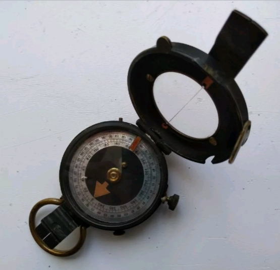

I have a couple of modern compass calibrated for the southern hemisphere of course and keep maps ... you might like the last not so modern one that I've bought. :thumbsup:
1918 VERNER'S' PATTERN MK.VIII PRISMATIC COMPASS

Nice compass OOW! Got some weird and wonderful examples but don’t have one like that in my compass collection.
