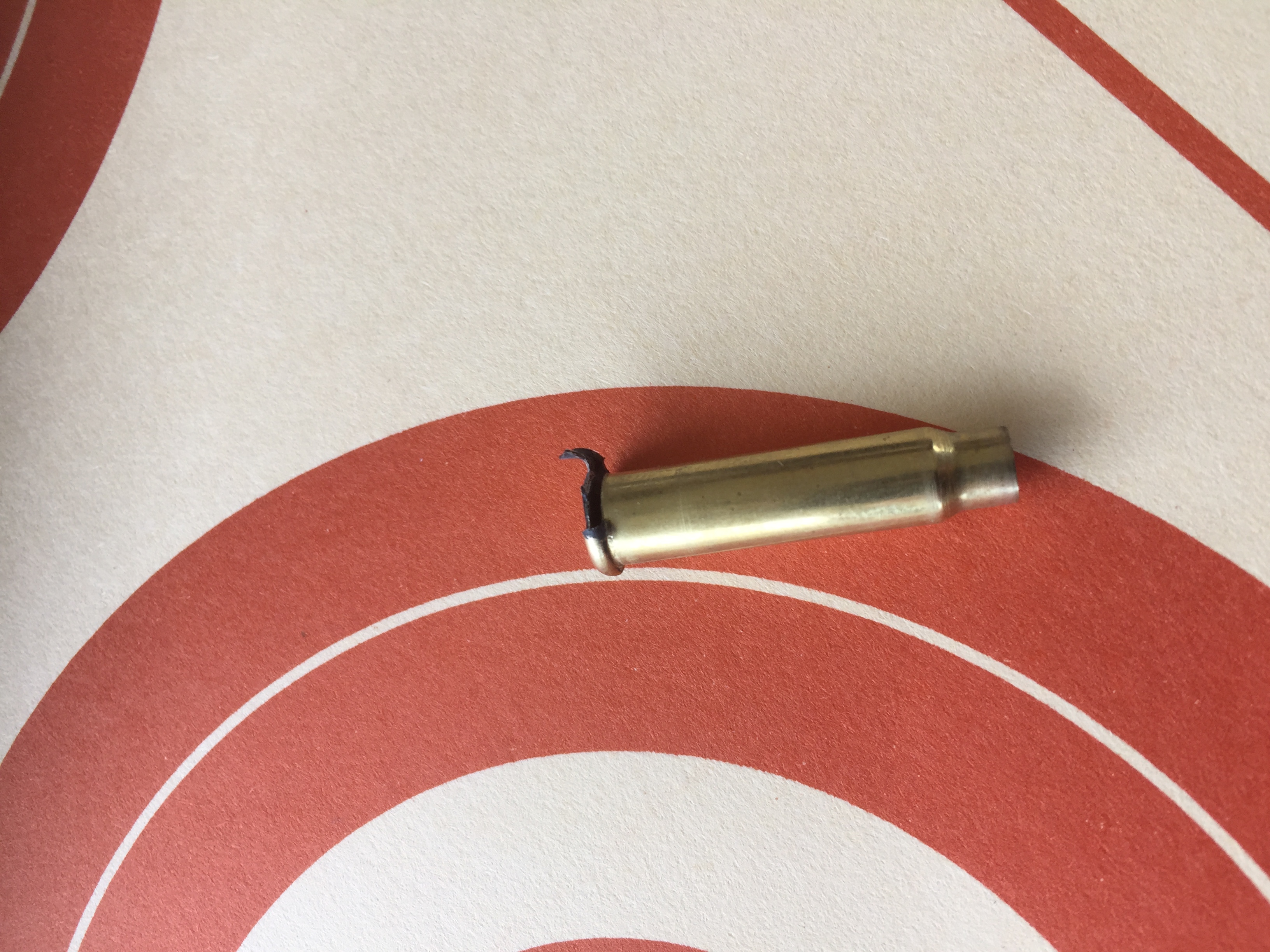

Hey fellas, I was at the range yesterday, tuning my reload recipe for new brass , and the fella next to me had his ruger 17 hmr have a major malfunction. A case split at the base ( head space issues? ) and cracked the stock. He was using Hornady ammo which is usually pretty good. I’ve seen Winchester 17hmr split necks on every second firing, but this is a whole different level. I researched this model ruger when I was thinking about a hornet rifle, but decided against it cause I’d heard on yank forums of head space issues cause of the design of the two piece bolt . This particular rifle had only shot a couple of hundred rounds, the owner had bought it new . Bit of a worry :?
edit , it blew the mag clean out of it too :o
The escaping gases stuffed the stock and gave the owner a good scare. Hurt his hand a bit too
This the case, split badly at the base

the stock was cracked from all the gasses escaping from the ruptured case . most rimfire bolts don't enclose the case like a centrefire , so when the case ruptured the gas vented into the mag well and stock inletting under the receiver would be my guess .even in a hmr there would be enough preasure to cause damage. i was next to a guy on the benches at ripley about a year ago when he fired a 308 round in a 270 tikka . that blew the bolt to peices , that fella is lucky to be alive . this 17hmr rifle belonged to a fellow shooter at the range . never met the man before . i thought i would post this as a heads up to fellow shooters and gun nuts :D
the ammo was hornady , normally very good ammo

i thought that too, got the owner to check and it was clear. i had a look and there was no bulge in the barrel either :unknown:

only thing i could think of , as it checked out negative for any evidence of barrel obstruction . i had researched this model ruger as a possible purchase in 22 hornet about 2 years ago. going on american forums i read stories of issues resulting from the two peice bolt . apparently this model file is converted from a 22lr to 22 hornet /17hmr by using the two peice bolt. headspace and accuracy issues relating to lack of qaulity control were reported . other peoples words , not mine . the fix was to get a gunsmith to shim the bolt to tighten them up

I don't see that the Ruger has malfunction, if anything the dual lugs looked to have performed perfectly. What would the result have been with an inferior CZ action :lol:
I have a couple of 77s and the gas can only get vented to the right and downwards hence a popped mag and cracked stock.
I'm guessing you mate had a squid load prior to get that amount of pressure. Also in my mind the 17hmr split case issue show that the 17wsm is a much superior round with thicker brass. :drinks:

i ran this story of what happened to this ruger by my local gunshop , and one of the fellas said they had the same issue with a marlin 17hmr . he witnessed it and said the cause was a squib load . winchester ammo was to blame with this case .mystery solved :roll: i don't think i'll be buying a 17hmr in the near future but ....... :P

Agree here. Not a lot of pressure or volume of gas in one of those. I think the squib load theory is a good one. Only way to tell would be to have a good look down the barrel. Opportunity lost now.
