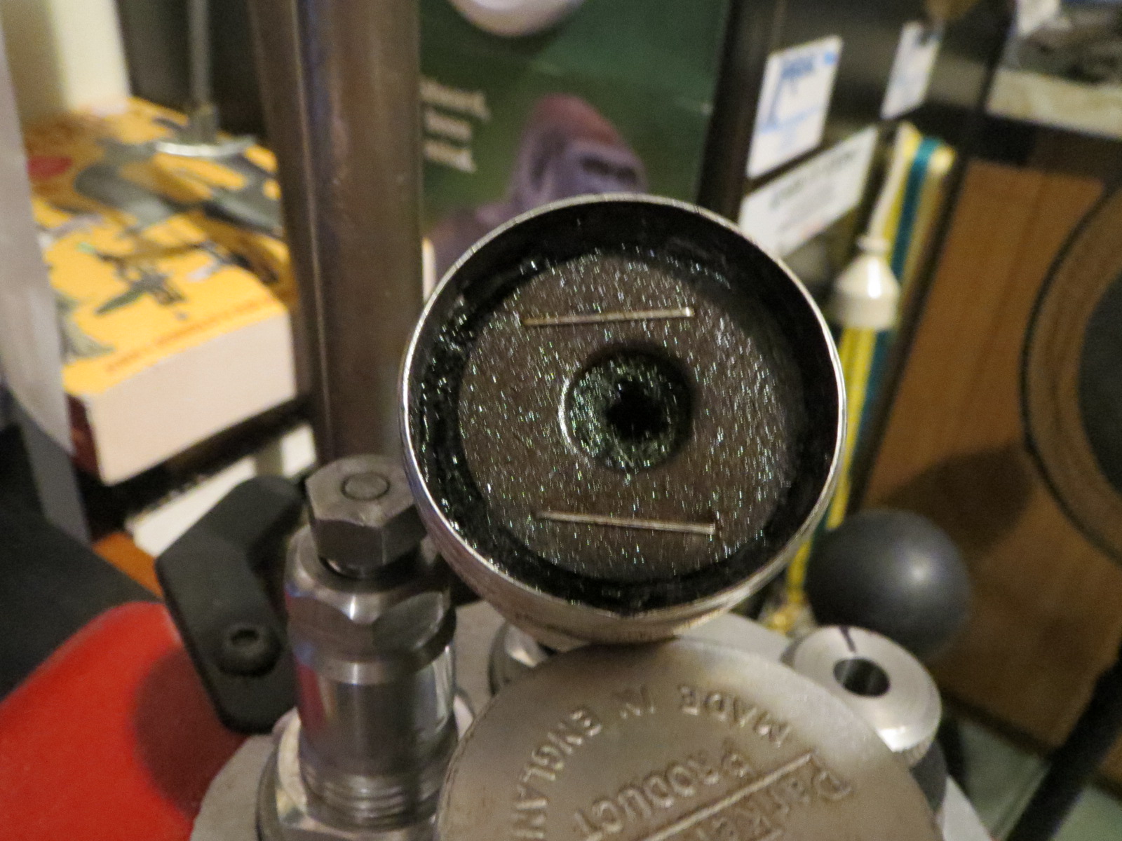

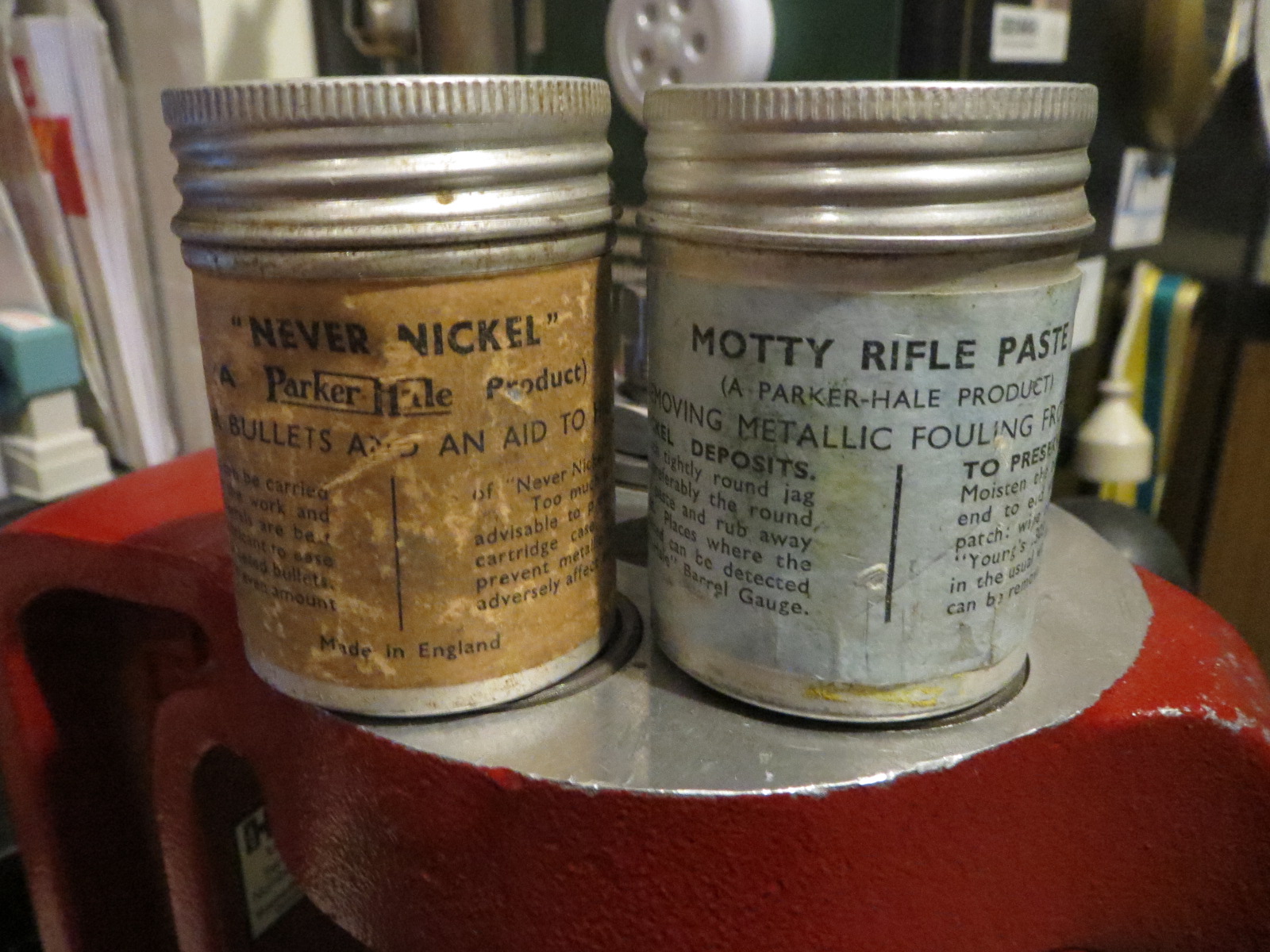

Years ago when I shot fullbore some of us would use products like Parker Hales "Never Nickel", and clean with Motty paste. Never Nickel was wiped on the 303 bullet before loading and is simply Moly Disulphide grease and some additives. Never had a problem with hard cleaning. The other method more common now is to actually coat the bullet with Moly straight over the jacket. Again, never had an issue if cleaned thoroughly except you needed to shoot up to 10 coated rounds to condition the barrel before the next comp. Most of us, myself included, simply used a carbon cleaner and left any moly in the barrel, then cleaned with a high ammonia cleaner like Sweets and start again. One thing to understand is Moly coating does NOT improve accuracy, but it can help slow down the accuracy falling off during periods between cleaning. It is also probably the 2nd most argued subject in Target Rifle, Cheers.
Parker Hale lube 002.JPG (515.11 KiB) Viewed 3350 times
Parker Hale lube 001.JPG (535.38 KiB) Viewed 3350 times

They dont make tins like that anymore No1...
I just love the look of that old stuff...seeing the print on the labels is like being a kid again & wandering through Grandpa's shed ...!!
