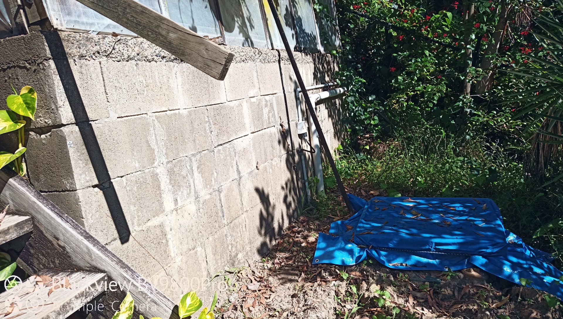

It is built into the side of the ground. North face wall is exposed, the recent is pretty much in dirt. I will post some photos tomorrow.

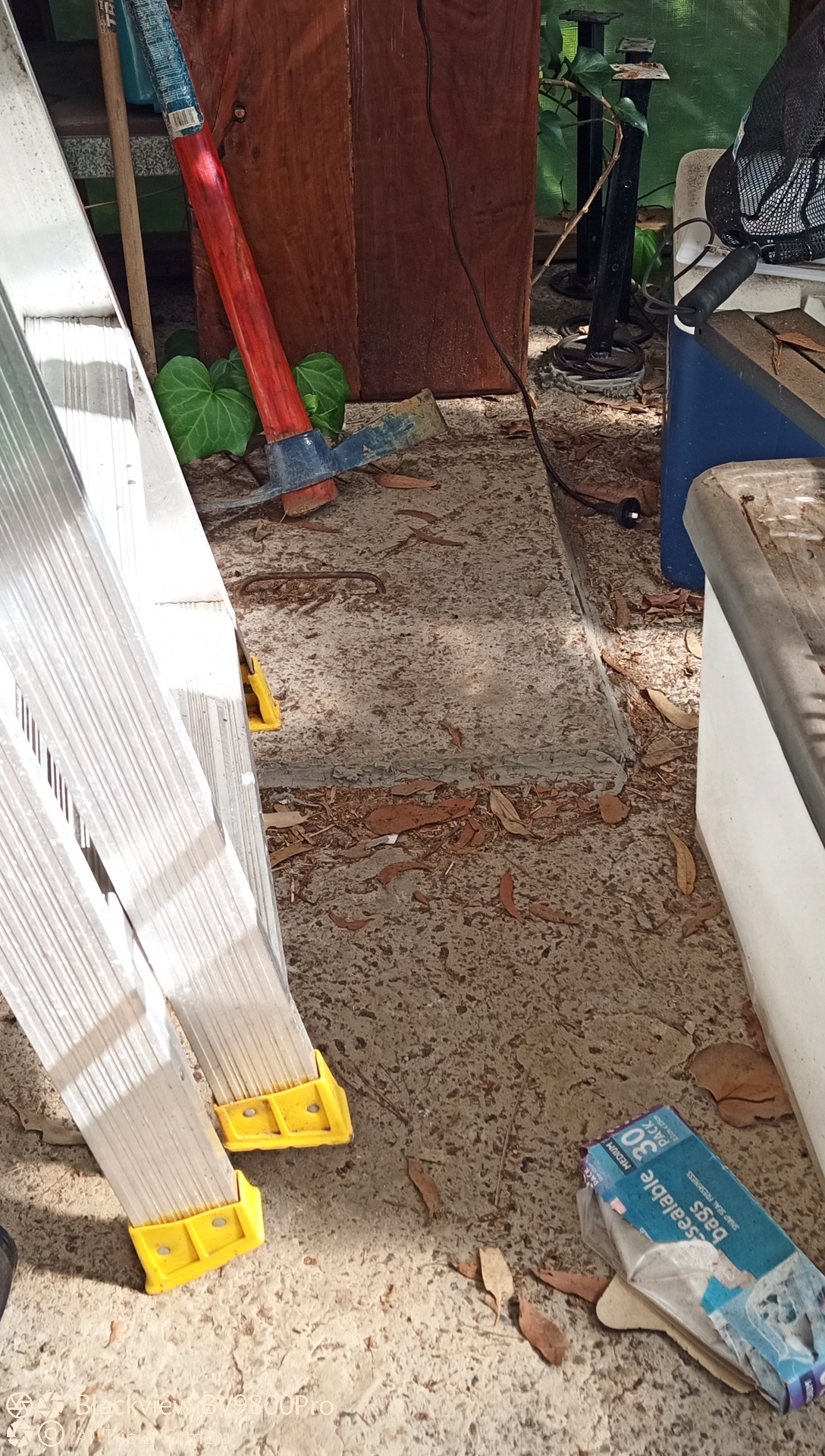

Post by duddley75 » 22 Apr 2020, 10:28 am
Access hole
North wall
