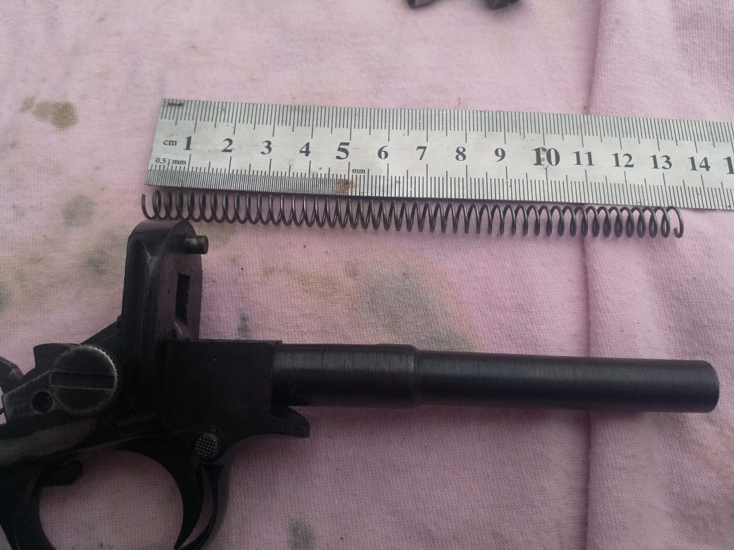

So, been playing around with my Browning/FN trombone. Trigger is quite heavy, and I think it's mainly down to the main/hammer spring being too heavy, placing to much force on the sear.
I want to try putting a bit lighter trigger spring and a lighter hammer spring in it and see how it goes. The hammer moves a fair way forward before it strikes the firing pin, so I'm thinking that leaves plenty of inertia for firing pin to strike the rim. Plus I'm thinking this spring isn't original, not that I can find details on original.
What I need is something around 7.5mm OD, 130mm long type of thing, so much longer than normal springs.
So anyway, just wondering if anyone can tell me the sort of shops that sell springs that aren't your run of the mill short ones you buy at Bunnings? I wasn't sure if it's the sort of thing stocked by fastener/bolt shops, or if bearing and o ring shops would generally have them? Can't find any reference to springs on the websites of those kind of shops locally, and eBay doesn't seem to have anything close that isn't located in China.
I'm hoping to buy locally as I would like to compare to the current spring.
Appreciate any advice you all might have

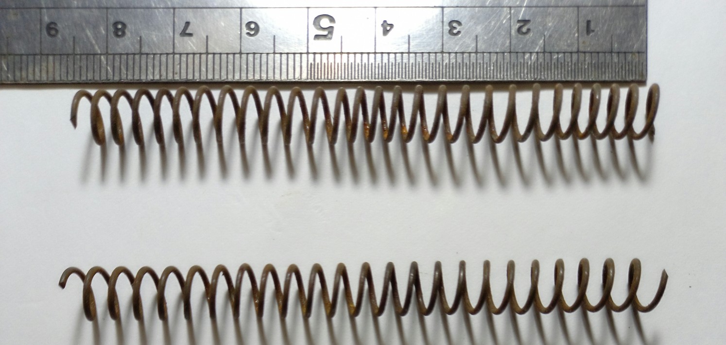

Have you got a pic? Preferably with a ruler beside it. Someone may have something in the shed.

Post by disco stu » 12 Sep 2021, 5:53 pm
Good idea, cheers
Dimensions, in normal logical units is OD ~7.5mm, wire 0.85mm, length is right on 130mm.
I was intending to try something around 0.65 wire diameter and trim it down a bit and see how the trigger is. OD isn't overly important, but it just needs ID greater than 5.5mm

I have these.
5.5 mm ID
7.7mm OD
0.85 mm wire
5.0 mm pitch
Too short but I have 2
You could use both and shorten one. Sounds very close to what you have but these feel soft, easy to compress.

So the local spring maker has closed. The place that has what I need didn't recognise their own part number and sent me on a wild chase of different distributors (not that bad) who don't actually have it in stock so would need to ship from another store. No other places I called locally had any idea where to buy anything close to a spring. How on earth do people make things these days?
I ended up going to Bunnings and buying 4 springs in shorter lengths that fit, but will likely order from China on eBay. Getting ridiculous finding one here for a $3 spring
Anyway, I decided to try a lighter trigger spring in the rifle. This is torsion style, and a safety pin ended up working great trimmed down to size. The trigger spring made more of a difference than I thought it would, but I'm going to test it all back together. I'll make a call then about the main spring
