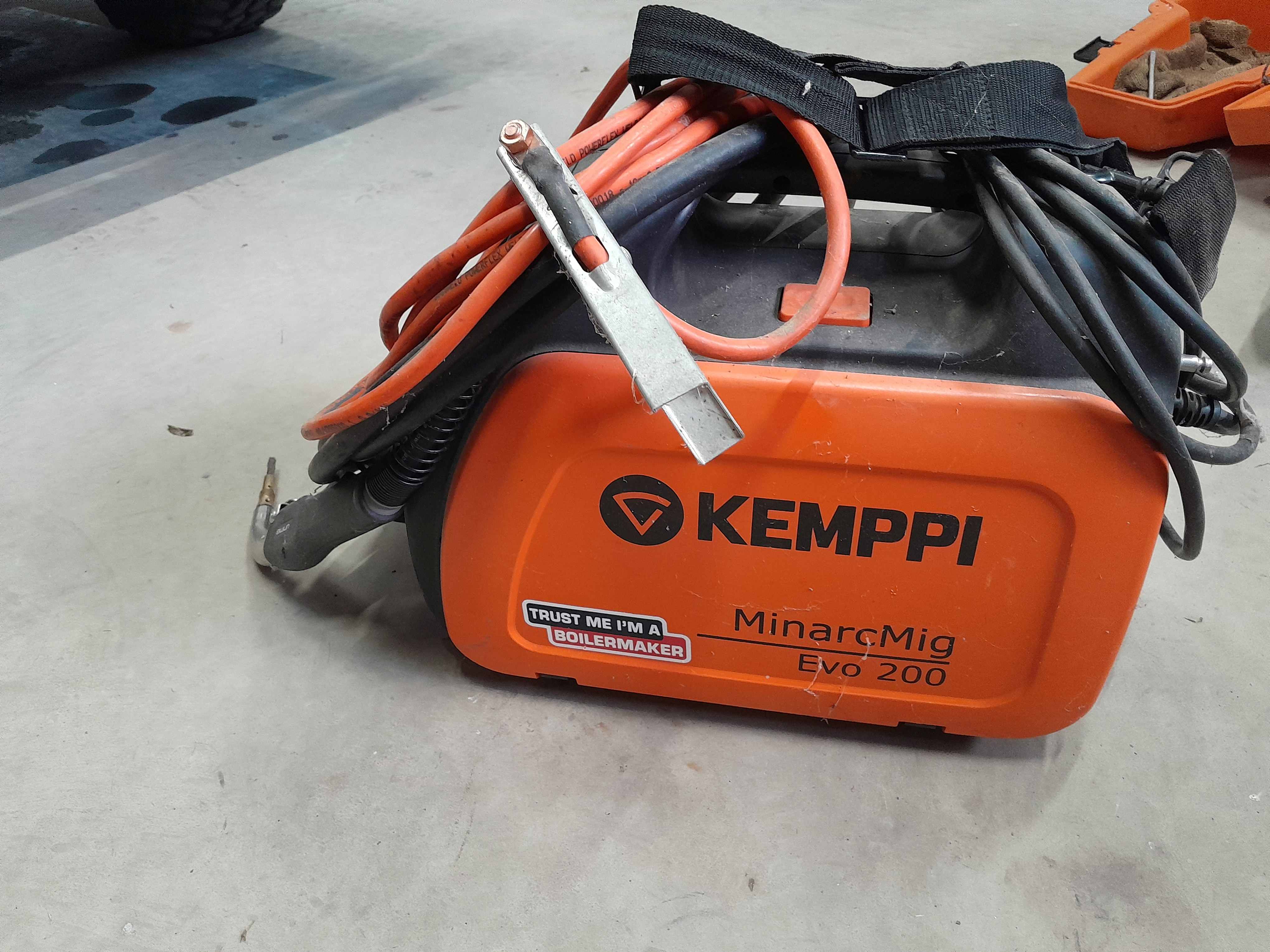

The reason they like it is, it has programmes in it where you pick the wire, the material, the thickness, and go weld. THAT is like a ballistics program for shooting, it's never correct.
Now I have a Kempi, it's a great light little thing. I don't use it off the back of a truck because it's full of circuitboards that fry when they suck in grinding dust, or any dust, and het dry solder-joints from bouncing and vibration in a ute tray.
The Kemppi. All of my migs have 5m guns for reach, this one has a quick-disconnect gun, extra-long earths and I run 5kg rolls in all.
The beauty of the Kemppi is that it will run on a 10-amp powerpoint or small genny, and has such great electronics it will not suffer voltage drop on a 30m extension-lead.

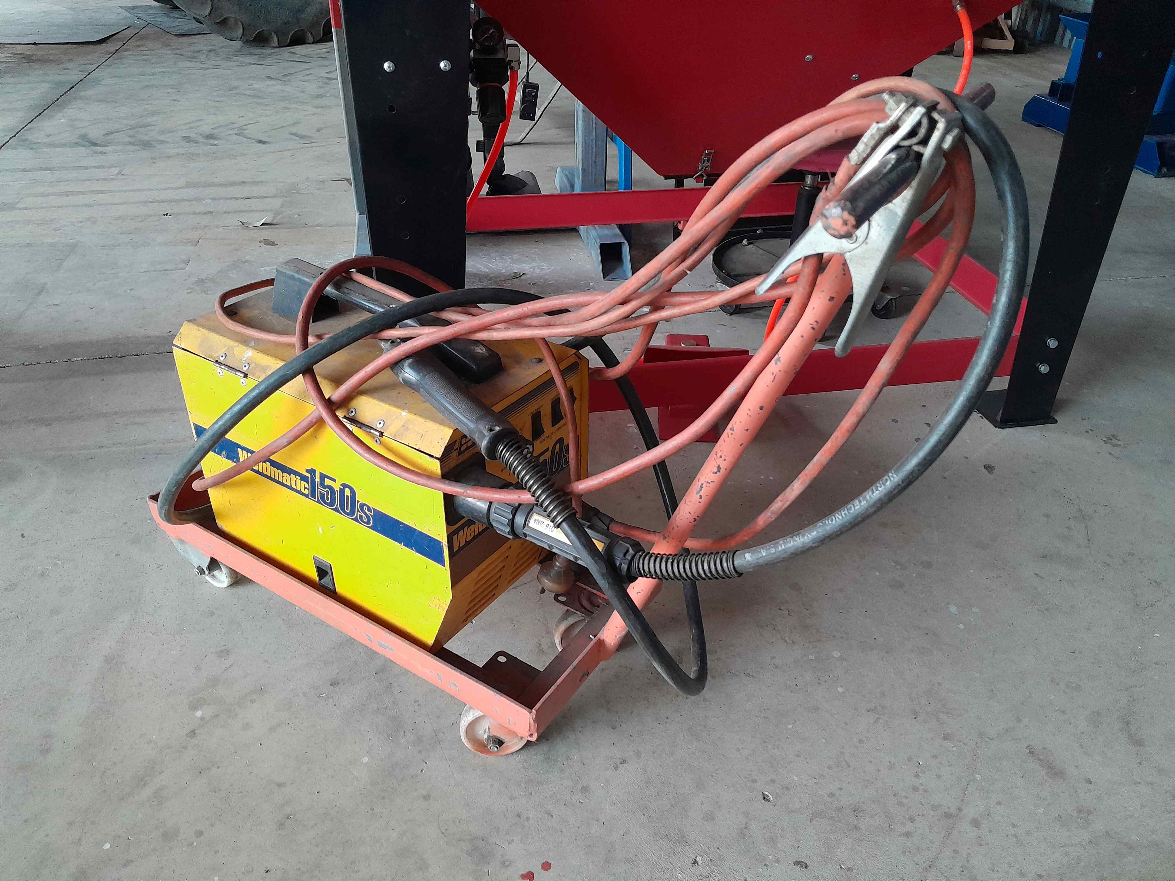

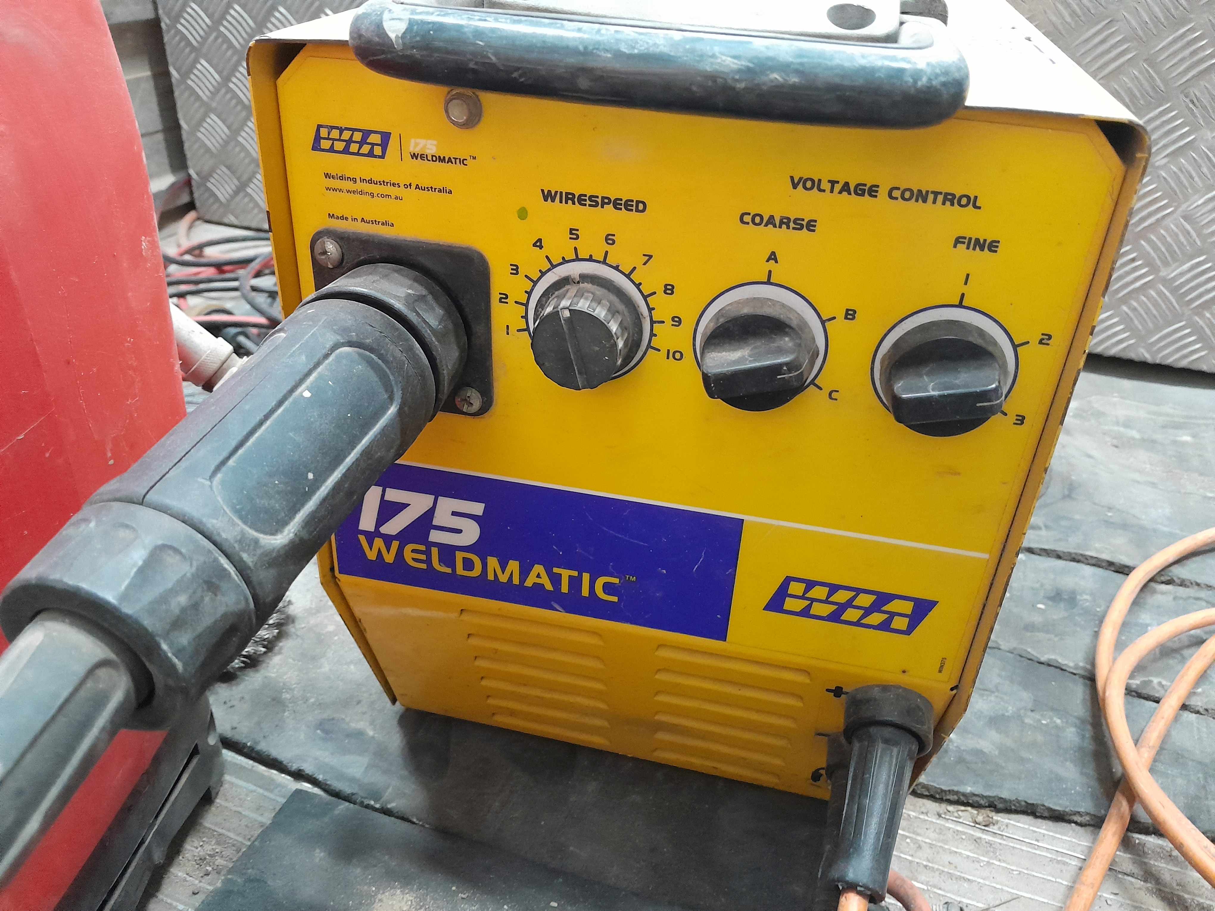

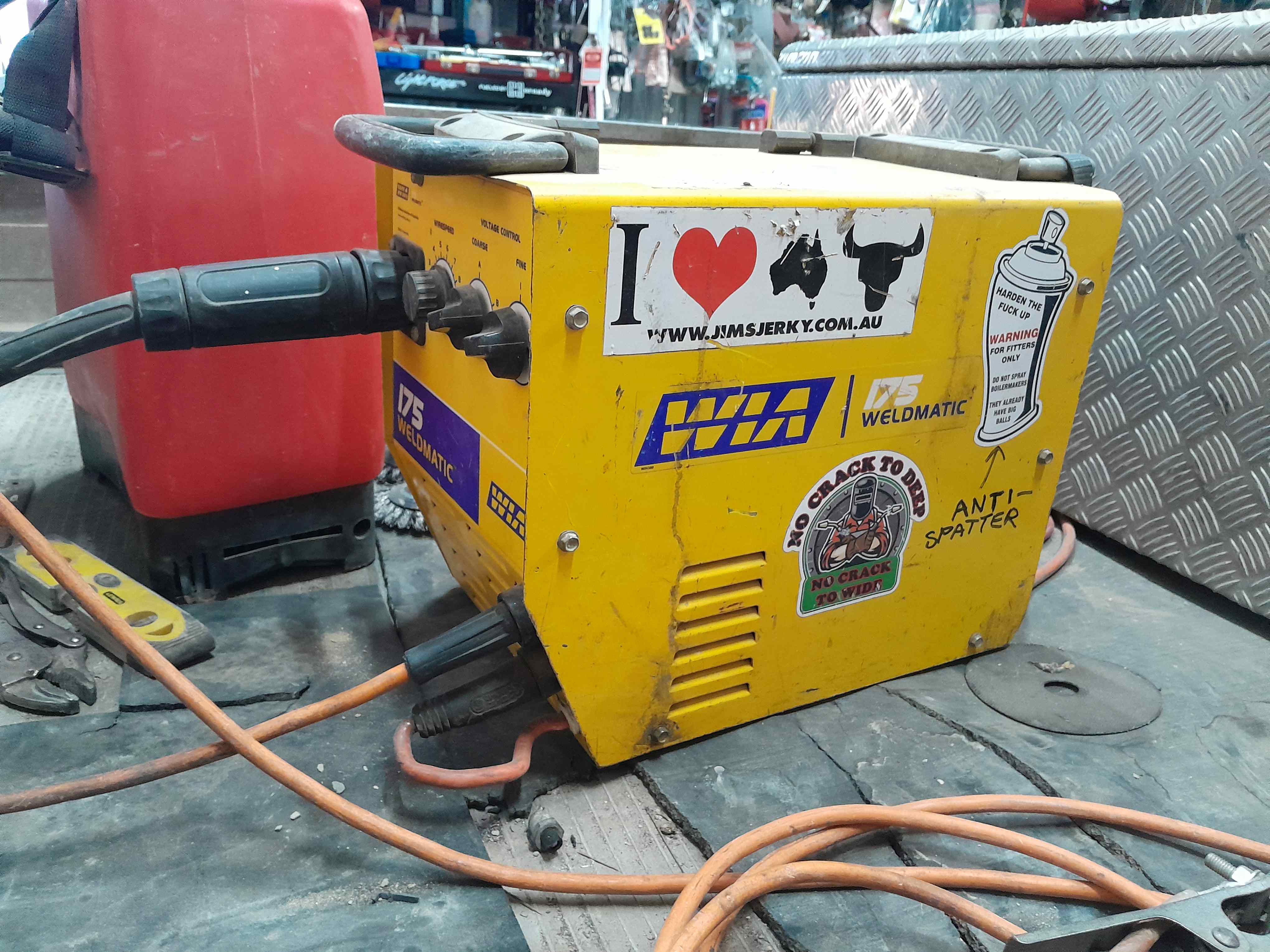

This is why I use the old copper-coil 240v mig here, it's absolutely bomb proof. All my field jobs are with this "s**t" copper-coil welder, on an 8kva genny.
All workshop welding here is done with this old, copper-coil 150 amp Aussie made WIA mig. Again, with a 5m long gun and a 5m earth lead. Runs on 10amp power and for welds even on 12mm angle etc, only is running on about 75% of it's capacity. On gasless.
As a boilermaker, if I thought I needed a big 3-phase machine for any job here I've ever done, I would have one.

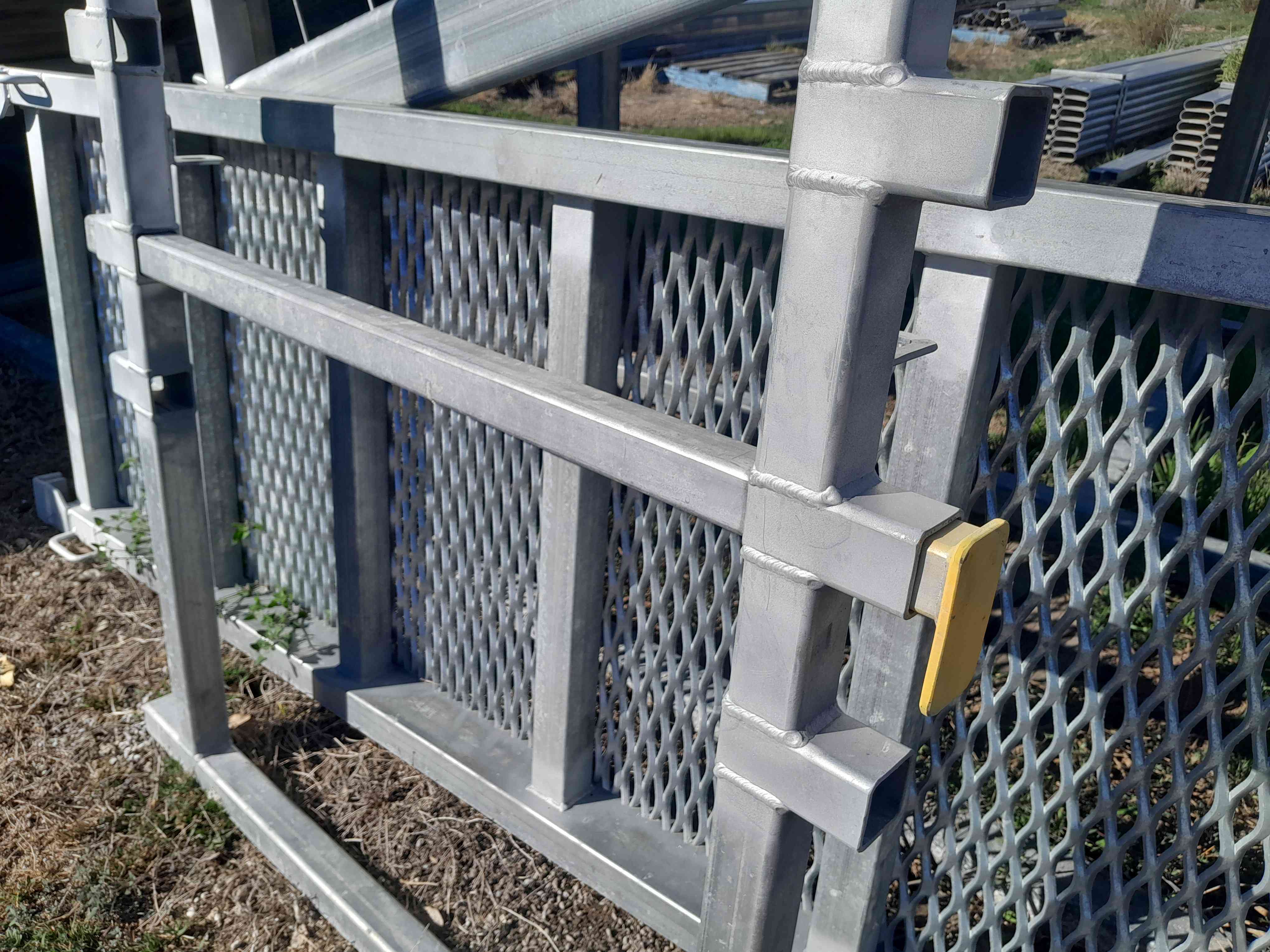

Here's an example of my routine welds this 150amp machine has done, on 6mm thick galv SHS with 0.9mm 71-T11.
Perfect deep penetration, no spatter, no grinder marks anywhere (try and find one), and the welds are as strong as the base metal.
