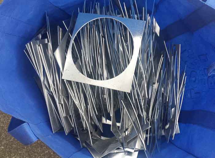

Waiting to get down to the scrap place again to pick up 10kg or 20kg of scrap then am ready to give casting a few proper things ago.
Lorgar
Posts: 2165
Re: Making your own charcoal
Post by Lorgar » 02 Mar 2015, 5:33 pm
Got there sooner than I thought.
Supplies!
And a bunch more bags in the car :D
