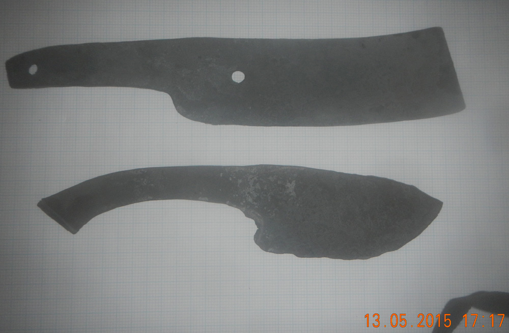

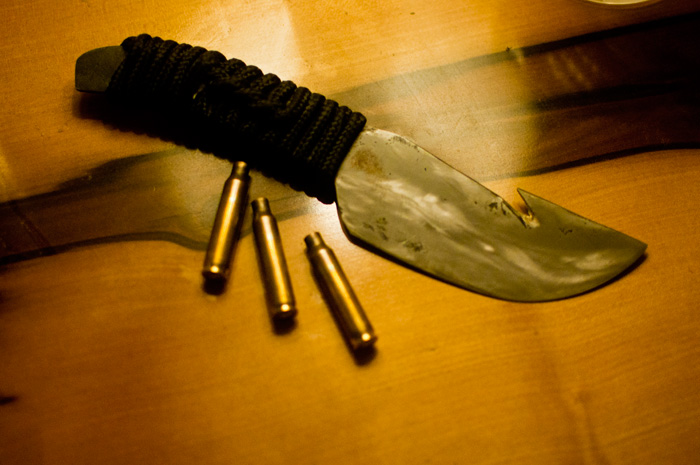

After a few issues building my home forge and needing to re build it after about 3 blanks were hammered out, it is finally running well and i've started on some new knives.
above: My first knife in forge #1. Bit rough but it works. Used it to skin a steer a few weeks ago and it stood up to the task just fine.
above: The forge. Made out of a stainless steel rubbish bin. First time 'round the burner wasn't sealing properly and heat got in between the casing and the lining/refractory and burnt it out quickly. I had a plate made up to properly seal it, relined with refractory (home made castable variety) and now it's much better. There are plans to build a bigger one for long blade like machetes etc and maybe a more open one to make tommy axes. I have a second burner and with the plates i had made, i will be able to fit the burners to what ever forge i need for the job. They'll just bolt on/bolt off.

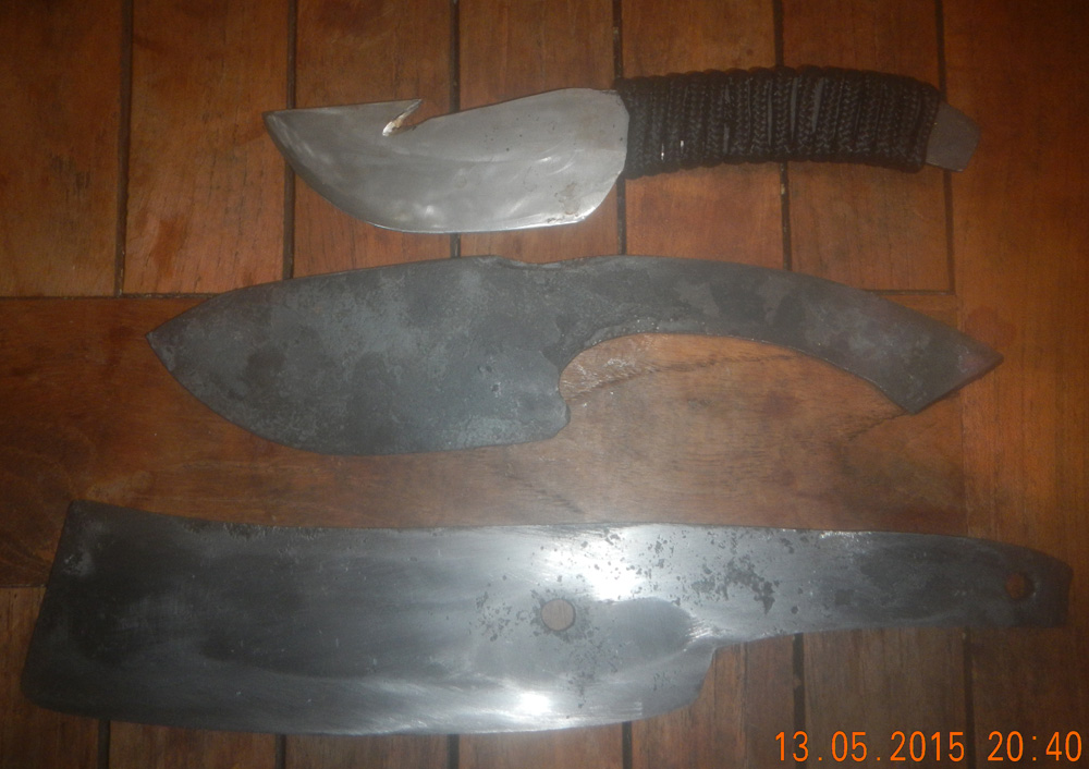

above: Before and after of last nights session. The chopper i've been trying to get right for a while. It is now at its final dimensions and has been hardened. The big skinner i just started on Tuesday. It's probably had 2-3hrs work on it so far.
Back into it today. We'll see how far i get.

Yesterday's result.
Spent a heap of time trying to get the hardening right on the chopper and big skinner. Had a slight disaster when the skinner came out a bit warped. I tried to tune it in the vice and the tip snapped off. At least then i knew i had gotten it as hard as i was likely too. :unknown:
I reshaped the tip and tuned out some irregularities in the belly then followed the same hardening process; this time, no warping at all! :drinks:
After cleaning up, i tempered to a nice blue in the cooling forge. Hope i got the differential hardness right with my quenching and tempering. Seems to have worked as the knife has a really nice sustained ring to it when you ping it! :thumbsup: :clap:

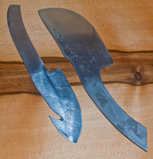

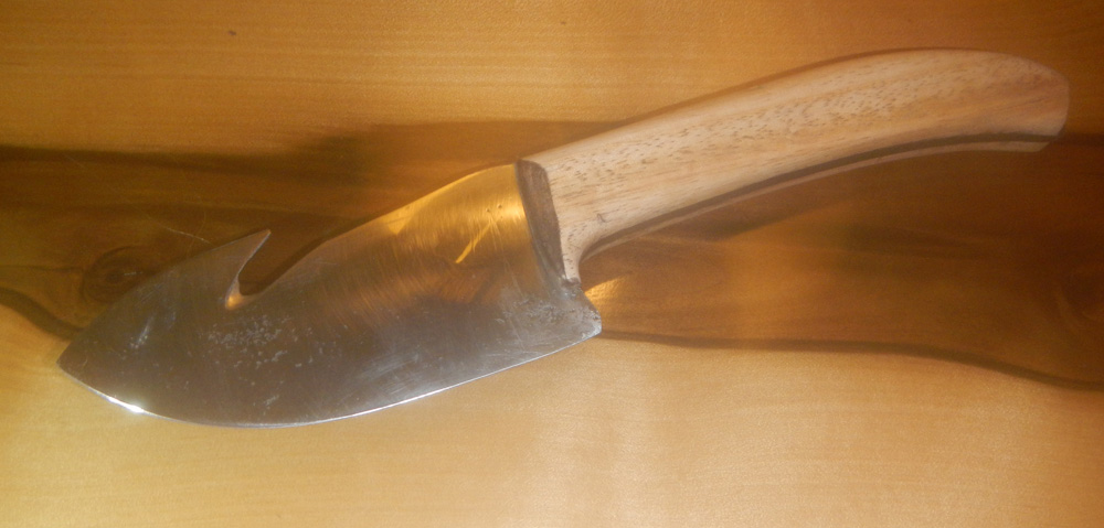

Post by Gwion » 18 May 2015, 8:47 am
Just got to fit scales to them now (with out buggering them up!).
Hardened, tempered and polished (as much as they are going to be). I'm leaving the odd file mark, etc in because they are my first knives and it shows the full hand made effect. As i get better with my forging process i will take more effort to run out all the file marks and take more time between grits on the polish.
Final edge will be worked when the scales are finished.
PS: the small one is the same knife as the black rope handled one at the top of the thread; it has just been tweaked and re-hardened/tempered. They both give a nice ring when pinged. :drinks:

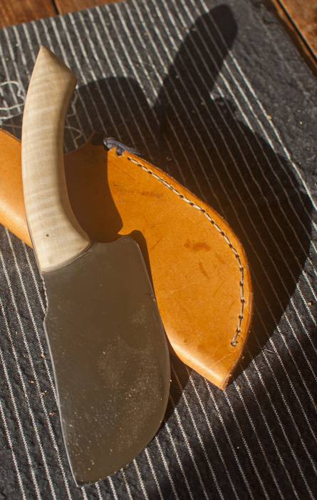

Post by Gwion » 18 May 2015, 8:33 pm
One knife as good as it's gonna get.
Quite happy for the first knife i've ever made. Shaving sharp and stood up to a few whacks on the corner of a bit of blackwood; not that i'd recommend using it to chop wood or pries anything open. It is purely a skinning knife.
Going to a mate because he needs one and has helped me out on the property quite a few times.

Post by Gwion » 18 May 2015, 9:30 pm
Epoxy. This knife may get a working again in future. Easy to pop the scales if need be.
Also, first try at knife making so keep it as simple as possible.

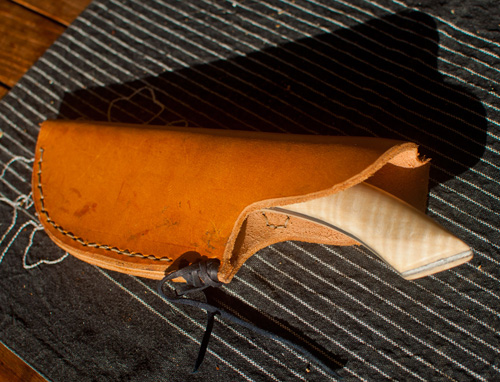

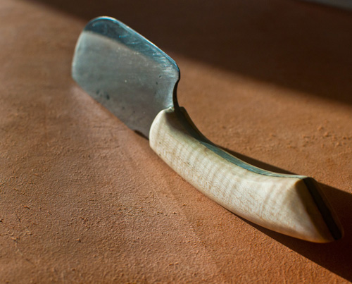

Finally finished knife number 2 and made a basic scabbard for it.
Also got the big chopper quenched right but not the small chopper. Maybe i've wrecked the small chopper because i thought i quenched them the same way and one worked and the other didn't.
Pic below of knife #2.
Fiddle back maple handle. I have acres and acres of this timber. Enough to make a gazillion handles!
