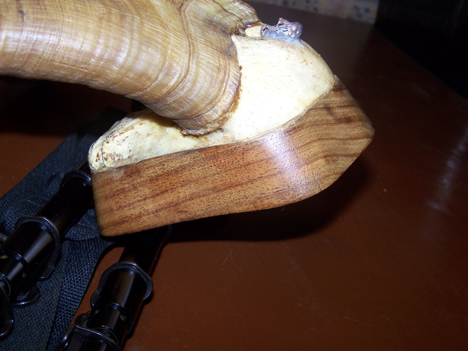

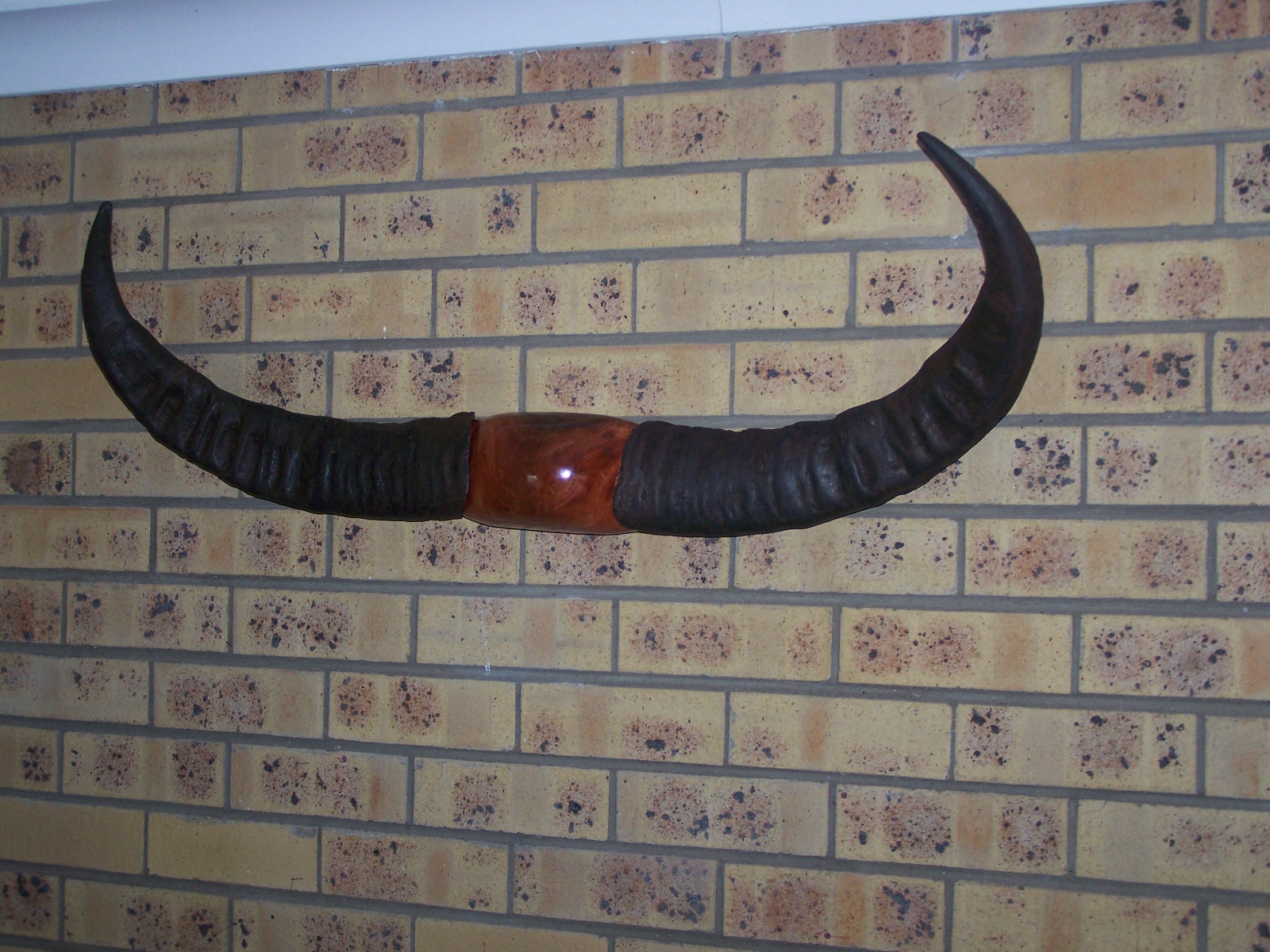

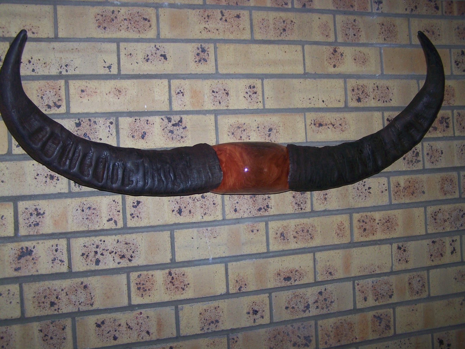

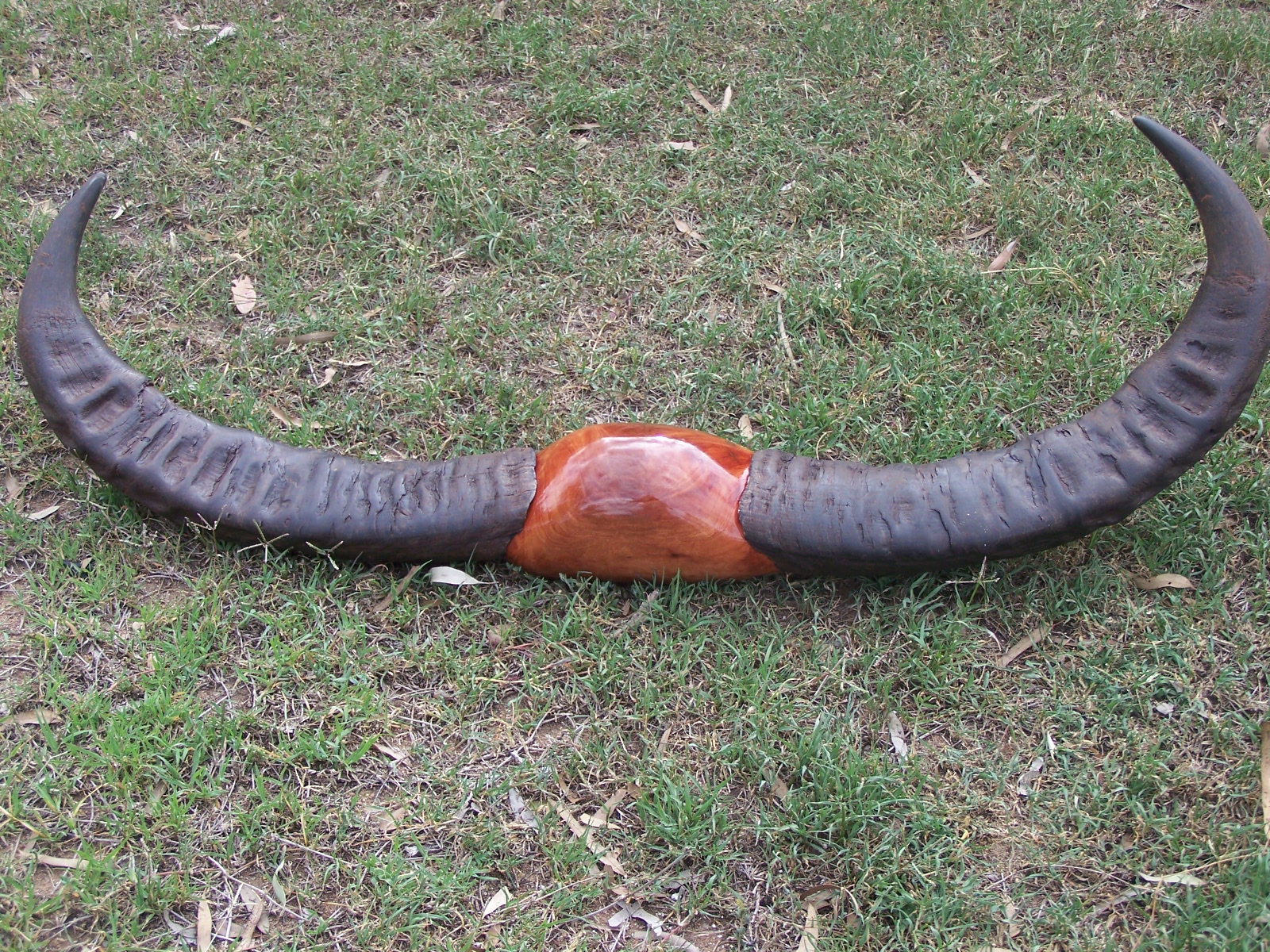

Post by Die Judicii » 12 Nov 2015, 4:29 pm
Well here it is, reshaped a little to my satisfaction and re oiled.
I've got more of this timber if anyone wants something similar made. (I've also learnt some tricks to speed up the process)
:thumbsup: :D

Nice job, is the oil put on with a rag/brush?

Post by Die Judicii » 12 Nov 2015, 9:34 pm
rsj223 wrote:Nice job, is the oil put on with a rag/brush?
Neither actually,,, I've developed a secret weapon :silent:

Looks bloody spot on! The secret weapon wouldn't have a grade of 0000 by any chance?

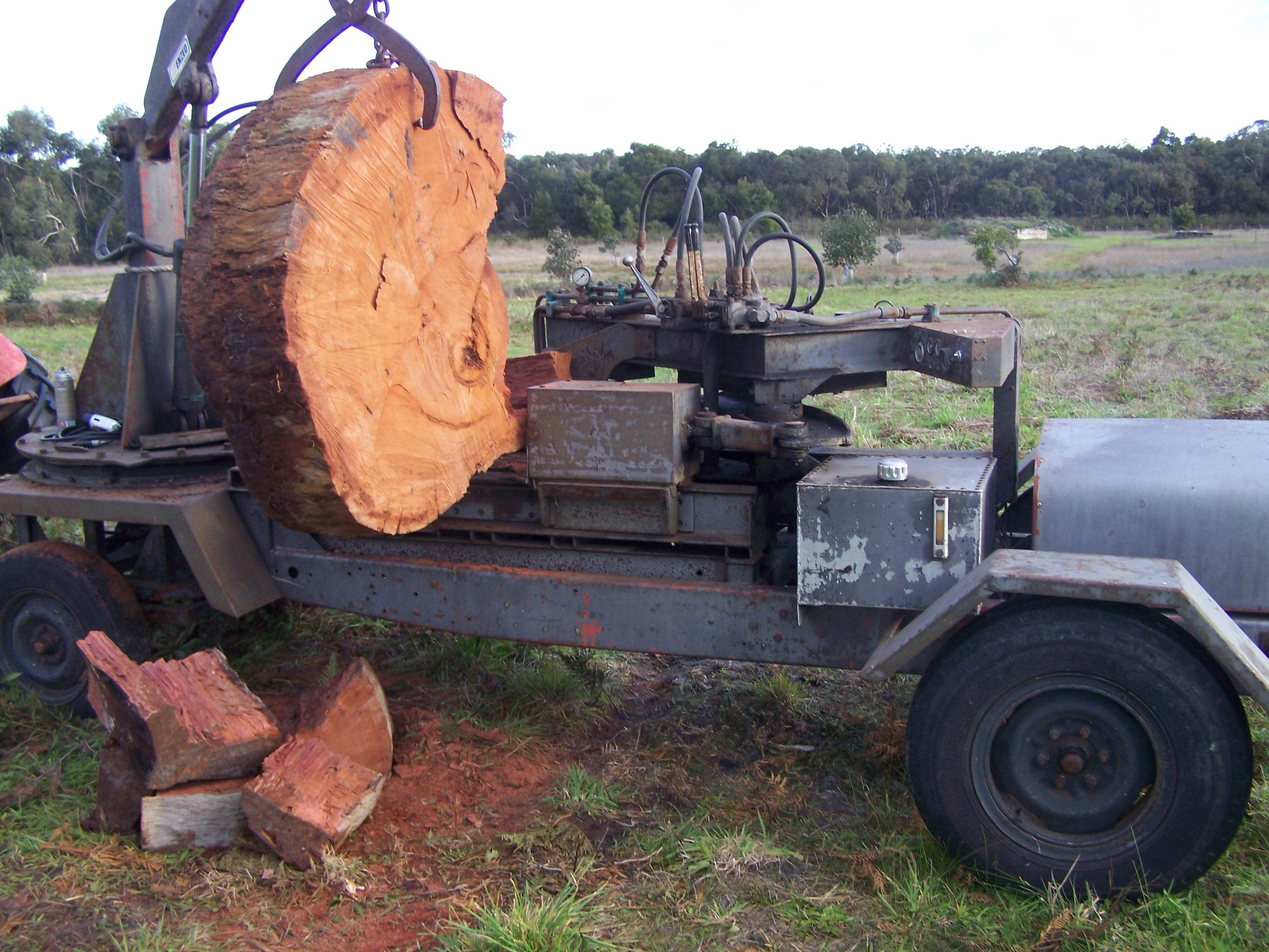

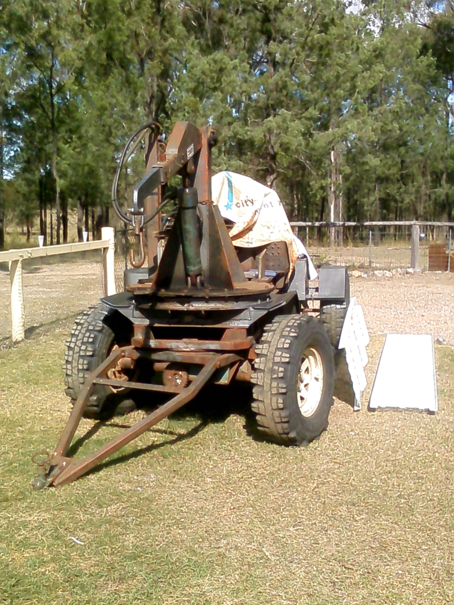

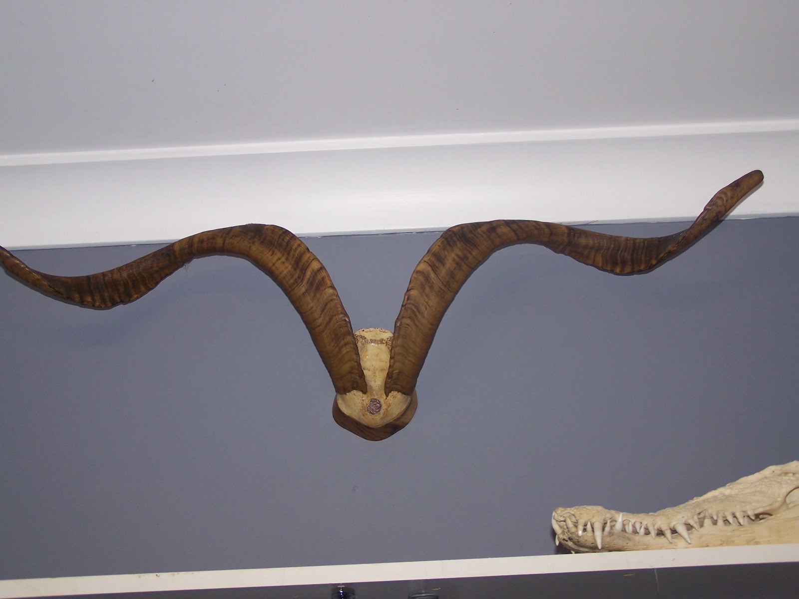

Pics of Goat mounted on Blackwood, and the log splitter I built years ago, but still use every year.

Wow, where to start...
Goat is very nice, but you have a crock in the pic. That's like if I said, "Hey, look at the new S&W revolver I just bought" and there was an M134 Minigun in the lower right corner of the pic.
Second, your goat has an alien face between the horns. Take a look at your first pic. And cover your probe port tonight :)
I like the log splitter :) More like a tree splitter.

Hi Title,,,,
:lol: :lol: :lol:
Good imagination,,,,,,
What you are actually looking at is the natural markings / joints in the skull, and the mangled projectile glued on it.
Sorry bout the croc, he wouldn't slide back along the shelf any further because the feral pigs wouldn't get out of his way. :o

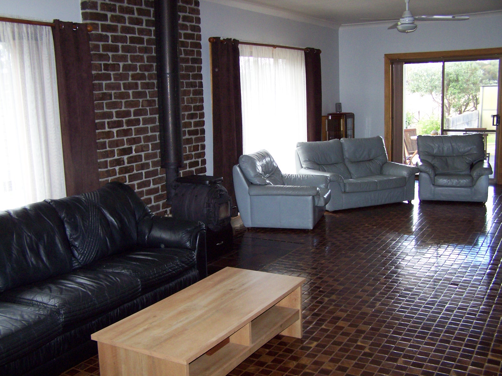

Here you go Title,,
A bit more fancy woodwork from my past,, a lounge room floor.
A parquetry floor that I did in the house of the property I sold a few years ago.
My youngest daughter loved it so much she had some of her wedding photos done on it.
The timber is a mixture of River Redgum (Eucalyptus Camaldulensis), and Blackwood (Acacia Melanoxylon)
The individual blocks are 30 mm thick, and all glued down end grain up.
I started the project by actually cutting the trees down myself, and paid a mate that owned a mobile sawmill to mill them into 3 inch square lengths.
Then they were stacked in a shed and air dried for 2 years.
Then I cut them into the blocks, and glued each one individually.
The grout was a special mix that I made myself (after extensive testing). It actually contains crushed garnet (abrasive blasting grade)
Posts: 4384

Post by Title_II » 14 Nov 2015, 2:02 pm
How long did that take? I'm thinking you polished and lacquered sheets and sawed them up. What did you really do?

Post by Die Judicii » 14 Nov 2015, 9:54 pm
Title_II wrote:How long did that take? I'm thinking you polished and lacquered sheets and sawed them up. What did you really do?
I thought I had explained it,,,,, albeit the simplified version.
The actual laying of the blocks was however challenging to say the least.
Because I wanted a "rustic" look, but at the same time pretty level, caused me some headaches because the 3 x 3 inch lengths were left as rough sawn and air dried, they were not all identical size.
The two different types of timber shrunk at different rates when drying.
So when it came to glueing them down, it was a bit like building a wall with rough tumbled bricks.
You had to allow for differing size blocks,,,, but keep an overall set line.
First step I undertook was figuring the finished depth of the blocks and base, and then set the level when pouring the concrete floor.
This had to be done carefully so that the finished surface of the blocks matched the adjoining rooms that had standard concrete floors with carpet or linoleum.
Once the "sunken" concrete floor was finished, then I screwed 8' x 5' sheets of marine grade particle board onto the concrete using HD wall plugs.
Then I loose laid all the blocks in the (staggered pattern width ways and set pattern length ways) which ends up giving a diagonal pattern.
Then I sprayed them with white ant water based chemical.
Next I turned them all over, and repeated the spray.
Then I started to glue all the blocks (individually) onto the particle board.
After all blocks were glued down, I applied the special grout mix that I made. That was quite a lot because the blocks were 30 mm deep.
When the grout had cured I then hired an industrial drum sander and sanded the entire surface area in three differing directions.
Starting with really coarse, and working down to ultra fine grits.
Even tho I worked in differing directions, I found that the Redgum was much softer than the Blackwood, and as a result I accidentally produced slightly rounded edges on the blocks that ended up like the cobble stone look you can see in the pics, which I liked.
Then I applied by roller 4 coats of a clear hard wearing gloss.
Many,, Many hours of work, and at one stage I almost gave up and thought seriously about just putting carpet on top.
But as soon as the 1st coat went down, the colours and grain really came to life and made it all worth while. :thumbsup:
