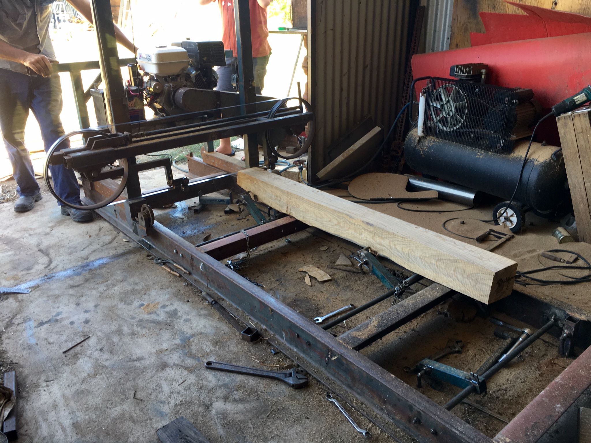

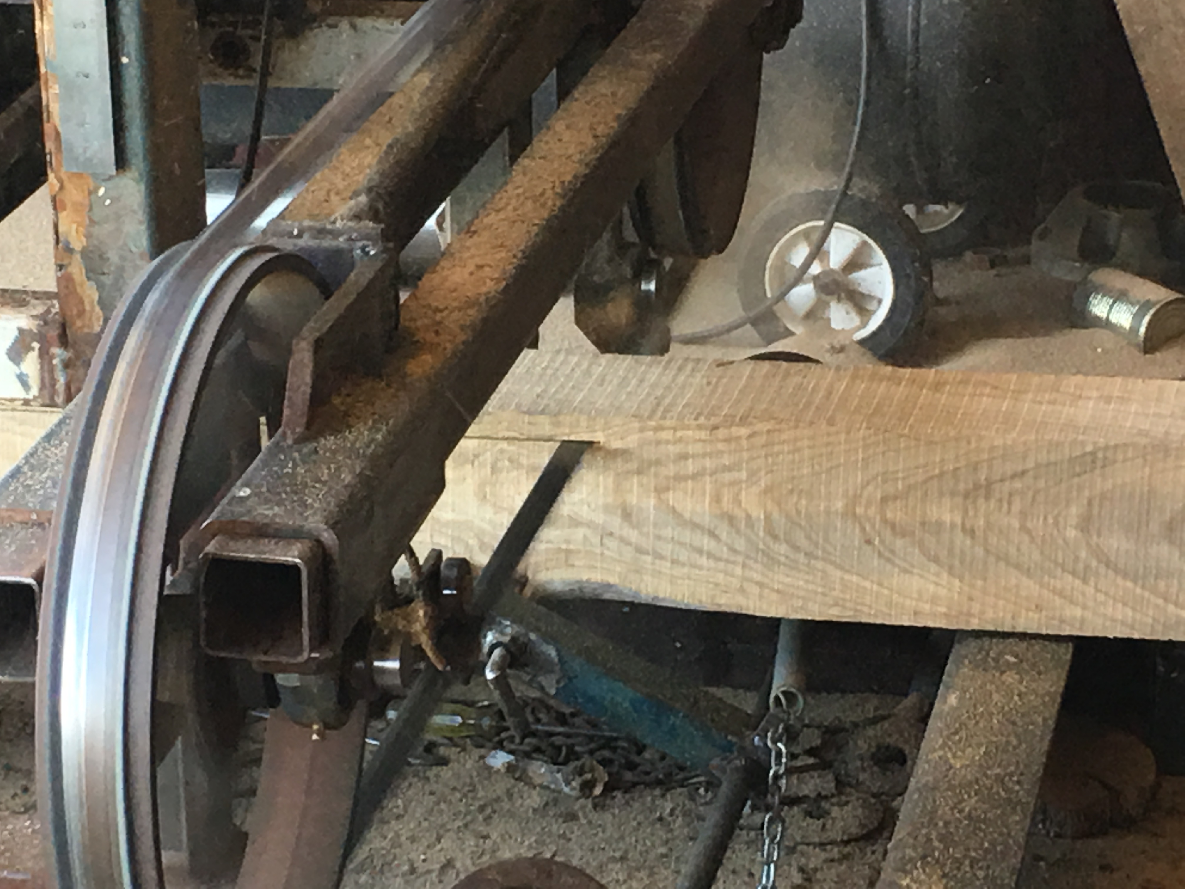

By request, here's a couple of pics of the latest creation from Noisy Labs of my portable sawmill. It'll handle logs from 2' to 10' (and then some if Iuse some left over steel to make an extension) and up to 2'6" diameter. So far I haven't hit the $100 mark in steel but I've got almost $600 in it including the 13hp engine. Never new there was a sawmill hiding in my scrap heap! :D
Going through Claret Ash like a light sabre!

I am literally mesmerised by the top image.

Good old bush ingenuity at its finest, I have only the greatest of respect for those that can make something useful from almost nothing. Good job mate, any chance of a YouTube video of it in action? Does the timber feed itself through the blade or do you need to push it?
Re: Making bigger stuff
Post by Noisydad » 22 Feb 2016, 10:30 pm
There will be a short and daggy video posted on the Noisydad youtube channel (such as it is but there's also a shooting video there) when Lady Noisy finishes it. The adjustable height cutting head rolls along the rails passing over the log. It takes no effort at all to push it along. You can see the spiked dogs holding the log. The band saw blade is a tooth per inch and water lubed. I may get a blade made that's a tooth per 3/4".

That's a great slabbing mill Noisydad! You must have a world class scrap heap to raise one of those from it, any guided fossicking tours? I used to love going through old scrap and demolition yards looking for ideas and dreams. Only $600 so far? beats a Norwood for $9K, as well as the pleasure of Home Made.

Lol probably shouldn't call it scrap coz it's not. I just have a pile of steel I haven't found a use for yet!
