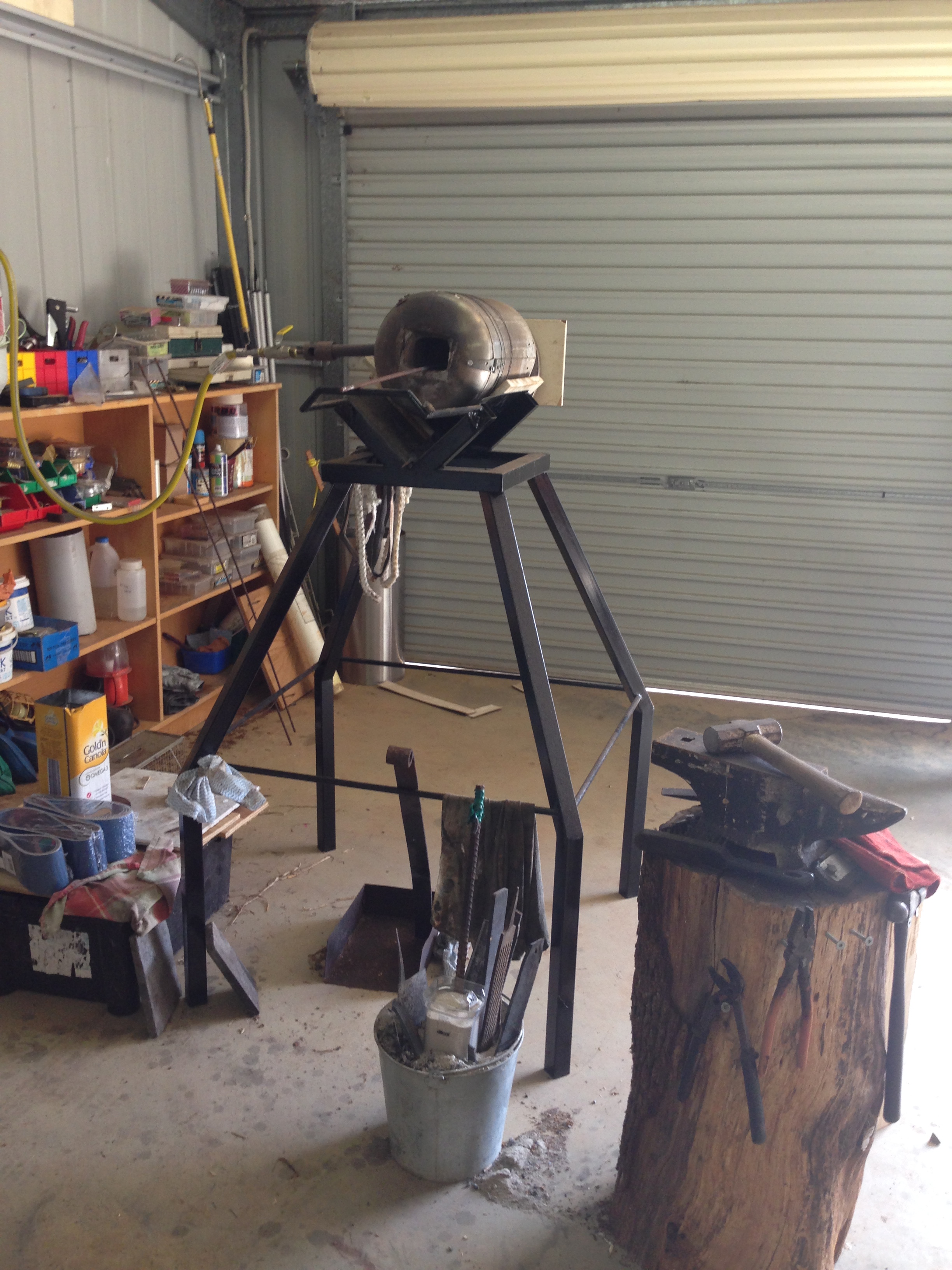

If anyone is into making blades, show us all your set up and some of your work. I'm pretty new to it all and teaching myself from good old YouTube and other online resources. Here are some picks of my simple set up and some blades I'm working on.

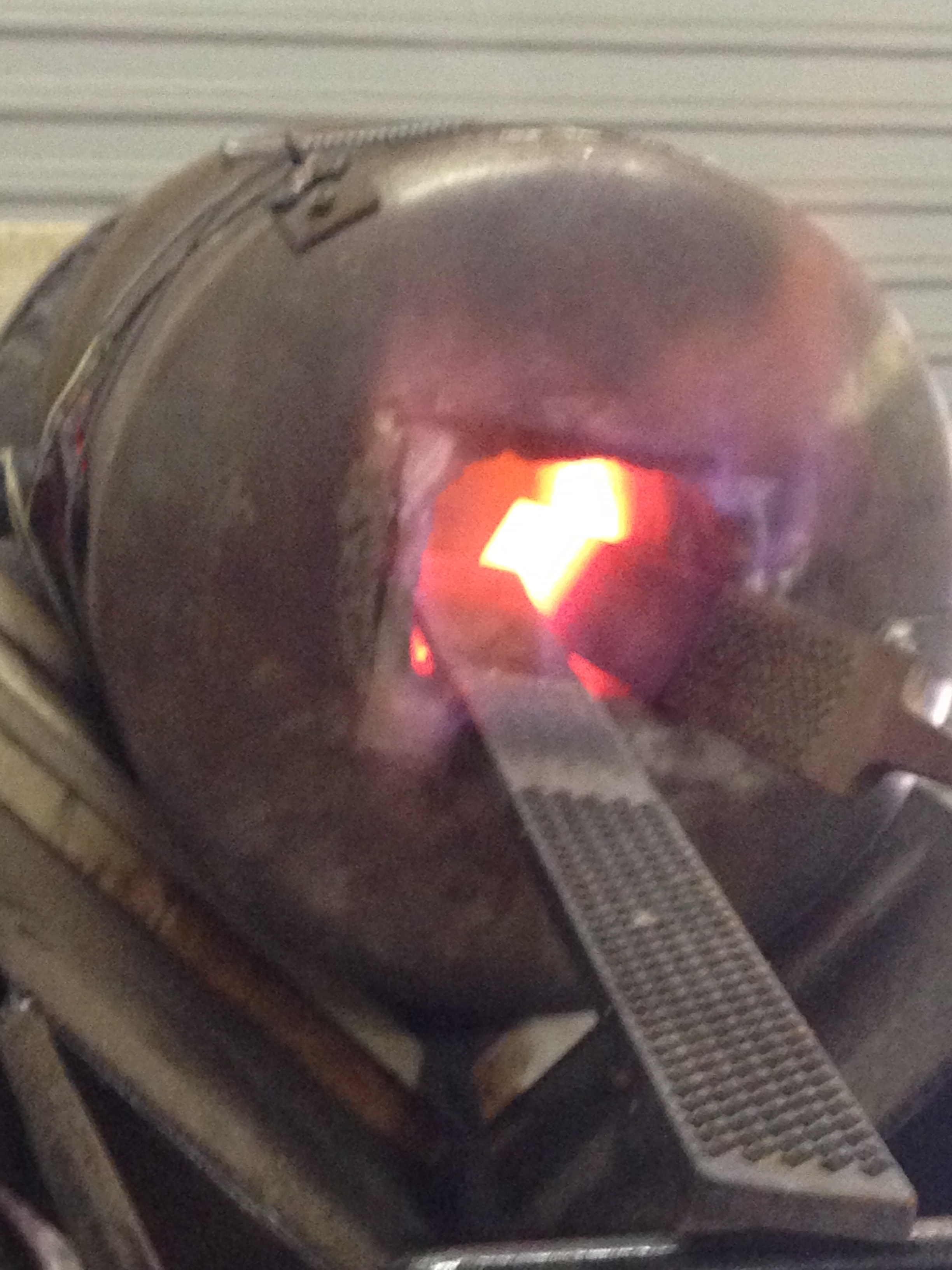

Home made forge and small anvil.
Forge fired up to 1/2 for 5 mins.

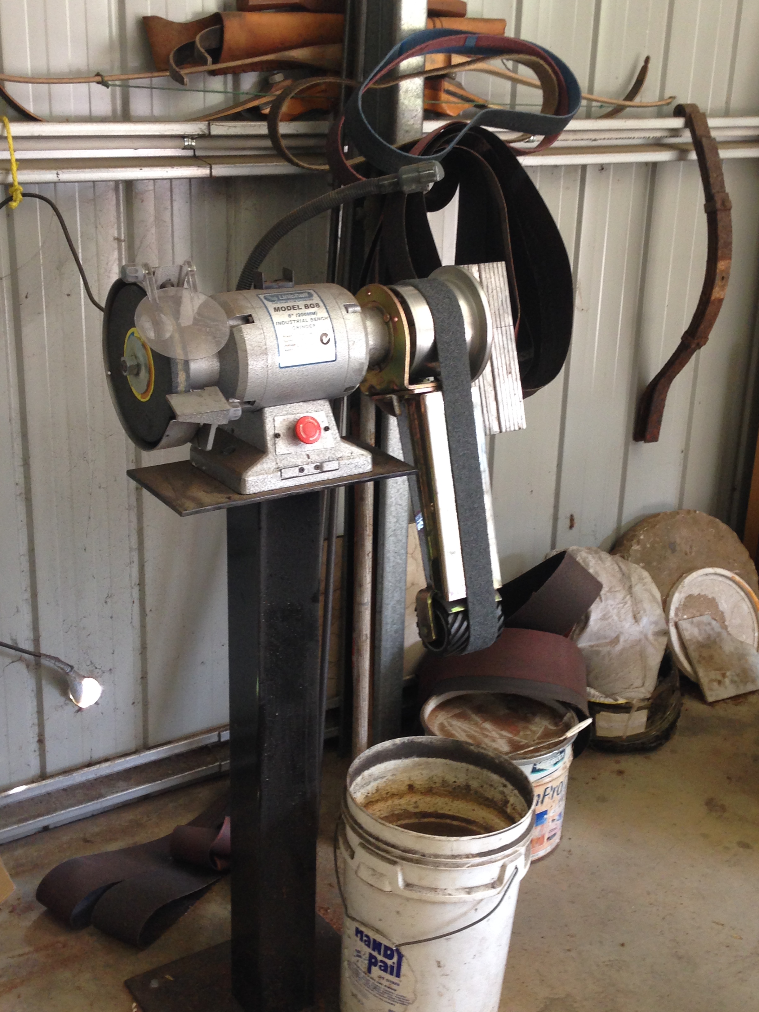

Grinding station.

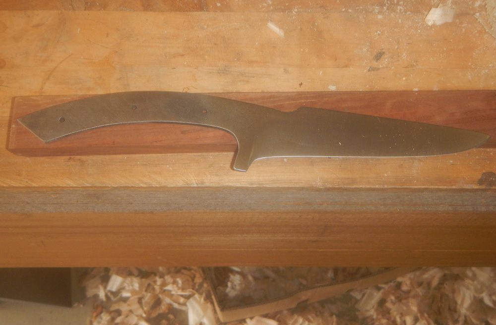

Post by Gwion » 10 Aug 2016, 1:20 pm

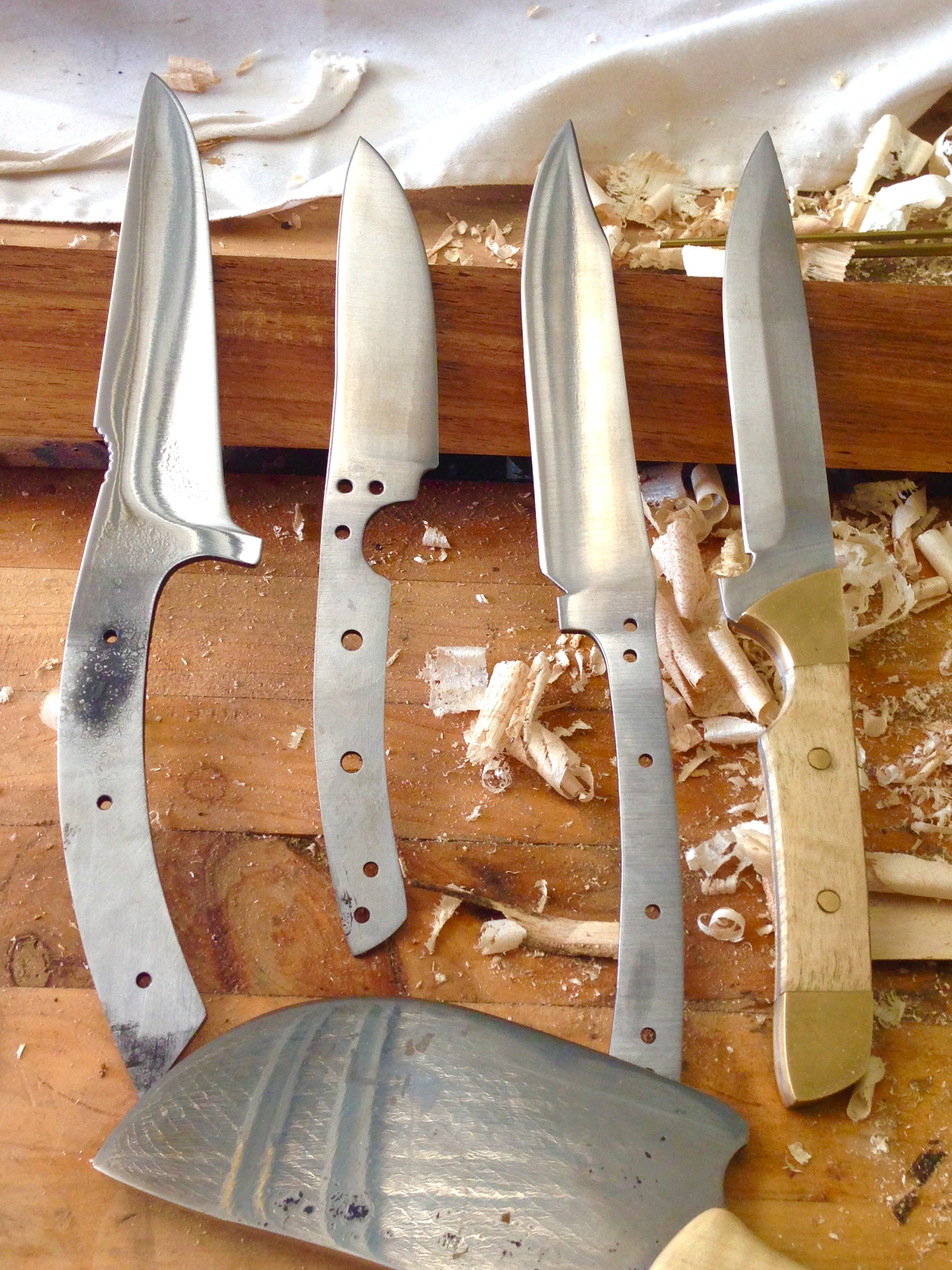

I'll update as progress continues on these knives.
Works in progress.

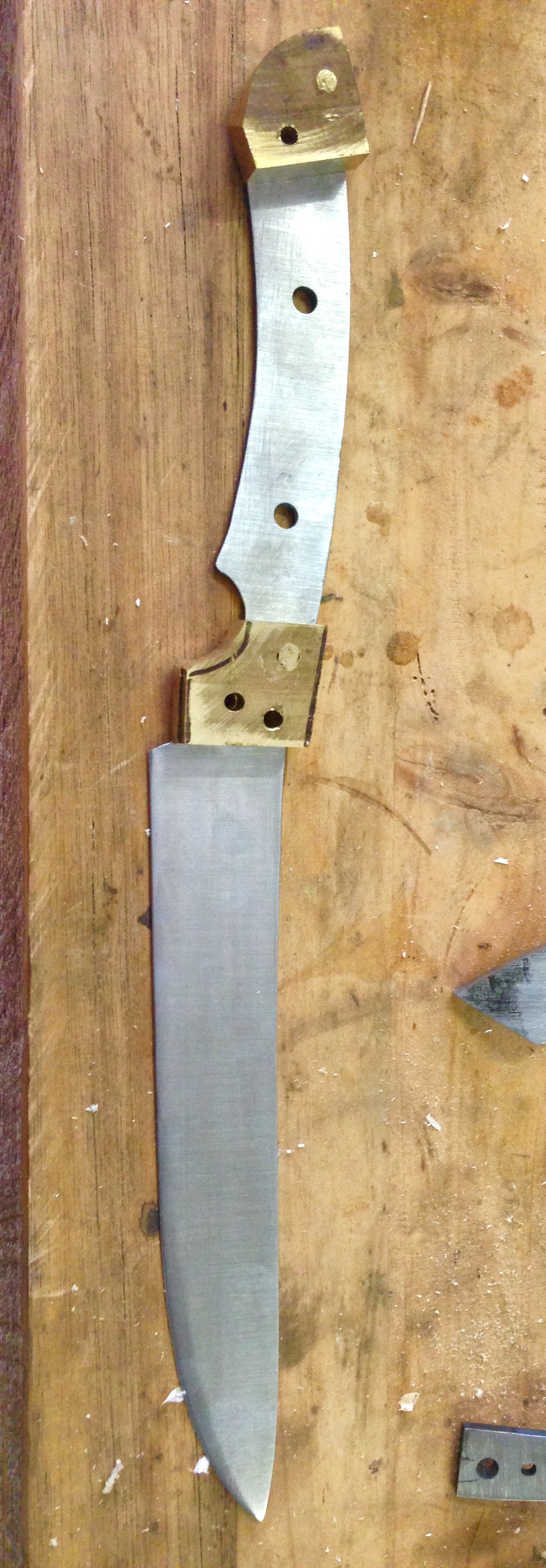

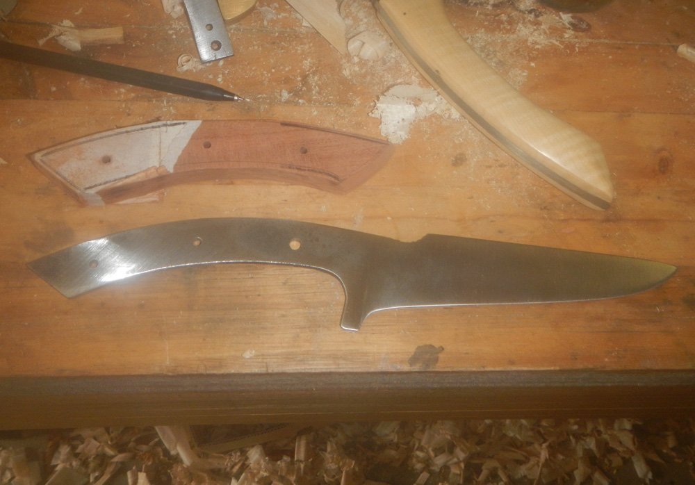

Roughing out some brass baulsters.
Re: Knife Making

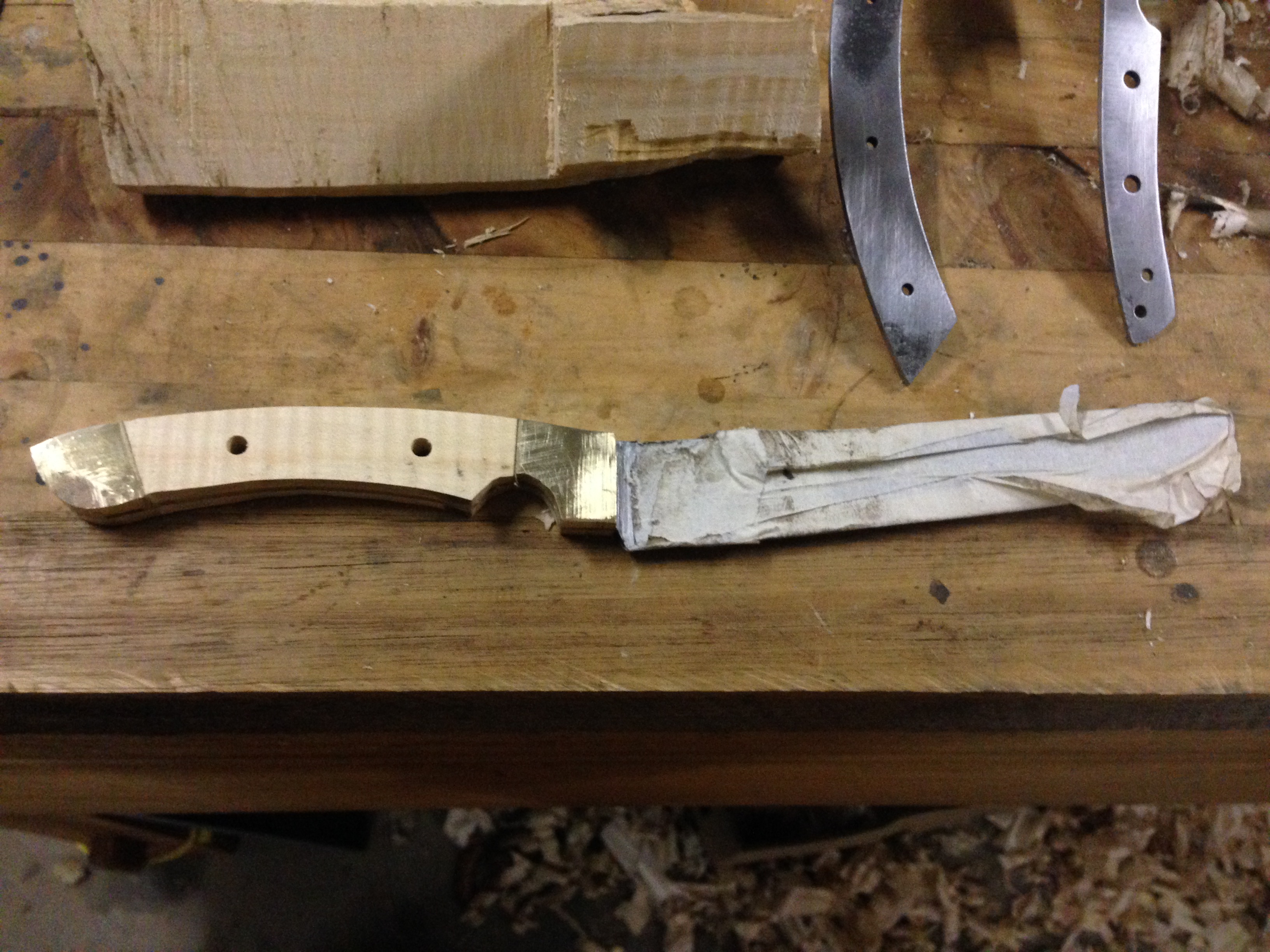

Post by Gwion » 10 Aug 2016, 4:18 pm

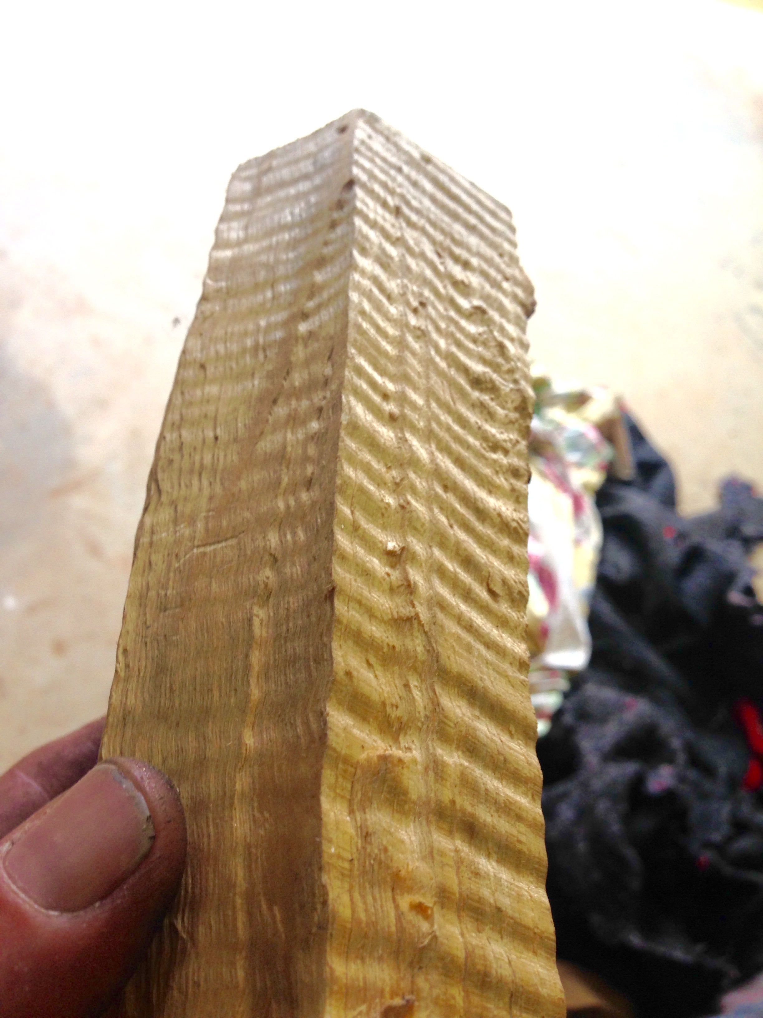

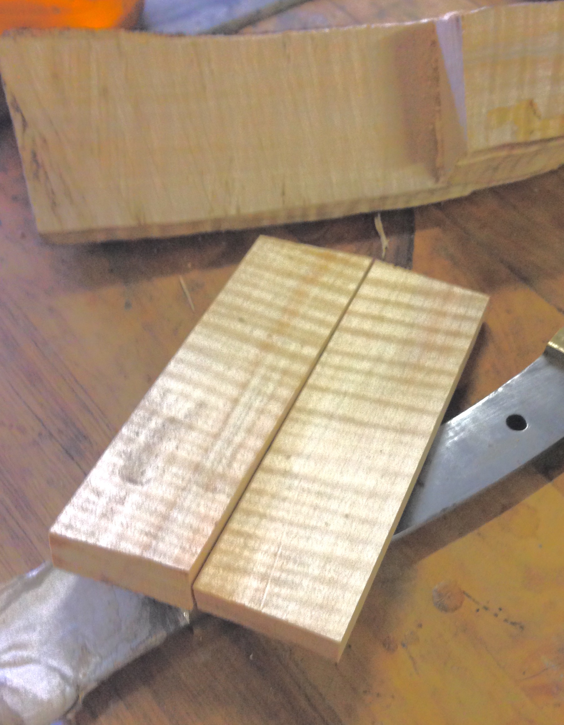

Fitted baulsters after a few minor hassles and the bit of maple to cut scales from.
Re: Knife Making
Post by Gwion » 10 Aug 2016, 5:06 pm
Scale blanks cut.
Fitted now but glue is drying; will update after rough shaping.

Norwegian maple. Commonly called Sychamore Maple. I have hectares of it and am trying to develop a market with stringed instrument & furniture makers.

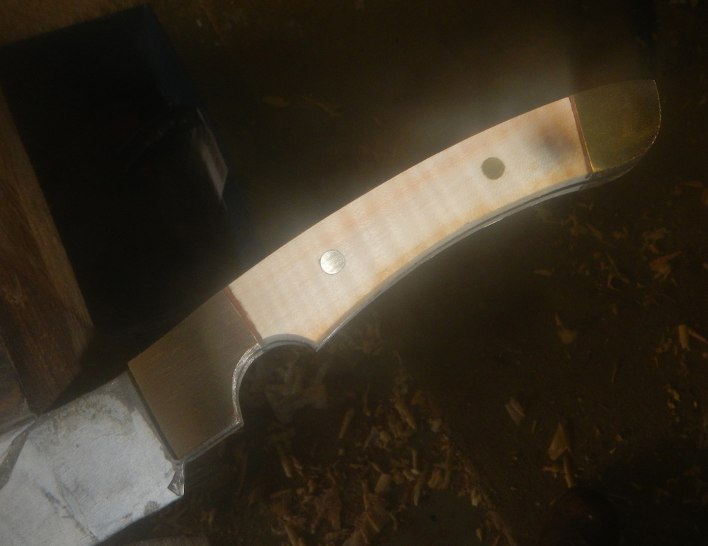

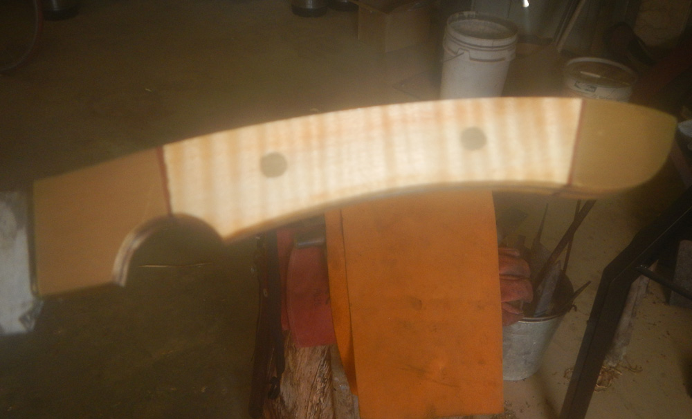

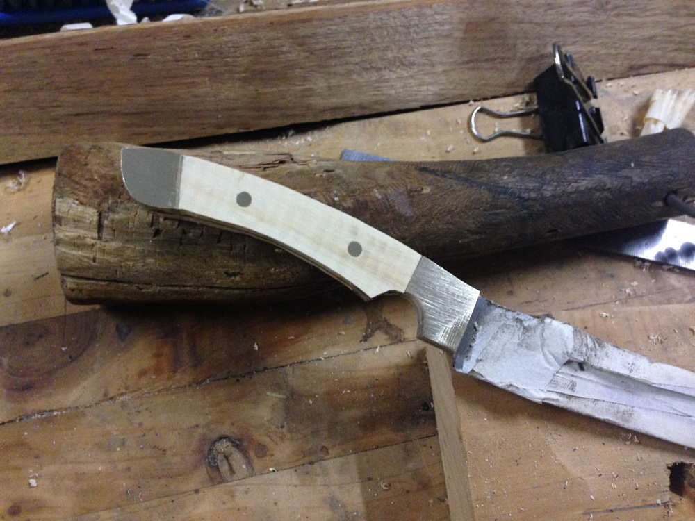

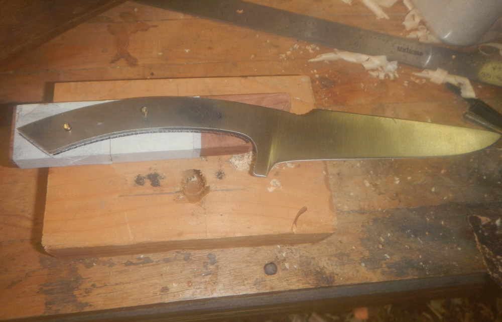

Post by Gwion » 10 Aug 2016, 7:29 pm
Oops.. half the pics are sideways (and pretty crappy)! They looked fine on my phone. I'll fix them later.

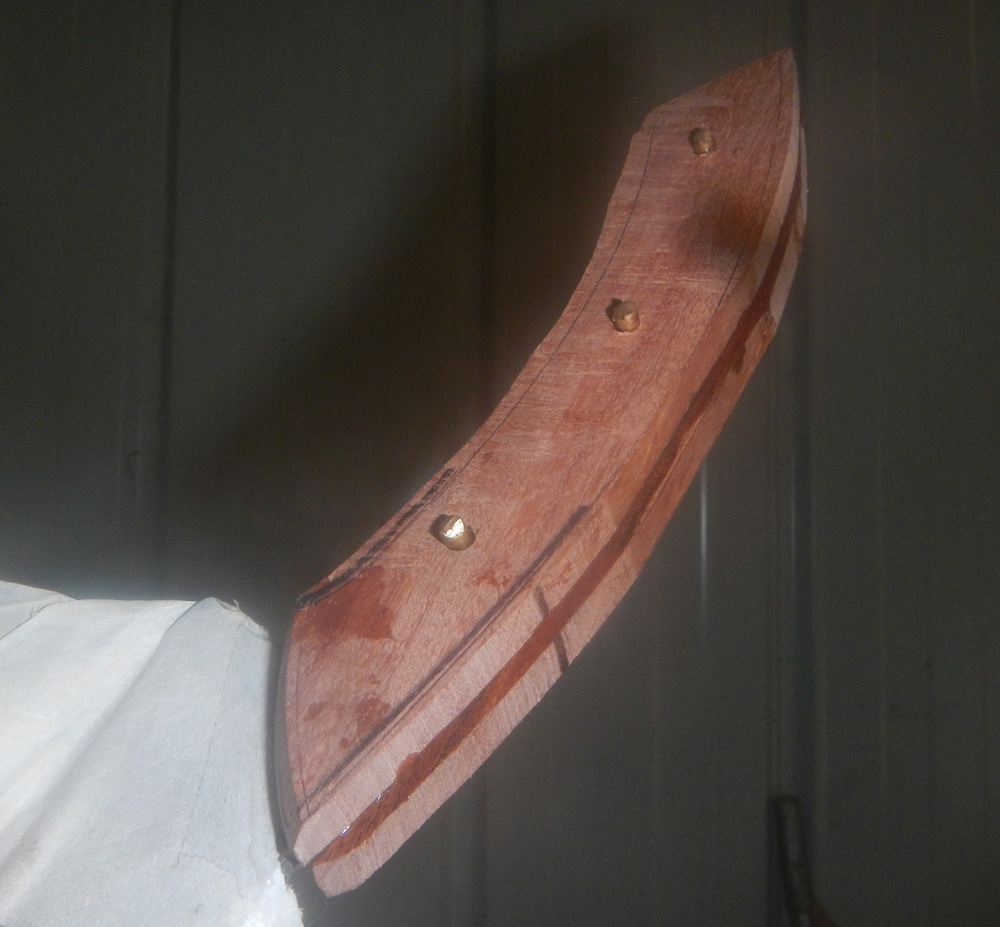

So, scales were fitted, rough shaped, tidied up and given a quick coat of clear so the timber doesn't get contaminated when i do the final shaping and sanding.
Rough shaping.
Brass pins peined out and scales shaped down to baulsters.
Initial coat of clear...
So, not really happy with the fit between the scales and the baulsters when the pic is that close up. Might look at putting a bit of blackwood for contrast or find some other fix. Not so noticeable in the hand but i'd like to find a fix for it. Also, i'll use a proper camera next time. These pics are crap.

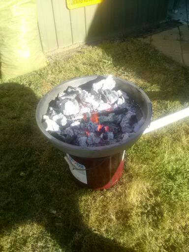

Looks good, Tom. The set up I started with was a fire drum and a piece of track iron that would make you laugh. The only knife I made with it came out more like a hand axe! Your set up is far more sophisticated. I particularly like the cooks knife. I'll try another cooks knife soon; the last one I tried ended up too thin and uneven and kept warping in the quench.

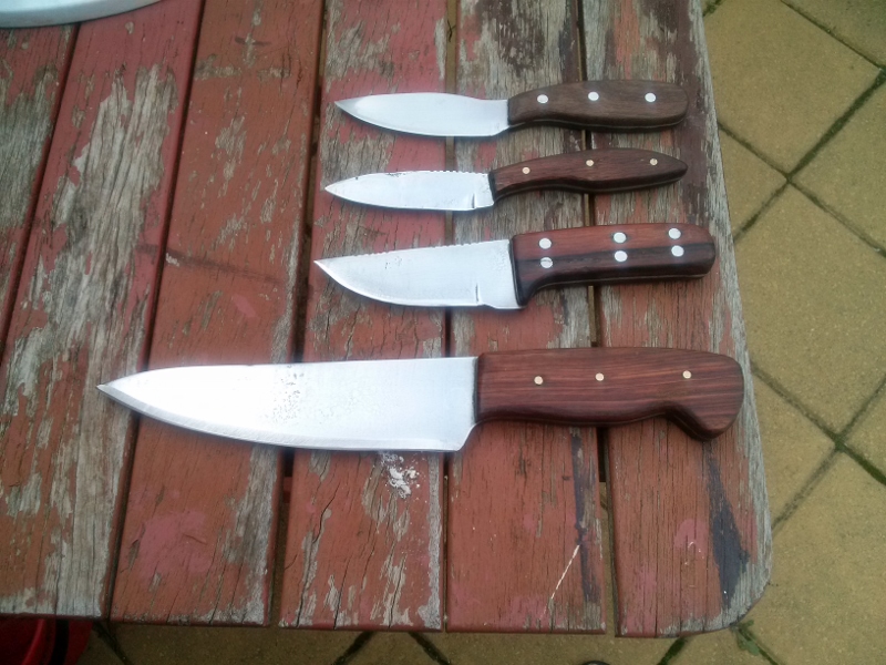

Post by Gwion » 11 Aug 2016, 5:23 pm
Lots of pics of progress today but the camera ran out of batteries as I was cutting them for editing.
Here is where the knives are up to taken on my phone. Will load other pics later.
These ones just need more coats of finish and and edge grind.

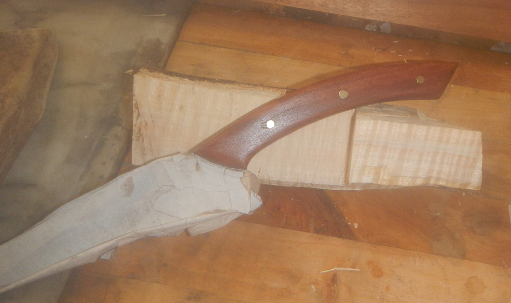

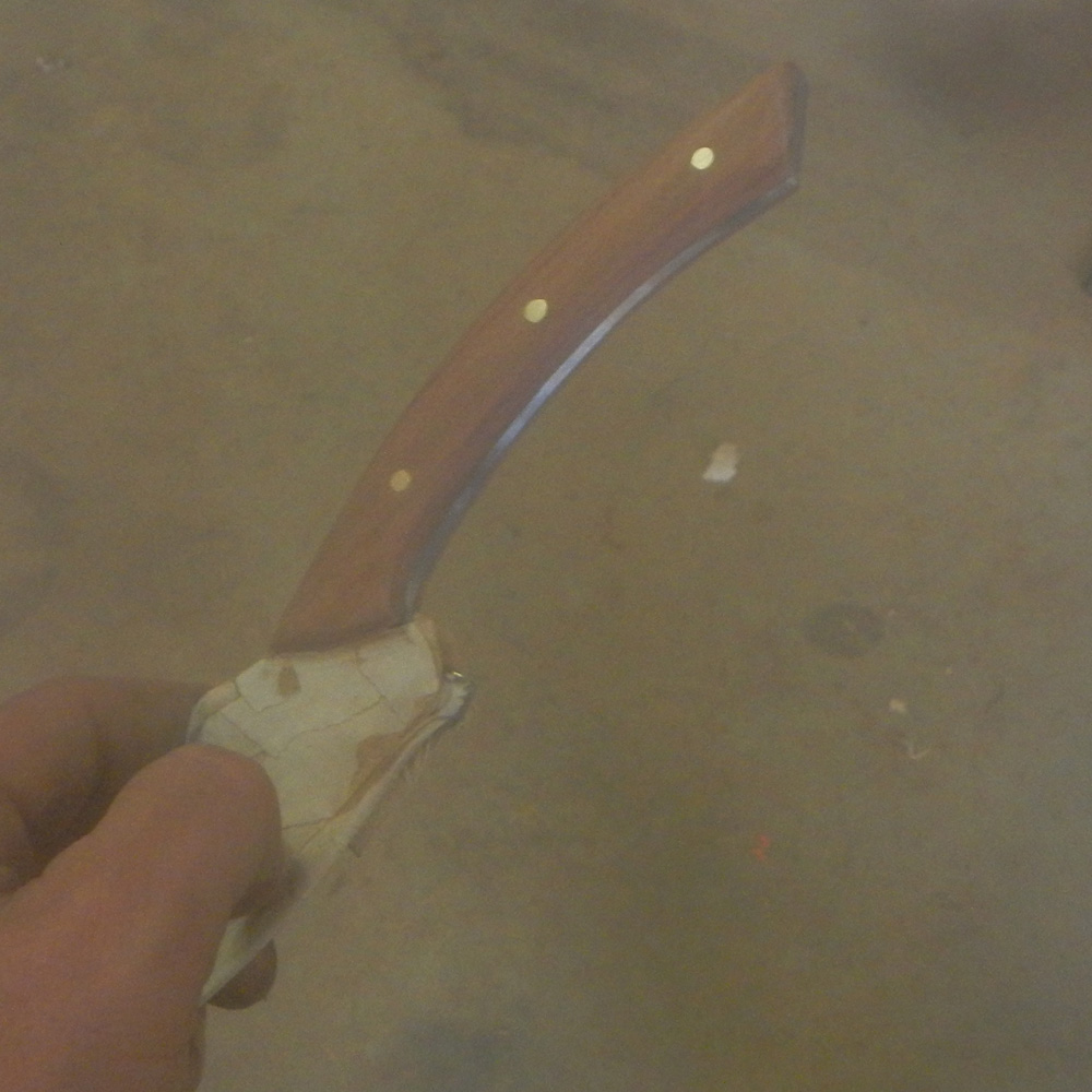

Carving knife. Blackwood shims to tidy up the fit.
Brisket knife with Blackwood handle cut from an old fence dropper.

So, it's apparent that i cant take a photo to save myself at the moment, but the following will give some idea of the process I follow for fitting scales.
First thing i did for the day was fit some blackwood shims to fix the dodgy fit between maple scales and the baulsters on this carving knife.
blackwood shims.jpg (166.86 KiB) Viewed 7485 times

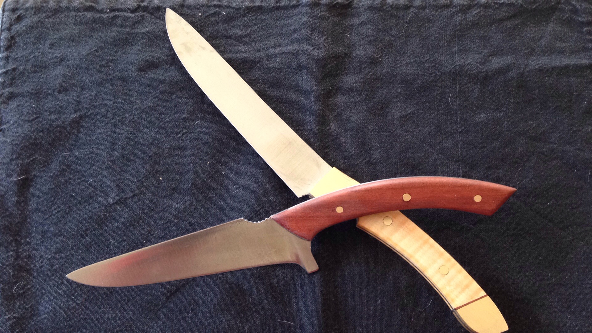

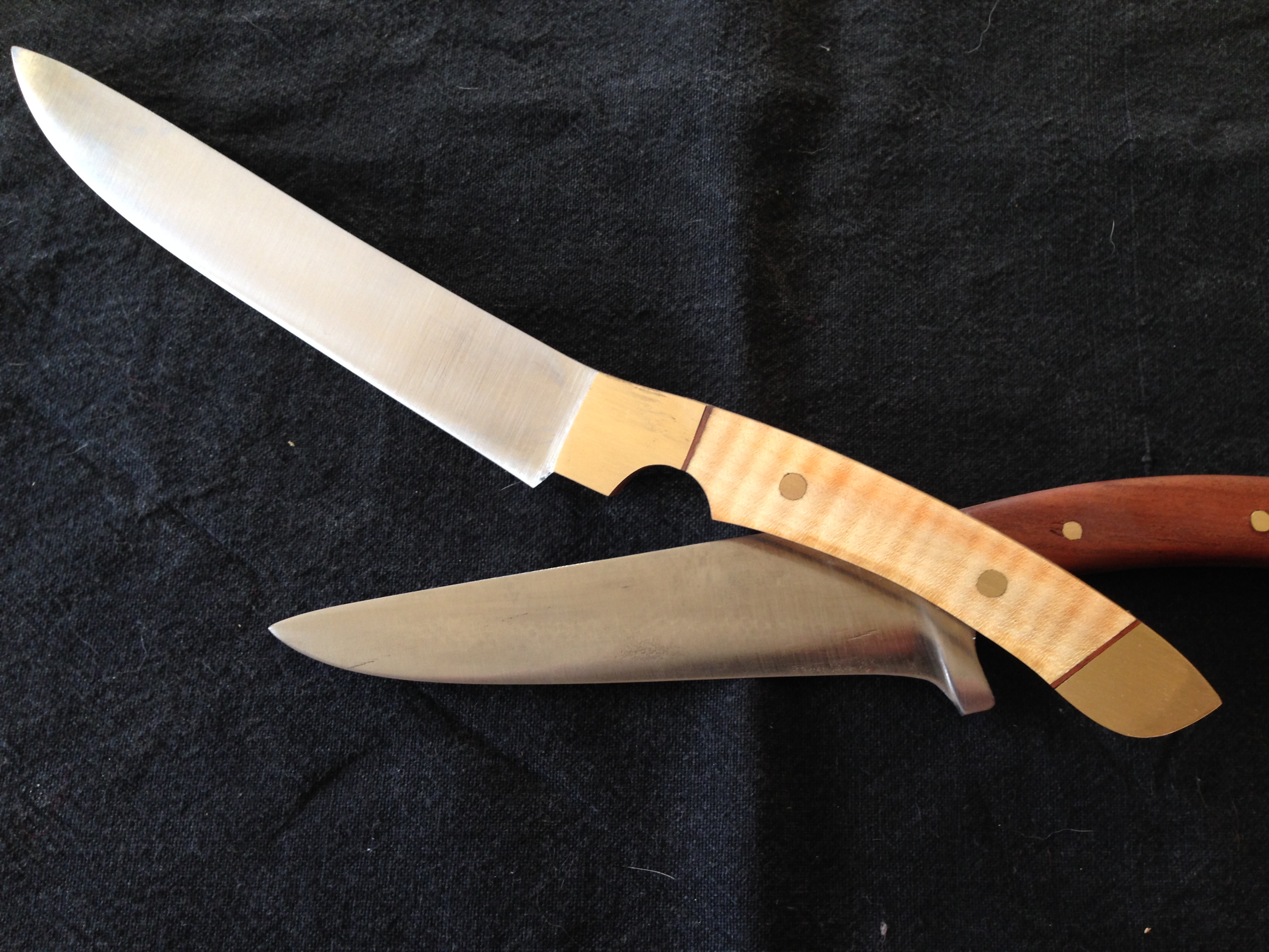

Post by Gwion » 22 Aug 2016, 11:47 am

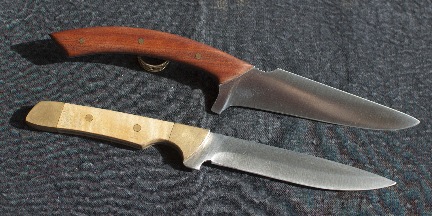

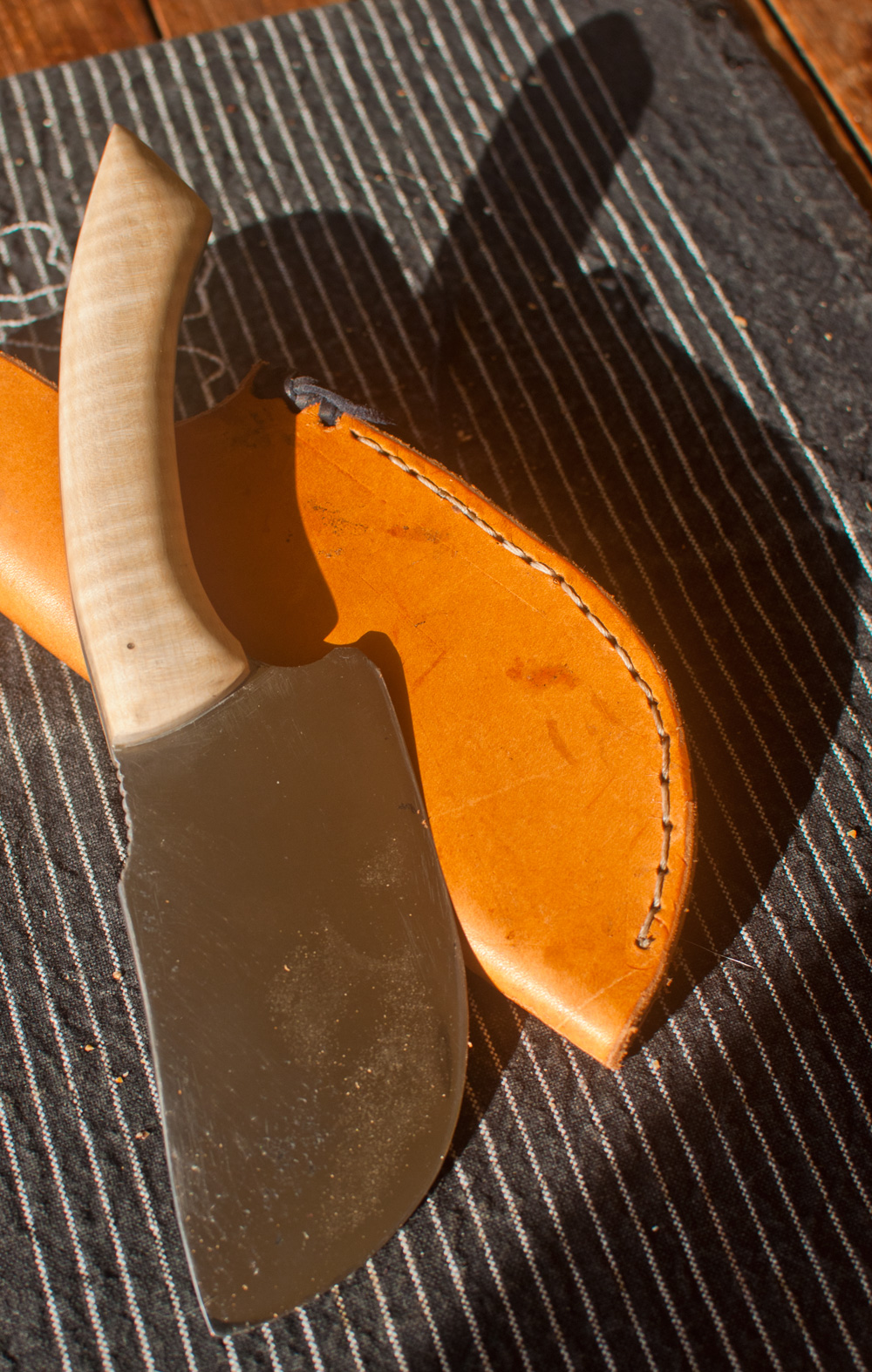

So, I finally got around to taking a better pic. The carving knife has already gone to it's new home.
Over a few beers, whiskys and a lot of bulls@*t, a mate and i drew up what we thought would make a pair of good knives for home meat processing for sheep, pigs, cattle. This is the result.
Paired up.jpg (548.37 KiB) Viewed 7432 times

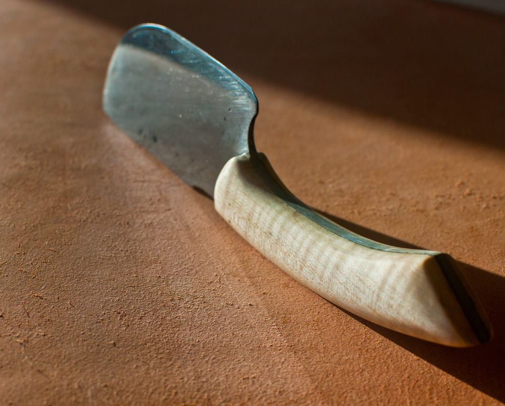

And below makes the trio. This one is for skinning and fleshing large hides. I made this one entirely by hand... no machinery... then i bought a belt grinder! :lol: :lol: :lol:
