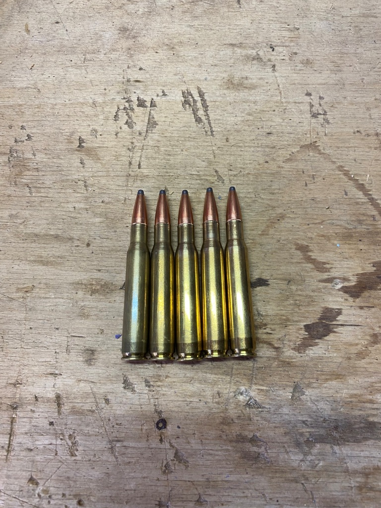

Loaded up my first batch today. Nothing special, just a reduced (60%) load of 2206H under a 150g interlock for gits and shiggles. The only difference was I used my bench bottle capper to seat the projectiles rather than banging it in with a hammer (lee classic loader), it worked a lot better than I expected. It did take a bit of friggin around to work out the rifles max COAL with a couple of different methods and 2x DIY bullet comparitors. It seemed a little short, but could be just me. Interesting that it appears that the 168g Hog Hammers are jammed into the lands in my rifle - not sure that's all that good seeing as they're copper monos.
As an aside, at what stage to reduced load shells need to be kept seperate from full loads? These are once fired (in this rifle) shells.

Why is the one on the left so blue?
Caper is a good idea. But don't be afraid to use the hammer. A plastic/nylon hammer is ideal or a small wooden mallet.

Oldbloke wrote:Why is the one on the left so blue?
Not sure why it's blue, must be a light artifact as it's no different in the hand.
I hear ya on the hammer, I have a small nylon hammer that works well and I'm sure x00'000s of rounds have been loaded this way, I just don't like smacking something designed to go off with a bang :lol:
