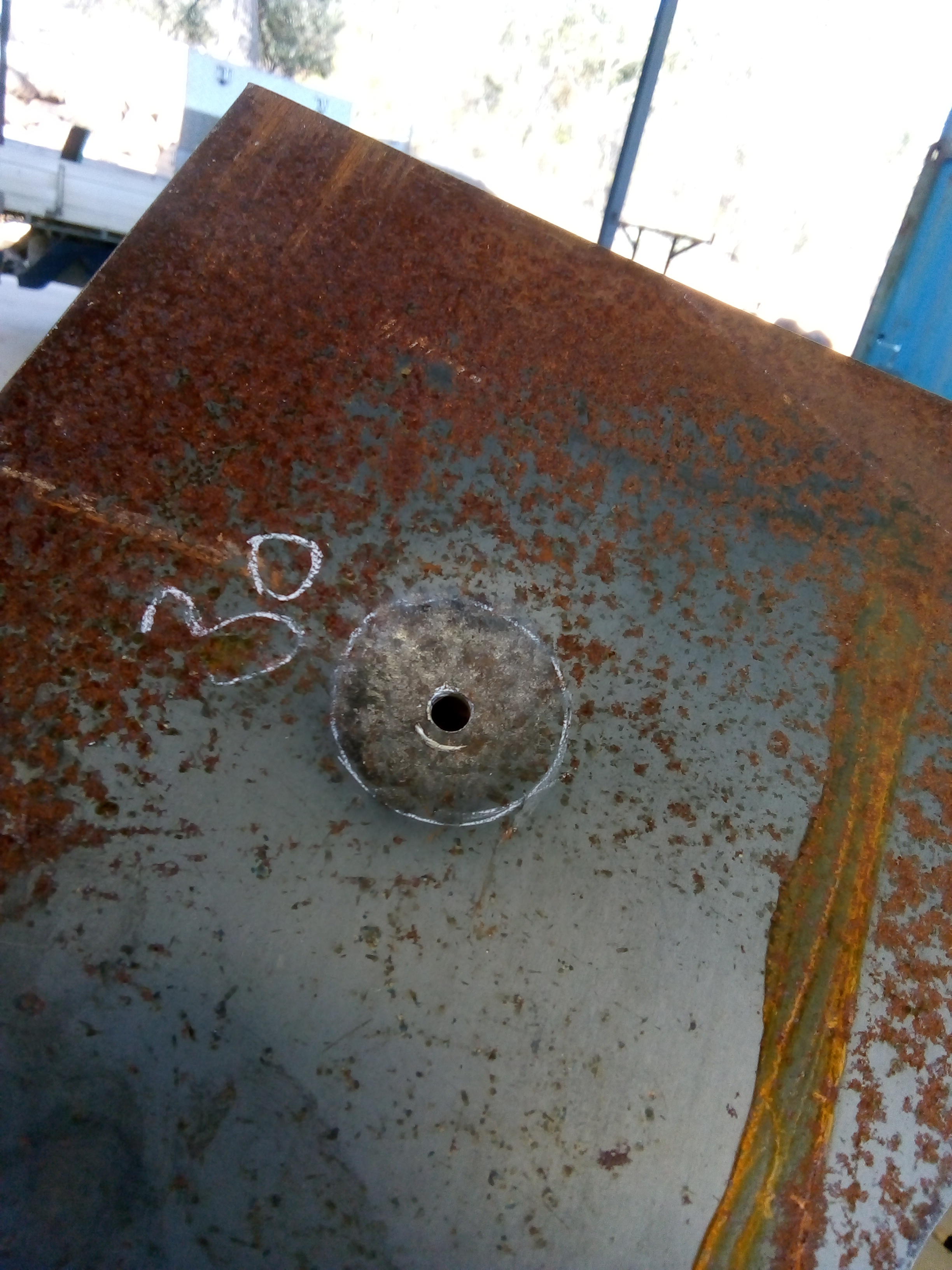

Roughly cut out with angle grinder
Drill hole for tang
Sheet metal with concave hammered in

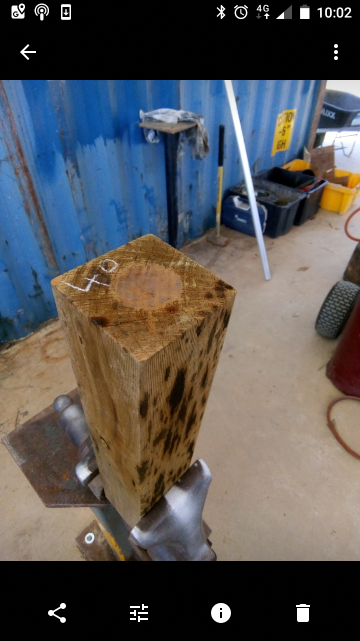

These are the only pics I could upload. Unfortunately some important steps had to be left out and I forgot to put them in reverse order.
Anyway Stix, get a piece of hardwood and draw a 40mm circle on the end grain. Using the round pein end of a ball pein hammer, beat a concave dish shape 40mm round using your 40mm circle as a guide....go about 5-6mm deep in the centre.
This is the 'die' if you like. Draw a 30 mm circle on the sheet metal, place it over the wooden concave die and, while holding the sheet metal firmly with vice grips or similar, beat the sheet metal into the timber concave.
The reason for the 40mm die is so you'll end up with a bigger dish than you need and can be pruned down to size.
Not sure why these 3 pics are the only ones that'd upload... took about 10 shots!

Here's the indented timber die

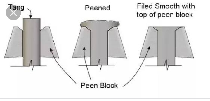

So in the schematic pic posted by Pete...all logic tells me that the "peen block" is going to be the end cap ive peened out...yes...?
Im not sure the wood will take a good punishment to completely peen it out...so i may resort to the tack weld as sugessted earlier & grind flat.

Dont weld it to the tang,you'll ruin the temper at a critical point. Make the hole for the tang slightly small the tap it on with a hammer and a bit of pipe for a tight friction fit.
Peening on sword pommels was usually done before fitting the handle.

Pete's diagram is probably an easier way than folding the tang over but will have to be done with the front end of the blade well supported. Again vertically in the vice.

And the peen block is the butt plate/pommel as you asked.
