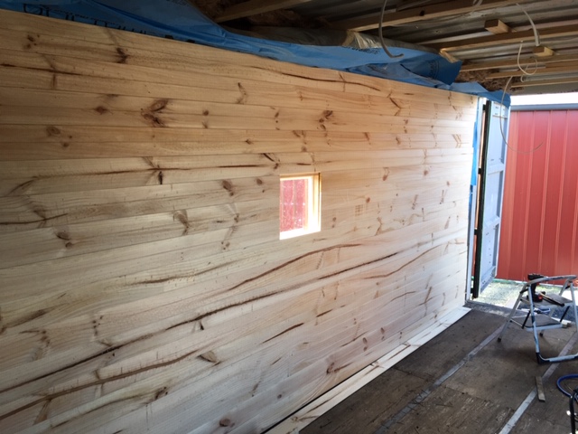

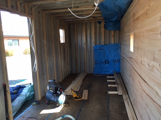

Hey guys...before i went away on the weekend i was in this building thread where the guy was lining a container... :?
You guys got any idea where it went...?
Im sure i last seen it around here somewhere... ...now i cant seem to find it... :unknown:
All i can see is what appears to be a couple of old bike tyres, a motorbike chain, & an oil stain on the concrete... :problem:

One of the best woods for so many purposes that is relative cheap for what it is. I have found is Formply it is 17mm strong and it has a coating that makes it flat no need to paint and is waterproof to a point. There are a couple of grades but not a huge difference in price between the structural and no structural.

Formply is excellent, but significantly more expensive than 19mm particle board flooring. Where I am, the 19mm Yellow Tongue retails for $47 for a 3600mmx900mm sheet, 17mm Formply is $55 for a 2400x1200mm sheet. $14.50/m2 compared to $19/m2. The Formply is also only available in 2400mm sheet lengths. The Formply is certainly much tougher than the Yellow Tongue though, and a bit lighter.

Good suggestion Sungazer... :thumbsup:
Im a great fan of ply, its very strong even without being structural...
The shelves of my reloading bench are all from left over form ply--easy to dust (yea rite...like i dust anything :roll: ), & cant see all the gun powder dribbles easily (until i put my glasses on anyway)... :lol:
The biggest issue in choosing between these 2 man made prodocts is coating...
The structaflor has a wax type coating, so if you want it painted this needs to be stripped off...its a simple process, however wouldnt be my favourite thing to do with a lot of sheets.
Personally, i think it would be best done with a floor sander prior instsllation.
You'd get all sheets for a contsiner done in well under an hour this way... :thumbsup:
You could then get away with painting ot in an self priming exterior acrylic paint like a good dulux weathershield if wanting one simple product.
Or use a good interior paint & sealer/undercoat for better cleaning ability...(so the "Stix woz ere" i write on the wall in deer blood with my finger while im down there building it for you can be easily removed with a sponge)... 8-)
With form.ply, you dont "need" to paint it...but then your stuck with black walls inside...
If you dont want black walls, painting form ply is a hassle...you have to cut (etch) the surface with a sander, remove all dust properly, then prime with a high quality primer, then top coat in whatever you choose.
Preperation is key (haha--funny pun rite there...! :lol: ) if painting form ply--remember its is designed so stuff DOESNT stick to it...!...so like painting steel or alloy, if prep is not done right, coating will de-laminate pretty easy & leave you feeling pretty disheartened when the paint peels off in sheets ...

I’d just like to say on some type of official type forum - VJ pine line can get rooted. I hate it. It bends in 6 dimensions and doesn’t ever line up...some boards don’t have a groove, some don’t have a tounge, some have 50/50...that being said, one wall done...I hate it. I hate it. I’m going to farkin shoot it!

Looks like you got a very nice result though :-)
I've found with any T&G flooring it's worth paying more for best quality. We bought a pile of 300mm teak T&G tiles cheap left over from a big job to do the whole house. What a nightmare that was! We ended up having to cut them to size and recut the tongues and grooves on a router table. The result was nice but the job was several times more work than it should've been.

Your 100% correct. Same going on here...and same with the actual body of the container.
I bought a middle ground container thinking it would be straight but it has dents in it in many places...dents that mean nothing at first glance but mean everything when trying to string line the studs on the walls...you save some money buying less than perfect but then spend more time getting things right...
At the end of the day, this will be a stay over base camp / office / maybe even an air bnb if ppl are game lol, so I want it reasonable but it doesn’t need to be perfect...that being said...when Stix ends up getting to tassie for his first fallow hunt in the snow, he will need somewhere warm to get back too :-)
