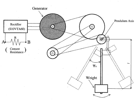

Here's another concept to get the creative juices flowing...
Imagine pumping 5000L of water into a tank that's fixed at height to a system of levers and pulleys. That's 5 tonnes that can be multiplied several times by leverage.
Once the weight is at the end of its stroke it can drain and be easily reset the it's maximum height.

Re: Solving the worlds energy crisis - 1 step at a time...
Post by TassieTiger » 16 Oct 2020, 7:51 pm
That’s Awesome oow - it’s that kind of collaborative thinking that does mount up. And very interesting link - I’d hope prices are a bit better today - but it shows what’s possible.

on_one_wheel wrote:Here's another concept to get the creative juices flowing...
5 tonnes is 5,000L not 50,000 you typed. I assume it was a typo. So is the picture a.... type of perpetual motion machine
I think you need to see Specsavers, and the perpetual motion machine is in the picture below
Mate, FYI energy cannot be multiplied. It can only be changed/transformed.
In this case (the image) it is changed from one type of energy, motion to another type of motion energy (rotory).
And there will be further changes (losses) to heat in the form of friction. (Bearings and air resistance)
https://www.sciencedirect.com/topics/en ... -principle
Thus the reason to utilise the excess solar energy for something rather than nothing...changing the energy to something useful and if the excess cannot be stored in electrical form, then what better way to utilise it than storing it as mechanical energy for use when most needed...
