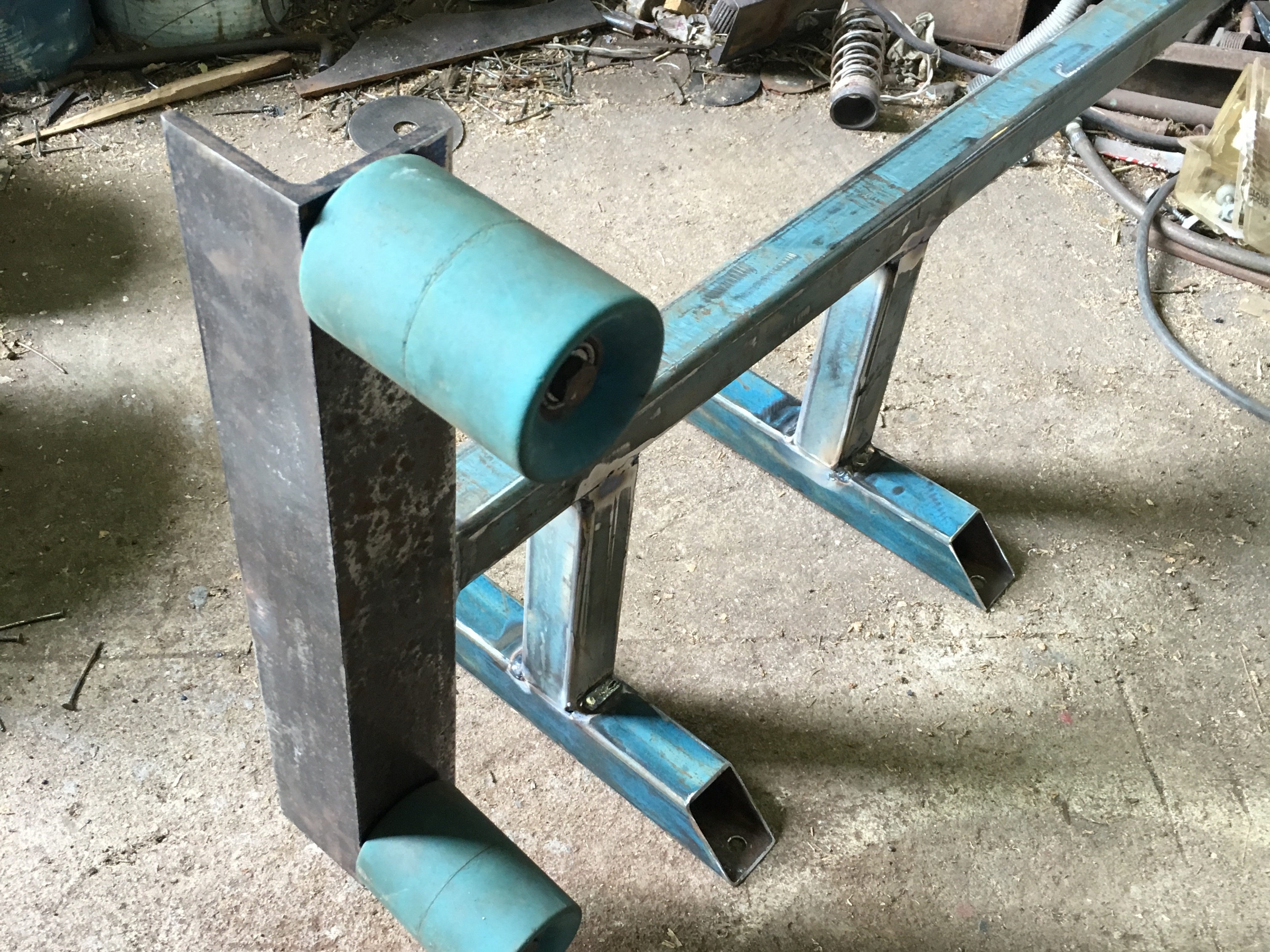

How are you going to do the tracking adjustment ?

darwindingo wrote:That's going to be a beauty, can't wait to see it in action. :clap:
the idler wheel will swing a little with screw adjustment.

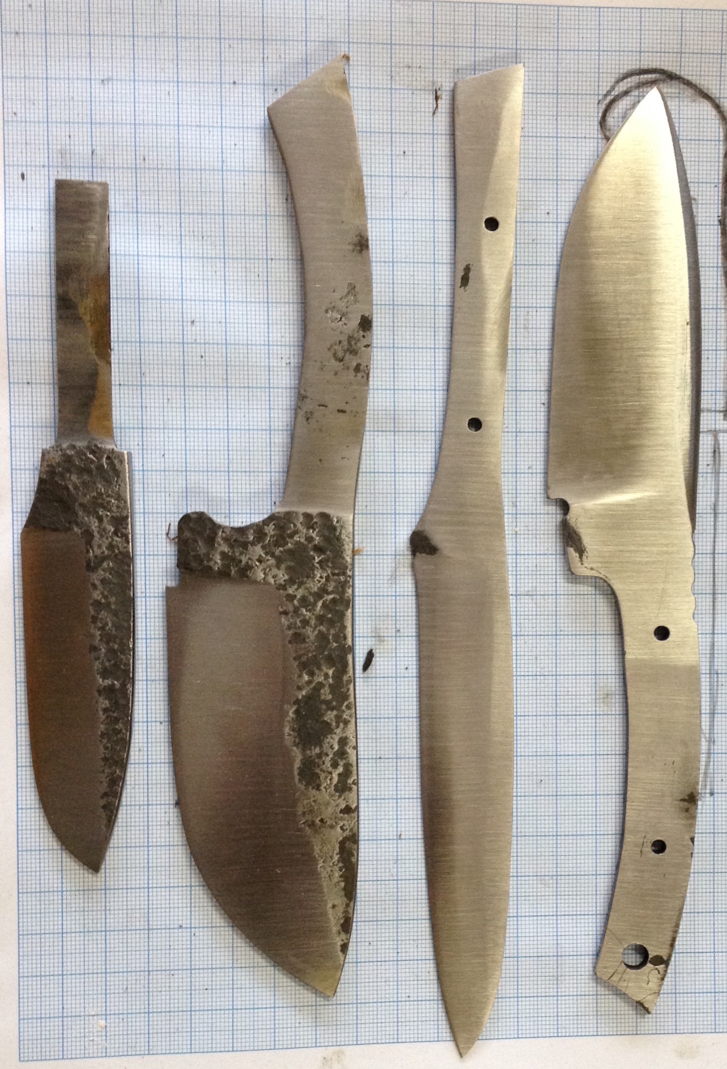

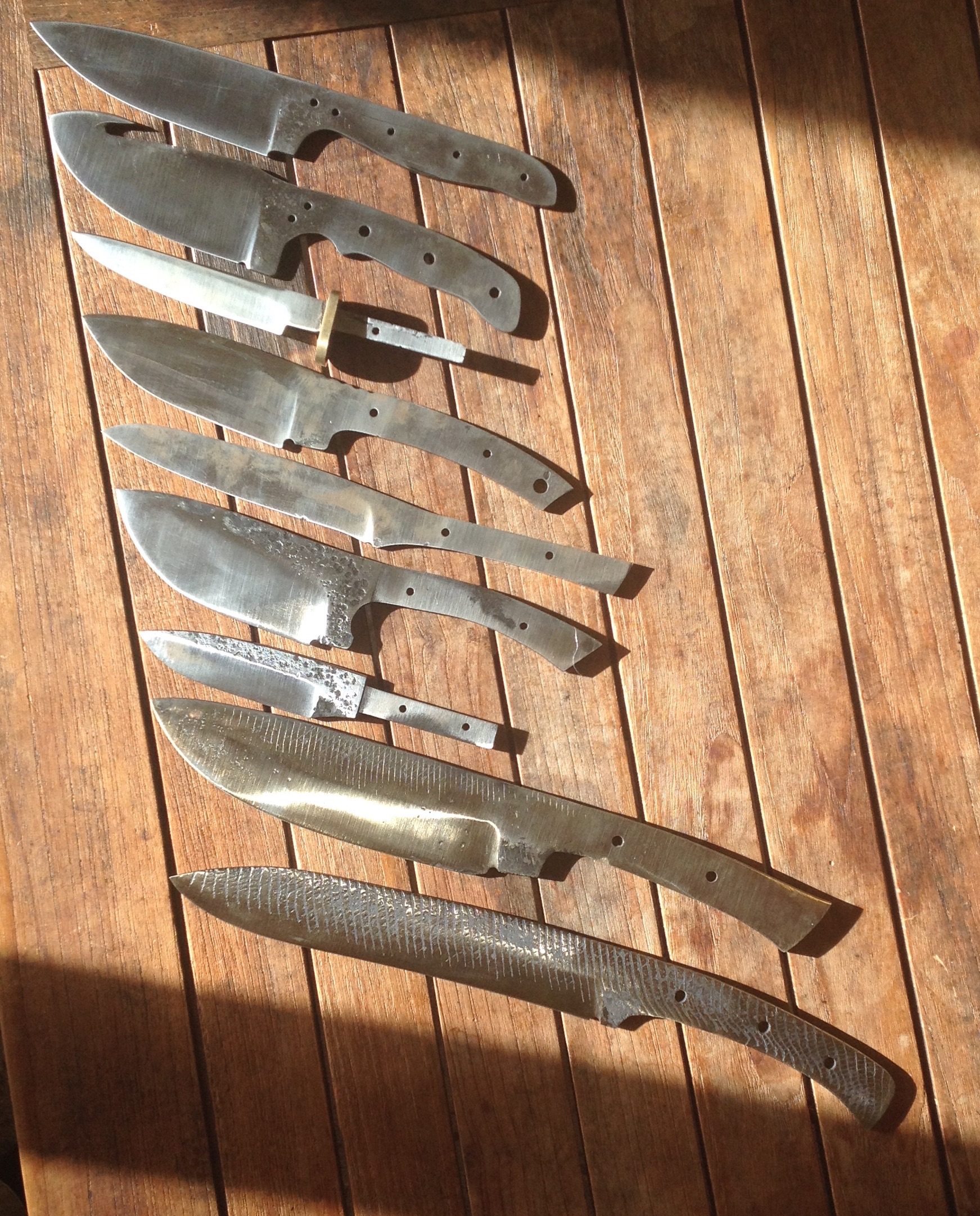

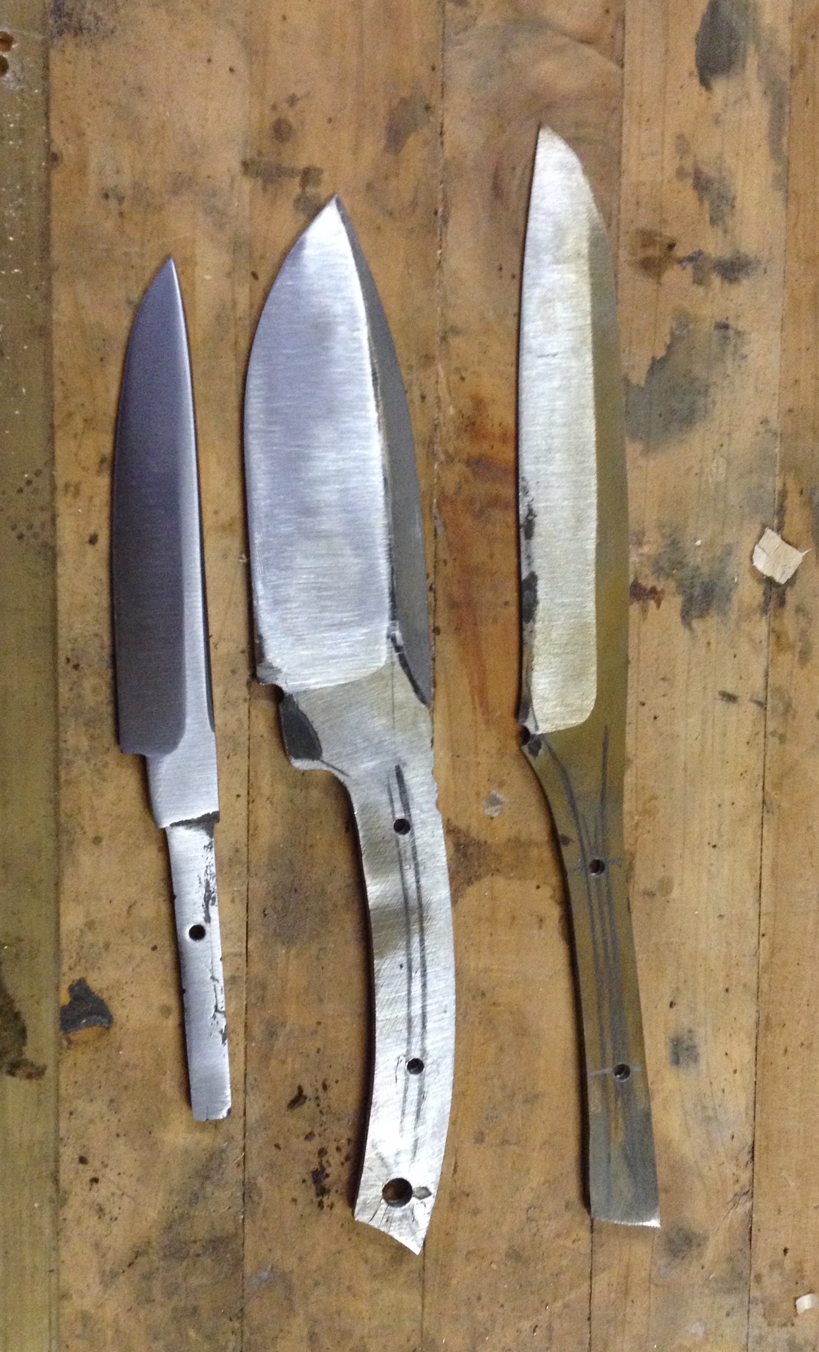

Well, bladesmithing season is upon us!
Here are some I've been working on. Trying to get a bunch up to polish stage and then fit handles to them all. I'm also working on a simple design that is easy to knock out for the test knives I promised last season. I'll make 4 in total.
Pics below.
Top to bottom: weed slasher to go on a long handle like a small pole arm, the two I was working on last season now heat treated and tempered, failed kitchen knife (tang too thin), small utility knife, medium camp knife ready for initial grind, kitchen utility.

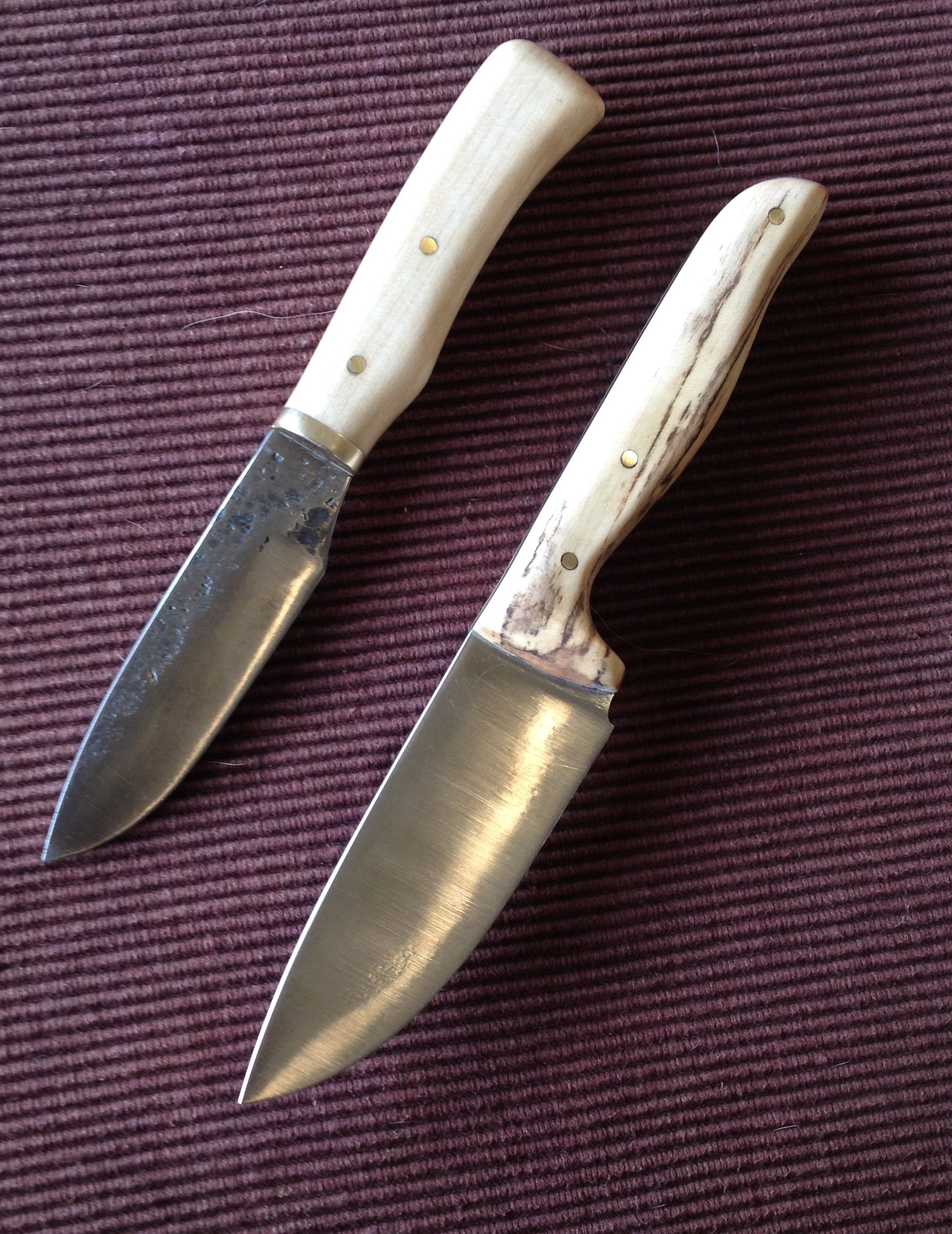

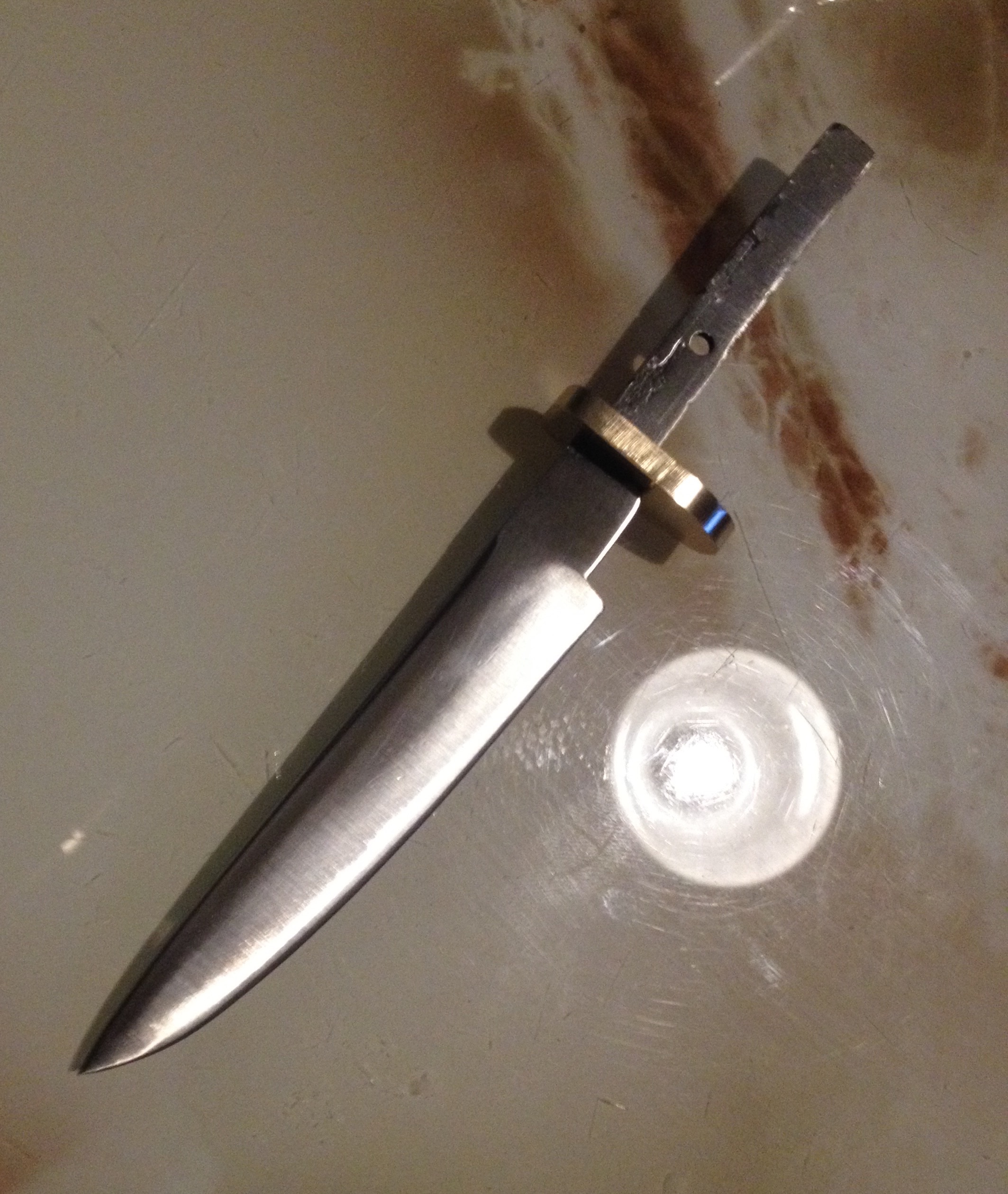

Small utility, medium camp and kitchen utility ground and ready for hardening in the forge/quench.
Small utility polished, hardened and bolster fitted waiting for handle.

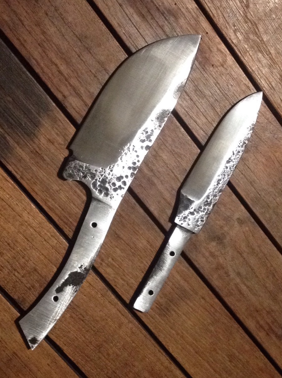

Skandi utility rough ground
Rustic skinner forged and rough ground
Re: Knife Making
Post by Gwion » 17 Jun 2017, 9:24 am
Skandi & skinner ready to harden, medium camp and kitchen utility polished and waiting for handles.

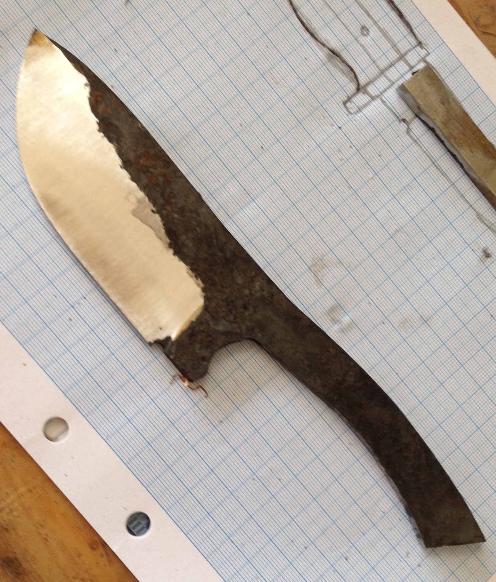

Farrier's rasp being forged into a heavy camp zombie slayer :lol:

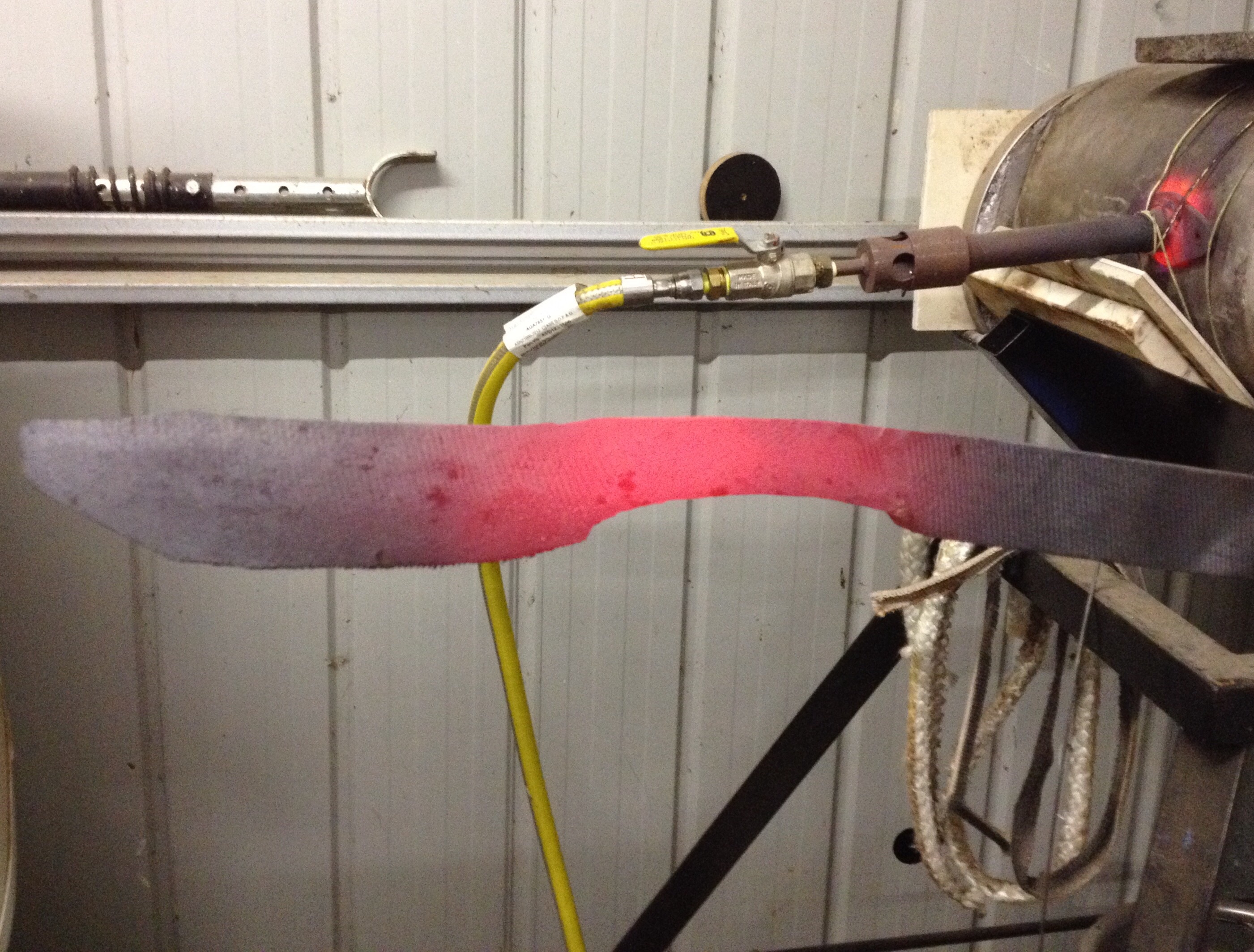

Re: Knife Making
Post by Gwion » 17 Jun 2017, 9:31 am
Skandi & skinner ready to fit handles.
Zombie slayer hardened, differentially tempered and ready to take an edge and test. I think it's a bit heavy and will grind down the bevels more and reproduce the hilt a touch before it is finished but want to test toughness and edge retention first. I think I kneed to make a longer, narrower version for extra zombie chopping reach! :lol:

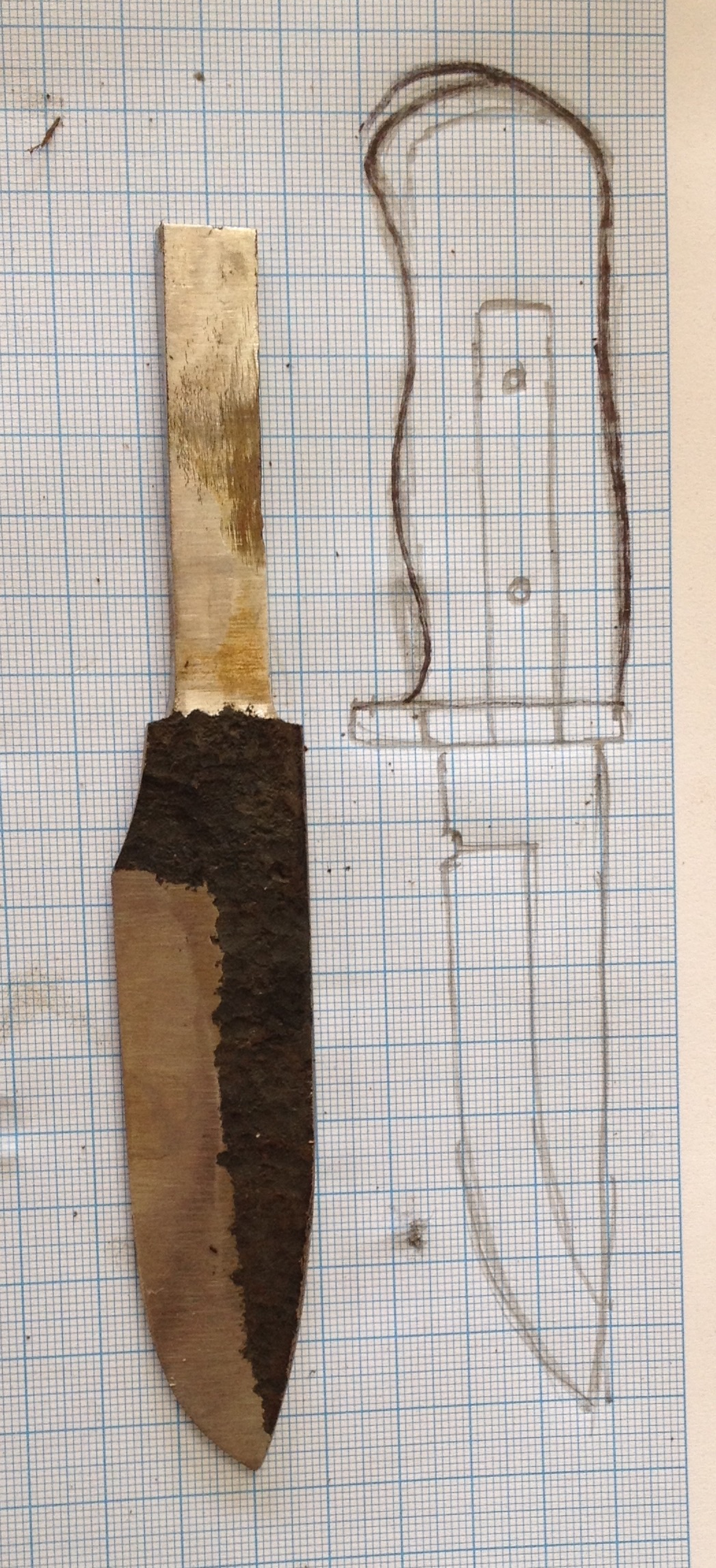

It will be at least a couple of weeks before I get handles on any, mate. I'm ordering some phenolic resin (heat cured resin) to vacuum impregnate some maple and Blackwood for scales and handle blocks. Got all the gear, just need the resin. It will make the handles tough as nails! I'll do extras and sell some. As you know, I have some pretty speccy timber that would make some A-grade blanks for handles and other pieces.
If you're still keen for the knife when it's done, your name is on it! :thumbsup:
That kitchen knife was just ground too thin across the spine and the tang/blade join got down to about 1mm. Not worth finishing due to questionable strength. I do like the shape though.
I have a number of knife shaped pieces of steel that ended up too thin because I forged them out too far (and unevenly) before going to the grinder and lost too much material correcting warps and wobbles.all part of the learning curve and my forging skills have improved a lot. You don't learn by getting things right; you learn by screwing them up!

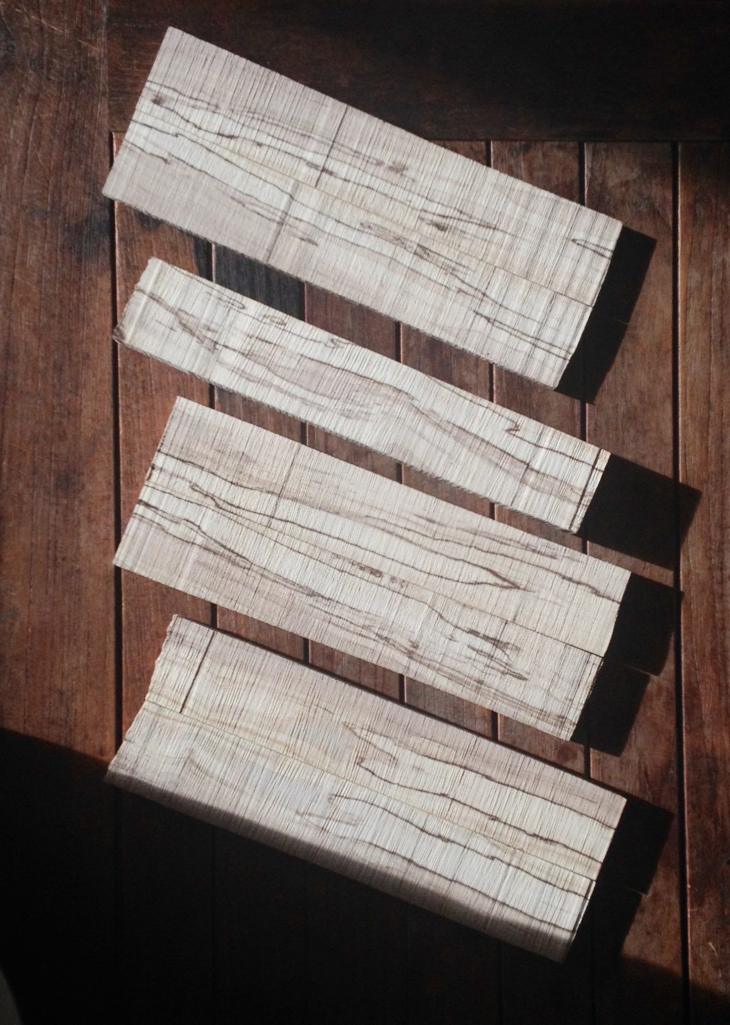

Post by Gwion » 21 Jun 2017, 2:24 pm
All waiting to be put together and finished off. A few detailing decisions to be made. Resin is ordered and on the way.
Re: Knife Making
Post by darwindingo » 21 Jun 2017, 6:54 pm
Gwion wrote:All waiting to be put together and finished off. A few detailing decisions to be made. Resin is ordered and on the way.
Looking good mate :thumbsup:
How beautiful is that spalted maple :D That spalting will POP even more once subjected to the stabilisation process :D

Post by Gwion » 21 Jun 2017, 7:02 pm
Sure will!
Just got to pick the right bits for the right knife. I should get a few knives out of each piece. They measure about 240x60mm. Possibly 4 knives per blank on the smaller handles.

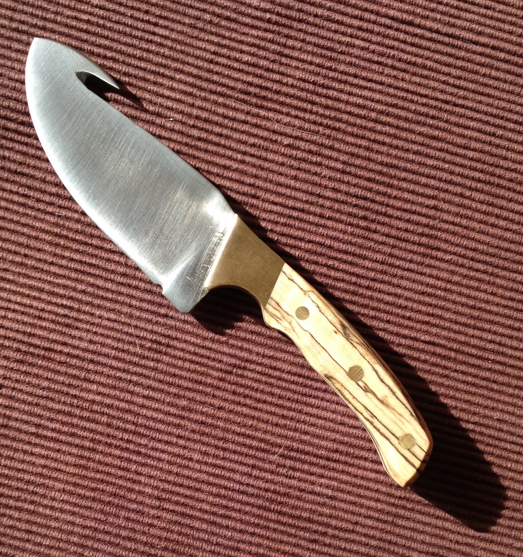

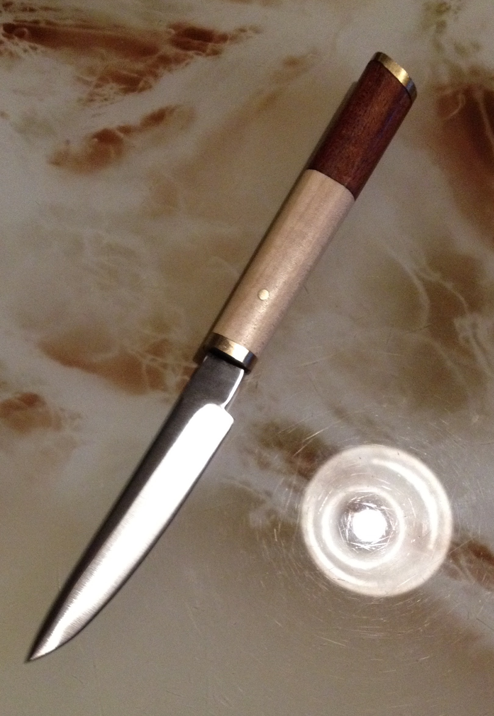

Post by Gwion » 22 Jun 2017, 9:48 pm
Very happy with this!
Also, phenolic resin arrived today so it's all coming together now! :thumbsup:

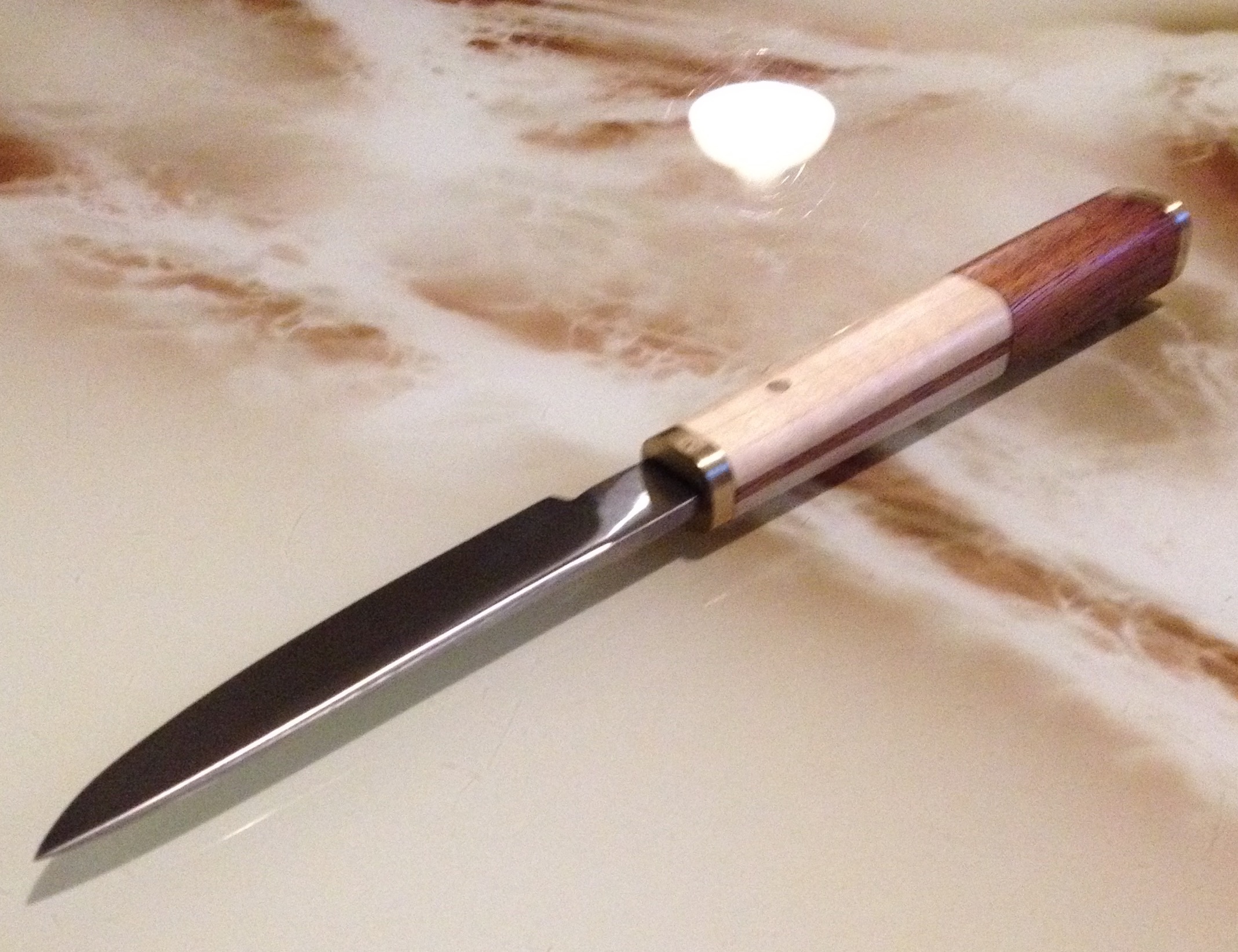

Post by Gwion » 07 Jul 2017, 7:16 pm

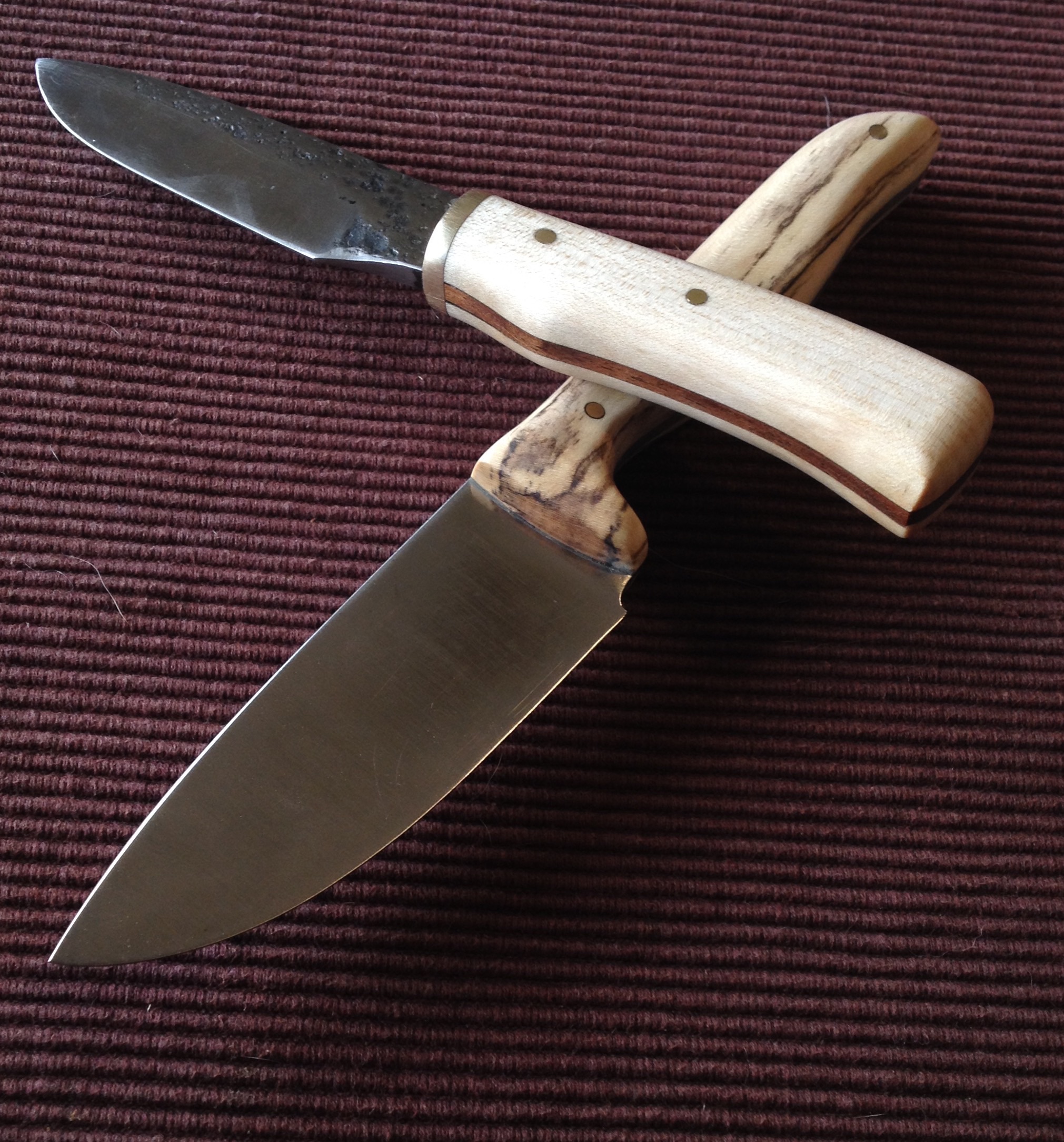

These two nearly finished.
The smaller skandi grind is my interpretation of a traditional Nordic utility knife. It was made for a cousin who does medieval reenactment and she wanted it for her Viking costume.
The broader blade is made as a prize for our rifle club 'dead eye' competition. The 'dead eye' total goes to the shooter who most consistently pits their first bullet of the day in or close to the bull over the season. When you shooting different ranges every week it's not so easy and forces you to really plan your shot (I came second, by the way! :P ).

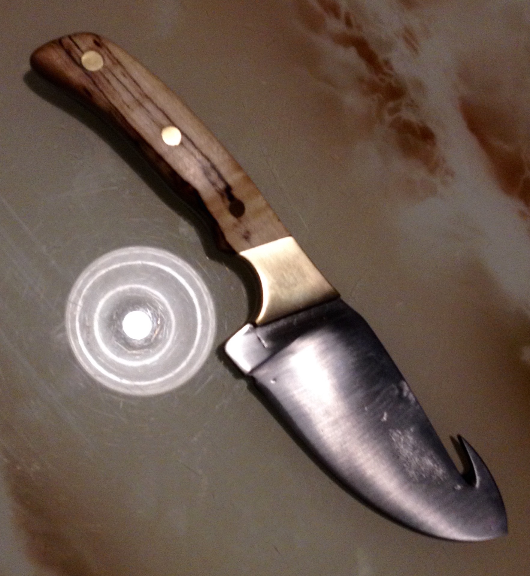

Post by Gwion » 08 Jul 2017, 8:21 am
Thanks mate. The 'Dead Eye' will be engraved with winners name, year and 'dead eye'. The comp, as of this year, has a perpetual trophy and a medal for 1st, 2nd, 3rd to be won as well. Last year was just a knife. I instigated the comp to encourage people to pay more attention to dope and conditions rather than just being lazy and relying entirely on sighters.
The skandi is a bit heavier in the spine than it needs to be but I'm happy with all in all. None of these will be 'perfect' but show a definite progression of my work and skill.

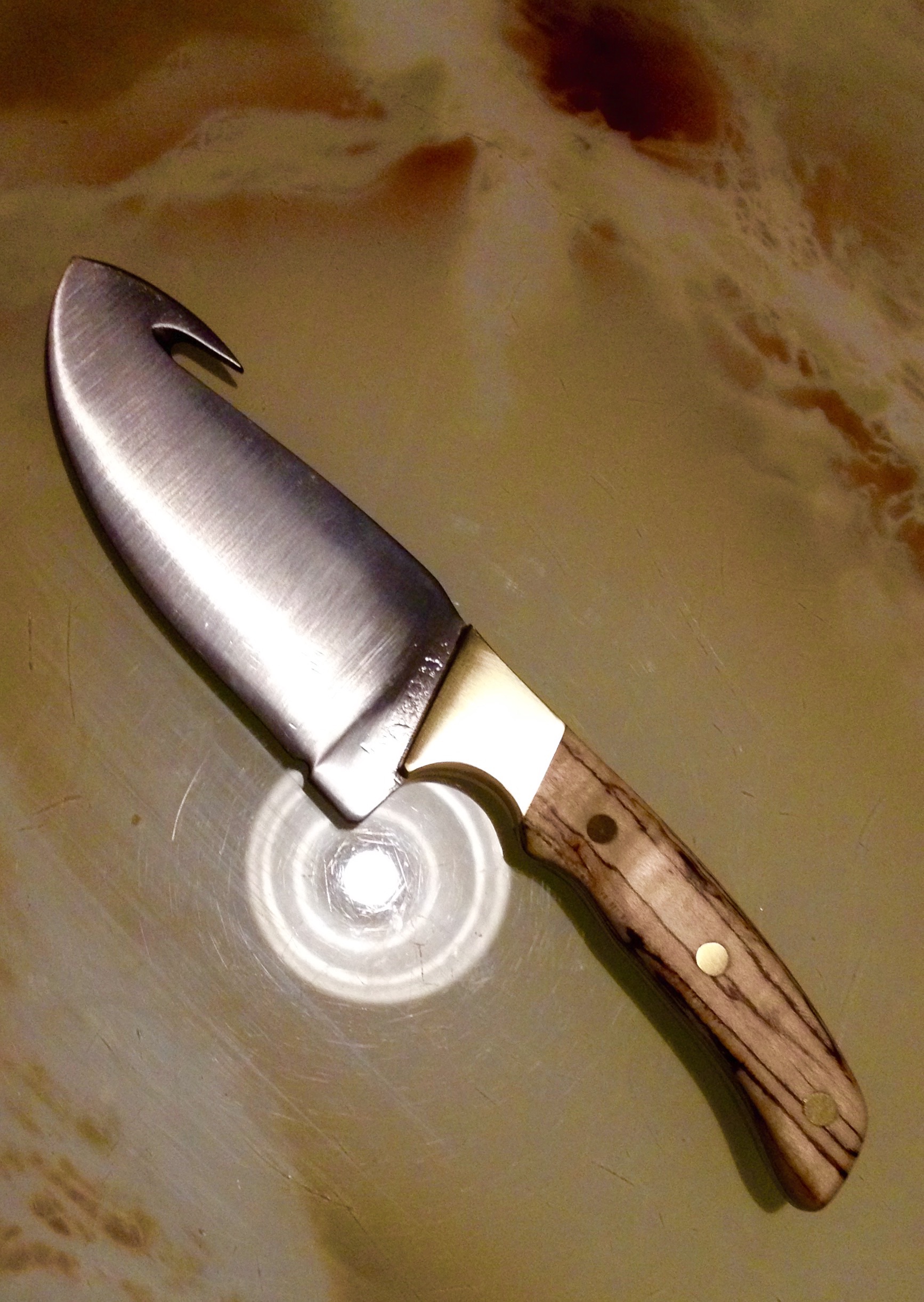

Re: Knife Making
Post by Gwion » 12 Jul 2017, 8:31 pm
Ready to go, Darwin Dingo!
Just an edge to grind and serial number to engrave. Are you a superstitious type? This is number 13 finished! :lol:
