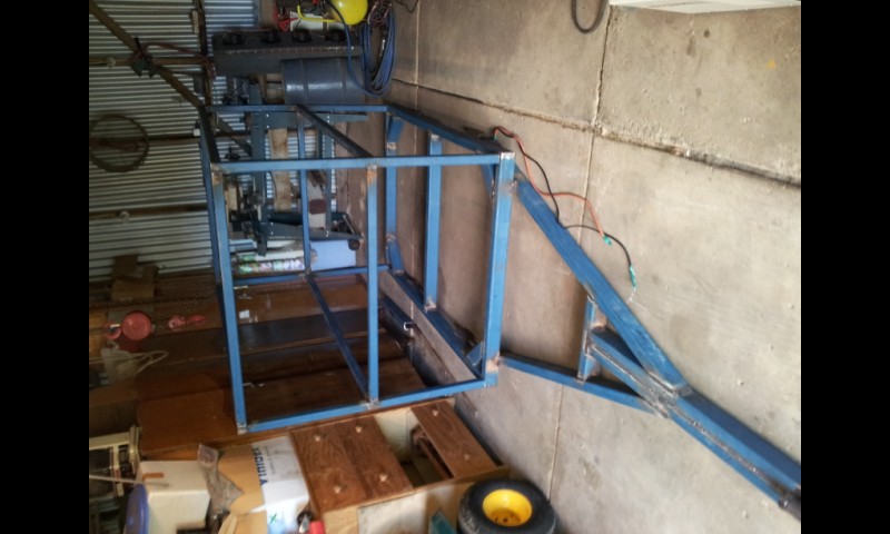

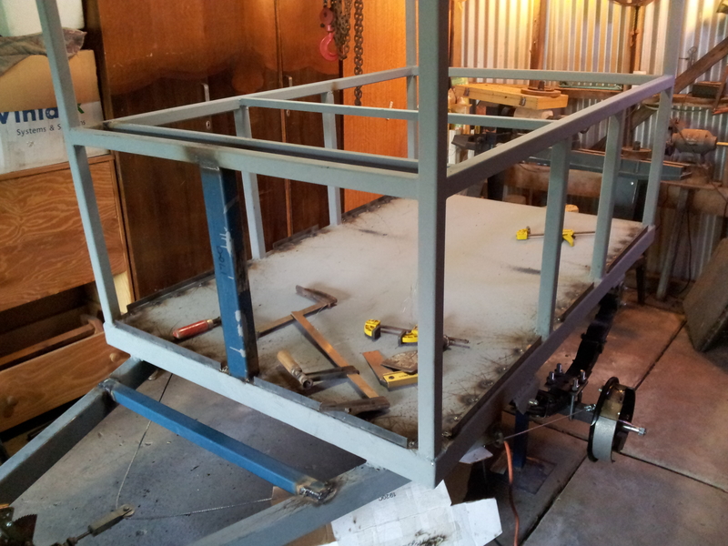

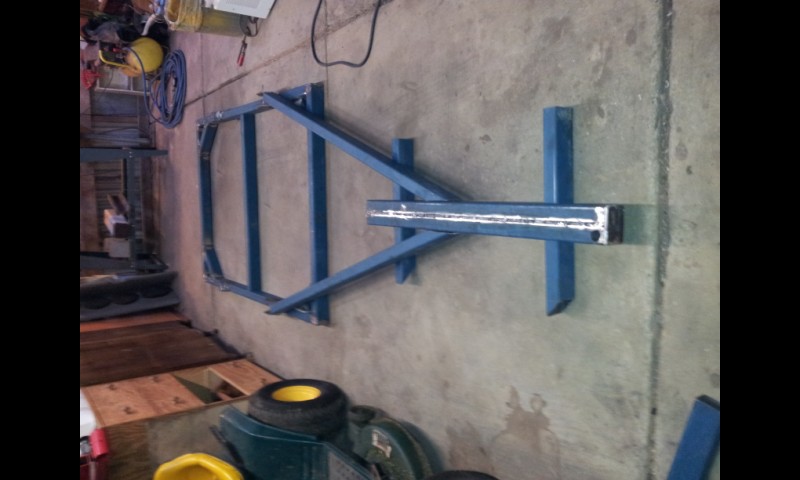

Nearly 3 years ago now I decided I could no longer live without an off-road camper trailer, and being tighter than a frog's blurter and suffering damn near fatal boredom at being unable to work, I decided to build my own.
I got about 80% done when poverty and ennui set in.
The fact that while building it, the rooftop tent on which I was basing it went from $800 to $1800 didn't help my motivation.
I don't know why the top 3 pics are showing sideways here, I have tried reorienting them before posting but they still come out sideways.
Given the dramas I'm having with my scope today, I am neither surprised at this additional failure, nor can I give an arse full of steam, so if you're interested, you'll have to turn your head.

Gaznazdiak wrote:Nearly 3 years ago now I decided I could no longer live without an off-road camper trailer, and being tighter than a frog's blurter and suffering damn near fatal boredom at being unable to work, I decided to build my own.
Time for some more moonshine.
Looks well made mate :)

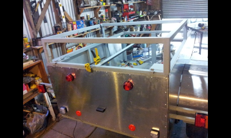

Post by Gaznazdiak » 07 Oct 2018, 11:42 am
Thanks Pete,
I wanted to try to bombproof it so I used 3mm wall tube all throught, chamfered all the welds and cold galvanized everything, I even splurged on a new welder to make the most of it.
I got an Australian made Boswell Inverter Combination. It's a stick welder, TIG, and plasma cutter in one unit, absolute ball-tearer.
Only one thing I'm not happy with is the floor. I used 3mm plate but despite clamping hell out of it and being super careful of heat expansion by welding small patches at at time and letting things cool, I still got a small ripple in the floor. I should have cut it a tad smaller and filled the gap with weld.

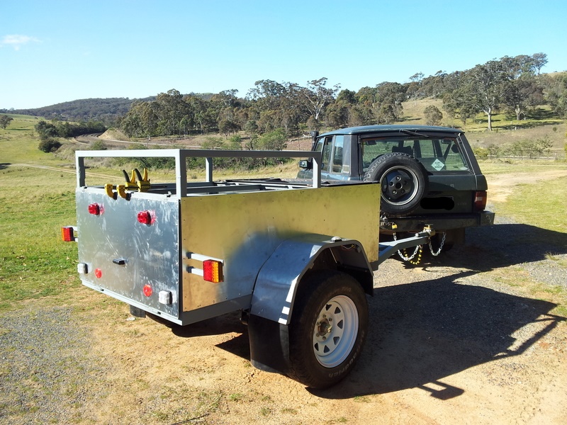

Post by Gaznazdiak » 07 Oct 2018, 11:51 am
Thanks Pete,
I learned a lot of things not to do on a previous trailer build. I got a ute tray back and built a chassis to mount the dual axle suspension and hinge mount the tray, put a compact 4 stage 8t hydraulic ram under it and a 12v pump and reservoir in a toolbox at the front and hey presto, a 2t tipper.
Heavy bugger though, 670kg tare.
I wanted to try to bombproof the camper so I used 3mm wall tube all throught, chamfered all the welds and cold galvanized everything, I even splurged on a new welder to make the most of it.
Only one thing I'm not happy with is the floor. I used 3mm plate but despite clamping hell out of it and being super careful of heat expansion by welding small patches at at time and letting things cool, I still got a small ripple in the floor. I should have cut it a a couple of mm smaller and filled the gap with weld.
