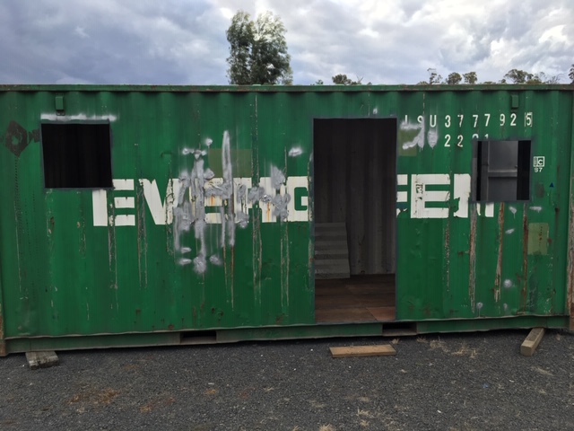

I’ve received my future shooting shack and I’m starting to sort it all out before having it relocated up the Bush.
I’ve stud lined the walls and cut windows and doors.
What is the cheapest material for internal lining? I was contemplating a Vj tounge and groove lining or perhaps a light marine ply sheeting - but I’m having a lot of shelving, bunk beds for 4, etc meaning lots of brackets on walls so large sheeting will ultimately be a pain - so other ideas?
Also - I’m going to put a 3 or 4% angled roof on the container, with railing and this will become a platform for some prone long distance shooting - but I don’t want a poor sod slipping off the darn thing, so just wondering if there is a roof product other than colourbond corrugated that might suit this application? I can put in additional rafters etc for additional support if it helps with material choice.

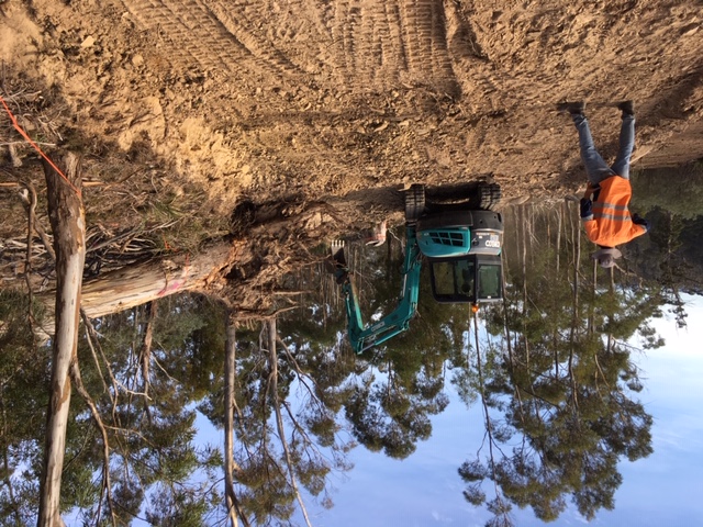

Here’s a pic of what happened 2 hours after it turned up...I couldn’t help myself. :-)
And here is initial site prep being undertaken with a hired 5t - ex. Lots of fun!
