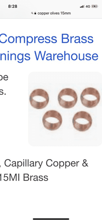

Dunc. When u say tube bushes do u mean these

What you show in pic are brass olives, not what Dunc is recommending.
Tube bushes are basically a silver solder to tube female socket transitioning to either a male or female BSP thread.
Probably the easiest high strength / high temp method would be flared compression unions, basically 1/2" [male or female] iron to comp fitting.
Very likely you will have a female thread in the mixer inlet so you would require a 1/2"MI to comp union.
