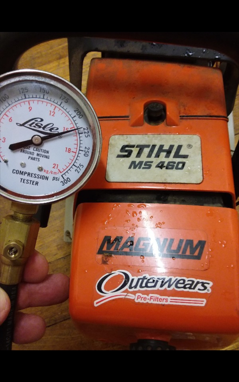

Not my two chain saws they both have good compression heaps of torque ......

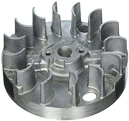

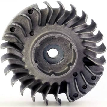

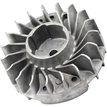

OK. I just googled sthil fly wheel chainsaw and whipper snipper. These are the results.
They both have fans. Unless the cooling fins are huge they have to have them. And don't forget 2 strokes fire twice as often as a 4 stroke. Motor bikes are an exception because you are moving.
