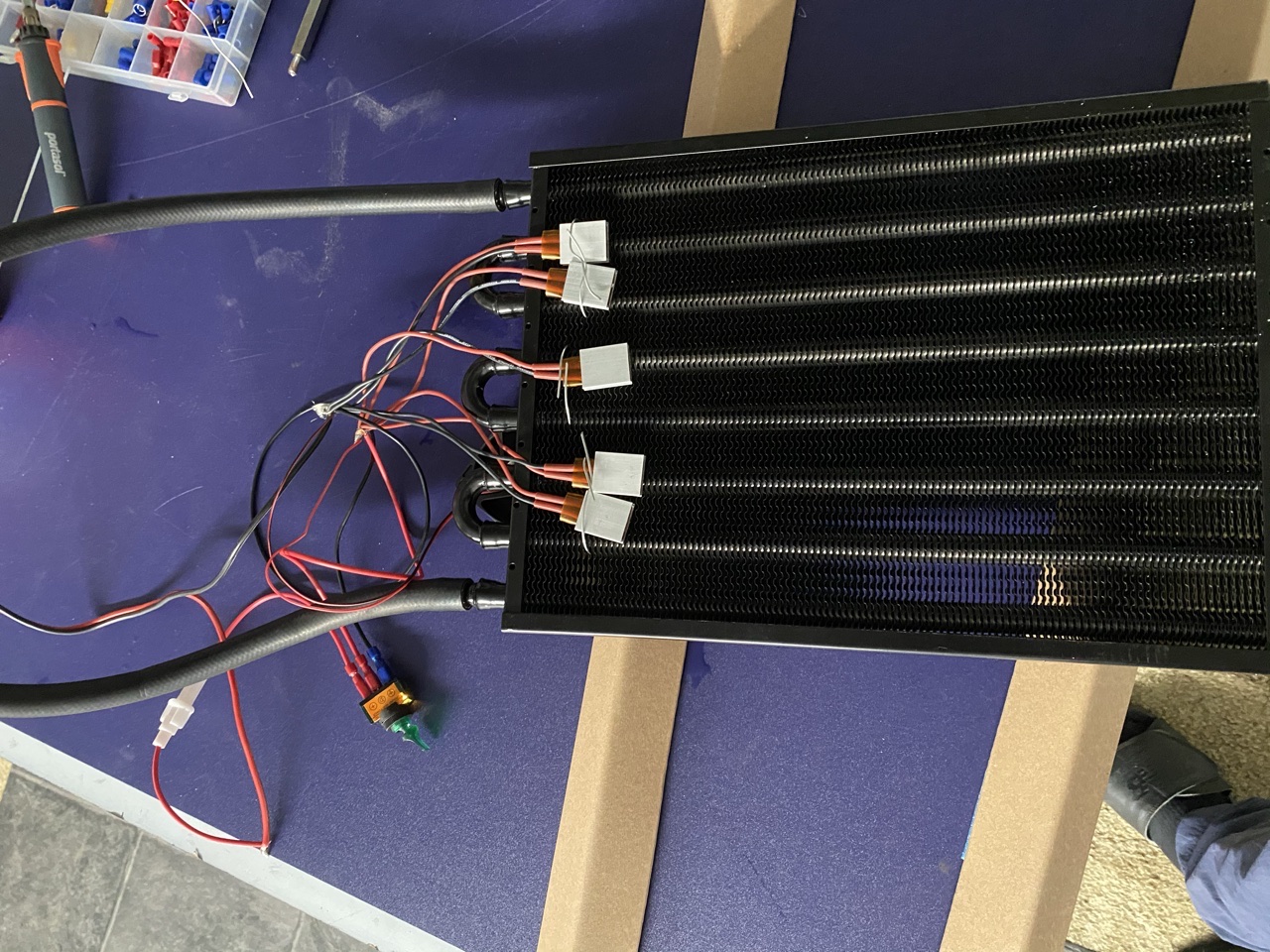

So, wanting to develop and mess about with heating a tiny house style cabin using solar / battery and if you look around, there is nothing available - it’s either gas, wood fire, 240v or massive DC draw only.
So to answer the why not questions-
Gas - don’t want to drag bottles and kids will stay here next winter.
240v - not available in middle of no where.
Wood - yes. Did wrestle with this but tiny house means small areas, hard to get a wood heater burn over night without over whelming the place to start with, and again - kids...monoxide poisoning without vents...etc.
Huge fire pit outside...regardless.
So, a few ppl offered ideas last time that I floated this and well...here I am...at this point.
5 x 28w (12v) thermistors resting on a water filled radiator with a PC mini fan circulating air from underneath.
This device when vertical, raised room temp by 7-8 degrees in an hour - but I then turned it off as worried re temp of thermistors. I need to cool them better. They were at 184 degs!!!
Note - 1 of these thermistors boiled a cup of water in 30 minutes...sounds terrible until you understand the tiny power consumed to do so. 1.2 amps to boil cup water. (Perspective = you could theoretically boil 12-16 cups of water with a single charged D cell battery!)
The thermistors total 150w (5x30w) per hour at 12v = 12.5 amps per hour.
8 hours heating for 100 amps for heat.
So now to look for efficiency - the thermistors are generating almost 200 degs C. They really need to be incorporated into the fluid somehow - ? Open one side of radiator tank maybe? The pc mini fan may need upgrading to move more air - or a second unit added. Water vs vegetable oil - not sure what would work best?
And I’m not sure if thermal dynamics will get fluid moving within the radiator or whether one end is always going to be colder...
Thoughts or ideas are welcome.

Actually glad you have come back to batteries and theses little heaters. Thinking about it a few thoughts come to mind.
Playing with 12v is very dangerous esp when you start going high amperage. A short circuit can result in fire and can burn the house down. I am sure you know, but for others who might be playing at home.
What are theses thermistors rated to run at temp and time wise. Have a look at their specifications sheet. I would think about using a copper heatsink maybe even like a cpu one with a high flow fan. Or just have a blower fan. The idea being air is taking away the heat as quickly as possible.
Put the whole setup on a thermostat with a timer. So say it runs for 20 minutes then off for 5 minutes, instead of running for 60 minutes. But you may find that theses prefer running instead the stresses of too many cooling and heating events
For your liquid component Have a search on what they use in hydronic heating systems, or radiator systems in europe.... its it just water or has some rust inhibiting and anti boiling additives.

I believe a ptc thermistor is not necessarily utilised as a heating device perse - they actually increase in resistance when heated...they are designed (I believe) to stay on rather than on / off. But I have bought a temp control switch in case too hot...
200 degs is farrrkin hot - like INSTANT burn hot, so they are going to have to be at least semi submerged...
I’m starting to think the radiator was a waste - I should have just bought a metal bowl, filled with water, dipped the 5 x thermistors into the water, had a fan blowing across top. Boiling water would not happen if I kept at least 15 litres in there...

Post by TassieTiger » 02 Nov 2020, 3:00 am
eddievic wrote:Having water will increase humidity mate.... long term you don't want that.
What i was thinking was like those diesel burner heaters, they are the long cylindrical type, but instead of burning fuel you use your thermistors to generate heat. The air flow will be enough, and they week not be easily accessible by children
Yeah - condensation would suck...that’s one reason I thought oil...but a potential oil fire is a farkin nightmare.
A guy on utube placed the thermistors between a couple of big bricks and the stone held the heat for dispersion...very simple and it worked...could store it easily as well.
I get what your saying with diesel heaters - old msn has one in his van...it’s not a bad idea. A cylinder with a same diameter fan to move the air - would be easy to mount the thermos as well...but - I’m still worried about these things potentially over heating - they probably wouldn’t...maybe that’s my next test - I bought 10 to kill off 5 ($2.90 each) in testing...it’s hard to believe how hot they get.
In fact, I bought a 12v kettle a while ago and smashed it in a fit of rage as 30 mins and water was at about 40 degrees...these 2,90 things would be 20 times more efficient.

I’m confident the elec will work, just needs some smarter ppl to kick some things around...and if it does end up coming off - then, I’m sure someone, somewhere, will also benefit from following the “concept”.
I think I’m going to leave a thermistor on for couple hours and just see what happens...I’ll do it away from house / shed...if it burns out or sparks - they will be history!

Agreed - the low draw elec heater doesn’t really exist. It may well turn out not to be viable - but, thus far, it is promising.
I don’t know how old the idea of PTC thermistors is ? if it weren’t for them, then I’d not even attempt this - but they are, pretty darn efficient as already mentioned. 28w for 200degs c...I’m absolutely mind blown how hot they can get from so little power, it’s really quite amazing - but - how long will they last at 200 degs? Being a ceramic resistor, I’d assume a decent time but I know very little about these...
I like the copper pipe heater idea - I could actually twist this and do similar, using the thermistors in place of heating element - similar to Eddies idea. How did you regulate the water element and I assume it was mains ?
I don’t sleep all that well (never have) and end up just thinking about different problems and potentials and all manner of wild ideas and s**t all bloody night...this is but one that grew some legs lol.
Ps Eddie - I researched re turning thermistors on/off and apparently, that will kill them / they have a finite no of cycles available per unit. So with that in mind - 2 options. Try and burn one out on purpose to understand life of, or semi submerge the units constantly to control the heat.

If your PTC's are not the silicone type, then they are self regulating, they'll heat to a pre-determined resistance then shut off until they reach a second pre-determined resistand value, where they'll fire back up.
I'd still go with the concrete block, but cast my own with the thermisters inbedded (the more inbedded the betterer) in them. Then build one of those stove top fans using Peltier as the power source for the fan motor; https://www.youtube.com/watch?v=ML0JQENP6IQ Just don't cast the block so big as to not be able to easily move it around so that you can place it outside in the sun, or next to the fire firepit when you first arrive up at the cabin, this way you are using an alternative free source to bring the block up to temp from cold, thus saving on your batteries.
