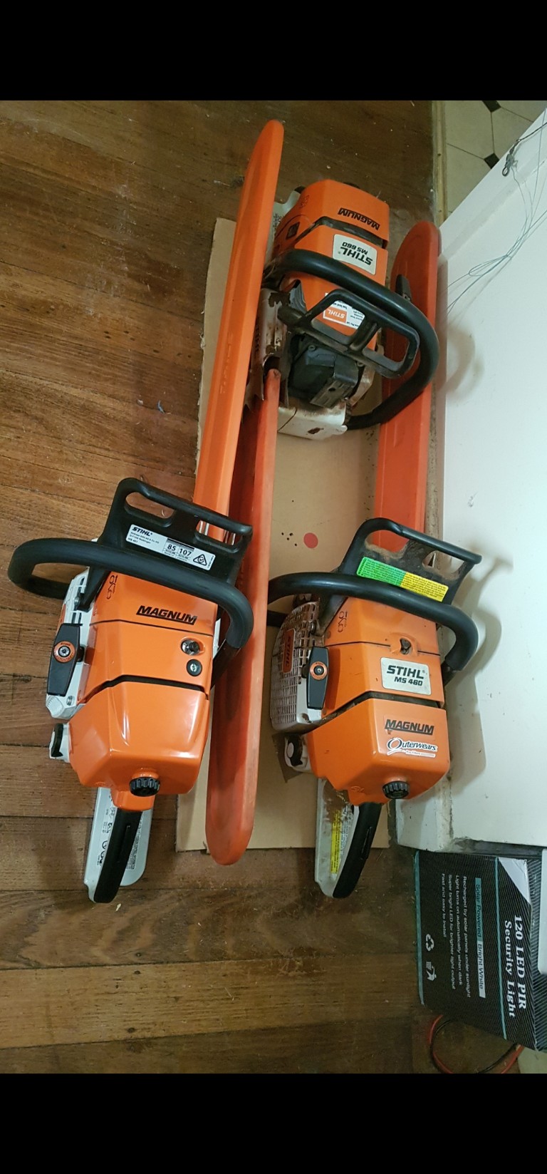

I was going to make a bit of a statement but these are my secateurs I have a very clean yard and a very warm house.
Oops I also have a 261 that's not in the pic coz it's in the lux .

deye243 wrote:I was going to make a bit of a statement but these are my secateurs I have a very clean yard and a very warm house.
Noted for future reference thanks deye. I have a bush, four actually, that all need trimming, so something like that would be handy :thumbsup:
