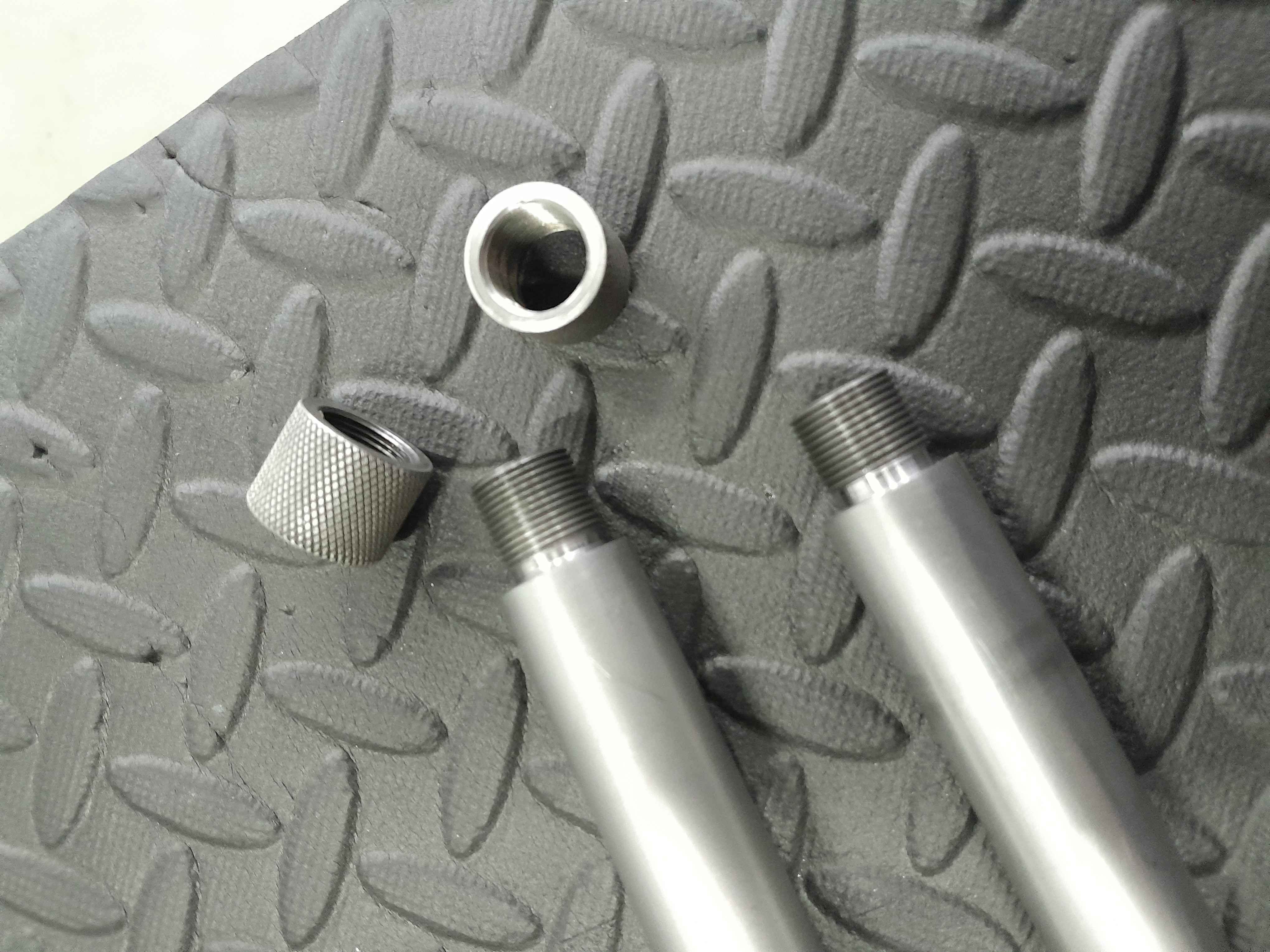

I made a couple of muzzle caps for two stainless varmint 308's, one for the long suffering grand-dads axe paddock gun Remington, and one for its replacement the Howa. Made them from 304SS as it's supposed to be nicer machining but you wouldn't know it.
Got one to go, a heavy barrelled Howa mini SS 223, muzzle thread on barrel too.
And then there's the bolt handle extensions to thread for. Gulp.

Yes, 1-10 is the choice nowadays as everybody is nuts about heavy bullets for target shooting. The grand-dads axe paddock basher (ex 700 Police 20") ended up with a 1-12 from TSE for it's 2nd barrel because I didn't think about that at the time, but iyt shoots 168's just great. But it only ever eats 135 and 150gn bullets in the paddocks. If I want to shoot heavier bullets I'll shoot a .300.

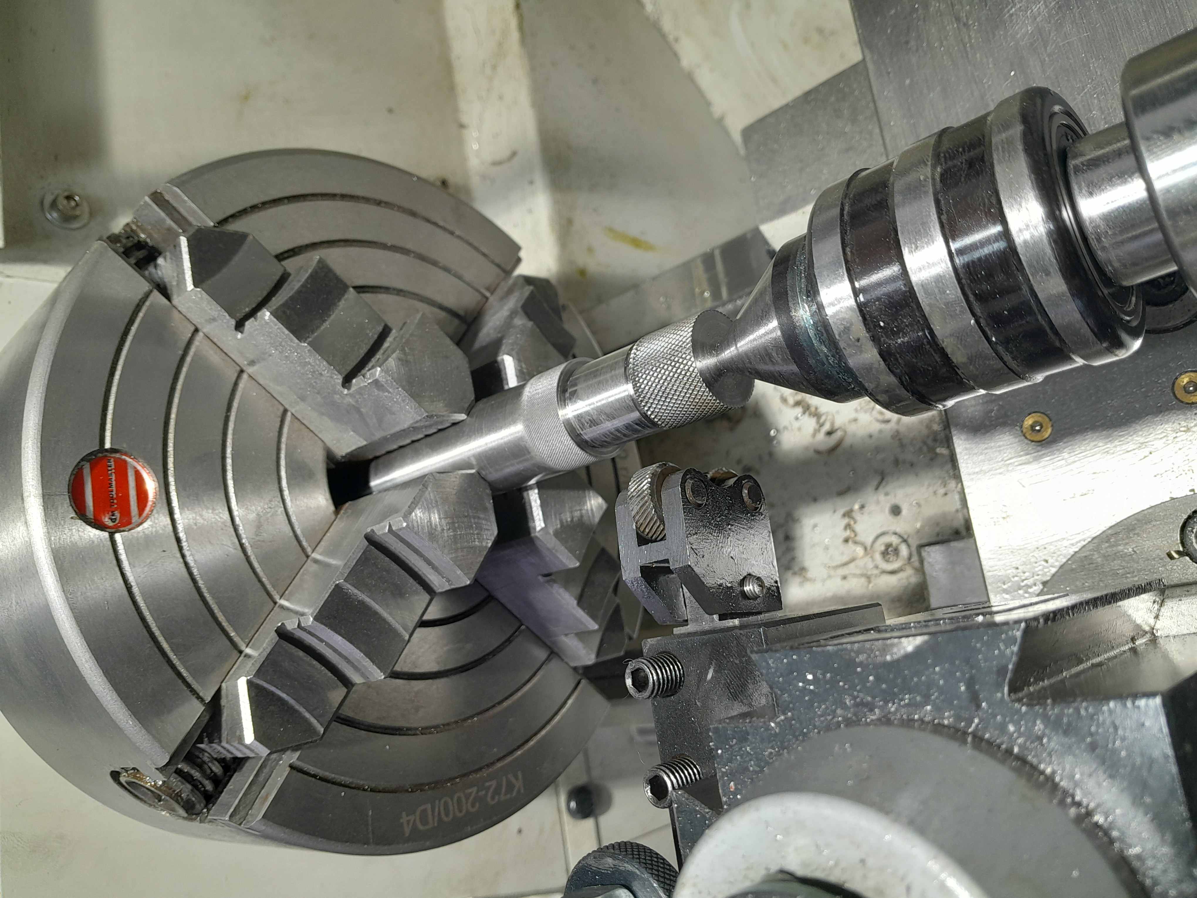

Yeah, got a lathe. Take off and fit barrels, true up actions etc. Just finished tightening up the chamber of grand-dad's axe actually, set it back 6 thou so it closes with "feel" on new unfired brass so there's no first shot stretch. Made quite a difference.
This is the first muzzle cap just finished knurling, the shiny section next to it closer to the 4-jaw is the second one. I size and knurl the outside before tapping the internal thread and parting it off.

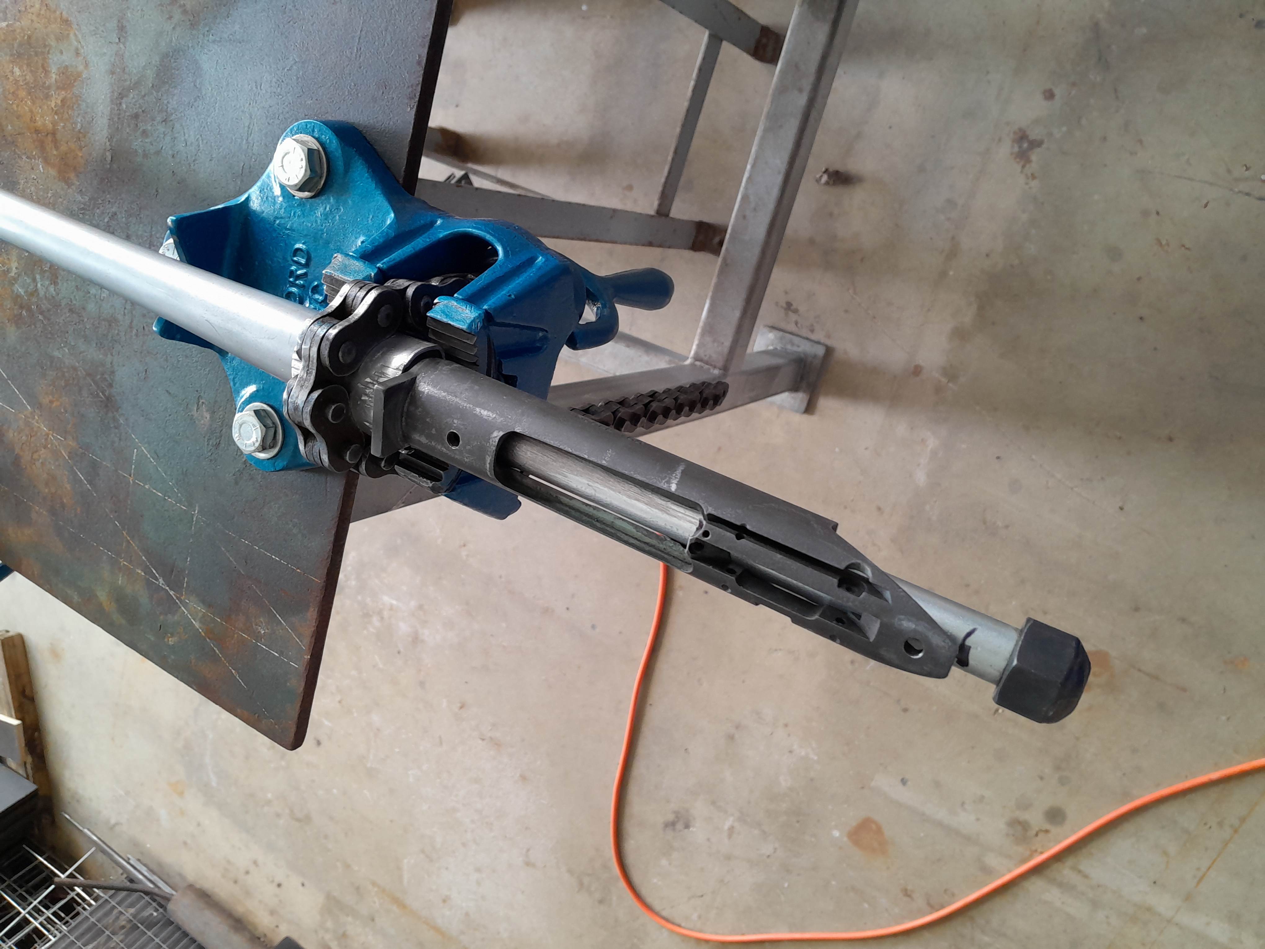

Barrelled action in the pipe wrench vice to hold it, with a home-made action wrench ready to undo the action.
The barrel is wrapped in 2.5mm sheet aluminium, so as not to mark it in the jaws.

The two caps. Stops me drinking beer. Make stuff instead

perentie wrote:Nice job. Never done Knurling. I have a proper alloy barrel vice I used when fitting target barrels to my late wifes 6.5-284. It was a long range tack driver but ate barrels. Still got the reamer for it and her 6BR I must get rid of one day.
Got a few knurling tools, was trying this coarser one and playing with the speed and pressure. Bit of a try and see thing.
I used a pipe vice to clamp the barrel because I have a few (pipe fitter and welder days on the gas :idea: ). Not the normal way using tools specially made for gun smithing that you can buy, but they hold the barrel very securely and clamp it at the same time, at a good working height.
But you have to use some "clamshells" to protect the barrel finish from the chain biting into it. Two suitably sized split pipe pieces, or as in my pic here, wrapped in aluminium sheet left over from power transformer windings.

Post by Wapiti » 27 Jul 2025, 8:05 am

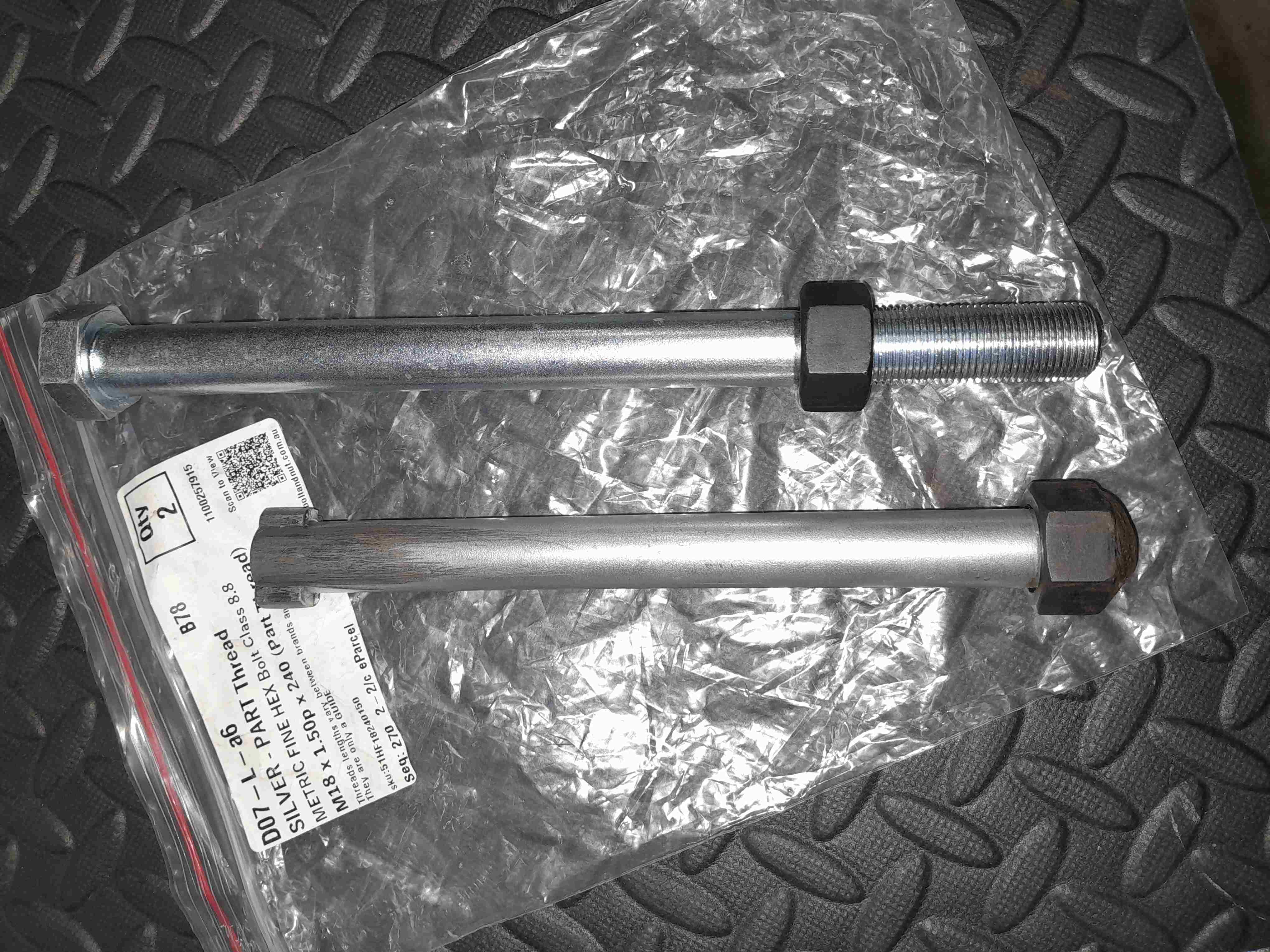

Using the pipe vice, and this home-made receiver tool to remove the action, it's an easy job.
I made this tool from a high tensile M18 bolt, an absolutely perfect wobble-free fit into a Rem 700 action. The bolt head is ground and files to run in the bolt lug raceway, basically mimic the bolt head. Weld a nut on the other end and this you use your breaker bar on. And torque wrench to tighten, I tighten to 100 foot pounds after coating threads in never-seize.
Good thing about these tools to remove an action is that you don't have to clamp the action with a commercial 2-piece tool right over where the barrel threads are underneath. Engineering-wise, that's just a bone of an idea I reckon, and I cannot believe people make tools that do that.
Anyway, for those who might ever want to make one, here's an unmolested bolt and nut, next to the made tool, with the nut welded in to fit the socket to remove-reinstall the barrel.

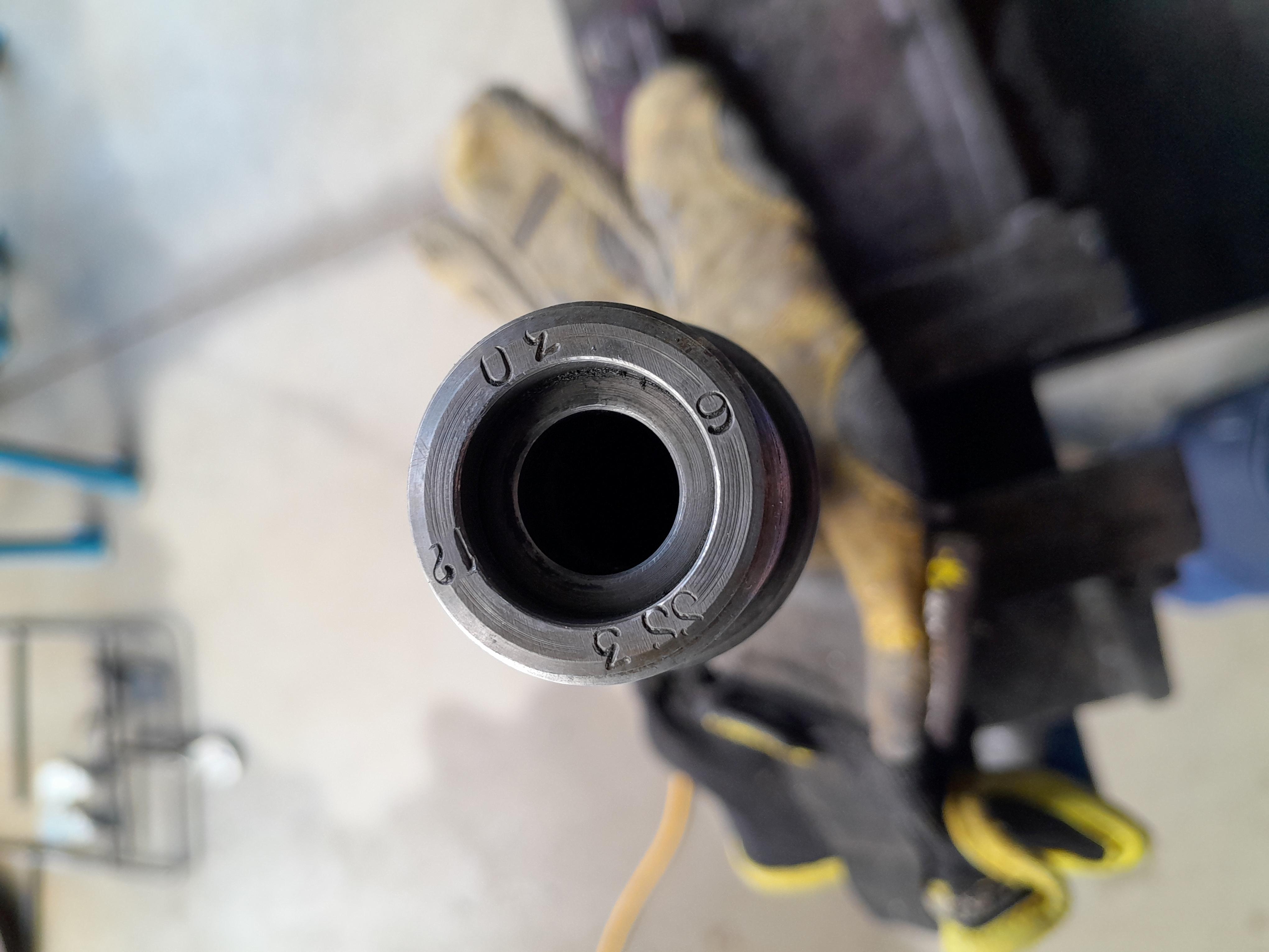

Markings on the rear of the removed TSE barrel. I assume that the 12 means 1:12.
I guess that all that info is left there and not machined off when threading/chambering etc as reference to that and other specs from the maker.
