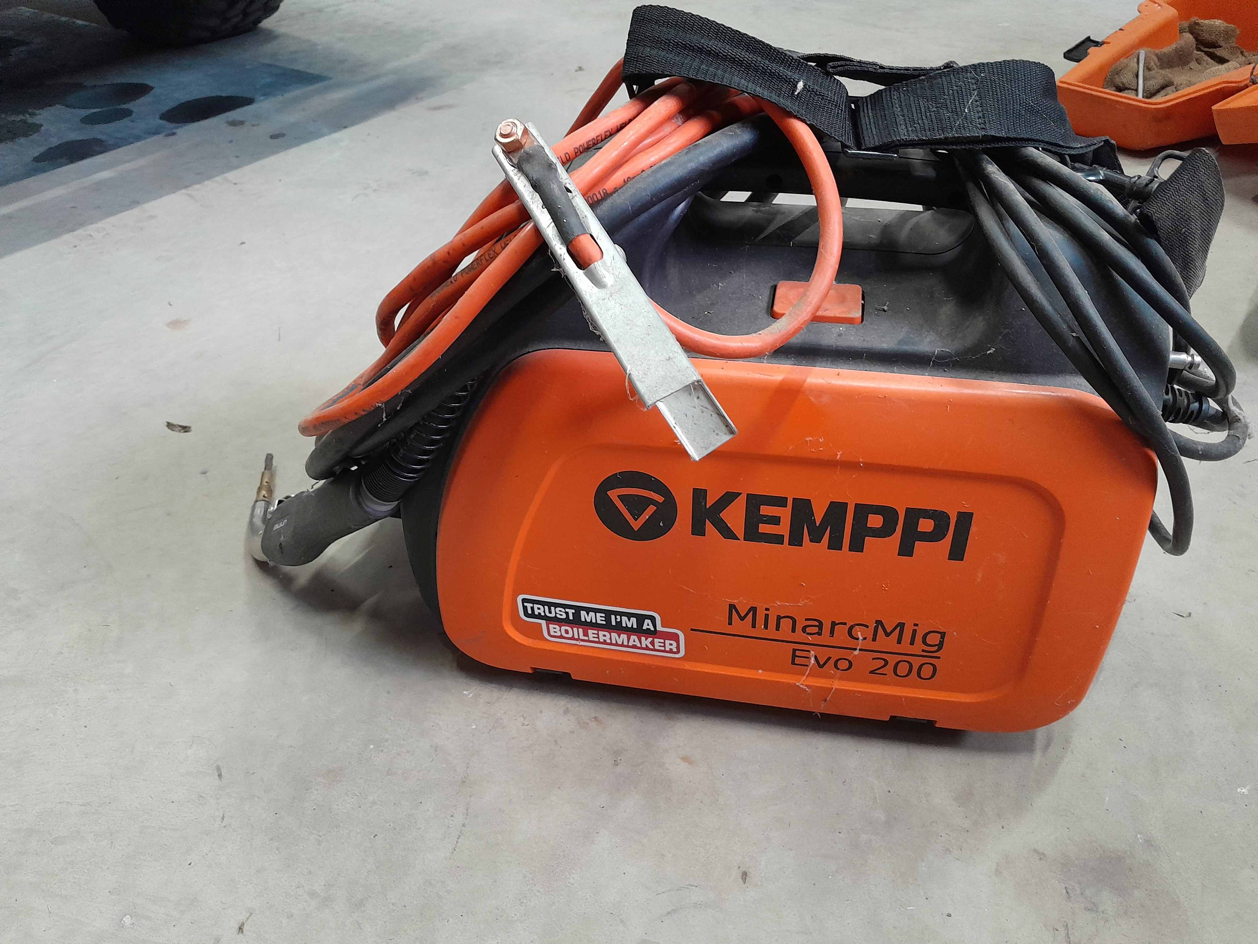

The reason they like it is, it has programmes in it where you pick the wire, the material, the thickness, and go weld. THAT is like a ballistics program for shooting, it's never correct.

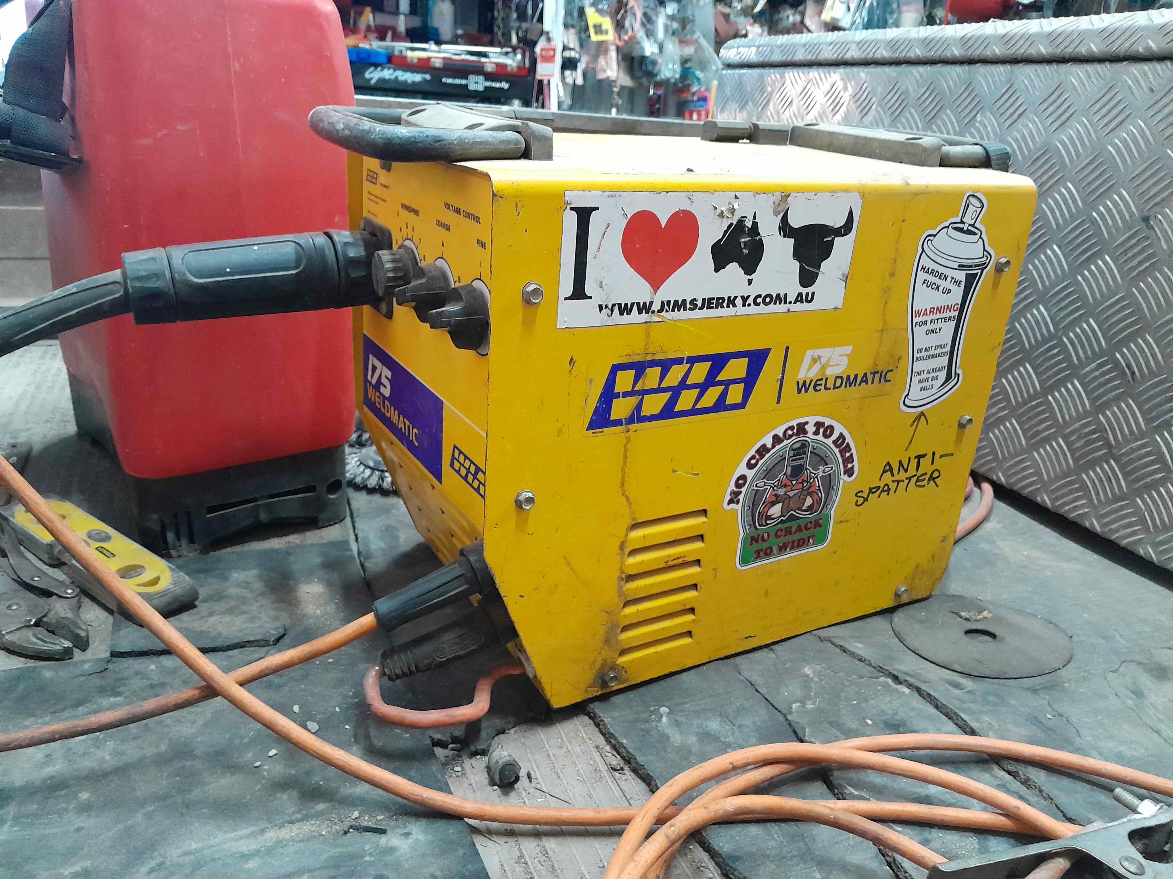

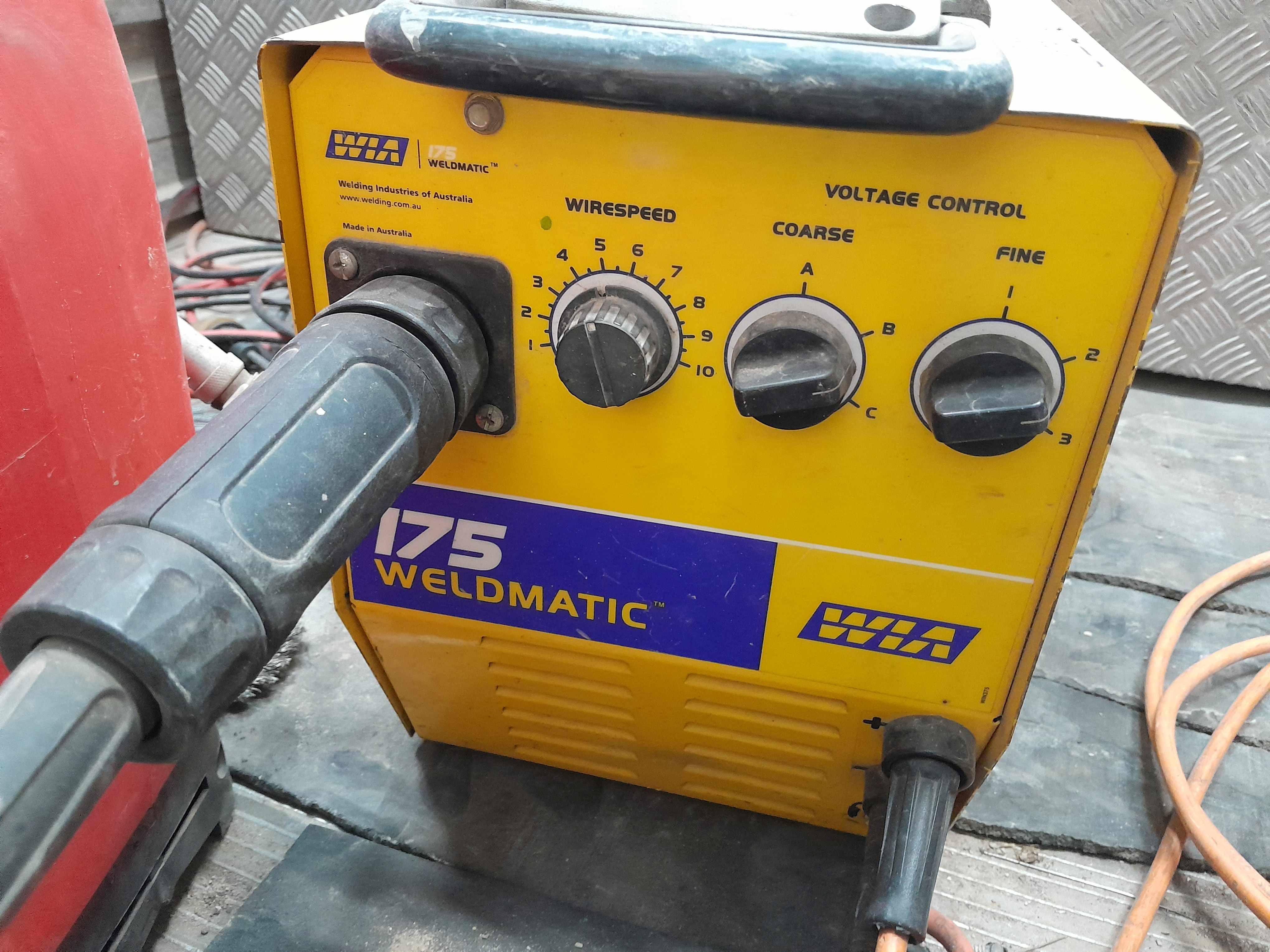

Now I have a Kempi, it's a great light little thing. I don't use it off the back of a truck because it's full of circuitboards that fry when they suck in grinding dust, or any dust, and het dry solder-joints from bouncing and vibration in a ute tray.
The Kemppi. All of my migs have 5m guns for reach, this one has a quick-disconnect gun, extra-long earths and I run 5kg rolls in all.
The beauty of the Kemppi is that it will run on a 10-amp powerpoint or small genny, and has such great electronics it will not suffer voltage drop on a 30m extension-lead.

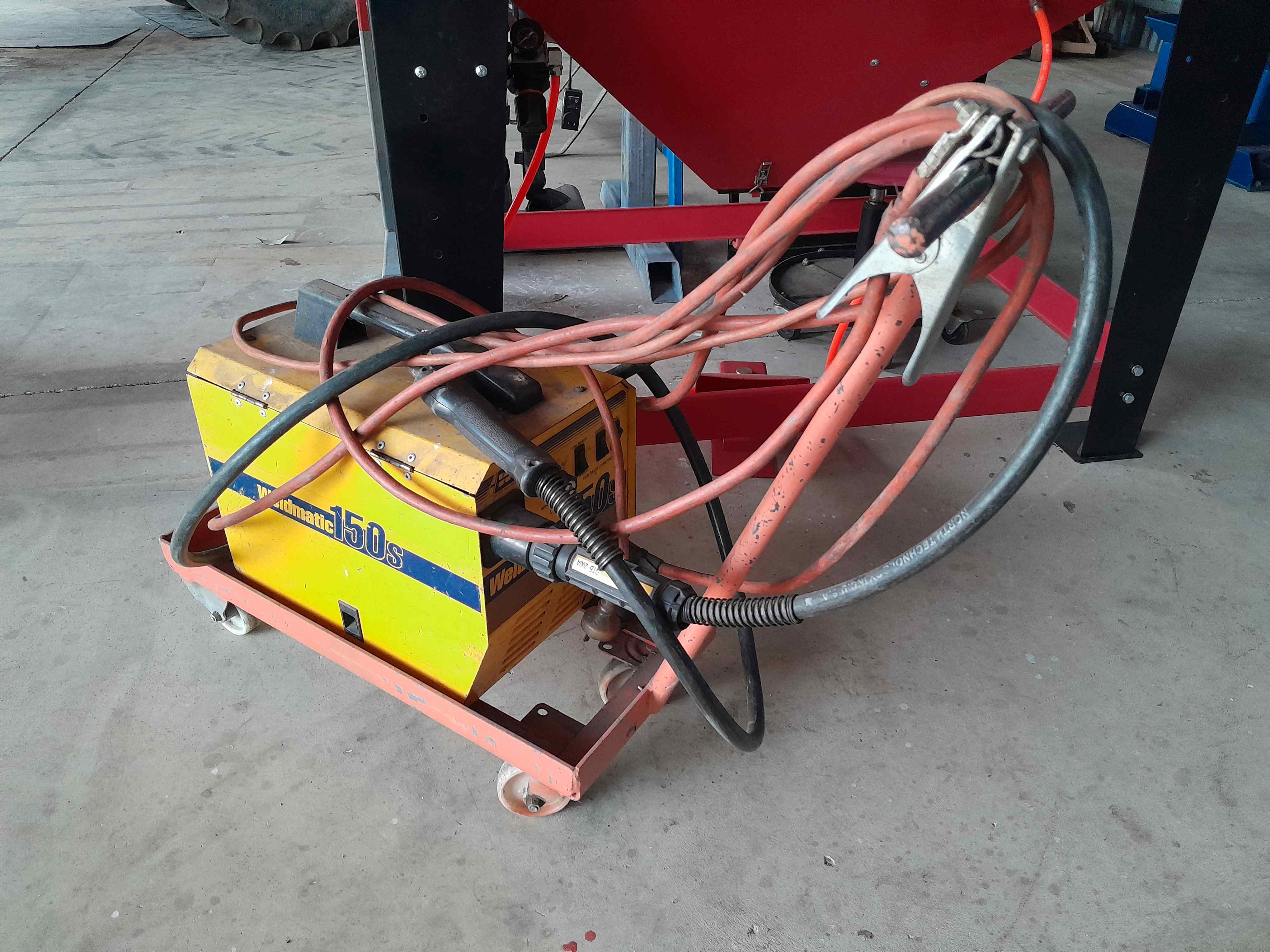

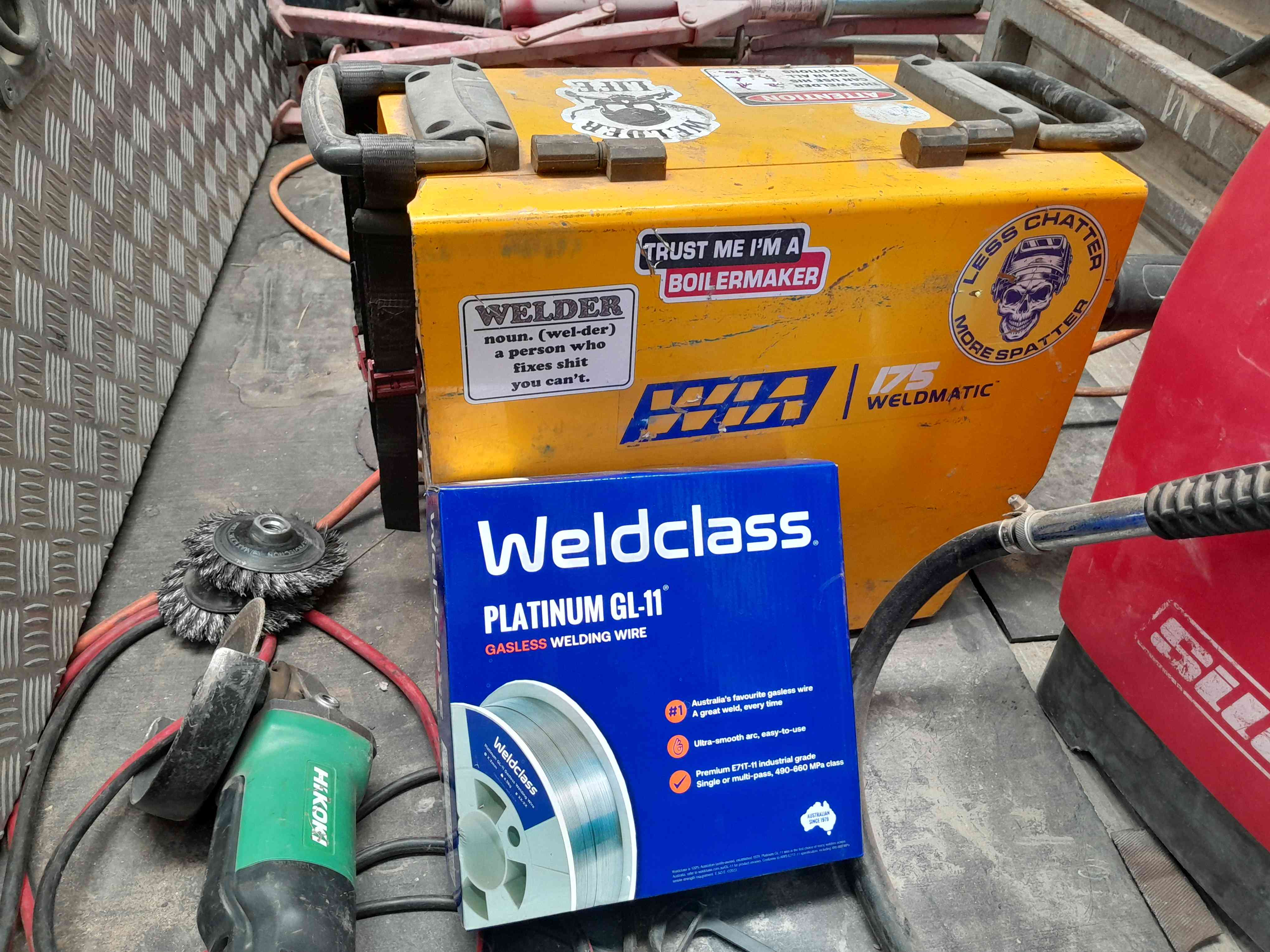

This is why I use the old copper-coil 240v mig here, it's absolutely bomb proof. All my field jobs are with this "s**t" copper-coil welder, on an 8kva genny.
All workshop welding here is done with this old, copper-coil 150 amp Aussie made WIA mig. Again, with a 5m long gun and a 5m earth lead. Runs on 10amp power and for welds even on 12mm angle etc, only is running on about 75% of it's capacity. On gasless.
As a boilermaker, if I thought I needed a big 3-phase machine for any job here I've ever done, I would have one.

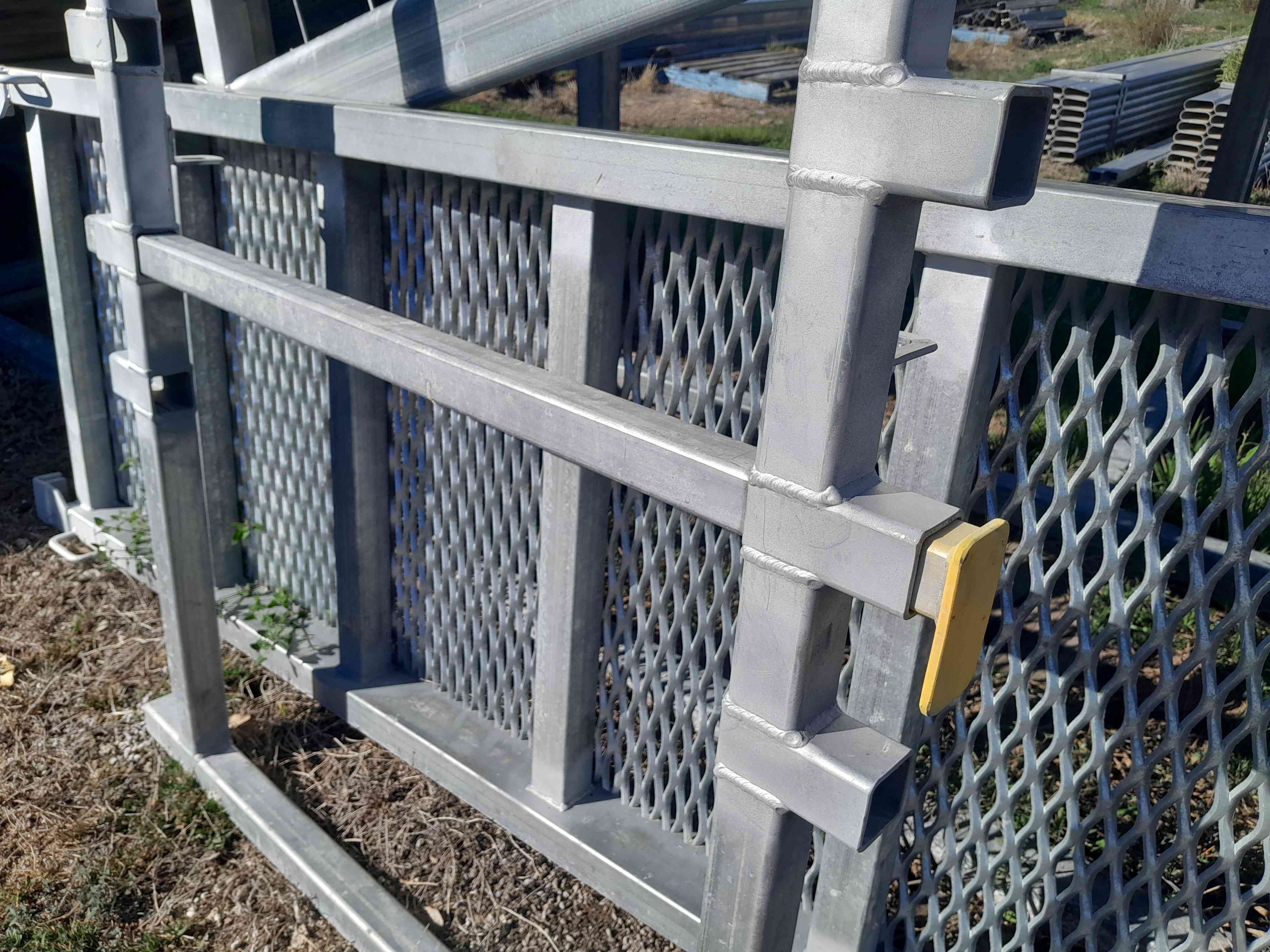

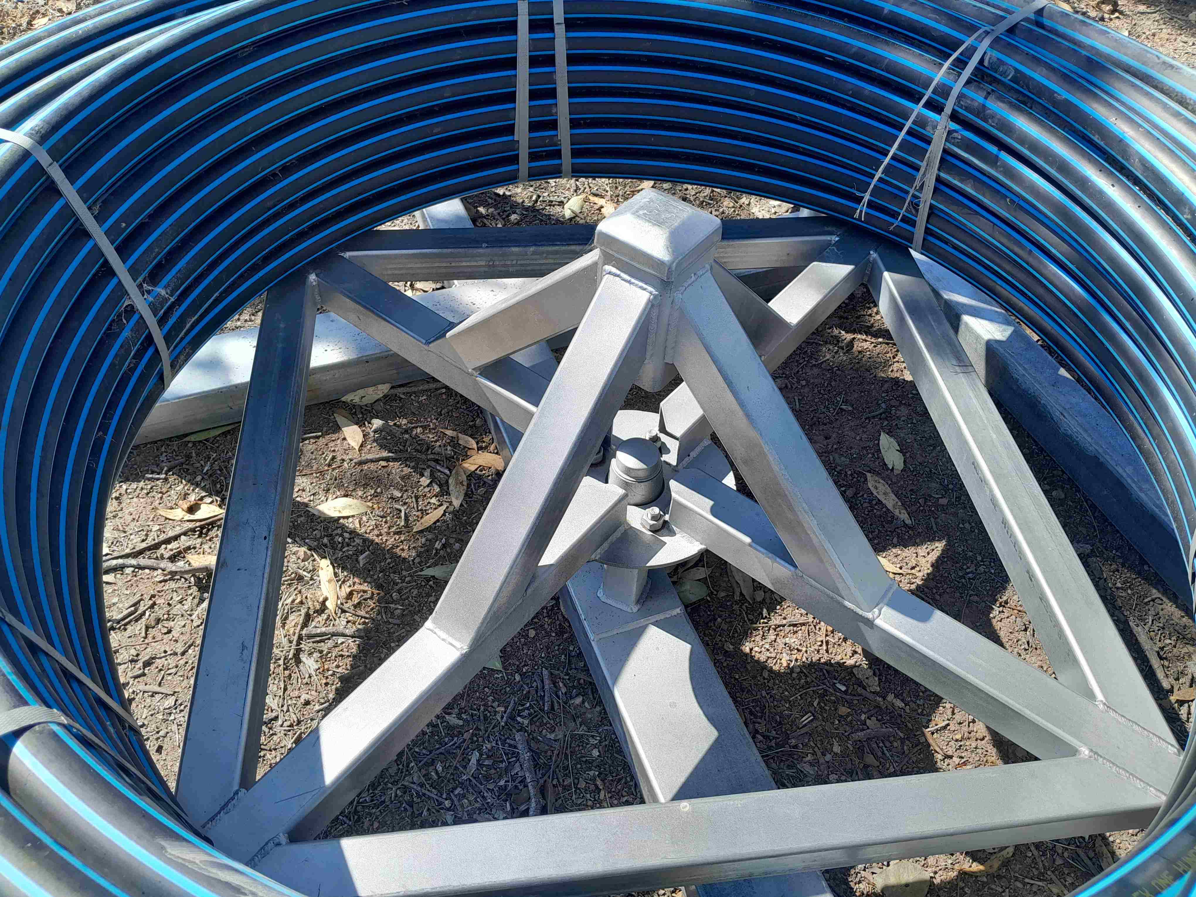

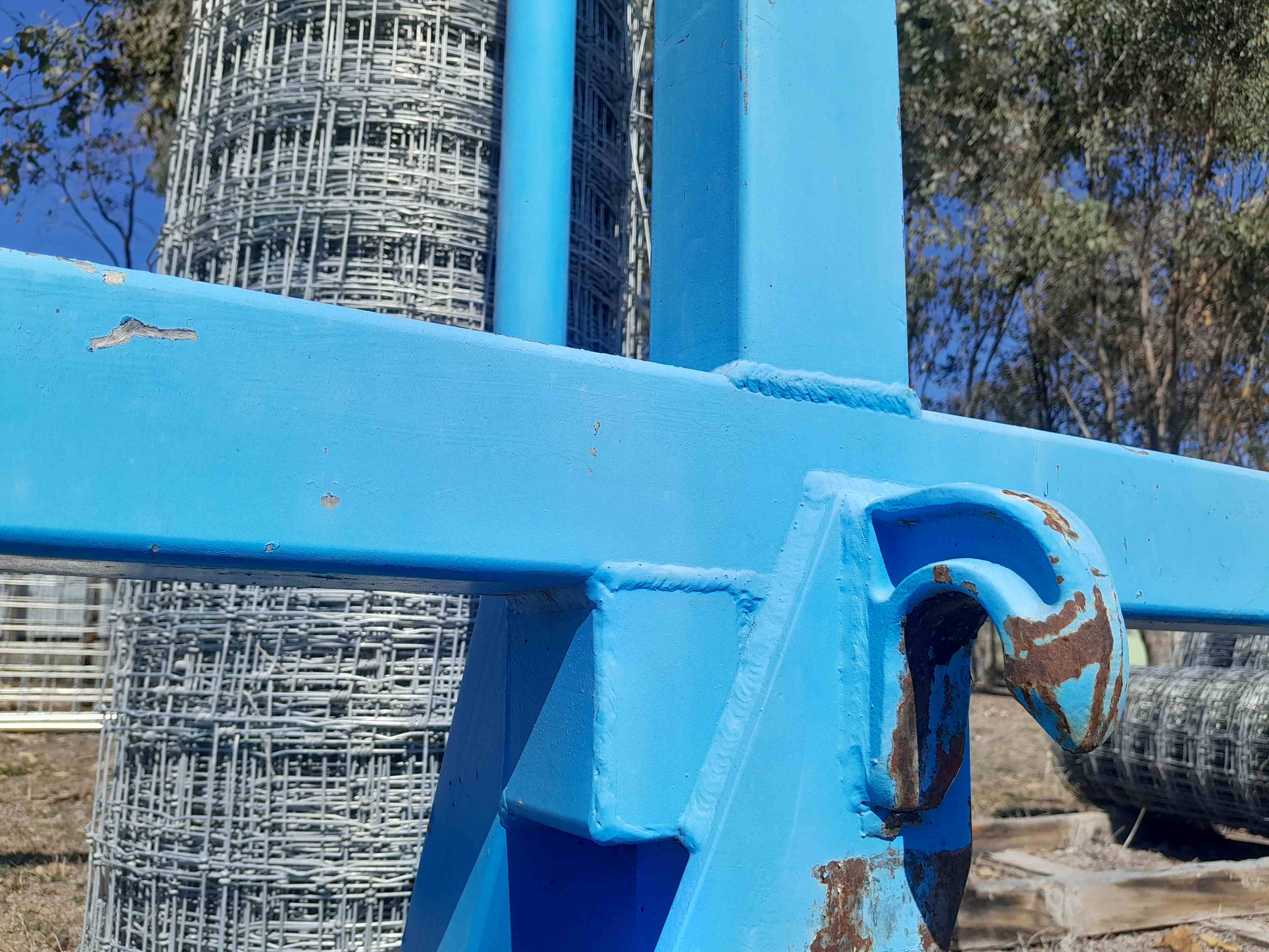

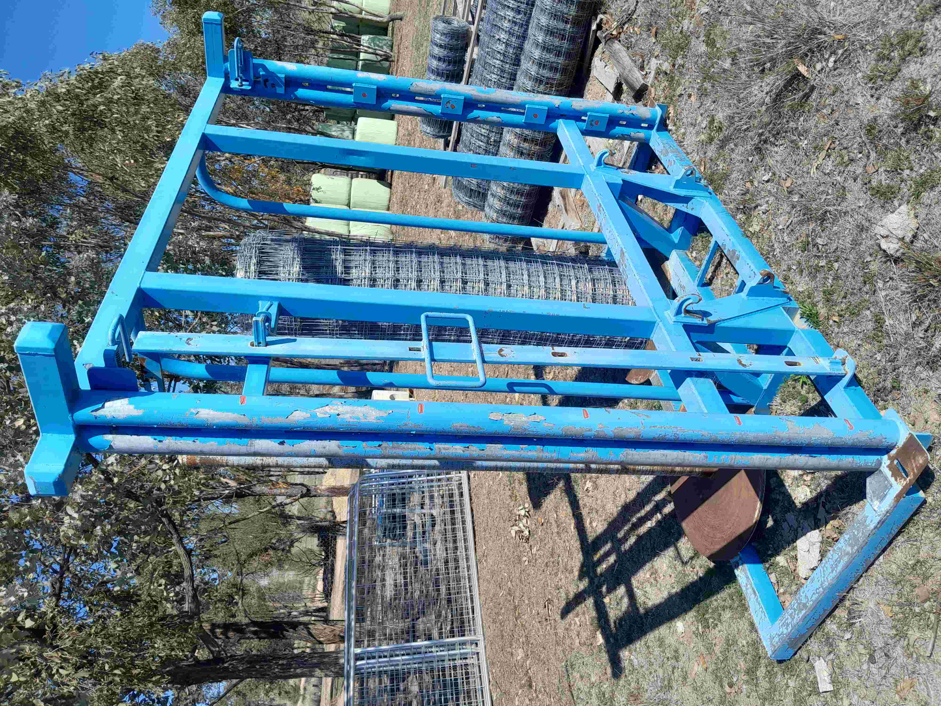

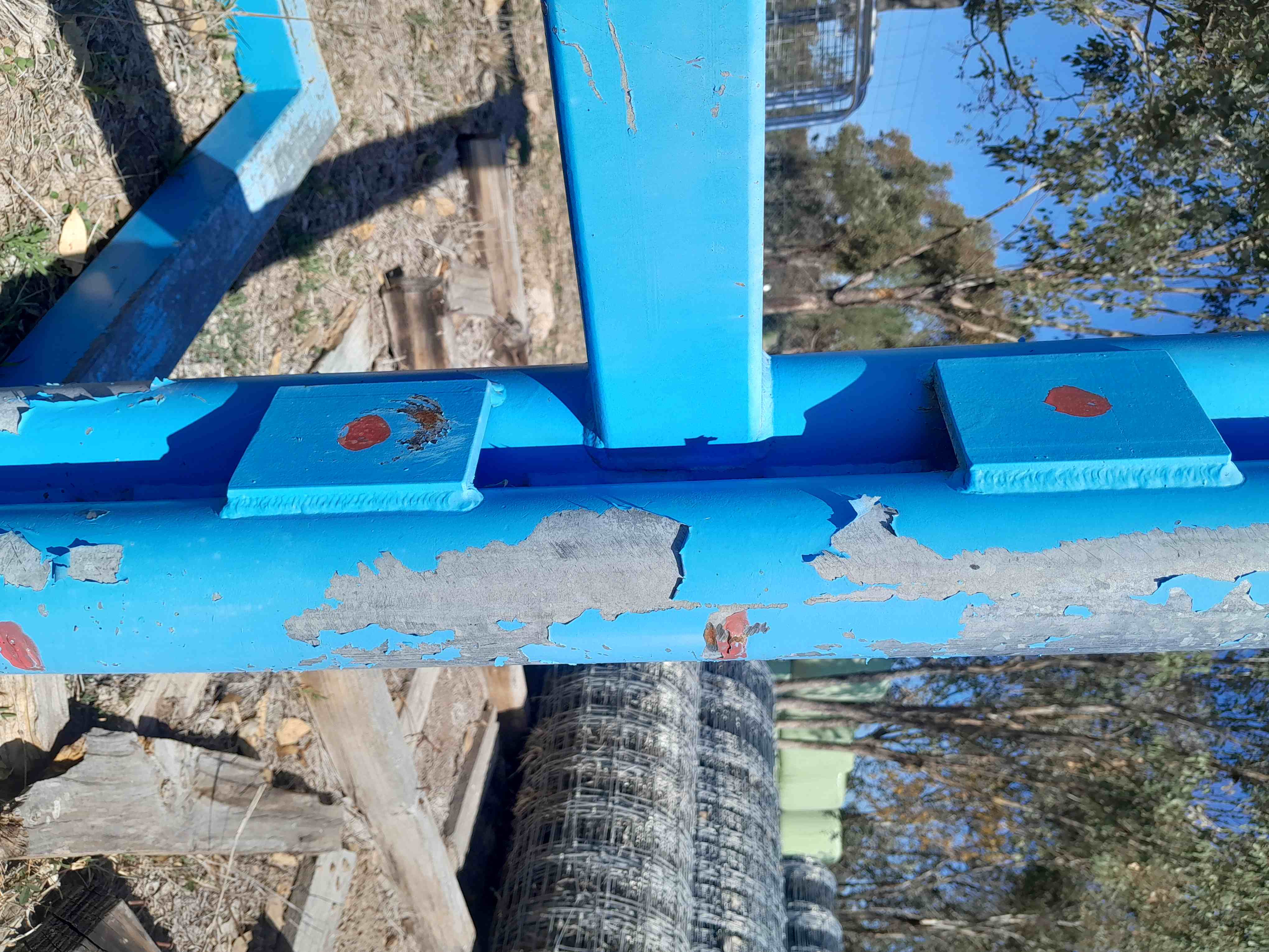

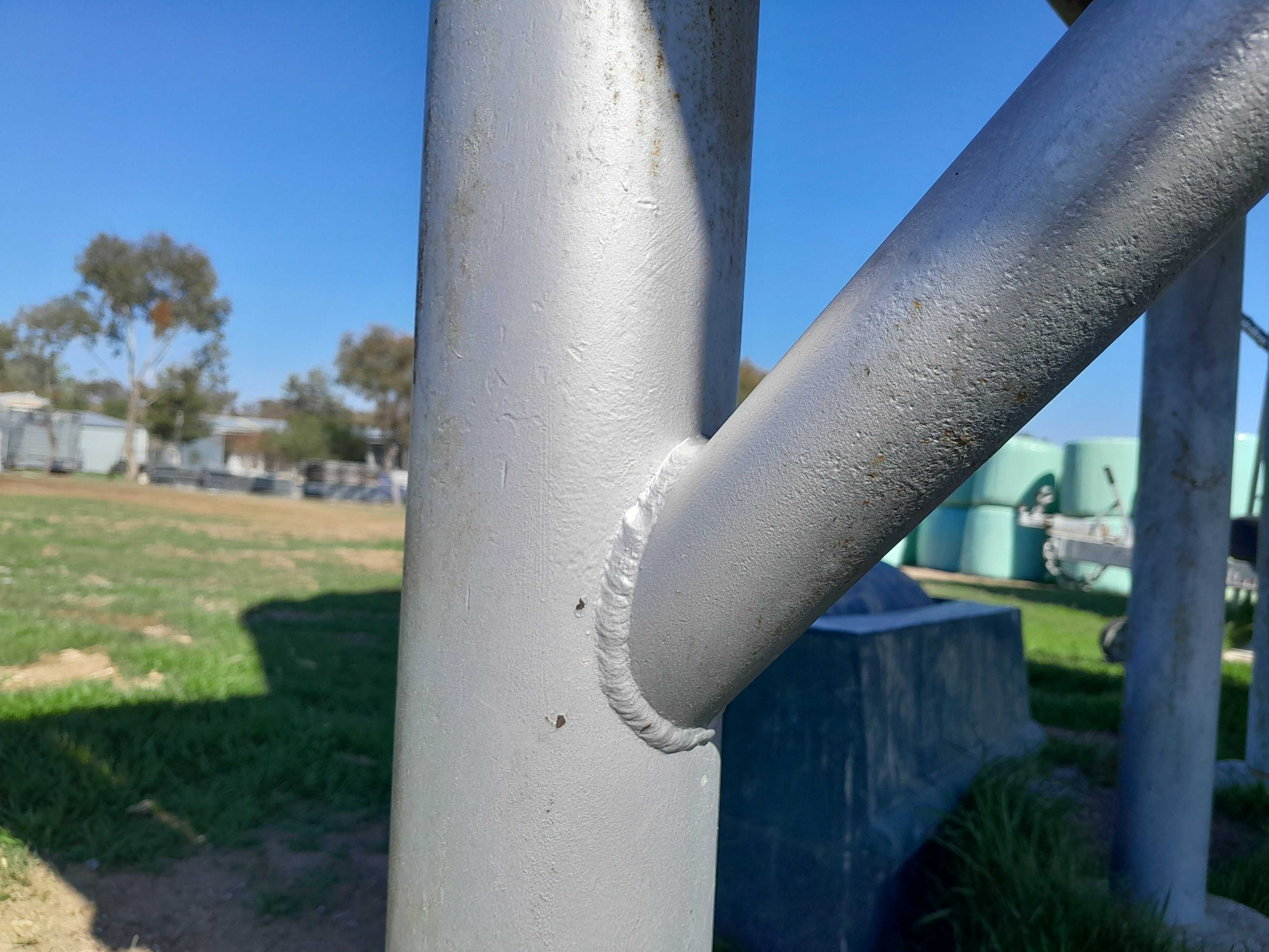

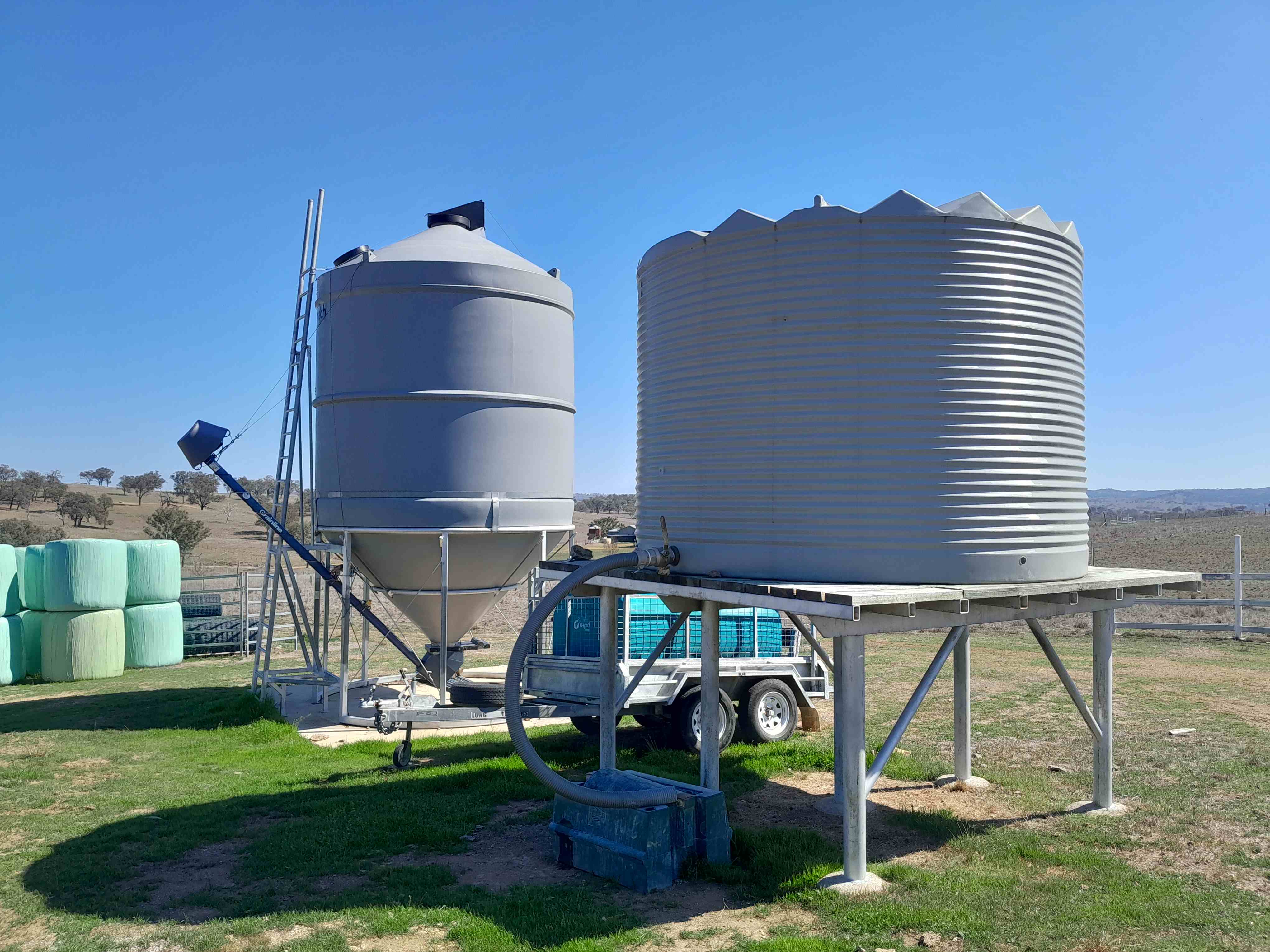

Here's an example of my routine welds this 150amp machine has done, on 6mm thick galv SHS with 0.9mm 71-T11.
Perfect deep penetration, no spatter, no grinder marks anywhere (try and find one), and the welds are as strong as the base metal.
WIA150welding example.jpg (699.68 KiB) Viewed 1149 times
If ANYONE tells you that small mig machines are not adequate for anything, let alone thick metals, stop listening to them because they are fighting a lack of talent and should not be giving advice. No malice here, but people listen to plain rubbish and make the wrong decisions because of it.

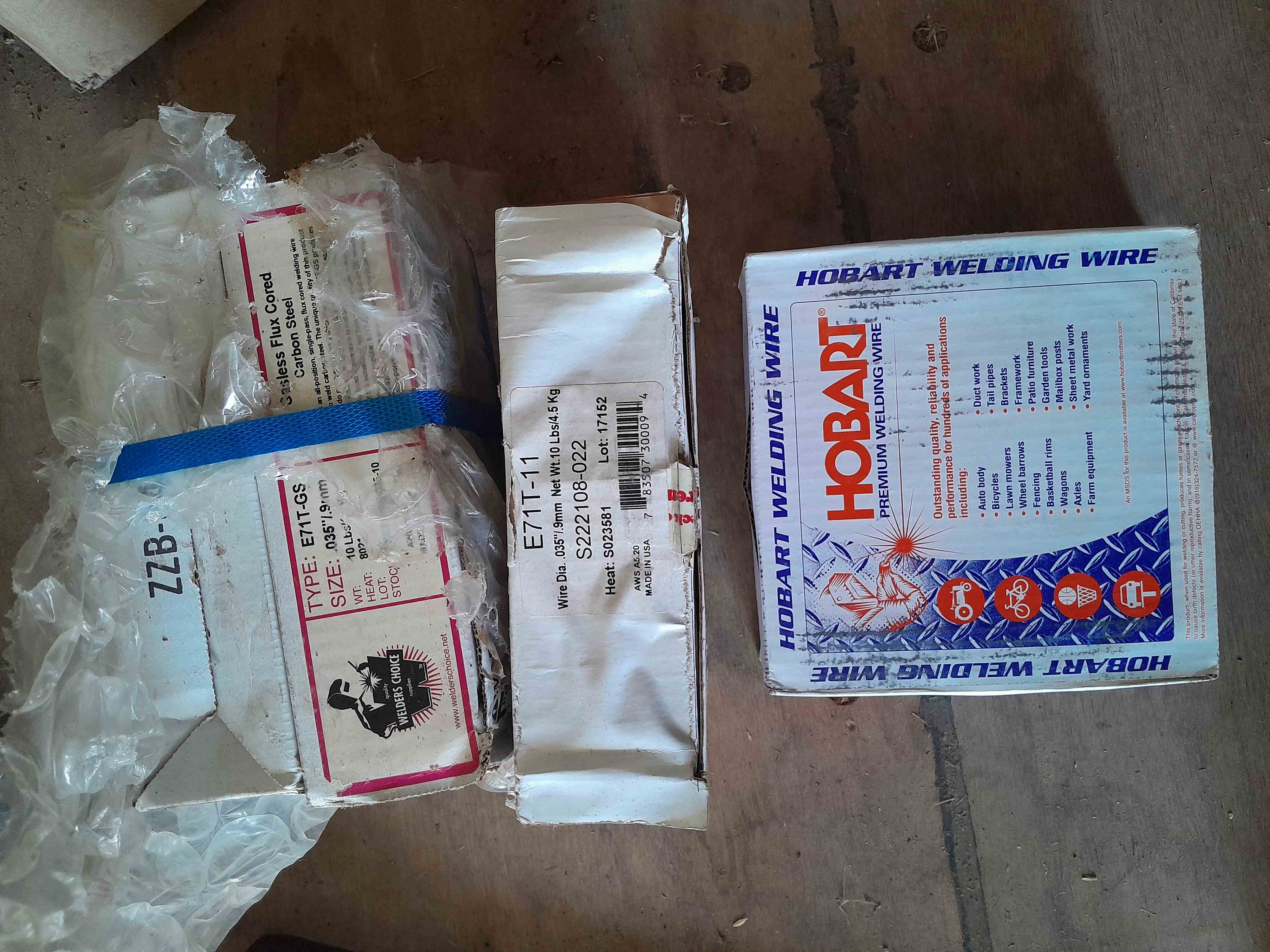

That's why I use gasless-mig excluseively now, I need to get the job done and move on. For the material used here, this process is faster, just as strong and neater, has no clean up save for a run-over with a wire wheel on a grinder.
Gas shielded welding does not work in the field.
But I wouldn't use self-shielded wire if my work looked like crap or it wasn't the right process, because it's my trade and I am the biggest critic of my own work.
I will go for a stroll later and take a few pics of the kind of things made with 71-T11 wire, and a couple of brands or commonly found wire available easily.

Being an old welder, I ended up with both Kempii and Esab welders. For myself, they have served me without fail. Good, reliable quality.
Willie

So here's some wires I recommend. The Hobart and Welders Choice are not that easy to find unless you have a pretty professional welding supplier outlet in your town. My closest is Toowoomba. Both here are a dream to use, with no more spatter than bare wire/gas mig.
Hobart andWelderschoice.jpg (693.22 KiB) Viewed 1043 times
I'm certainly not here to make anyone mad, but these wires are suitable for multi-passes, should you need to have a larger weld fillet on thicker steel.
There is a lot of that about, it's only because of the rubbish that department stores sell from the bad old days, not now.
The heat of the steel needs to be higher in thicker sections when using thinner wires like 0.9, around 70'C plus, which is what it'd be like if you left the steel in the sun before welding.
This Weldclass wire is actually VERY nice to use. You can get it from any steel suppliers, and they sell welding machines under this name too, which are quyite acceptable machines.
This wire also is suitable for multi-pass welds. Of course, you have to run a wire buff on a grinder over the previous run to remove the burnt flux which also pulls the galve, paint and other s**t out (kinda like fluxing lead when making bullets and skimming off the crap)
Then, you are good to go.
I just bought a few more rolls in Warwick last week, and the 4.5kg rolls were $79.
For the money, taking into consideration the extra cost of gas, rent (if you don't pay rent the whole shebang costs more), or welding rods and the fillet sizes ie. length of fillets for the money, Gasless is cheaper and more flexible.
Edit: these wires lay down a low-hydrogen higher-tensile grade of weld similar to the low-hydrogen rods like WIA 16TC, for example.

Here's some examples of the stuff you can make with a small mig machine, with gasless wire. In fact I made these things using the Weldclass G11 wire.
This thing is picked up by the 4WD tractor and picks up off the ground' spools off' and tightens the 400kg 250m rolls of the wire I use to keep deer in, and dogs out.
These welds are all 6mm fillets, some larger on the thicker sections as needed. The weaves you see are all vertical-up welds, done in position. This little 150 amp machine was running at about 75% capacity to run these welds. No spatter, in fact try and find a grind mark where the welds needed de-birdsh*tting.
Small machines easily make big stuff.
You can see the size of the welds you can make with gasless, out in the wind or anywhere.
The only parts here I didn't make are the forged hooks that allow the quick-connect on the tractor to lock onto the fencer. Much more convenient to buy those items but the welding is all done here.
So if anyone says a small machine is no good and won't do anything useful, don't listen.

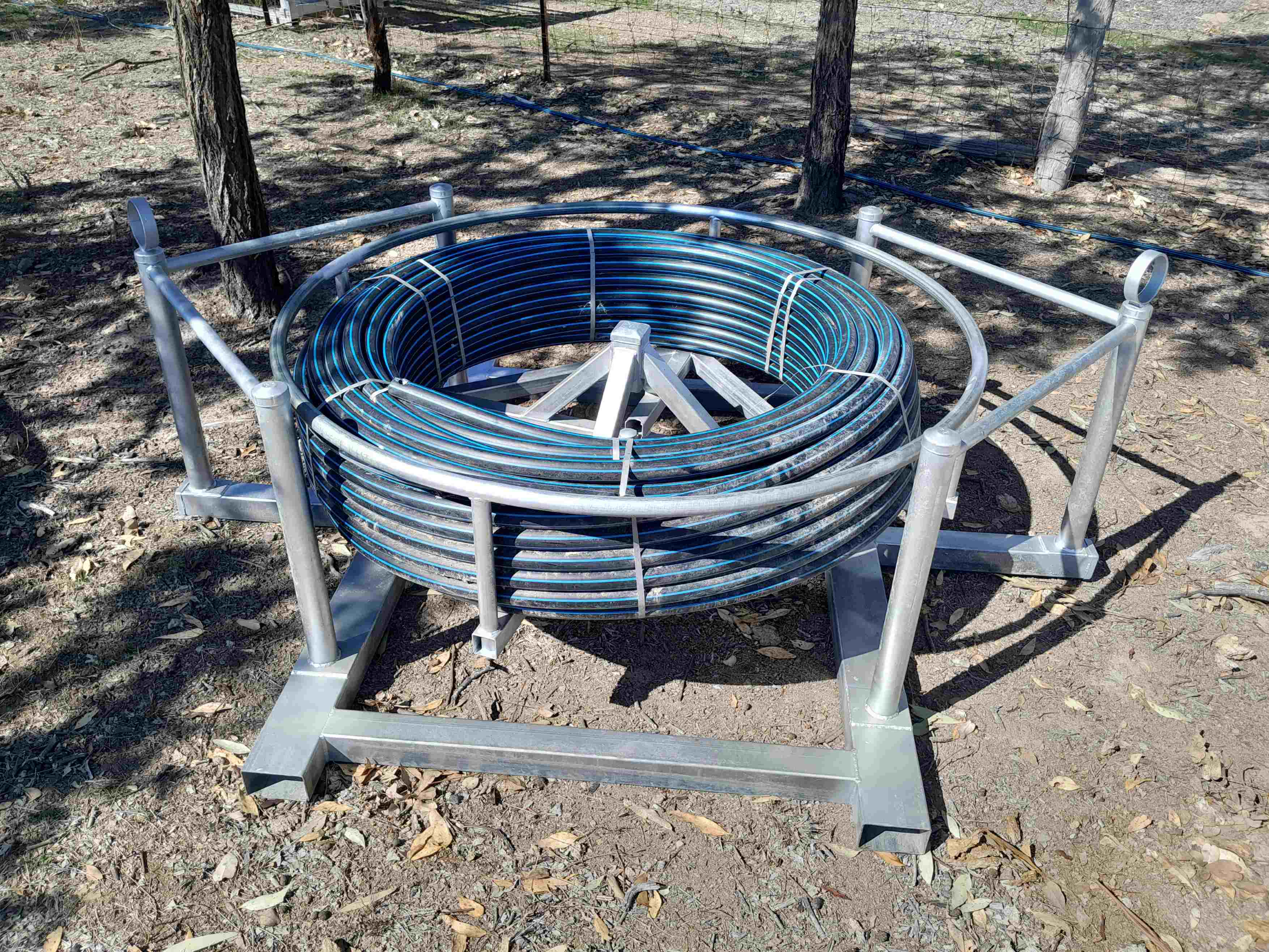

And here's a pipe spinner I made, to run out 200m rolls of 40 and 50mm blue-stripe from the front of the tractor and down into the pipe layer on the ripper tyne on the back. Down about 5-600mm underground. Made with the ancient little Aussie-made WIA 150. With 0.9 Weldclass gasless wire.
All out of galvanised box and pipe. The circles on the sides guide the pipe as the turntable spins and guide it over the tractor roof and down into the spooler. No digging needed (thank f**k)
That strange pyramid in the middle keeps the outriggers the pipe is laying on from flexing up and down. And the cap on top allows access to the bearings in the Ford trailer hub, with Slimline brearings.
But I show it because you can see the positional welding that this wire and little welders can do, and there is nothing anyone can complain isn't completely adequate.
Some of this stuff you just have to make, because it's either not made, too expensive, unavailable or just crap.
Without a welder, you can't.

This tank stand was made with the 150 as well, on 2 30m extension leads joined together from the carport powerpoint, a site no-no.
It holds 20 tonne of a molasses mix cattle supplement, in a super-thick special rapid-Plas tank.
The steel angle is 16mm thick and the pipe legs 10mm thick 115mm ex-LNG pipe. The diagonal braces are 10mm thick 65mm ex-LNG pipe, A106 carbon steel.
So the reason this is here is that the gasless 0.9mm on a small 240volt machine easily welds thick steel.
All welds are vertical-up or overheads.
There's so much misinformation out there, from people who have never done it unfortunately, and it ruins others from having a go.
