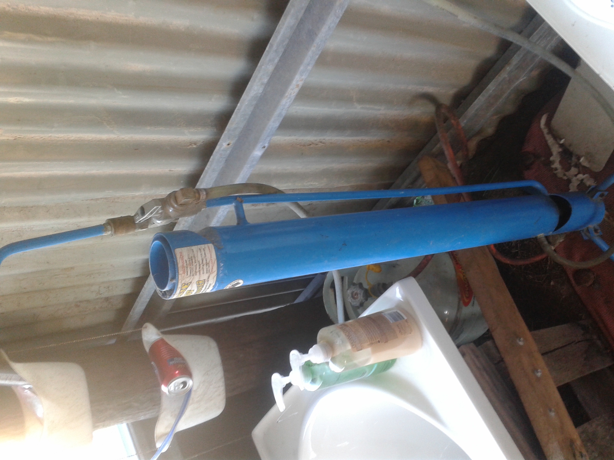

Post by Daddybang » 26 Apr 2018, 3:57 pm
Jeez some of you fellas are spoilt!!!!
This is our hot water system!! Connect a hose and light the gas and ya get all the hot water ya need!! :lol: :lol: :lol: :drinks:
