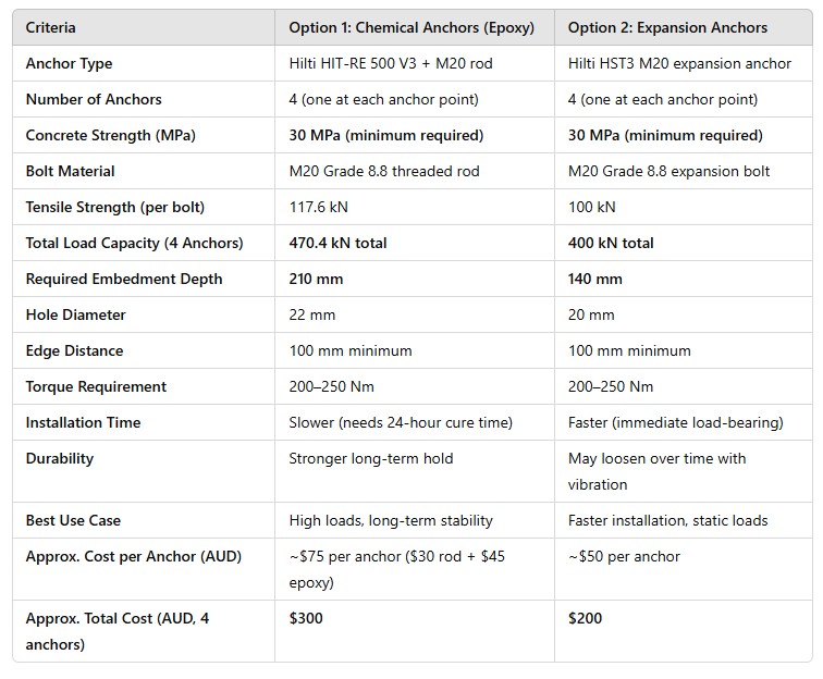

This may help

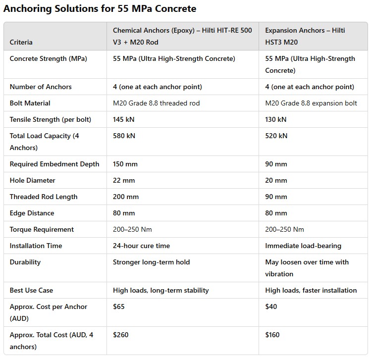

Post by stihl88 » 13 Mar 2025, 5:33 pm
on_one_wheel wrote:You won't find many 30mpa house slabs.
Good point, they're typically between 20~25mpa and 100~200mm thick in which case one would likely have to pour their own footings/slab from the start, may as well go to higher MPa to reduce the specs even further if going to this trouble. Following is for 55MPa concrete, with a noticeable reduction in anchoring depth and edge distance. https://www.bunnings.com.au/dingo-20kg- ... e_p0760378
Anchoring 55MPa.jpg (120.1 KiB) Viewed 11983 times

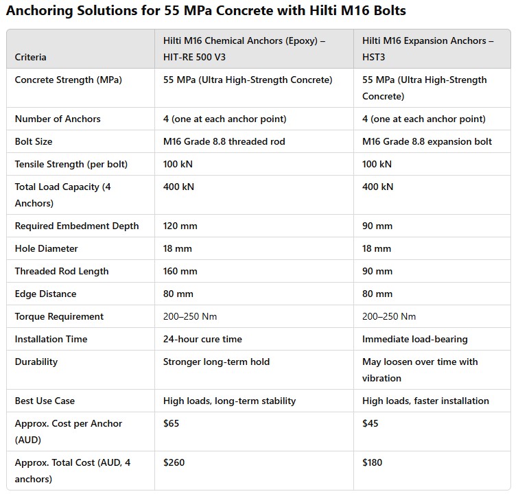

Post by stihl88 » 13 Mar 2025, 5:46 pm
Looks like M16 might get you closest to the pin in 55MPa at 100kN, bonus is the M16 bolts appear to require less embedment depth than M20 bolts...
Anchoring 55MPa_M16Anchor.jpg (122.76 KiB) Viewed 11968 times
