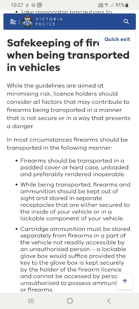

For Victoria. I use a trigger lock and small cash box for ammo if just a day outing. Removal of the bolt and hide it or lock it up is another option.
https://www.police.vic.gov.au/firearm-storage
