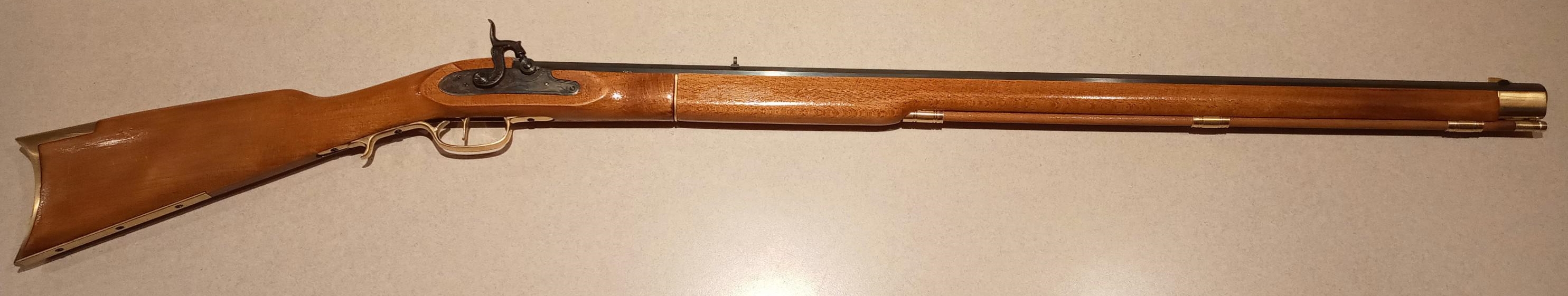

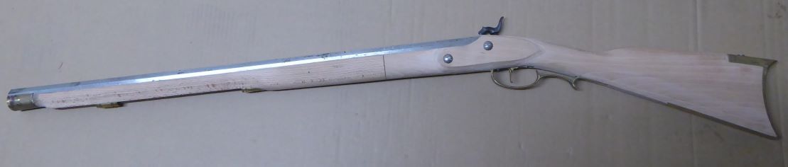

Well we all know it is damn near impossible to get Muzzleloader kits here so when I saw a 1987 50 cal percussion Kentucky Rifle Kit still in the box I bought it.
Now I know half of you are cringing and I know that the old CVA Kentucky is not exactly the pinnacle of Long Rifle builds but I thought what a great piece to practice the craft.
This is what most look like.

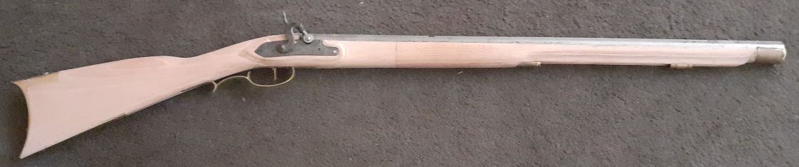

so here is where I am at.
Progress so far:
- Firstly I decided the brass spacer was not an option so just left it out.
- Took about an hour to get the buttplate nice and tight to the wood
- Inlet the lock in about 10 minutes
- Inlet the barrel so it sat well at the back and most of the way along (slight warpage in front end couldn't be helped).
- Had to set the barrel back to get the nipple to line up and play a little with the nipple and hammer.
- Put the corner in the tang and bent it
- Set the tang down in the wood and relieved the back of the barrel for the rear lock screw.
- The Lock screws were missing so I rethreaded a couple of others.
- Fitted the trigger. Had to bed it out and recut the threads and countersink to line up.
- Inlet the trigger guard ever deeper

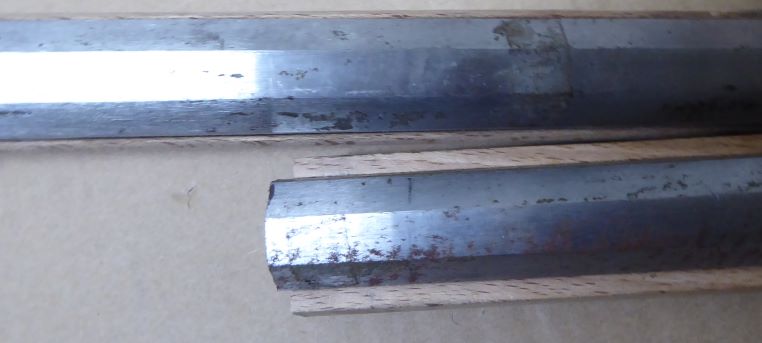

- Cut the barrel off

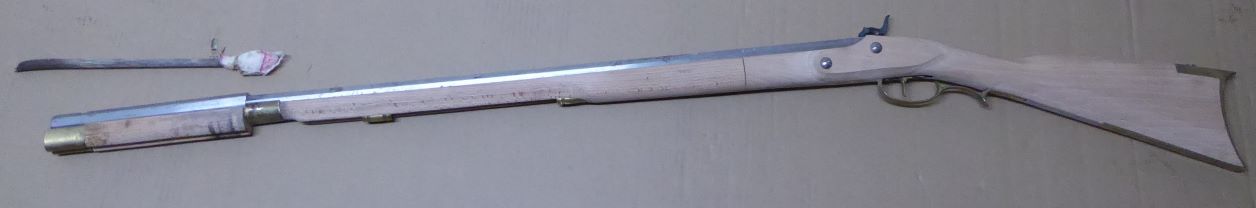

- And the stock
- Inlet the rod thimbles
- Took to removing wood
- narrowed the grip maybe 6-8mm
- Narrowed the comb right down
- Rounded the rear forend
- Went to town on the forend such that it is about 3mm fatter than the barrel and fluted.
Before and after of forend

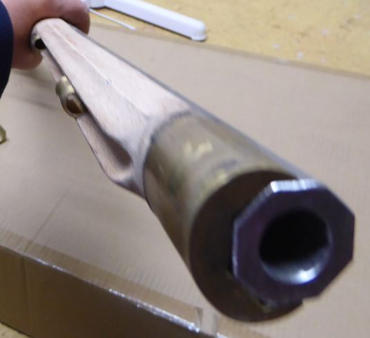

- Recut the muzzle and crown
- Shaped the muzzle end
- Made a forend cap (took a coupla goes). Waiting on the rivets to rivet it on.

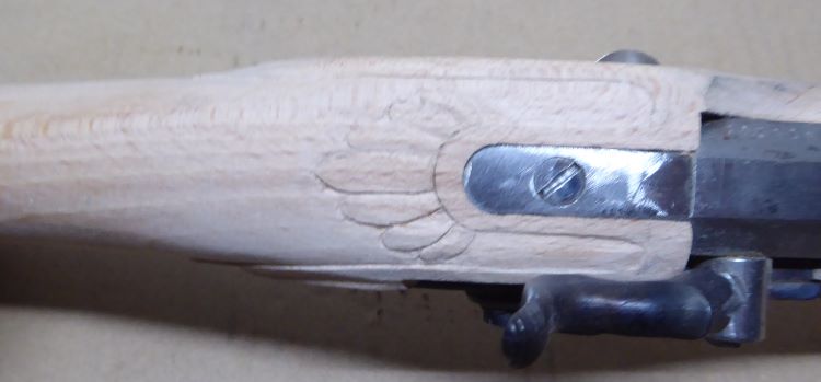

- Shaped the lock panels
- Attempted carving
Yeah not done but coming along well I think :allegedly:

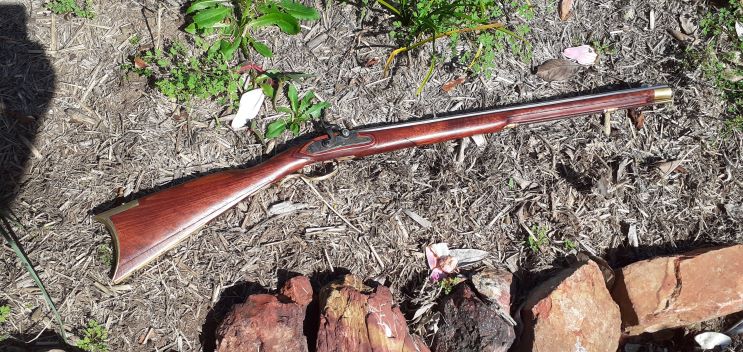

Post by LawrenceA » 28 Aug 2022, 2:39 pm
Its done
LawrenceA
