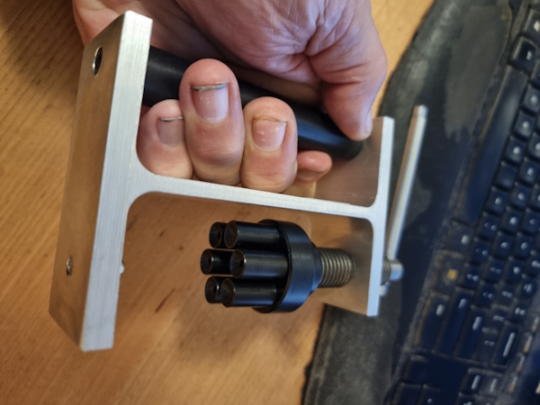

For the revolvers I bought a hand vice that seats all six balls together, which greatly speeds up reloading the revolvers and I've ordered two different paper cartridge kits. I think paper cartridges will really speed up the reload. Instead of dropping the six charges in from vials, then pushing in six wads, and dropping six balls on top, then seating them all together, I'll just drop in the six cartridges and seat them as one. It might take me longer to cap the six nipples than to load the cylinder. I'm leaning toward pre-loading syringes of grease that I can just squirt into the chambers without even having to look at them. I haven't decided on what to use for grease yet. I don't want to use a petroleum product that needs solvents to break down when it gets into your clothing, so something vegetable- or animal-based sounds like the way to go.

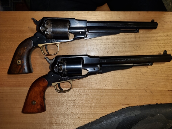

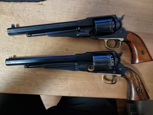

Ps don't forget to share a picture of those lovely revolvers :thumbsup:

They're actually fairly ratty but that's how I like them :-)
They are Uberti Remington New Model Army 1858's in .44-cal.
They came from a NSW dealer who bought 80 firearms from a reenactor in Qld, so these two spent years firing nothing but blanks. I bought a .36 as well for my mate which is in lovely condition. I was concerned they might've been put together out of junk parts for that purpose so the price was really good. The nicer one is 1996 manufacture and in very nice condition. The tattier one is 1965 production, and the cylinder has clearly come from an even older one. It has been recrowned at least once as the muzzle is significantly shorter. The cylinder is machined differently and does not index correctly. Looking from behind when you cock the hammer you can see that the nipple is off to the left. From the front of the pistol you can see that the pair of chambers on each side are not in the same vertical plane as the frame. The cylinder over-indexes so I figured the bolt was bent. But I put the cylinder in the other pistol and it indexes the same, so it's been machined that way. I've been trying to get a replacement cylinder with little luck so far, but for what these are worth it'd be cheaper to buy another pistol. I'm going to fire six rounds with the pistol inside a cardboard box and see if it spits any shrapnel out of the cylinder gap. The forcing come appears quite generous so it may not be an issue, at least not for Cowboy where precision is considered a dirty word :-) I'll try filing some metal out of the side of the bolt slot and bend the bolt over to try to correct the indexing if it is an issue. The bolt also randomly doesn't pop up to lock the cylinder in place so I want to order a new bolt and bolt spring. If the cylinder is not locked and you bump it before you fire it can throw the index way off, and that could be nasty. There are some slight differences between the two so things changed over the 30+ years between them, and I'm guessing the cylinder might be twenty years older still.
Taylor's in the US does cartridge conversion cylinders for these for US$245 to shoot .45 Colt (and for the .38 Special in the .36-cal version), but say that they can't export them out of the US. The cylinder would be twice the value of the complete pistol but it would be a nice feature, and would hopefully fix the indexing issue.
I haven't fired the bad one yet as I don't want to be around other shooters in case it does spit lead out, and I want to shoot it in a box on the bench. I'm hoping I'll be able to do this on Sunday as I should be on my own.
One of the club members has a stainless Uberti 1851 .36 Navy that I want to buy off him as well. He bought it new and only shot about a dozen matches with it decades ago.

Yep, I like being able to drop the cylinder for loading without having to disassemble the pistol like the 1851-1861 Colts.
I'm using this for loading, from Viceroybooks.com.au.
We're not allowed to load from the flask anymore, must use premeasured vials, which are faster anyway.
