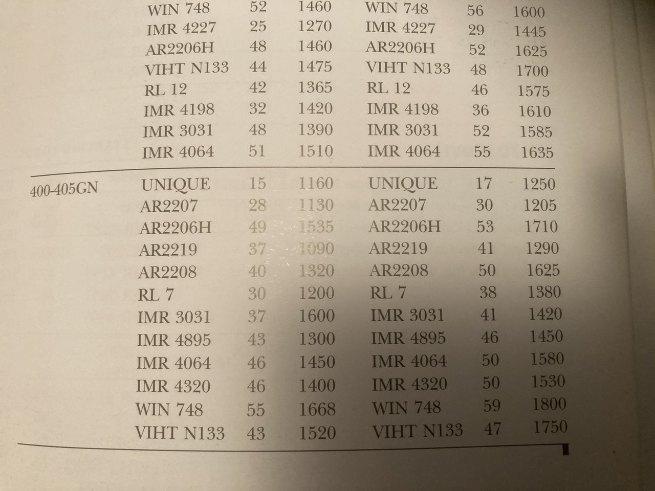

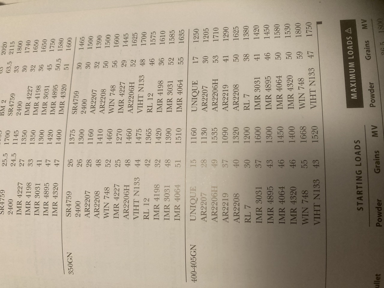

Blr243 wrote:Big rich can u please share your nick Harvey low FPS lead loads with 2208 and 2219. Pretty sure I have those powders ?
Here ya go , straight from uncle nick’s bible
Here ya go
Posts: 6640
Re: Lead loads in 45-70
Post by bigrich » 15 Sep 2021, 5:34 pm
Try again, it was the right way on my phone. these figures are for 1886 winchester and trapdoor springfeild . these figures came from uncle nick's 10th edition. the data given in this edition for 1895"s is hotter than this data for jacketed projectiles . this data does not say if it's for lead or jacketed , so as always use caution . maybe cross refeerance with adi . i checked and the 2208 and 2207 listings are about right for lead as in the latest adi manual . interesting is data in the ADI manual ,the case fill and speed for ar2206h for 405gn lead 40-48gn for 1424fps - 1645fps out of a 24" barrel . food for thought
a lot of yanks use alliant 2400 for lead loads . as you can see blr some of these loads have good case fill from some powders . with small powder loads in the big 45-70 case dacron is used as a case filler to keep the powder near the primer for consistant ignition and accuracy . for those that may not know , dacron is the fluffy stuff used to coat foam in upholstery before it's covered with the cloth/leather .
hope this is as helpful to some as it has been for me . now , back to more research :D
Right way I hope

Post by Blr243 » 15 Sep 2021, 5:56 pm
Thanks very much for that ! That will keep me busy
Posts: 4808
Post by bigrich » 15 Sep 2021, 6:00 pm
Blr243 wrote:Thanks very much for that ! That will keep me busy
use caution mate , play safe . reread what i've posted as i did edit to try to make things clearer :thumbsup:
let us know how you go :D
