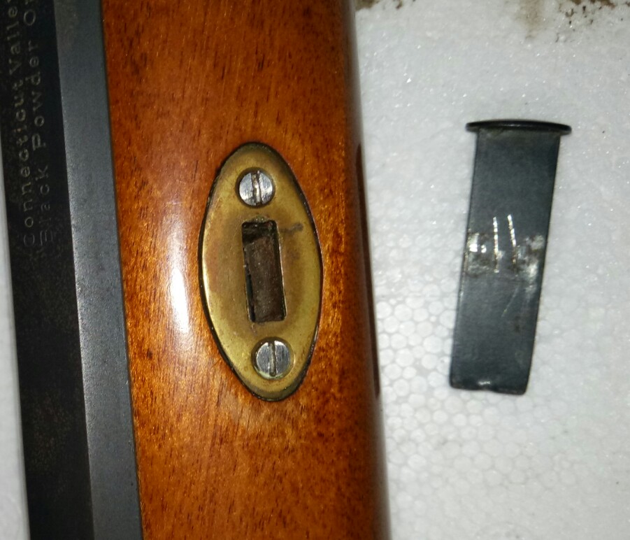

What is this for? :lol:

Post by bigpete » 16 May 2018, 7:49 pm
Holds the barrel in. If you cock the hammer,pull that out,pull the ramrod out,you should be able to lift the barrel from the muzzle end and it hooks at the other end into the stock

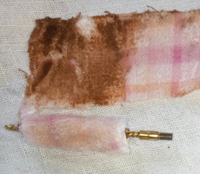

I gave the bore a clean todayjust using about 10 patches with eds red. It has a loose spot 5 inches from the plug. I'm not sure if that will make a huge difference to accuracy or not. Anyway going to let it soak for a week or so then give it another few patches.

Post by bigpete » 20 May 2018, 2:25 pm
I just use hot water,no soap. No you don't take the breech plug out ( you would struggle to anyway if its like mine ). Once your drying patch is coming out clean,oil the barrel. I use something I got from green rivers when.they were still operating that looks like a water based machinists oil. I've also use rp7 when I'm lazy lol. But any sort of natural oil or grease is ok.
