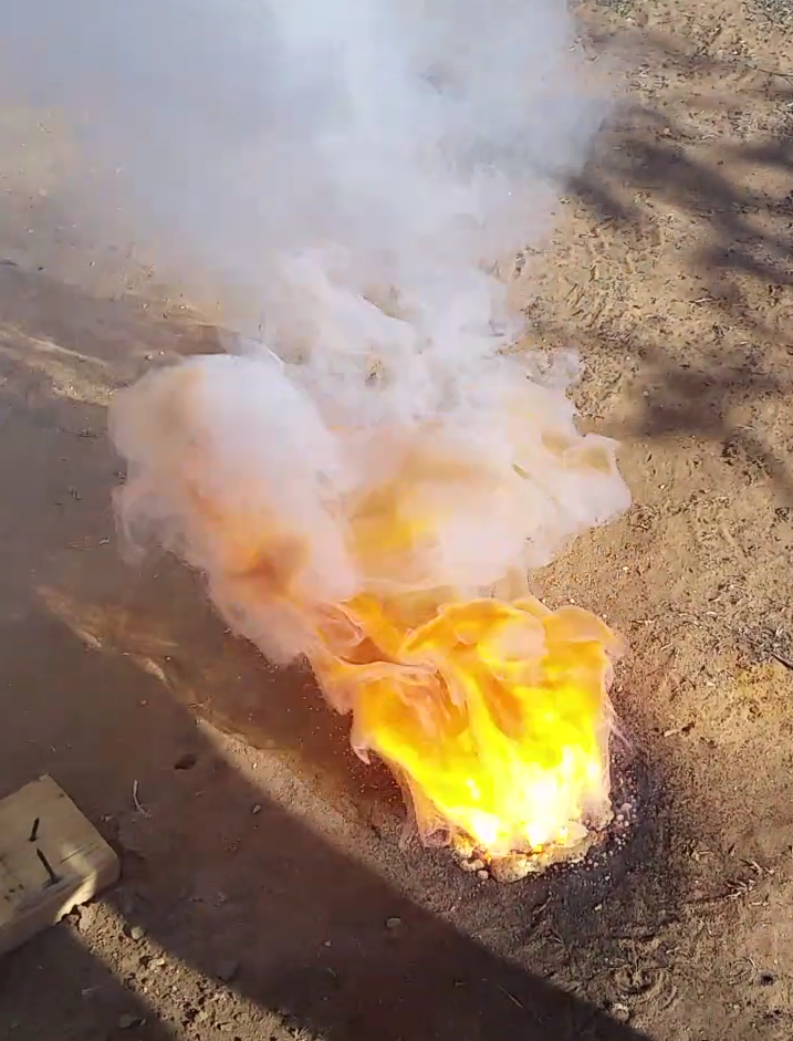

Farmer i know made his own powder...i assume it would be closer to black powder as it burned real slow (compared to modern rifle or shotgun etc stuff).
Heres a pic i screen shot from the video...
Home made powder.

Blackpowder burns far faster than smokeless.

Anyway this was pretty slow to my mind & left residue but would still build a good deal of pressure i imagine. :unknown:

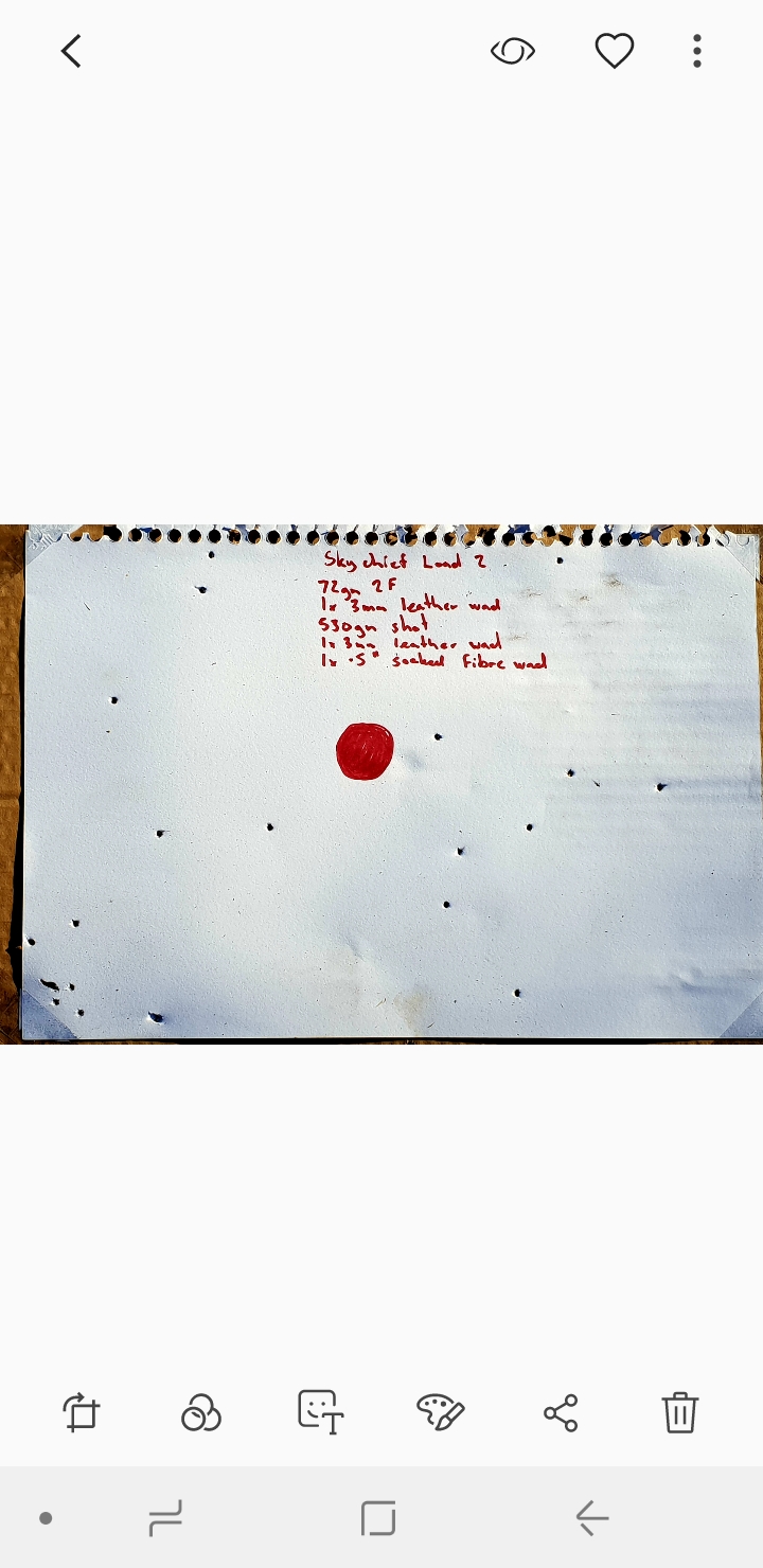

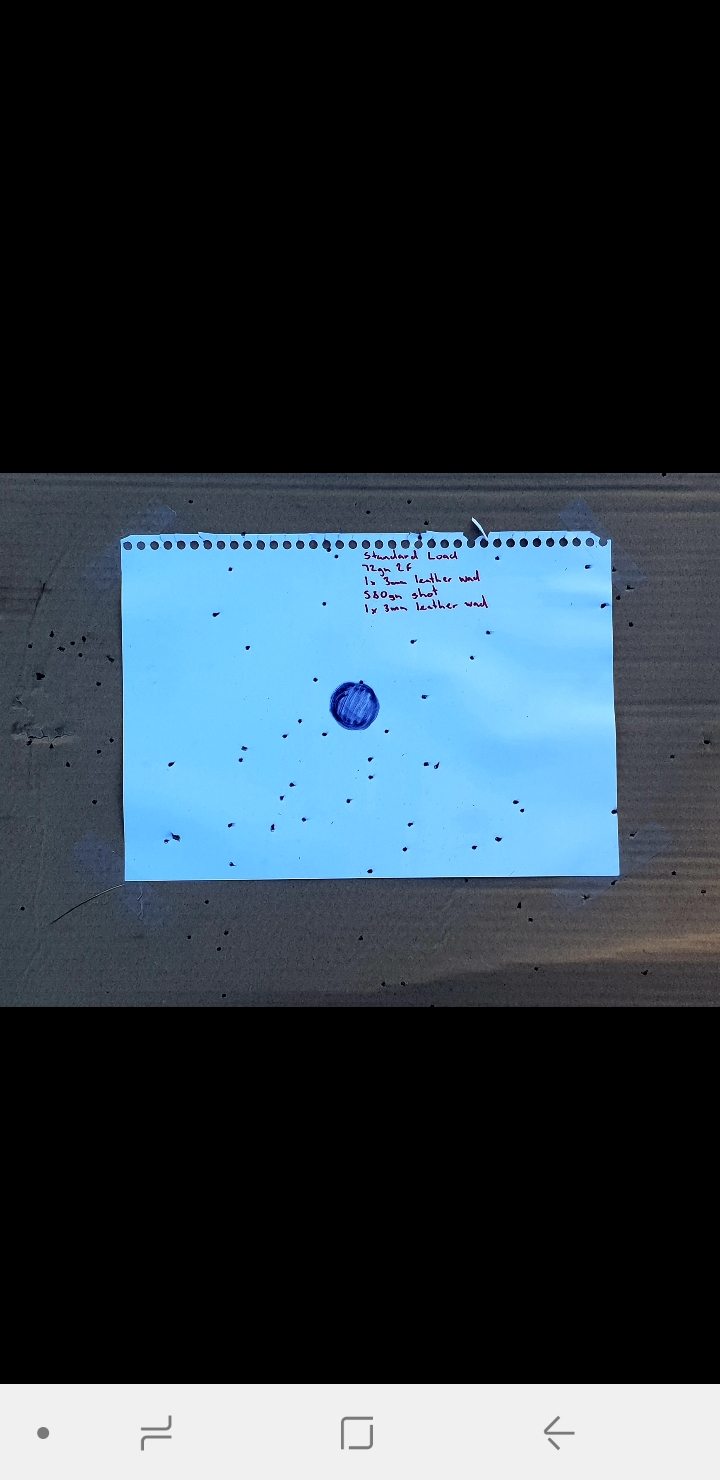

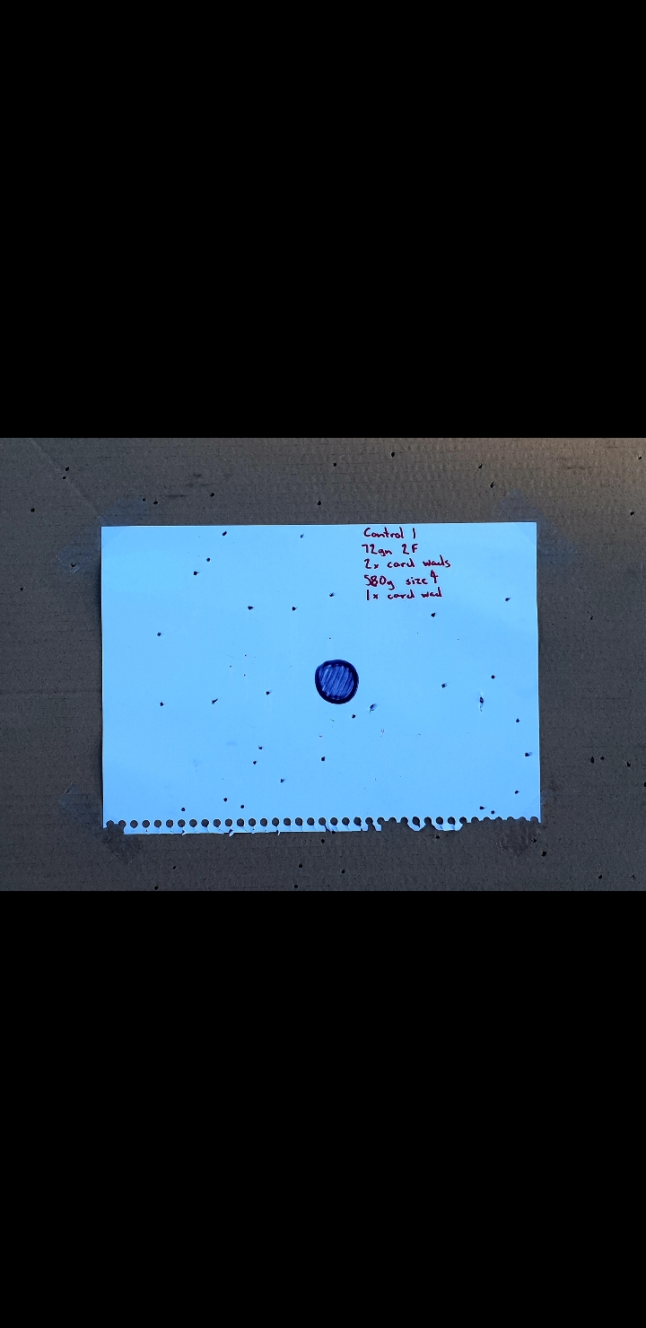

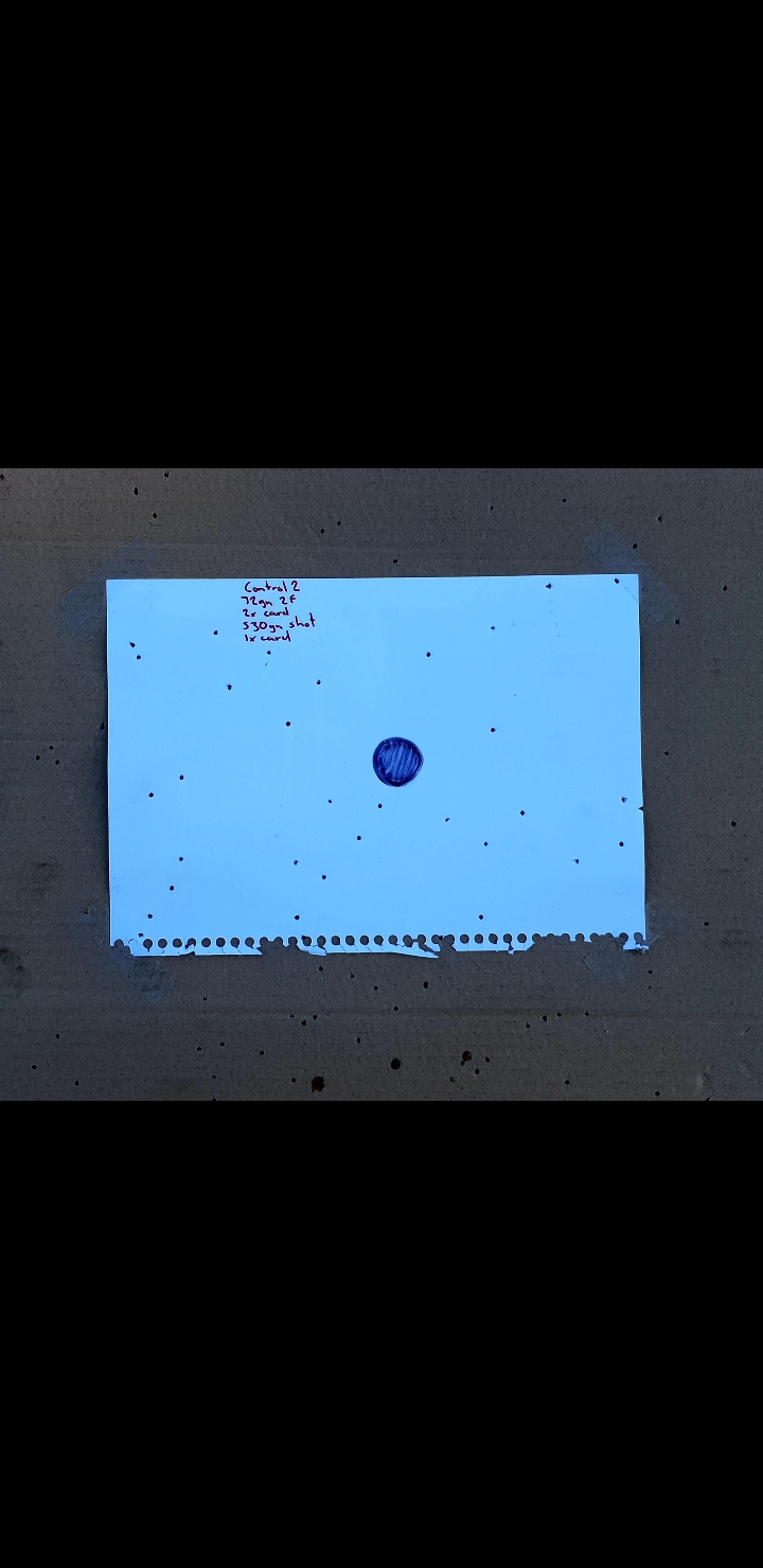

Ok,so I tested the Skychief loads....personally,in my gun,they made everything worse. So I won't bother with them again.
Interestingly, my standard rough loads using leather disks worked the best....
Anyways,the pictures tell the tale. All shots at 30m aiming at the dot. White paper is A4 size,and was replaced after the shots,so is the only real comparison.
