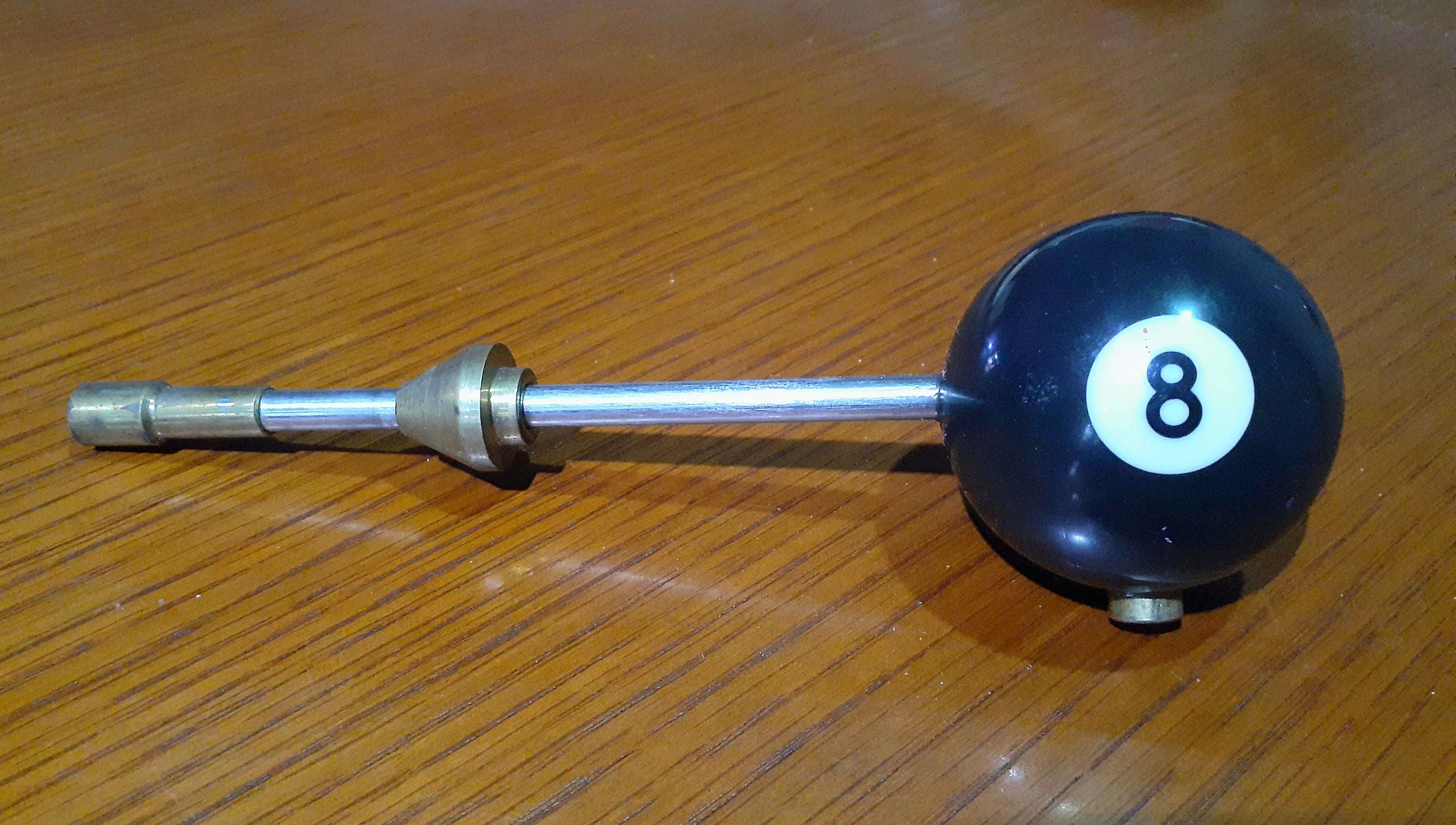

One of these is essential if you want to hang with the cool kids in the front stuffer brigade :thumbsup:
8 ball starter

on_one_wheel wrote:One of these is essential if you want to hang with the cool kids in the front stuffer brigade :thumbsup:
Was that taken from one of Napoleons men at Waterloo?
Don't need it if you cone your muzzle ;)

Post by on_one_wheel » 02 Aug 2020, 11:11 am
It was taken from The Commercial on a Friday night
They play 7 ball there now ;)
