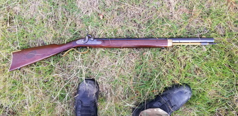

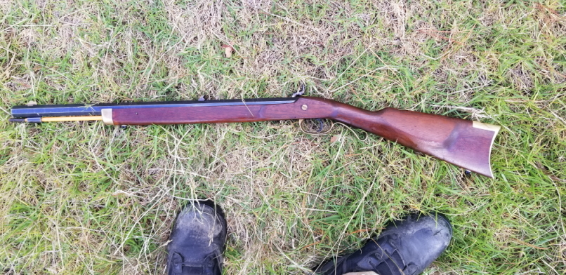

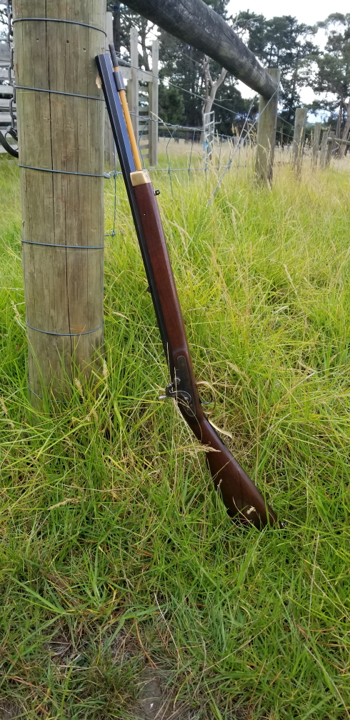

The "new" blackpowder forum gave me a hankering to get dirty.
Got lots of family here for a couple weeks so I couldn't get in as deep as I would have liked, but I managed 19 shots before needing a second clean and then finding other things to do :-)
I took 70gn charges of FFF out with me but it was tossing them into a 180mm circle at 30m, so I backed off to 50gn which improved it a bit.
Seems to be grouping around 120mm at 25m offhand.

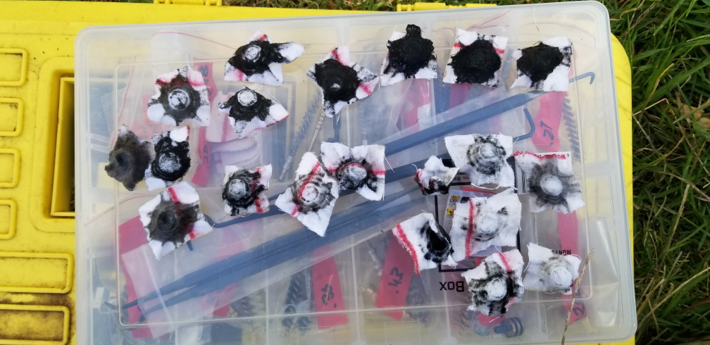

Five shots were good, then they started getting hard, with shot number nine needing to be persuaded down the bore with a stick. I cleaned the bore out to spotless and fired some more patched .440" balls until they started getting difficult again by shot number eight.
Then I finished with three REAL Lee bullets just on bore diameter. I did measure them but don't recall what they were now - .444" I think. On 50gn they went sideways so I think they need a bit more punch to obturate. And I think they're too hard. I lost my logbook from back when I cast them but I think they're too shiny to be soft lead. I probably threw them when I was casting rifle bullets. But so much easier to load, I'll have to cast a pile of them out of some lead conduit I was given a couple years ago.
Then I cleaned the damned thing again!
Twenty patches from cleaning it twice.

Your Hawken.
What breed is it?
Looks even short by Hawken standards.

Made by Hawkin in NZ in the seventies.
As short as it is it's still fairly front heavy.
